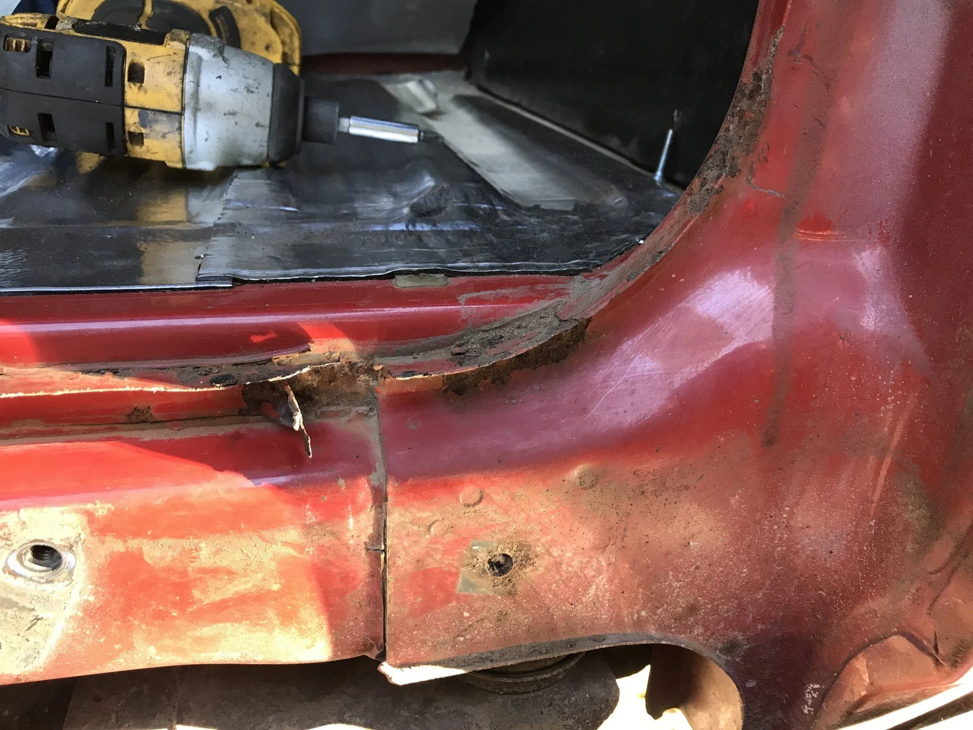

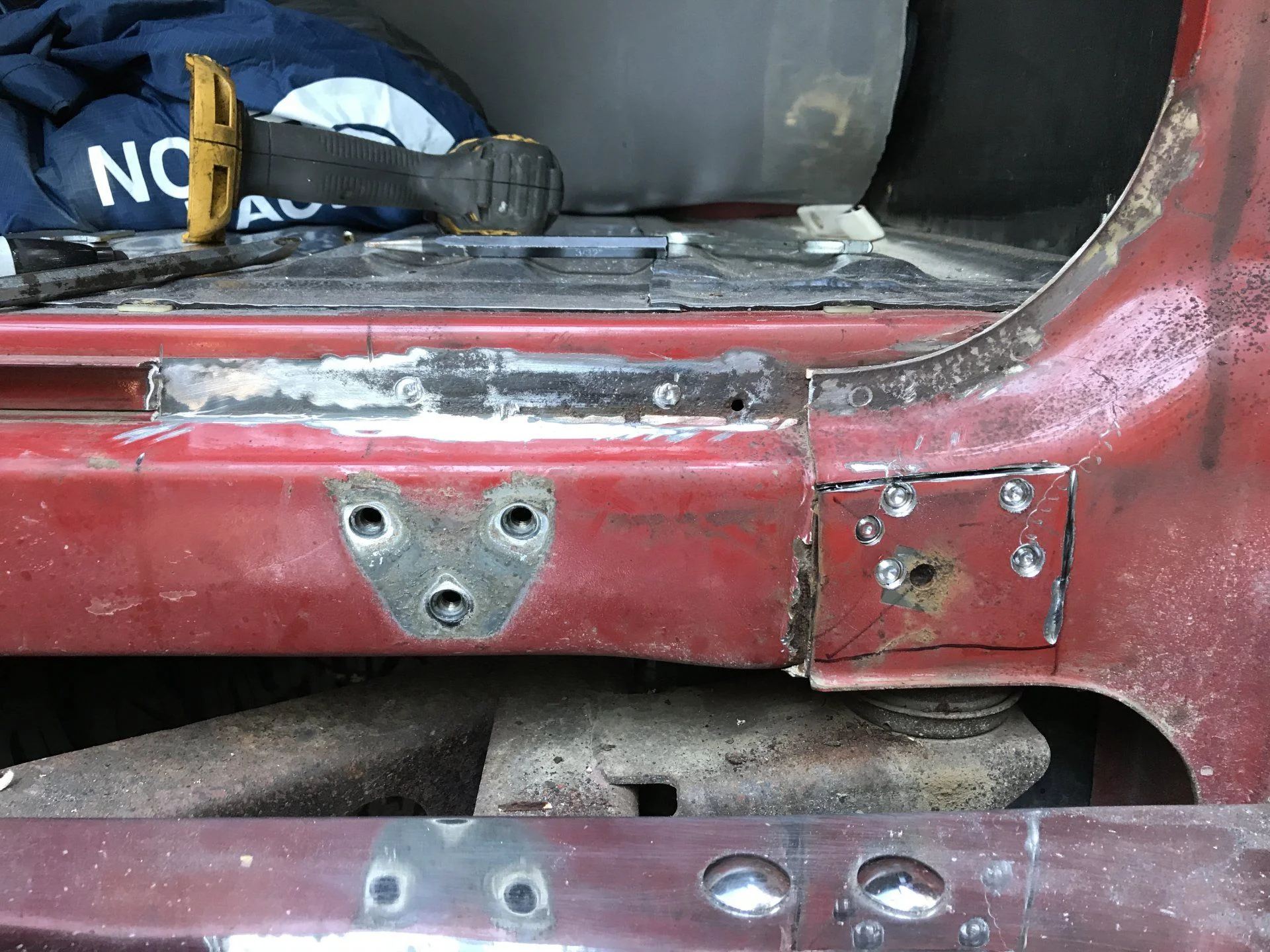

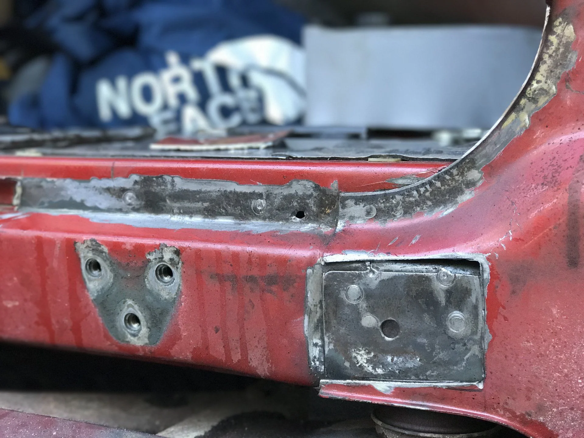

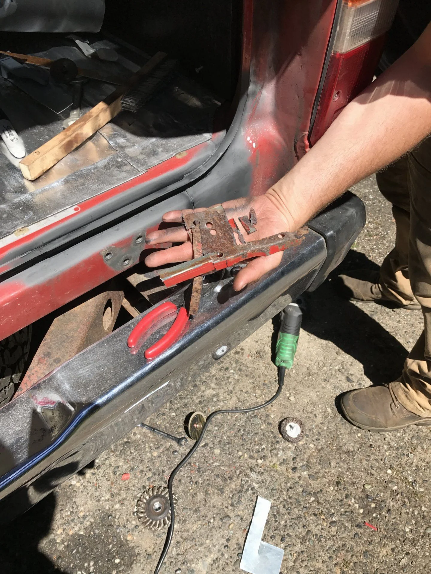

Went to replace the rear hatch surround weather stripping today and found a suprise. In the 7 years of owning the vehicle I never pulled it, prob need to make that a bigger priority people. No worrries, @Kleatus has got the routine down from his "Patches 40 thread" and is going to watch me learn how to grind ugh I mean weld.

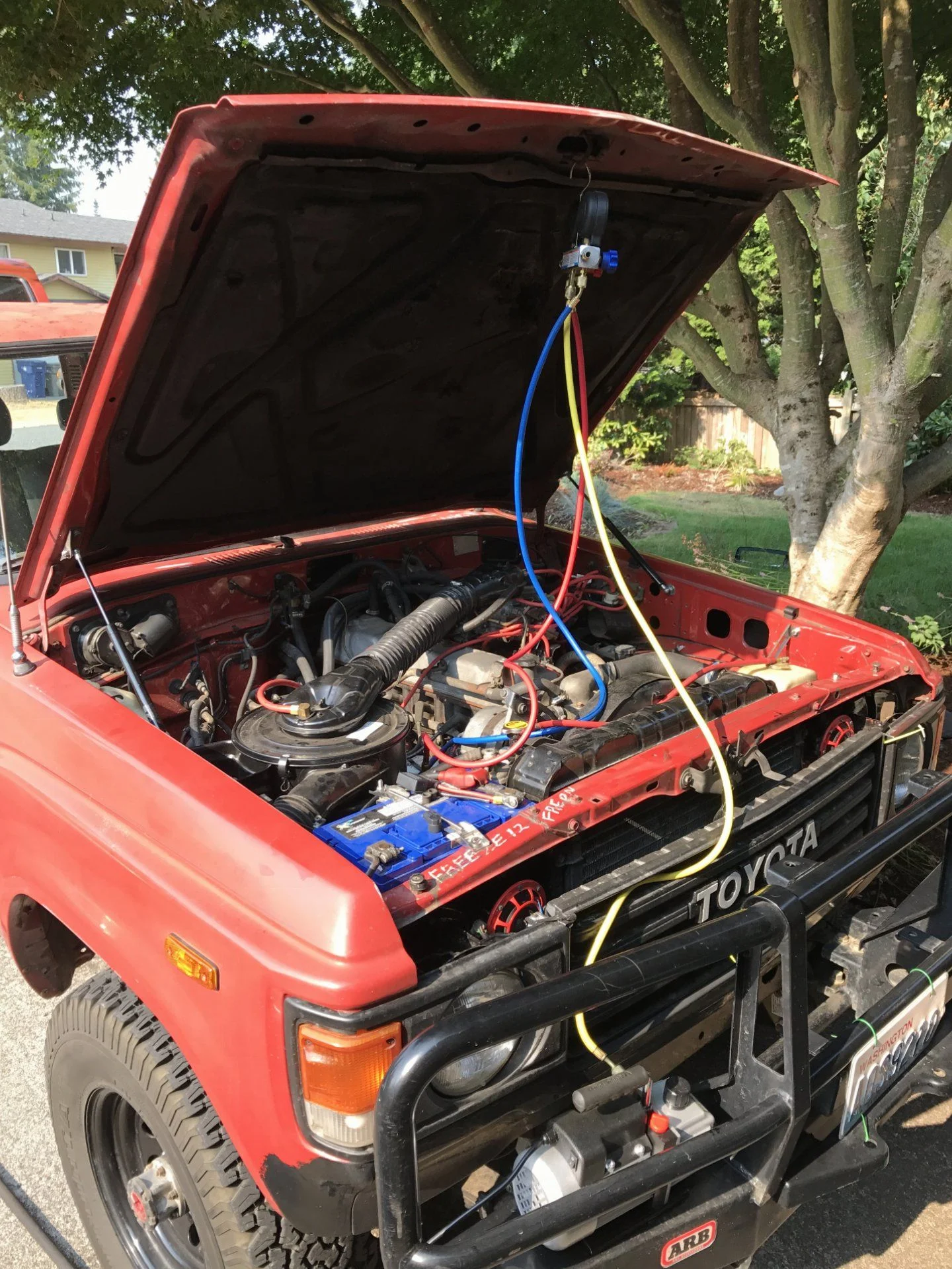

Haven't had AC running in 6 years. Pulled vacuum on the system for 45 mins. Didn't hold vac after I let the pump off. Need to double check the 134 adapters and rest of the fittings to make sure everything is tight.
I have a blower motor arriving Monday, and o-rings and new drier arriving on Wednesday.

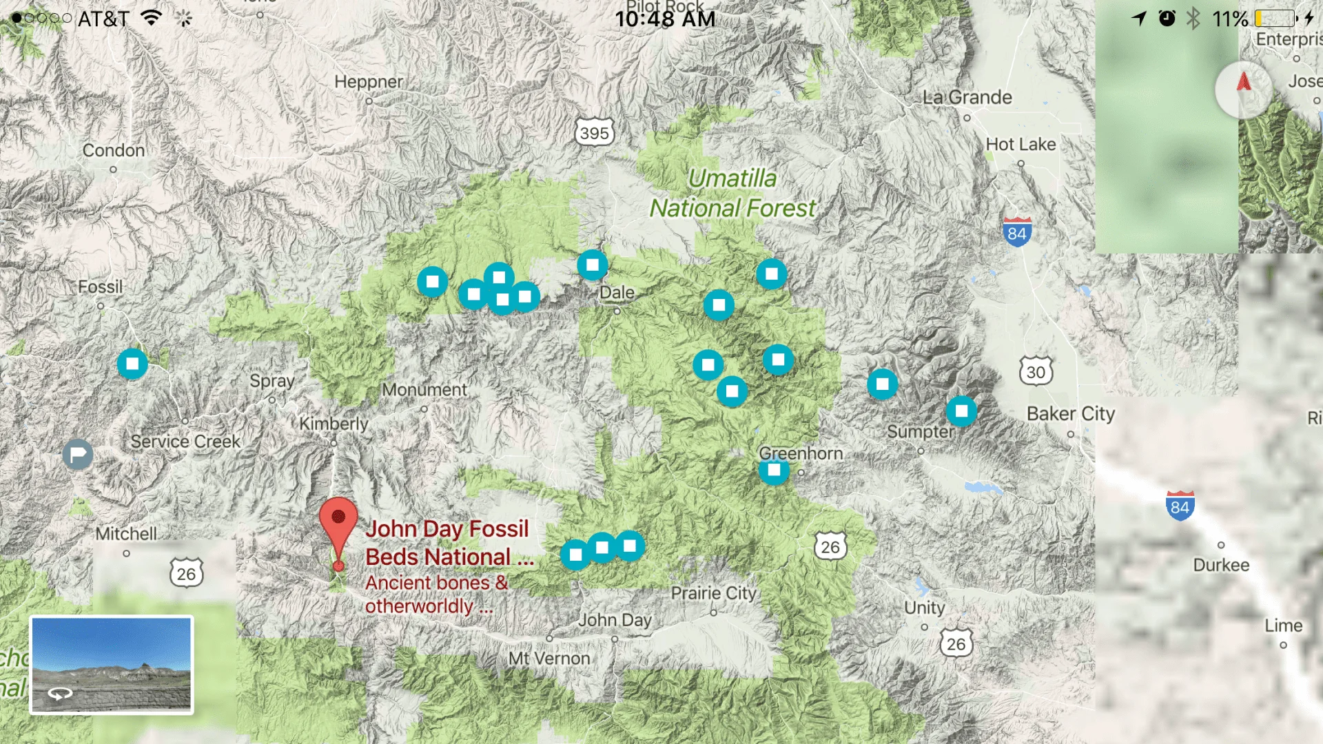

Blue dots below are mapped viewing spots. Couple fire towers, and ridge tops. Most are an hour back from paved roads.
