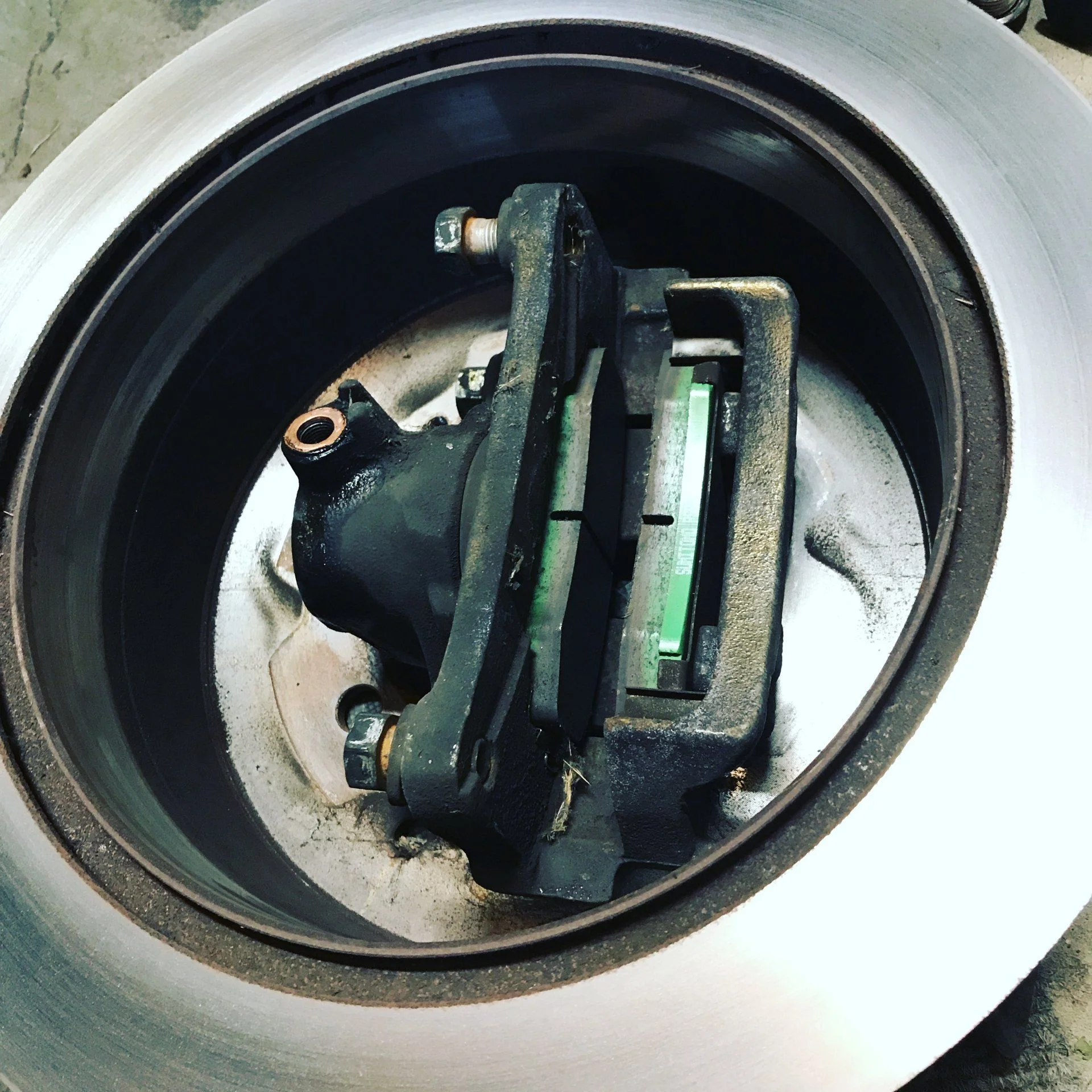

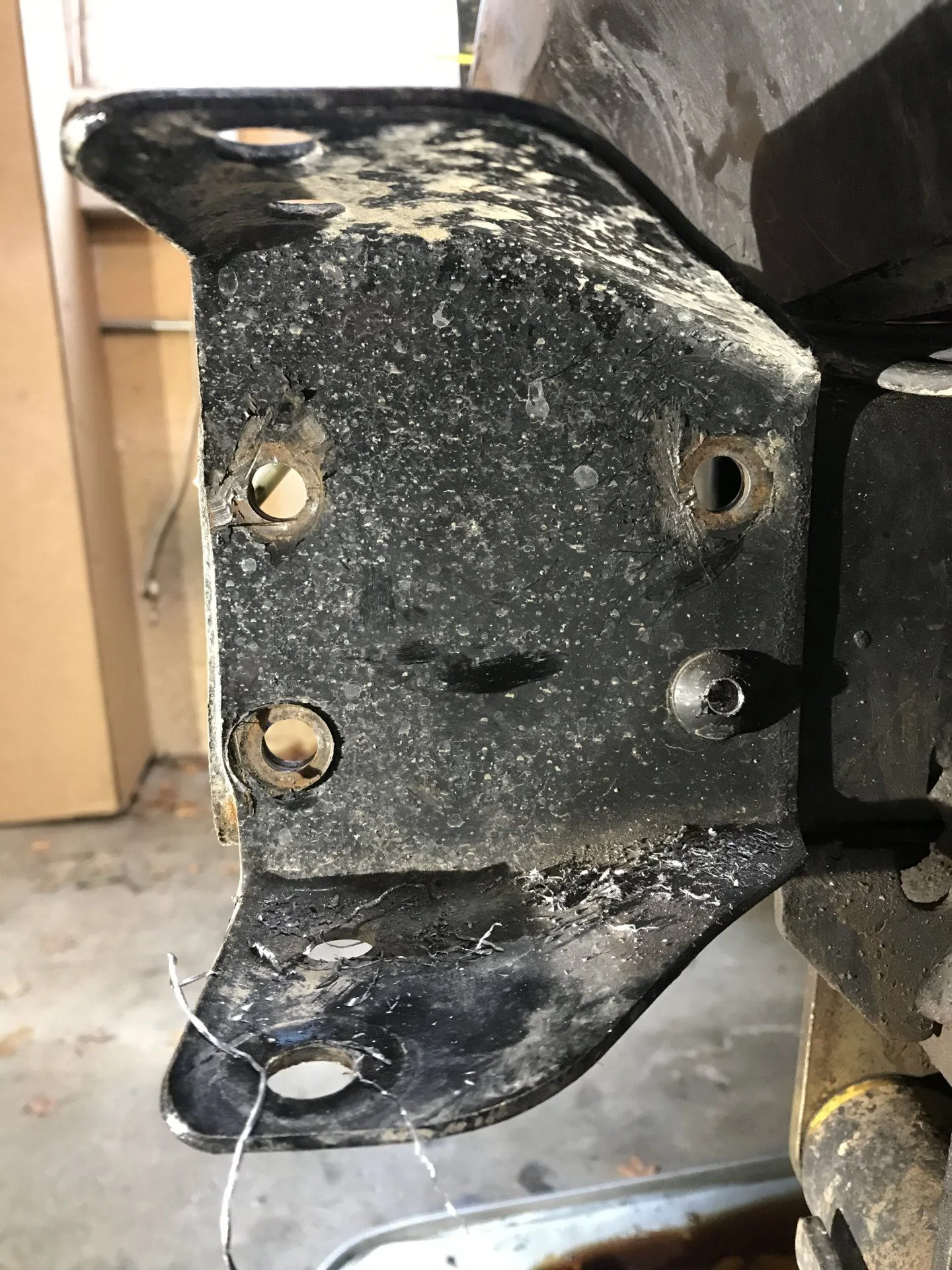

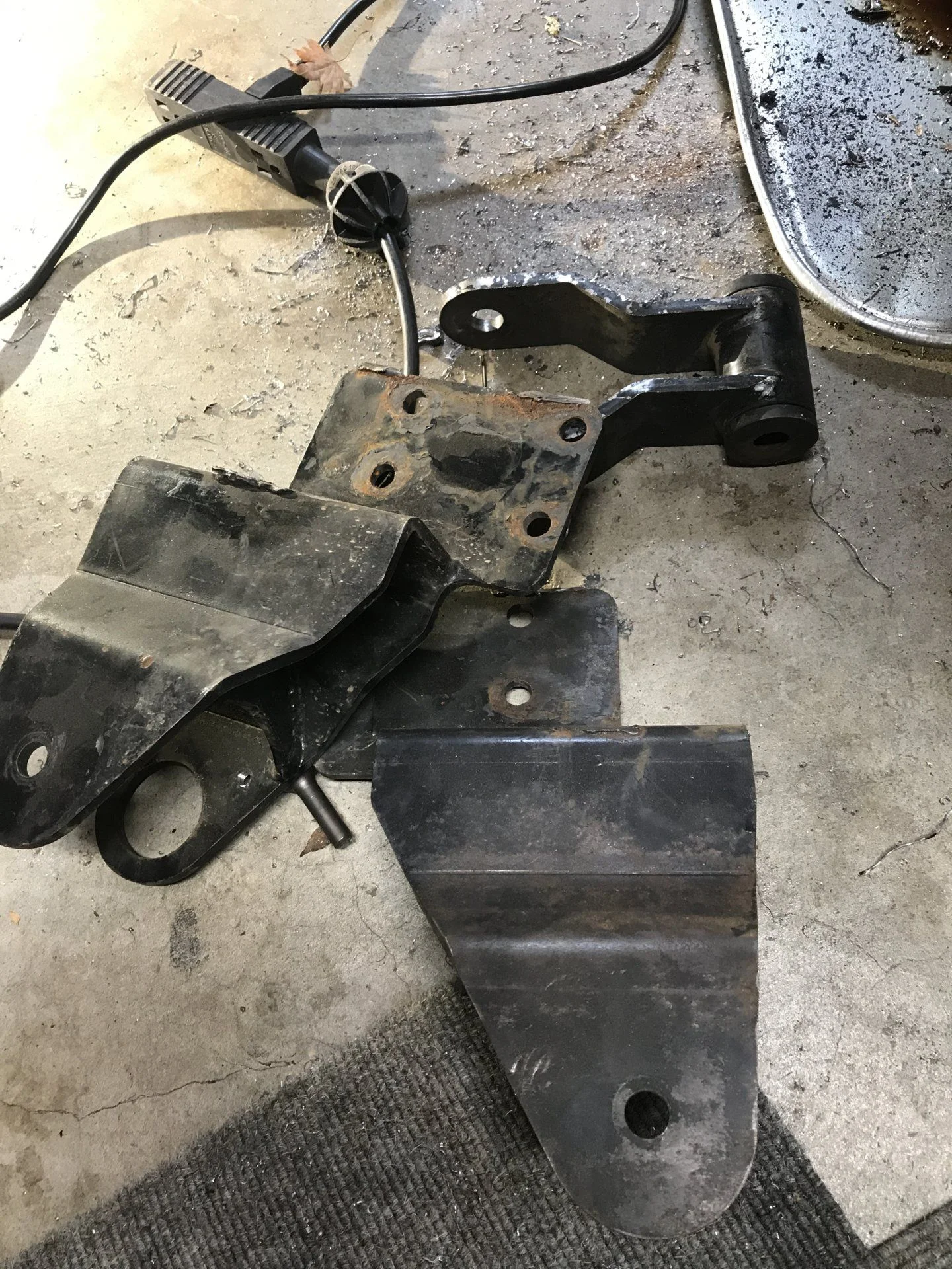

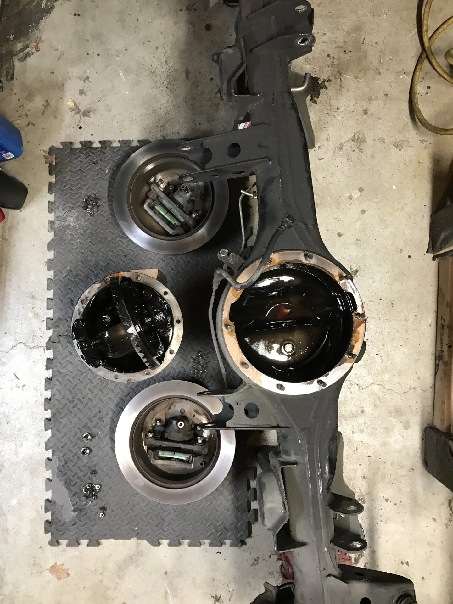

Started the axle breakdown. Looks like the PO ran ATF in the housing. Had TorFab give the 3rd a look over and they thought it was in good shape. Have the axle re-buil parts on order and started in on grinding off the suspension mounting brackets.
Parts are in for the rear axle. Need a little more research on the swaybar attachment.

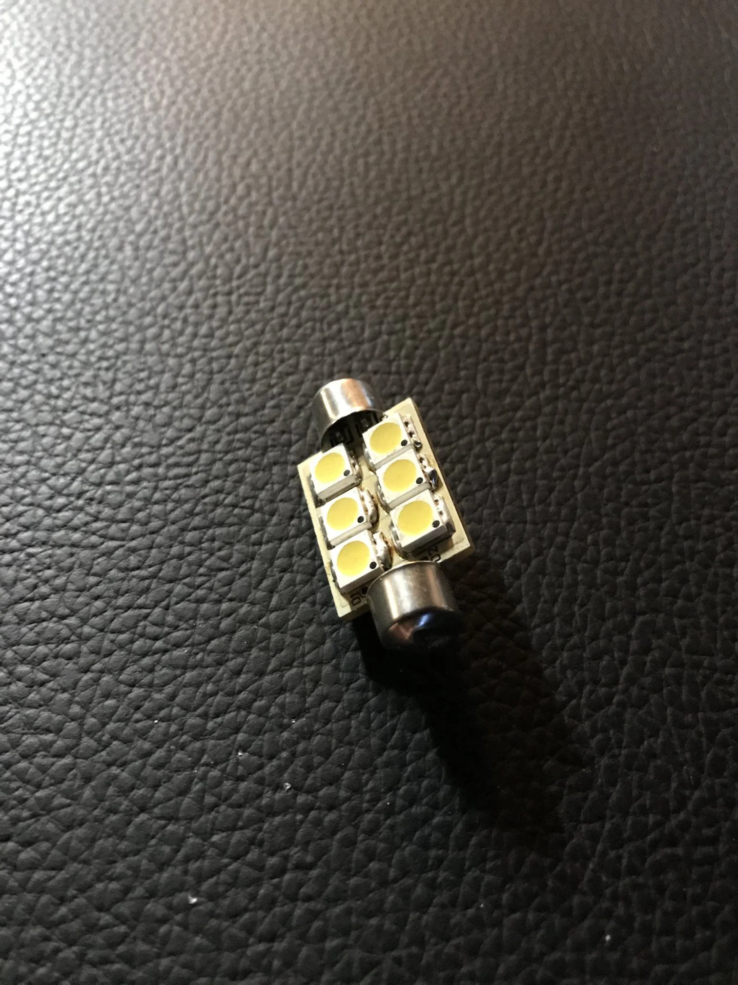

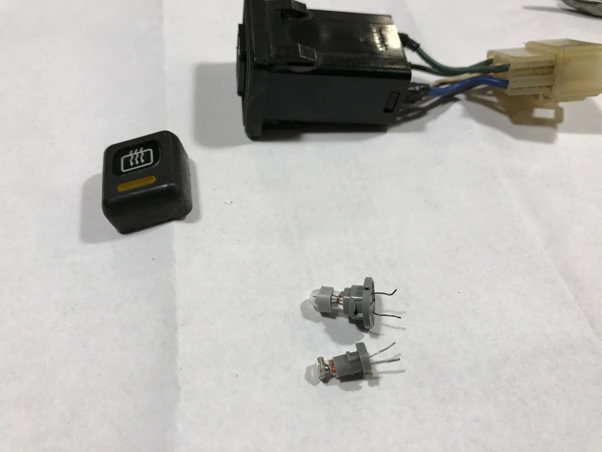

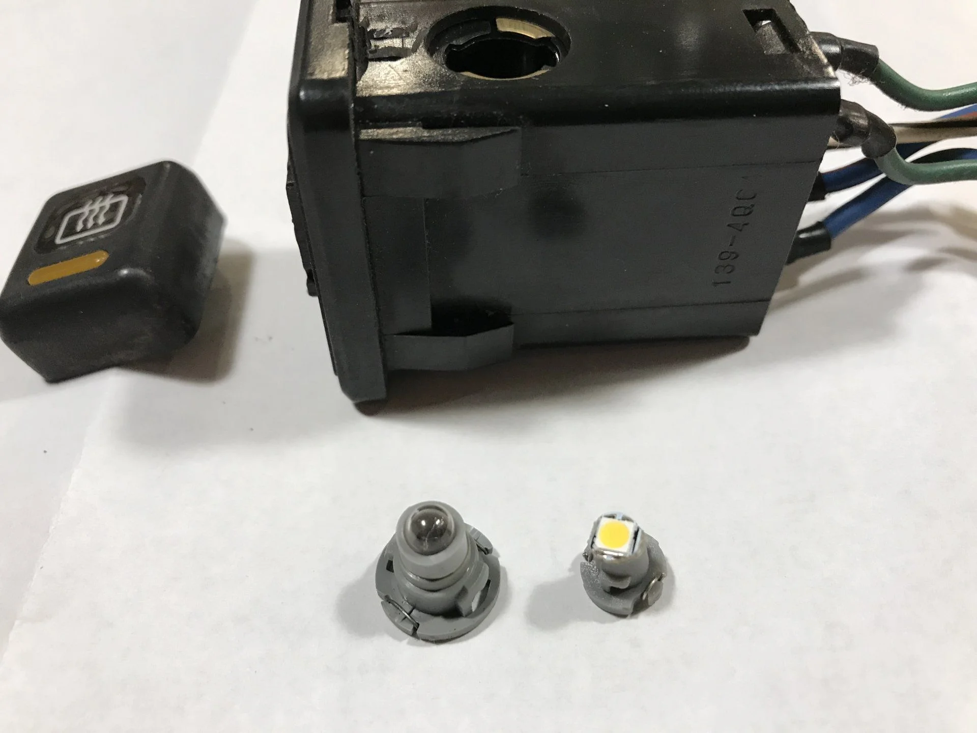

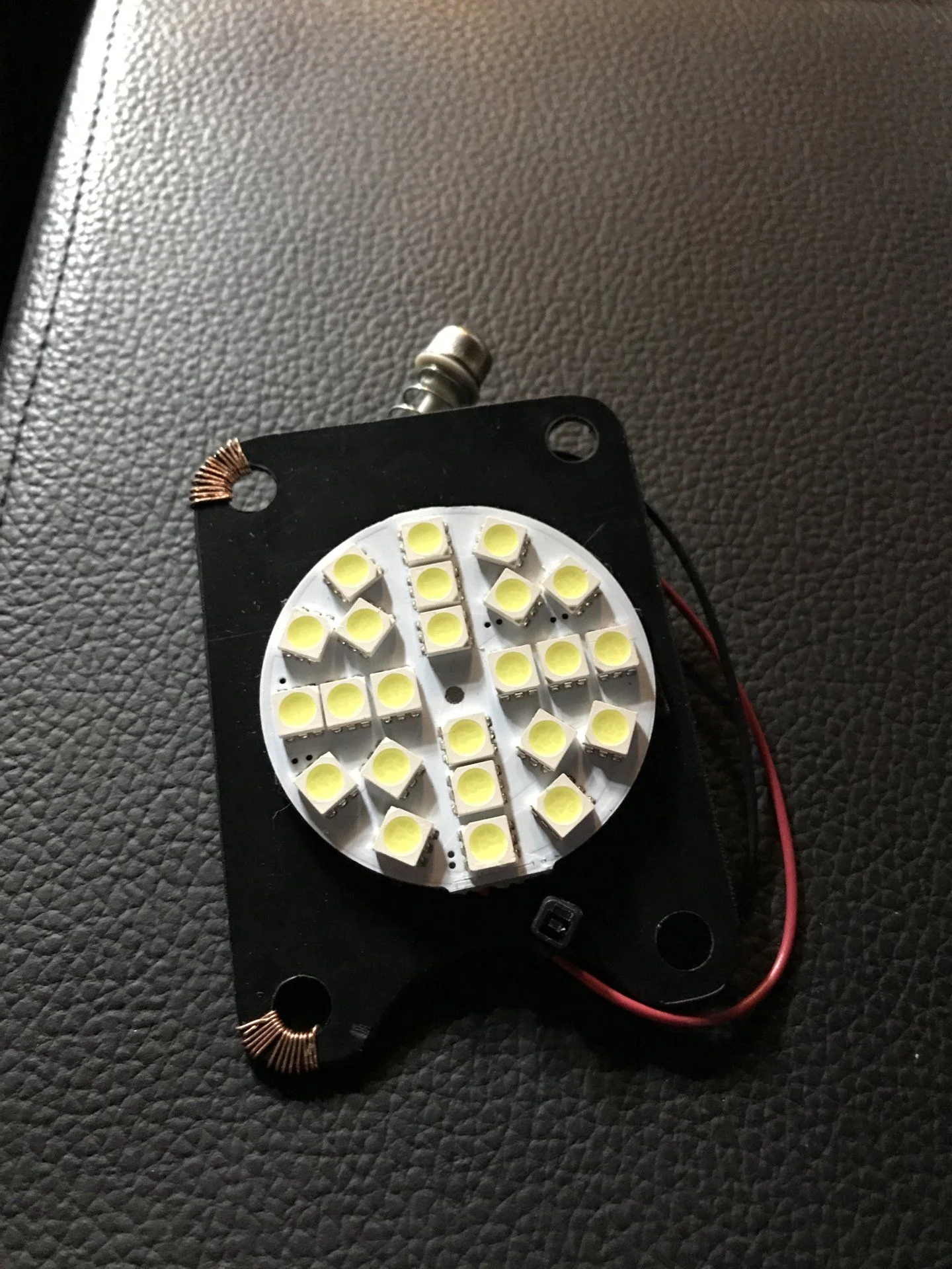

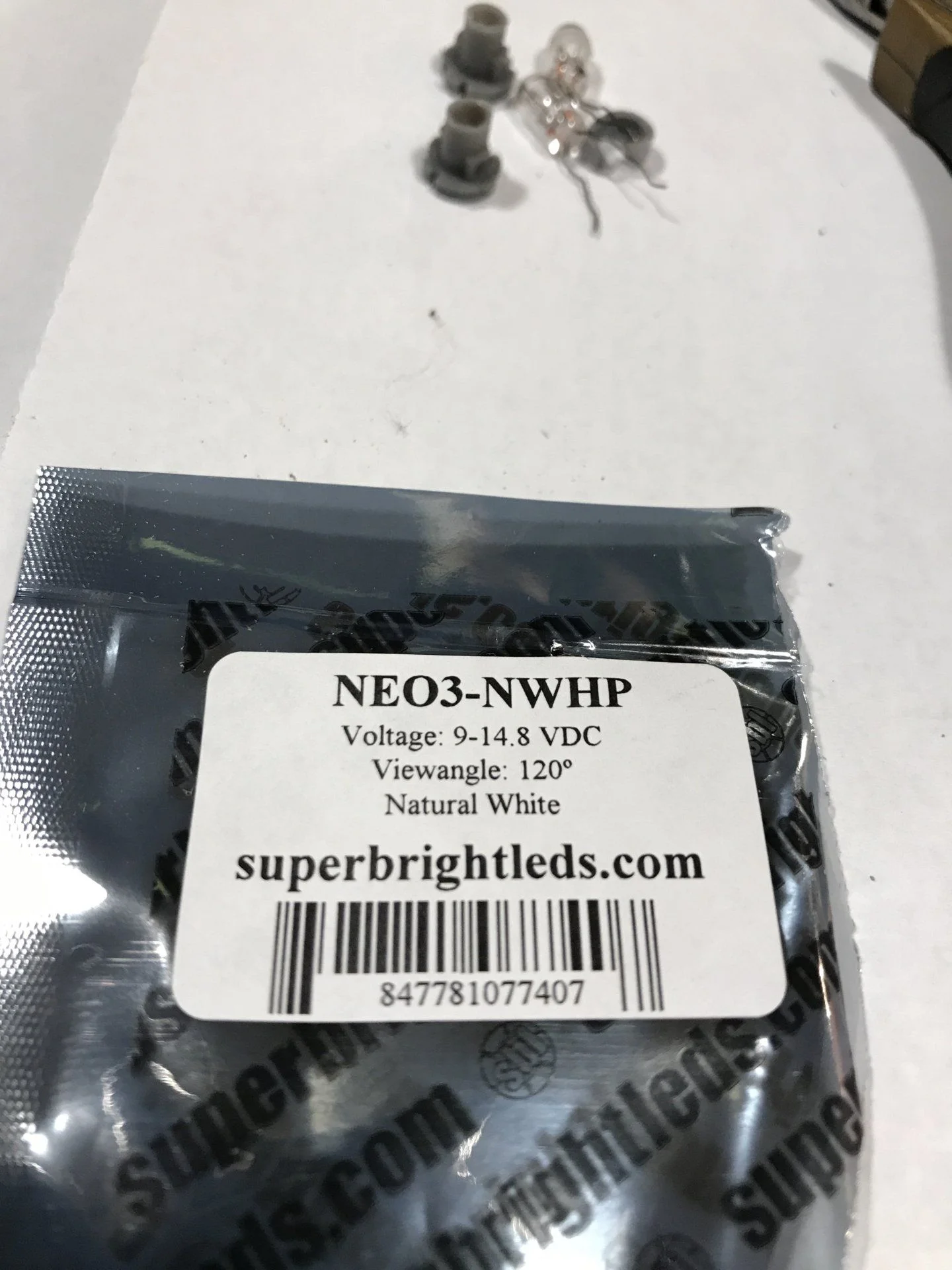

Also ordered a could LEDs to try and get the rear defrost button to light back up again.
Left is the OEM and incandescent bulb, right is the replacement LED. You end up using the OEM plastic housing and swap the bulbs.

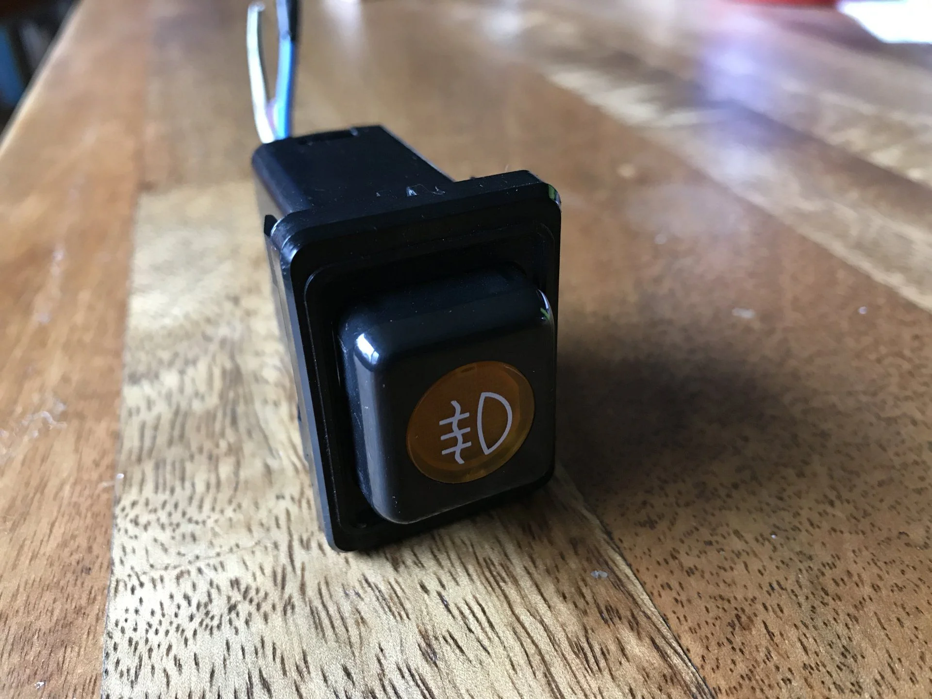

Straighten the wires out and switch out the LED. You'll need two bulbs per button. I've picked up a few of these to re-label and use as switches to run accessories down the line.
NeO3-NWHP natural White superbrightleds.com

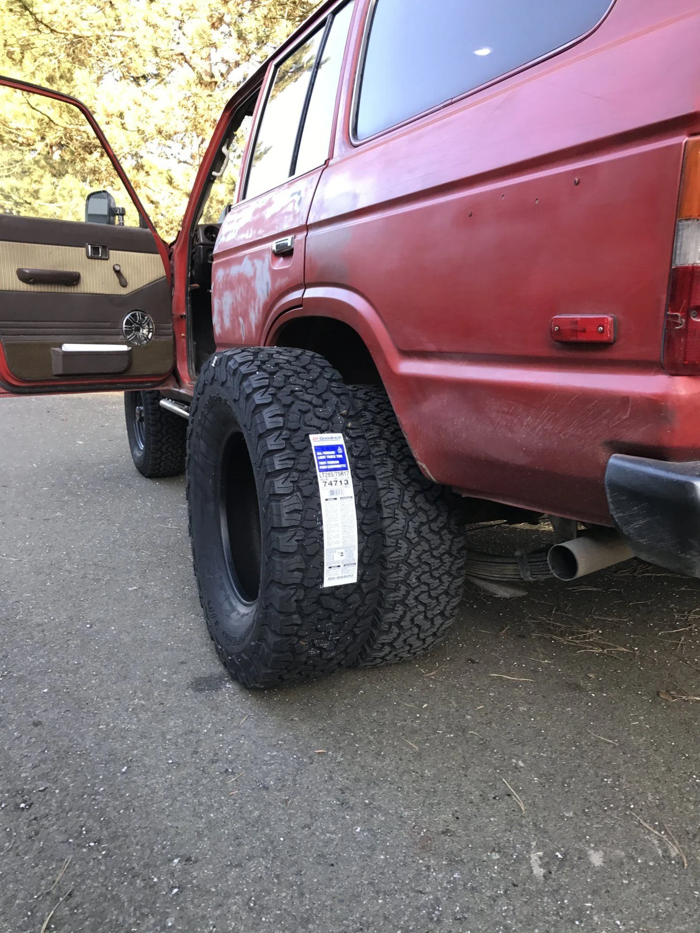

285/75R17 BFG KO2's ordered.

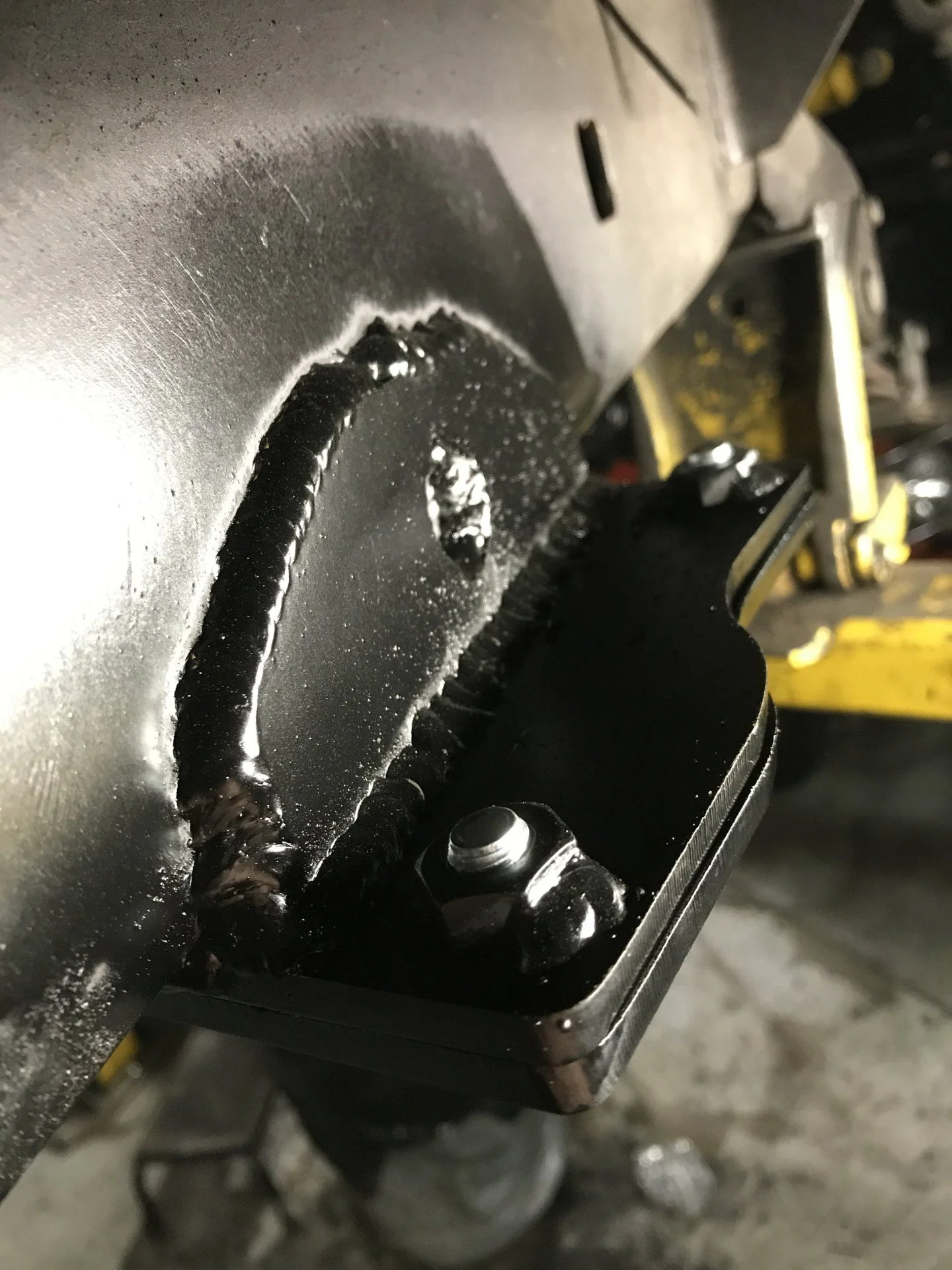

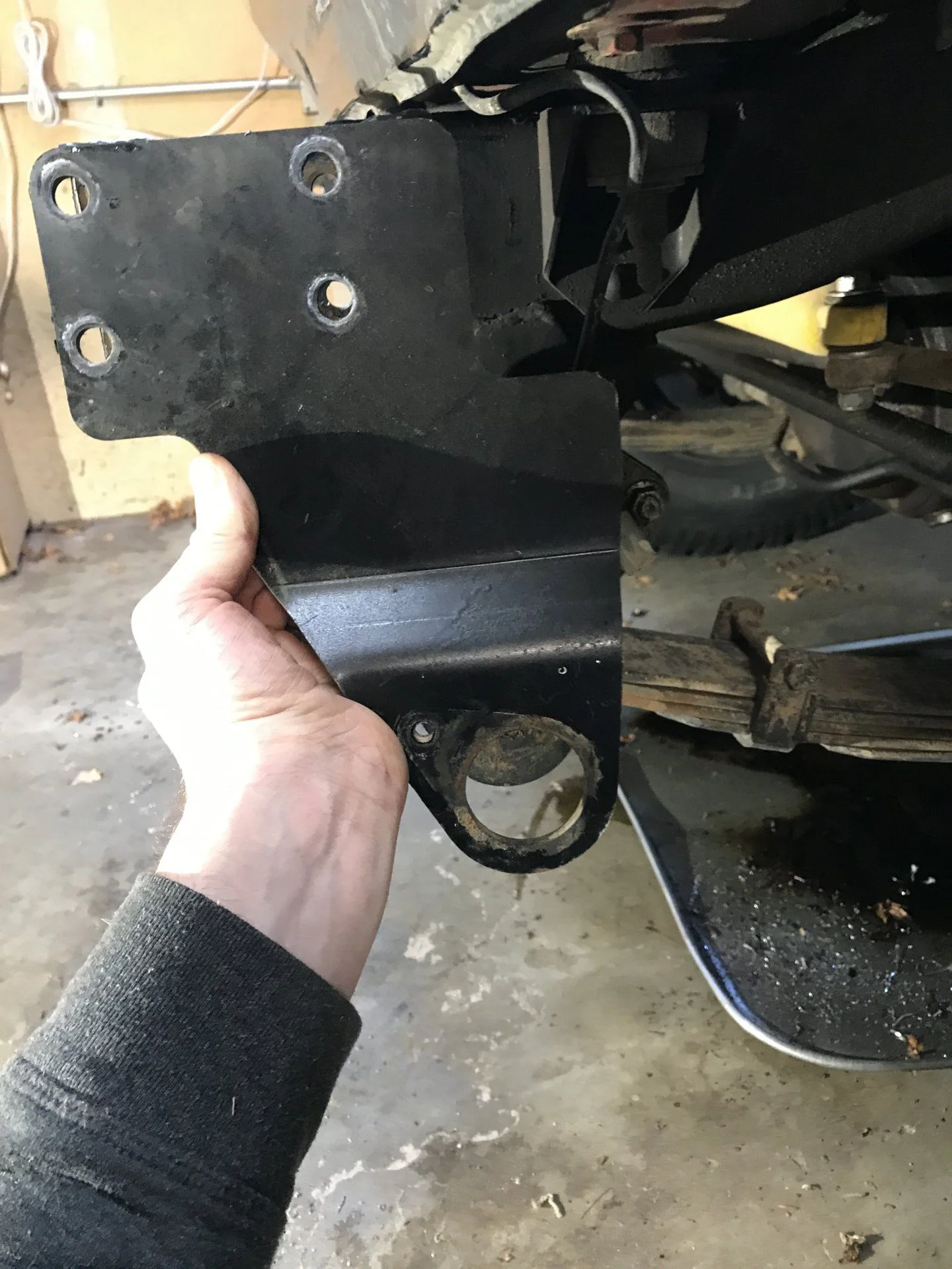

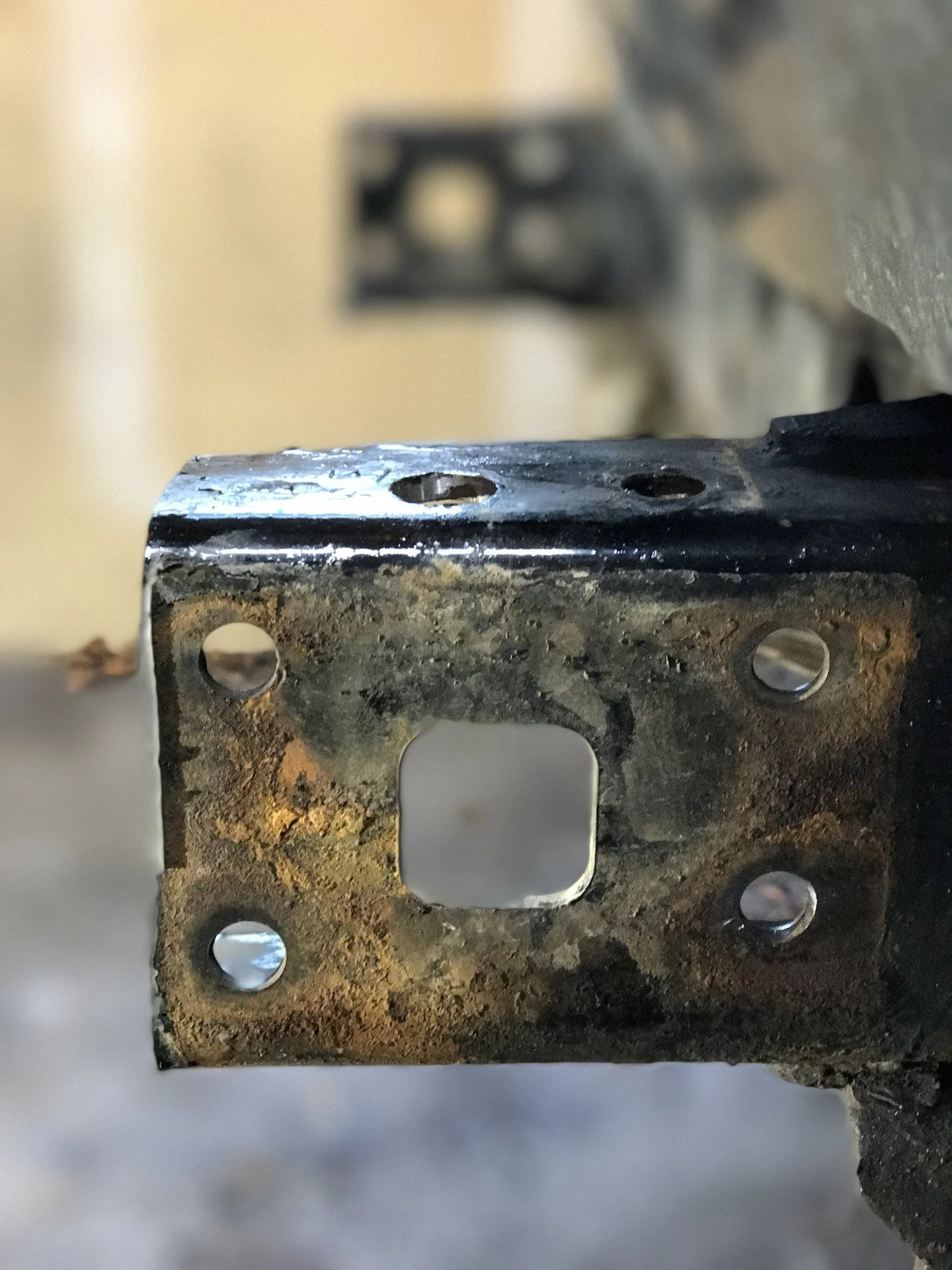

Early 60 bumper mounts in great shape. Getting ready for a SR. hope this will balance out my stink bug.
Hope to get the 80 rear axle perches set today with the help of @Kleatus.
I don't have the whole thing re-built yet so it will be just to get perches welded in then finish the re-build at my place. (Might be time to get a welder)

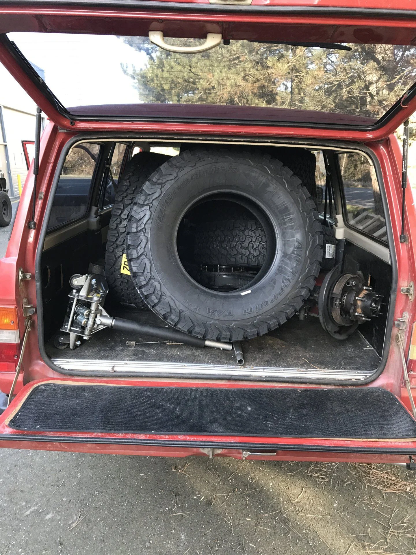

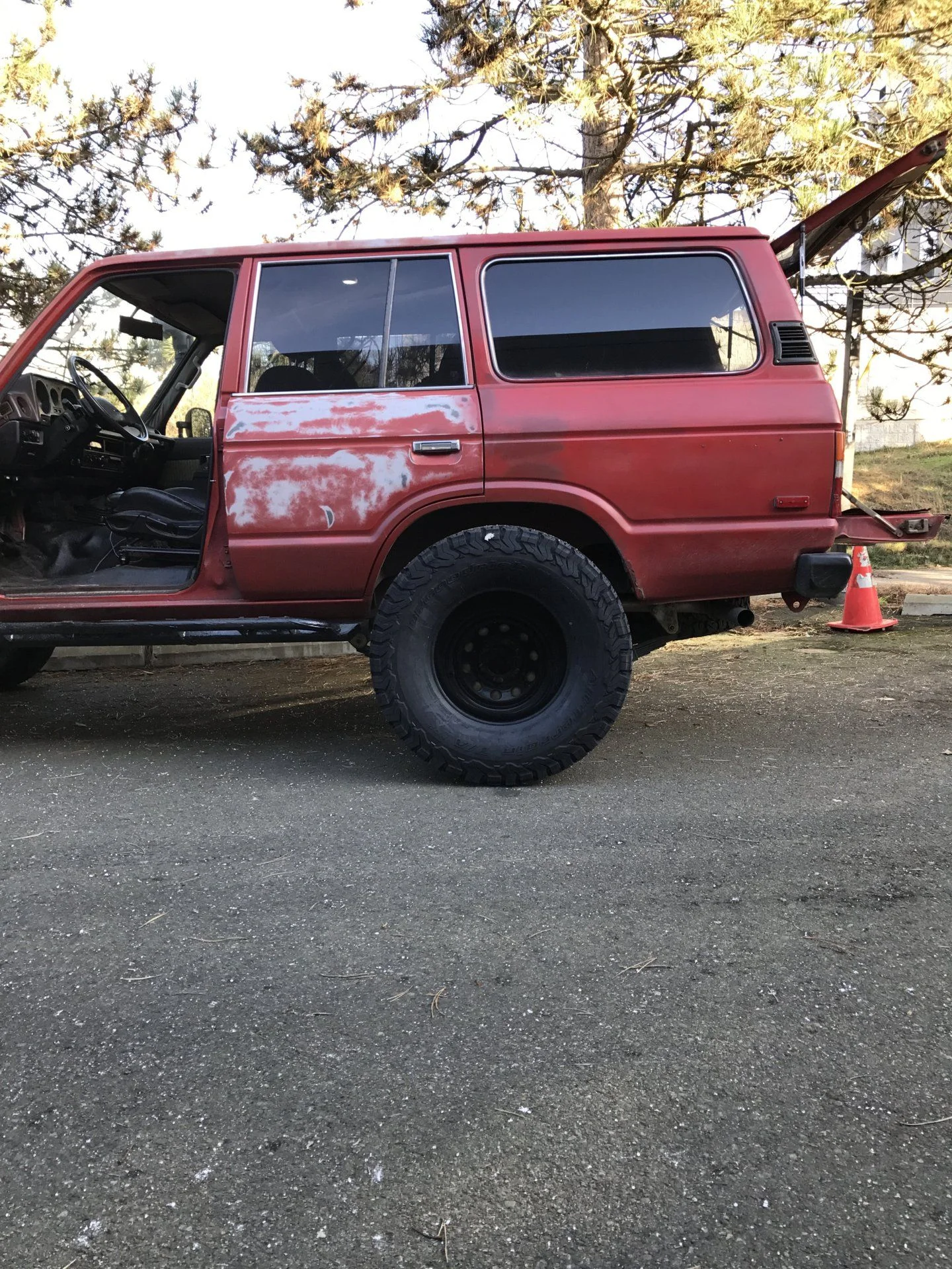

New shoes. 285/75R17

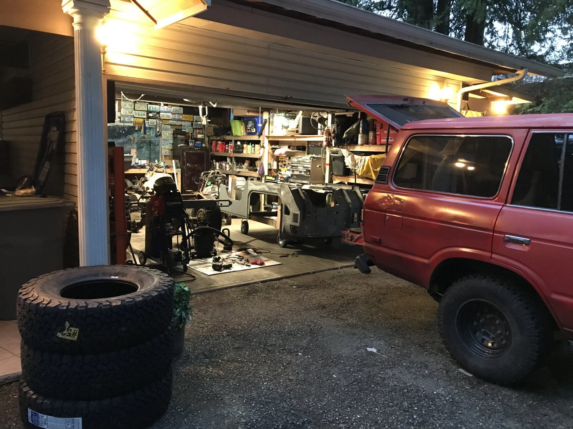

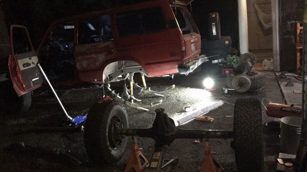

5 tires and a 80 rear axle fit, took a little Tertris to get right though.
Out with the old. In with the new with @Kleatus at the #HausofKlaus (glimpses of Patches in the garage)
Late night welding on the 80 rear axle.
Popped over at 5pm and we stopped at about 1:30am, couch surfed till the AM.
Now that the perches are welded in place, I need to get the rest of the axle re-built and the brake lines plumbed.

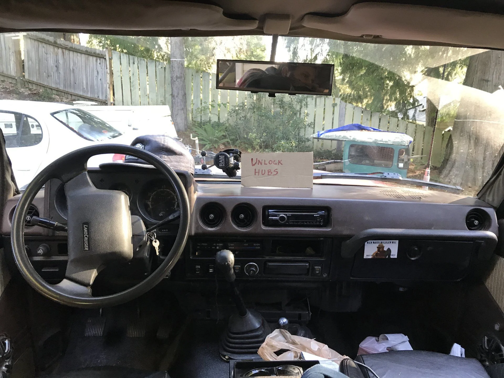

#HausofKlaus coffee in bed (when you make it)
@Kleatus does have some nice touches when you bring your rig over. Simple dash reminders are thoughtful and hand written.

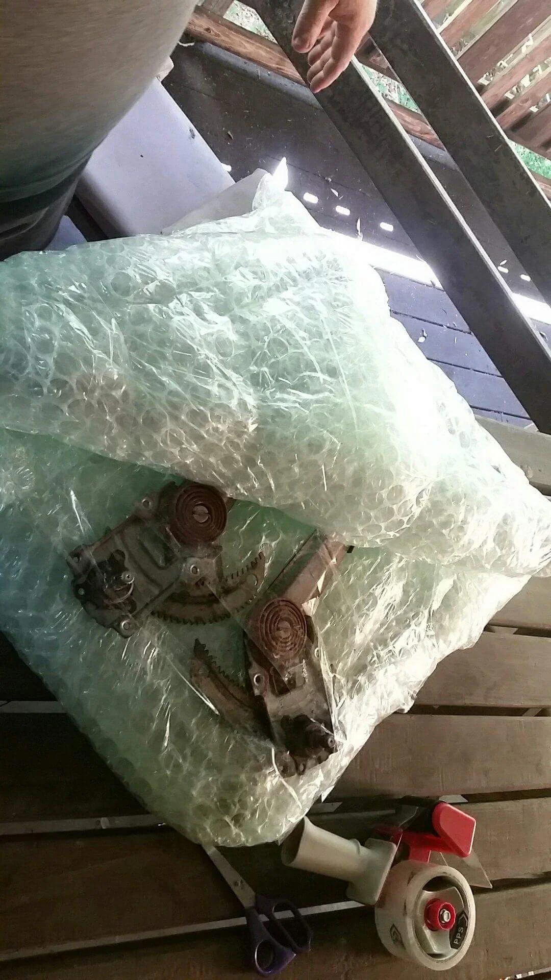

On the departure the dang window fell off the regulator.
