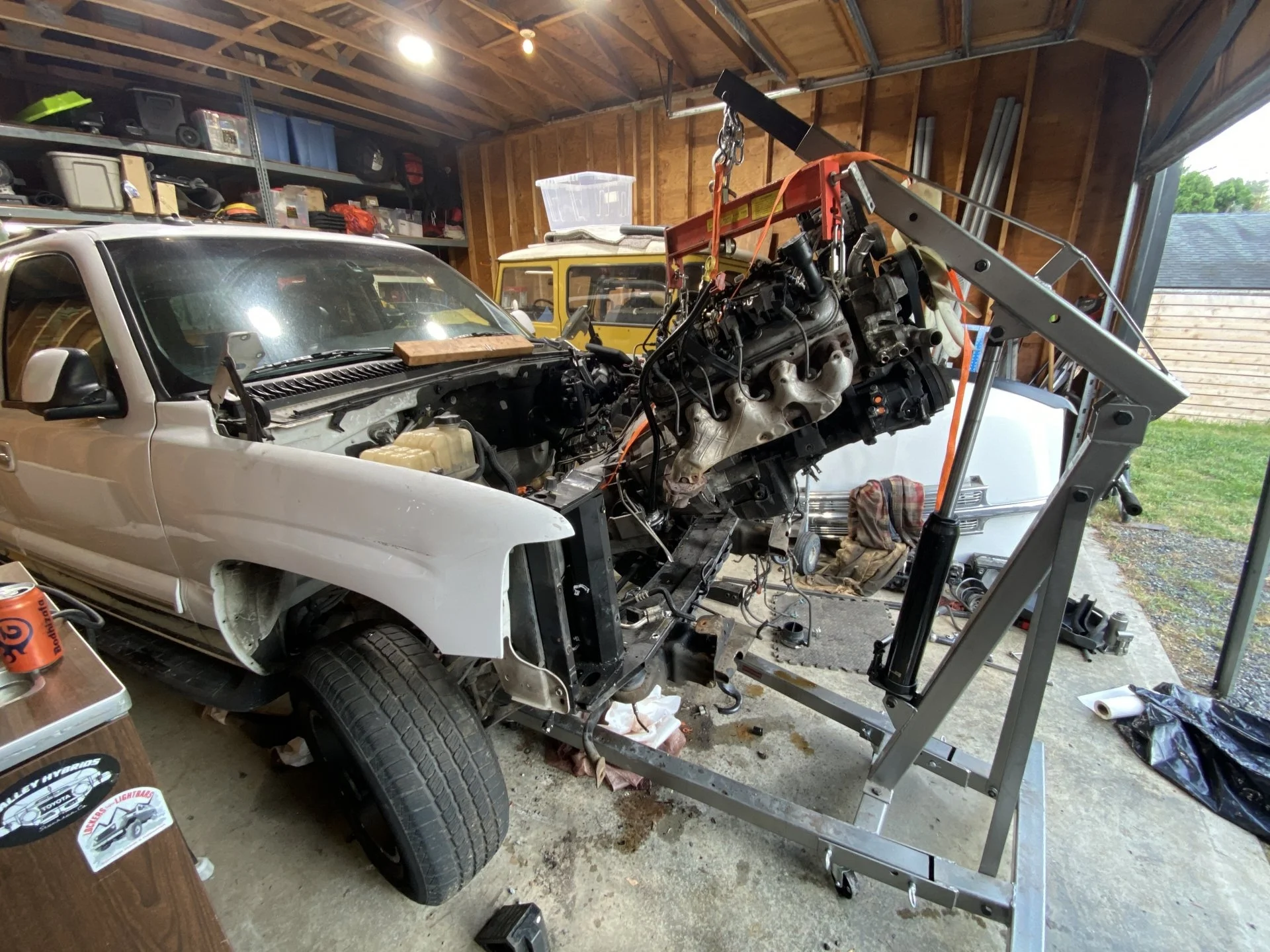

I’m happy that you’re doing a 5.3 and sad that you’re getting away from the 2F.

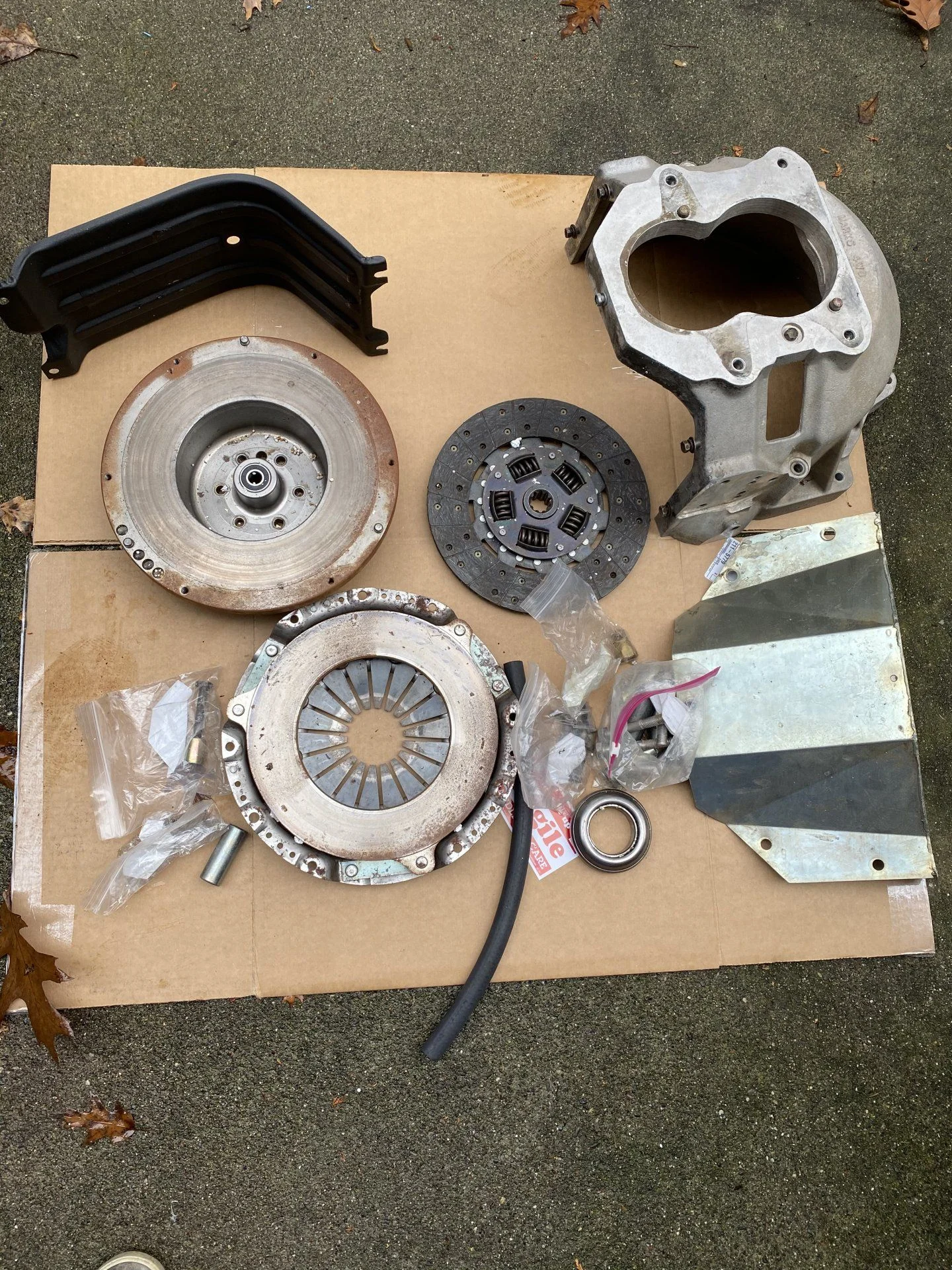

Honestly just run the H55f since you already have it. I just did one with the Marks kit. It’s a pretty nice setup. That truck had 3.70/33’s so just put some 35’s on to go with your 4.11’s and you’ll be good to go!
40 will be keeping one. That’s going to stay as stock AF.
2F has been very kind to me and I love it under 35mph (off road has some throttle response lag that bugs me when it’s steep and I’m scared). I know very little about efi so it’ll be a little bit of learning.
Ultimately the LS platform works well, has parts accessibility and as @Kleatus said “You’re just bringing the weight to power ratio up to 90’s era passenger cars.” 😆
I don’t really hear that many people say “I wish I never LS swapped my rig”.
This build isn’t close to stock and the drift away from a Toyota power plant isn’t the direction I thought I’d originally go but this was too good to pass on.
Especially since I have a Marks adapter kit I bought a few weeks ago. Thanks @MadronaFJ60

Lemme fix that - “You’re just bringing the power to weight ratio up to 90’s ̶p̶a̶s̶s̶e̶n̶g̶e̶r̶ economy car standards.”
and then if you want more power later you can simply bolt parts on and have it
Little more to pull off the doner rig then get rid of it.
Thats was a learning experience for sure. When in doubt: sawsall.
Come up and help me pull the drivetrain out and get the LS in this winter between ski days.

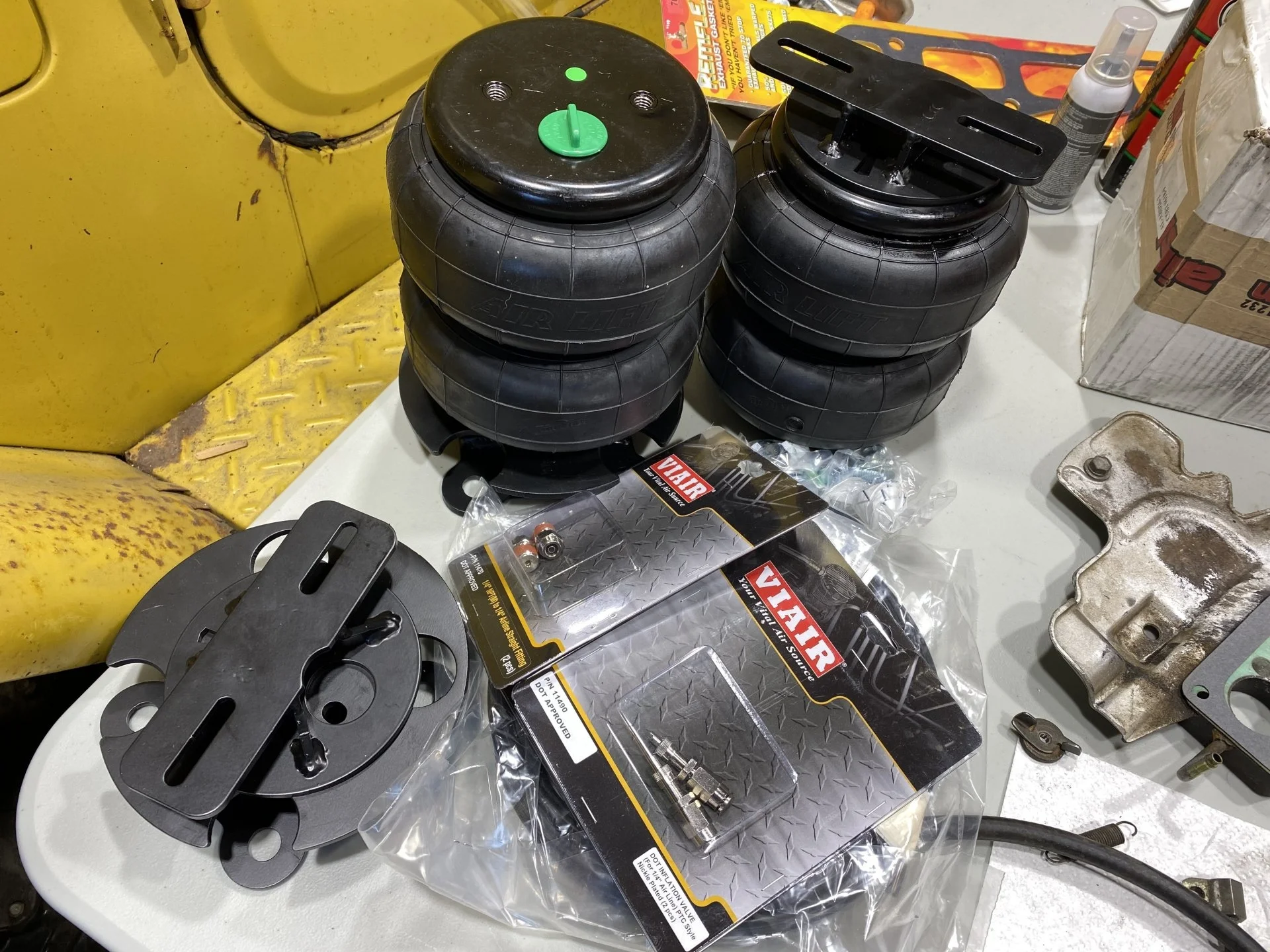

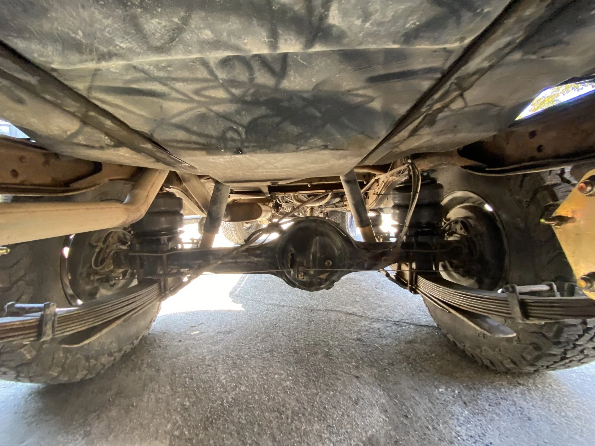

-Dominator airbags installed with 4plus flip kit. (Would be really nice to level the back out finally.

-AA Twin stick kit adjustment

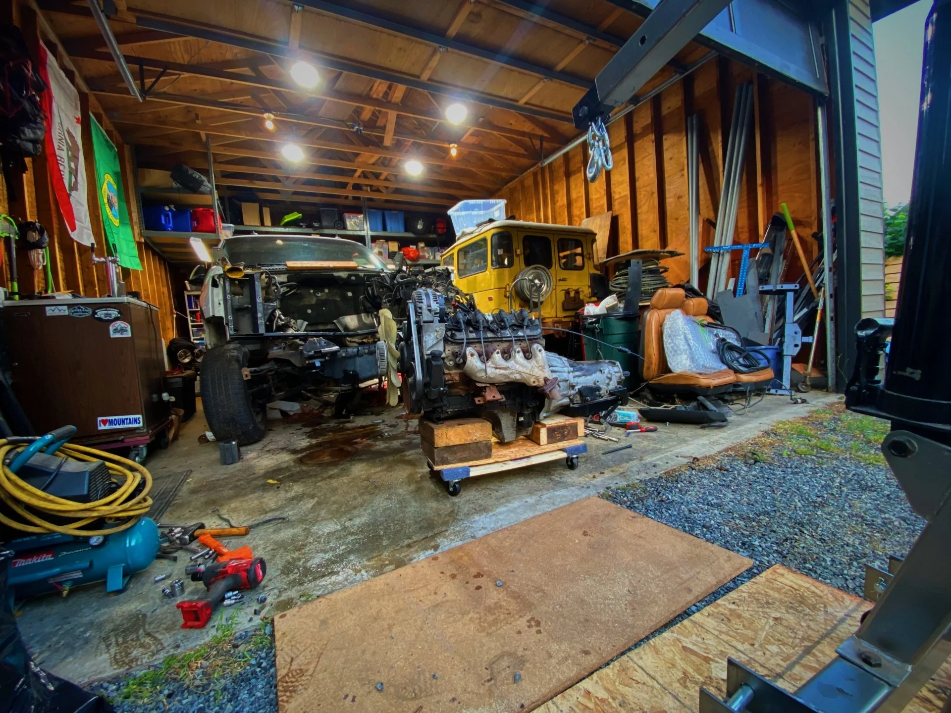

Like a bloated house guest that has over stayed their welcome. This busted burban is outta here.
It is out of the way and we are back to our regularly scheduled program of Landcruisers.
Good work Dave - Can’t wait to see you stab that puppy in!
Did the burb go to the scrap yard?
She needs a date to the dance. Currently out of the shop though. I need to make some calls and see if I can get some rollers for her. The wheels are horrible on her (not tasteful, but in good shape) but could help fund the build a little more.

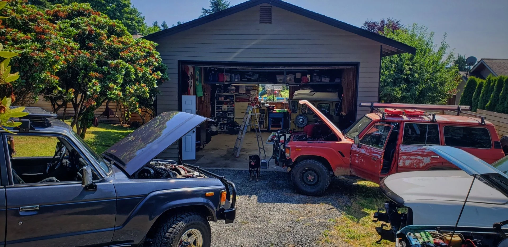

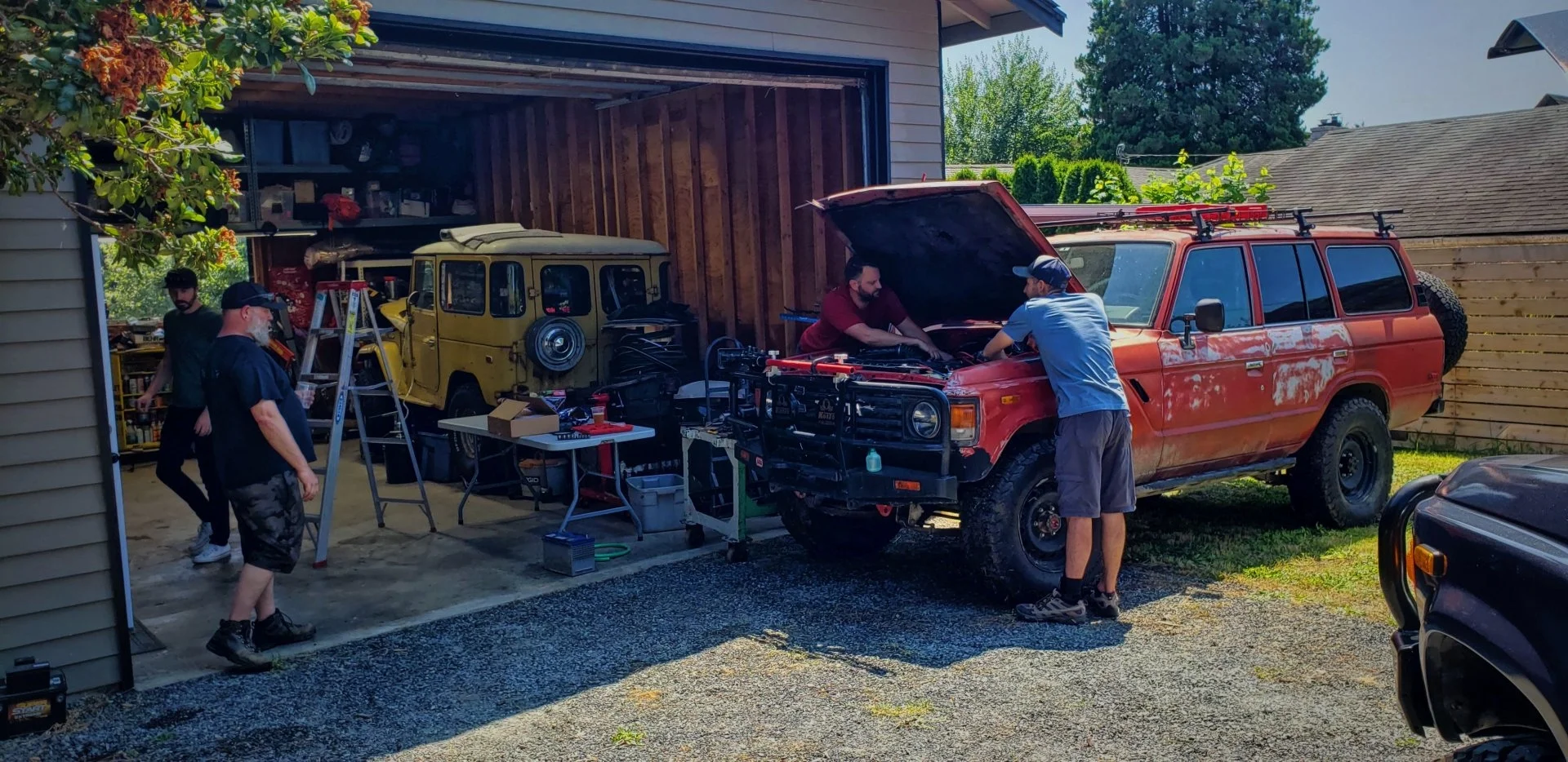

Had a bunch of people smarter than me over to tell me how to do stuff.
Set timing (+7deg), adjusted City racer carb via lean drop (sounded pretty good).
adjusted valves. Picked up 5 m hg of vaccum!
Checked cap & rotor, wires and #4 plug.
Didn’t really make it run better. Will need to mash the pedal to work and the Tuesday Cruiserheads meeting see if he starts to feel loved and run better.
comlression check is next on the list. Speculation is that #4 is low.

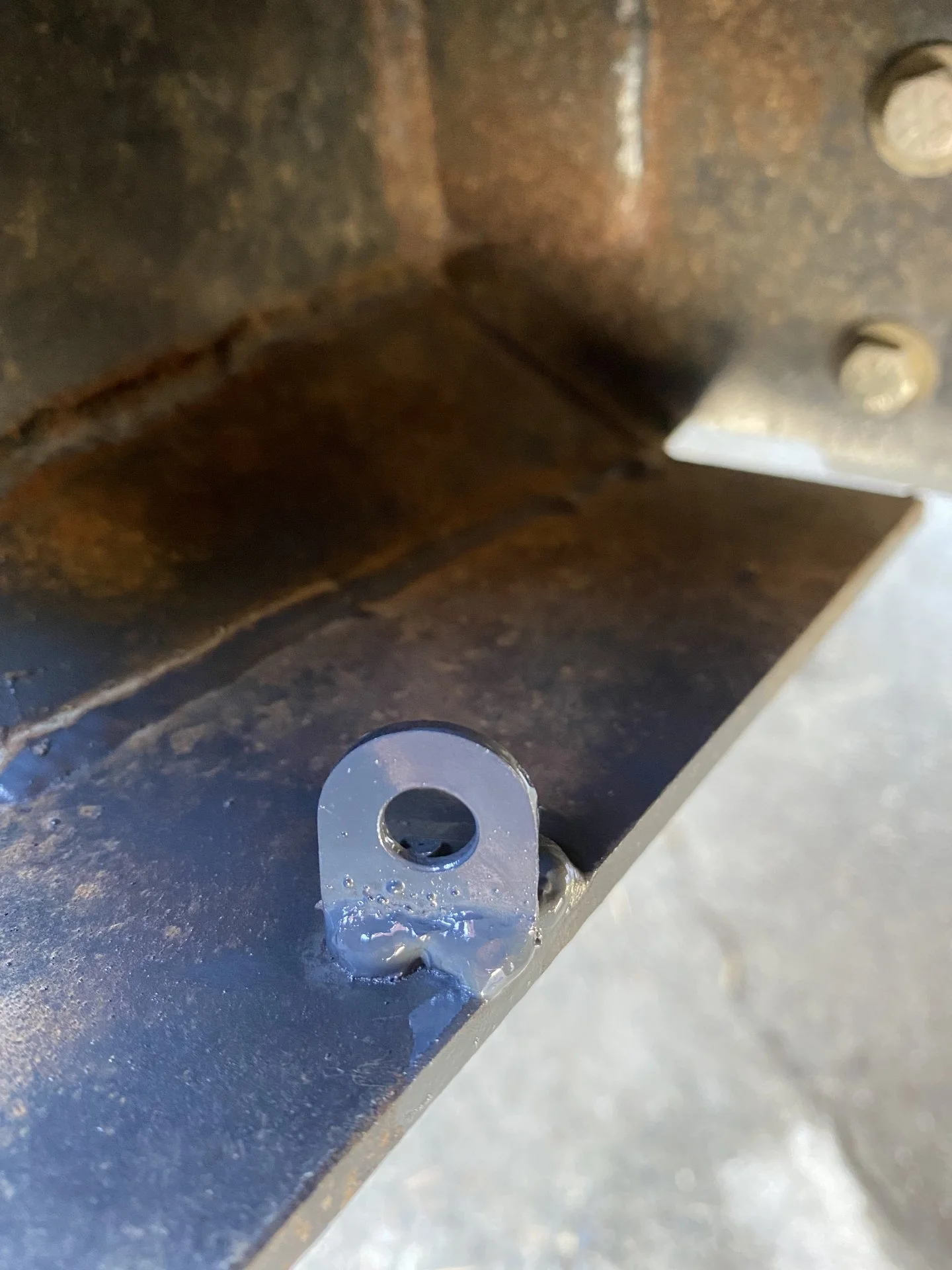

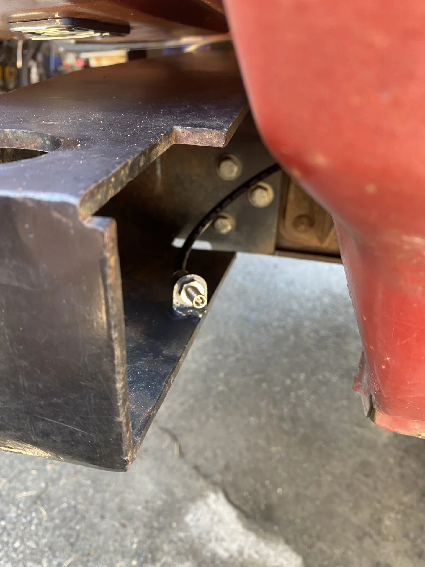

Airbag brackets ready tomorrow. All thenn no other parts are in except the brackets and bags. P
Susspension shackle bolts are in and I’ll work this week on getting those on fronts and rear and post up before/after measurement.
Parts are coming in for a few projects.
Hope to have the airbags wrapped up this week. Brackets for the 4Plus flip kit from Torfab.
Shifter will wait until the LS swap to change up. This is a beefy set-up. Will be glad to get rid of the AA twin stick.
Parts List
Pre Req 4Plus Ubolt Flip kit. (if you don’t have that check out Torfab for stock ubolt kit, also heard great things about SLO Cruisers BOSS airbag set-up.
- Torfab brackets
- Liftmaster D2600 bags
-Viair P/N 11490 1x pair of inflation valves
- Viair P/N 11470 1x pair of 1/4”Npt to 1/4” airline straight fitting
- DOT 1/4” airline. 10ft is likely plenty.
-legumes Brass Pipe fitting hex bushing 1/2” NPT male to 1/4” NPt female adapter pack of 2.
