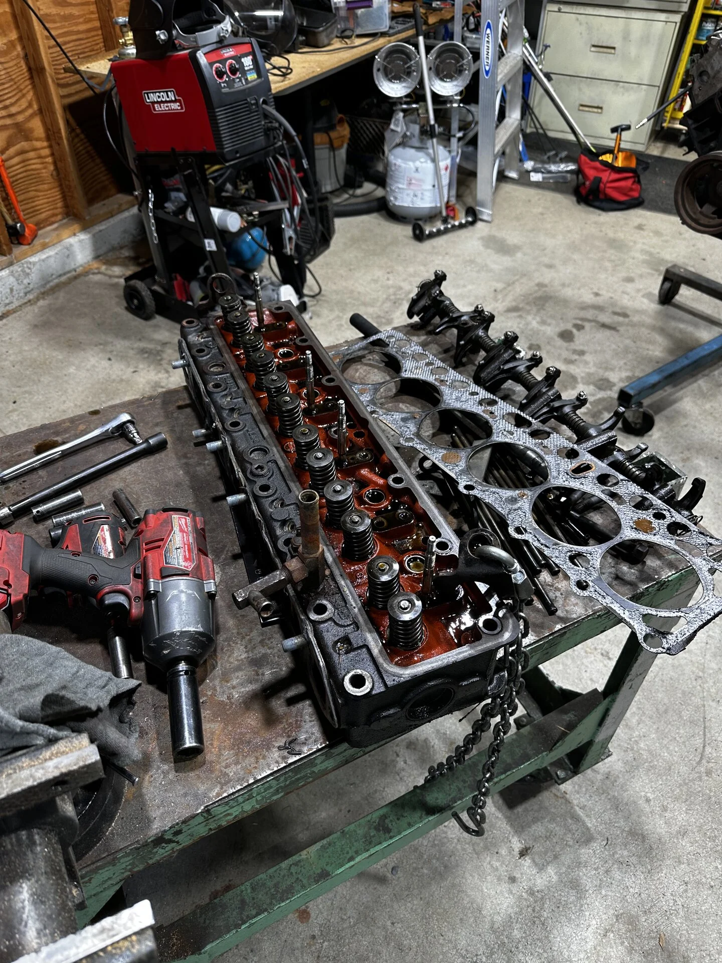

Race to get Fitz a runner has me doing a quick head job.

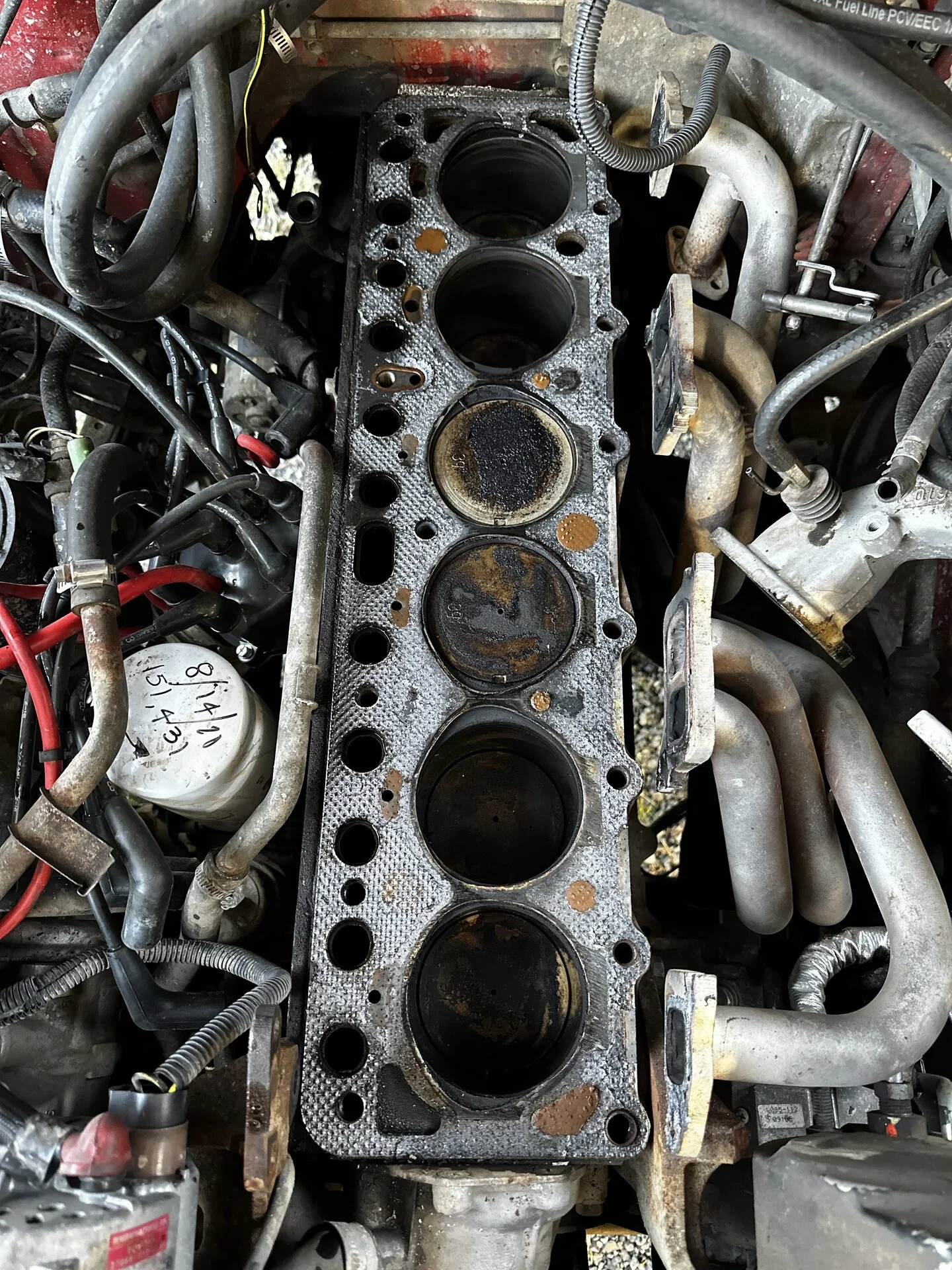

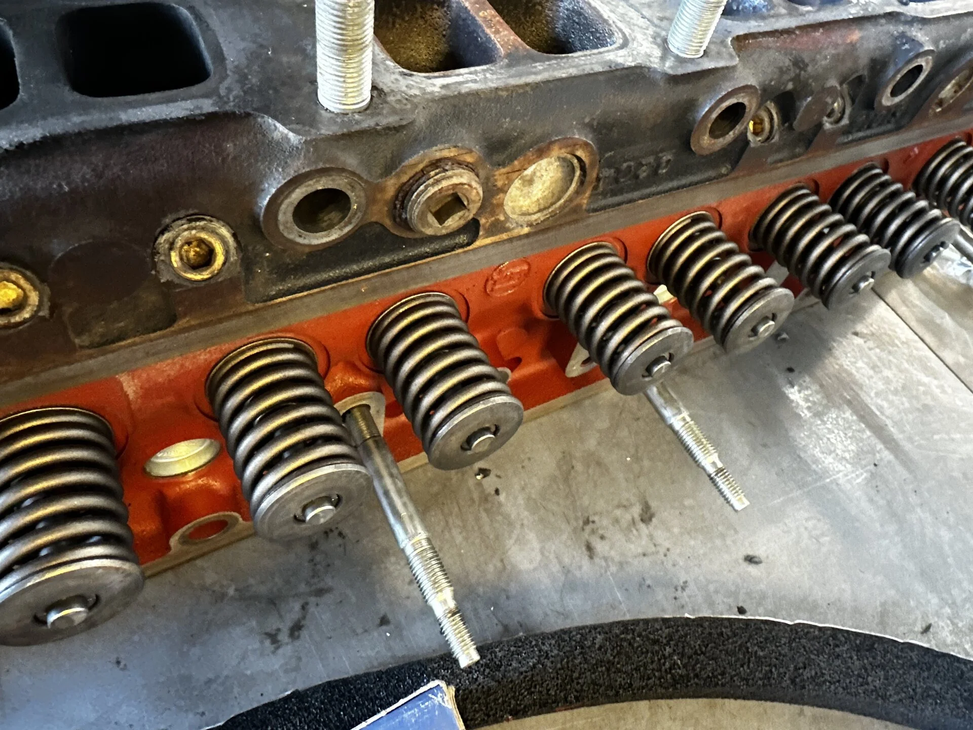

Head off:
Check out #4. Notice the clean piston edges. Steam cleaned by some coolant leakage.
Compression Check on #4 was zero both dry and wet. #4 was pushing into #5

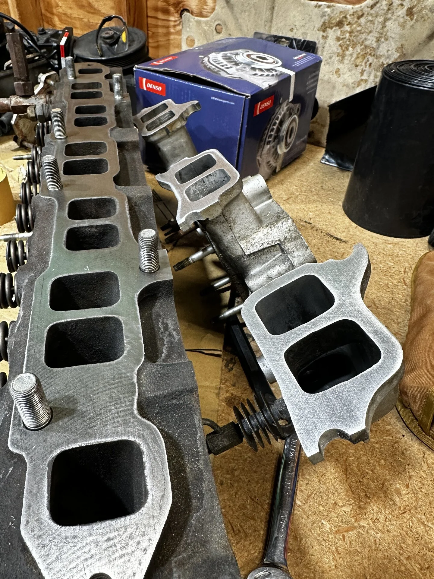

Found out some interesting stuff about this head. Someone spent some money on this before me. Glyptal paint some old school machinist who knew what he was doing and took pride in details was the last one inside it. Covers the cast surface and makes oil return faster. Common on race/hot rod applications. Unnecessary? Yes. Better? Yes.

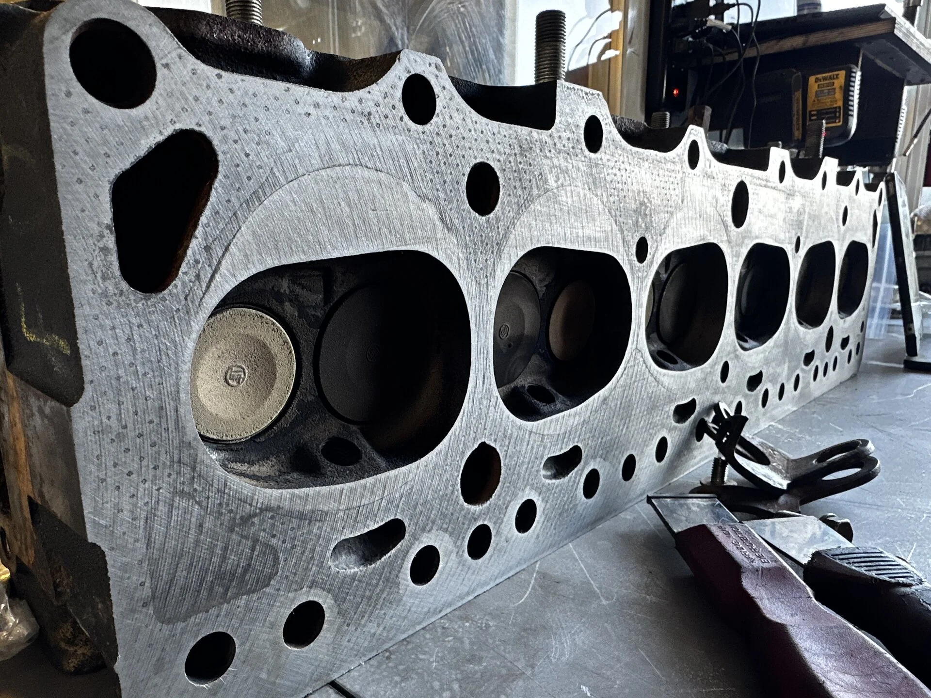

You can also see the machining marks from the previous decking on the bottom of the head.
I bought the truck back in 2010 and the head had supposedly been redone.
The HG appeared to be aftermarket and was likely the cause of the failure on the thinner parts between the cylinders.
New OEM gasket is in and will going in shortly.

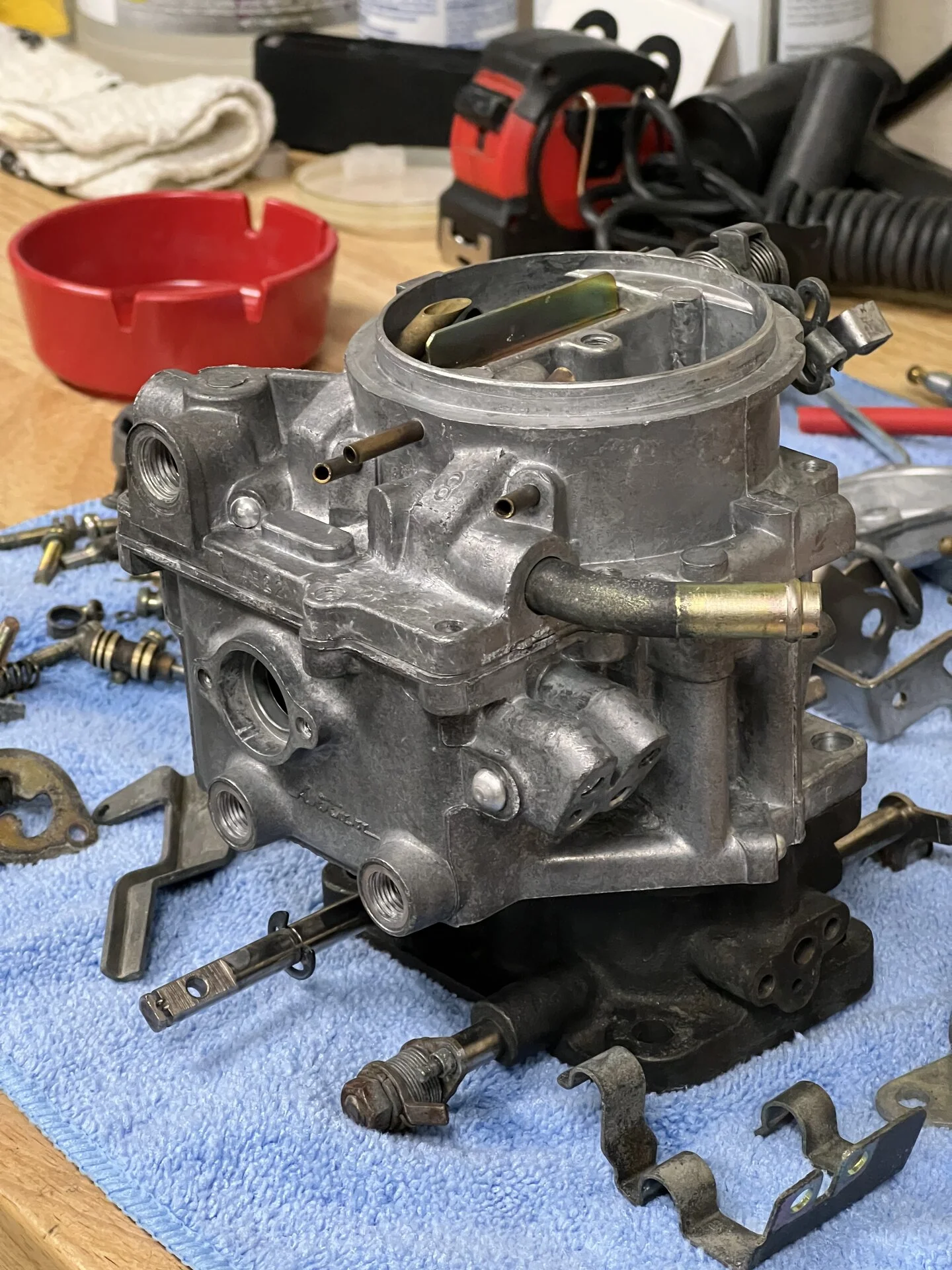

Carb was pulled and sent off to a rebuilder (@mattressking) I’ve been getting a play by play on the rebuild.
How can you you not get excited when you are getting photos like this.

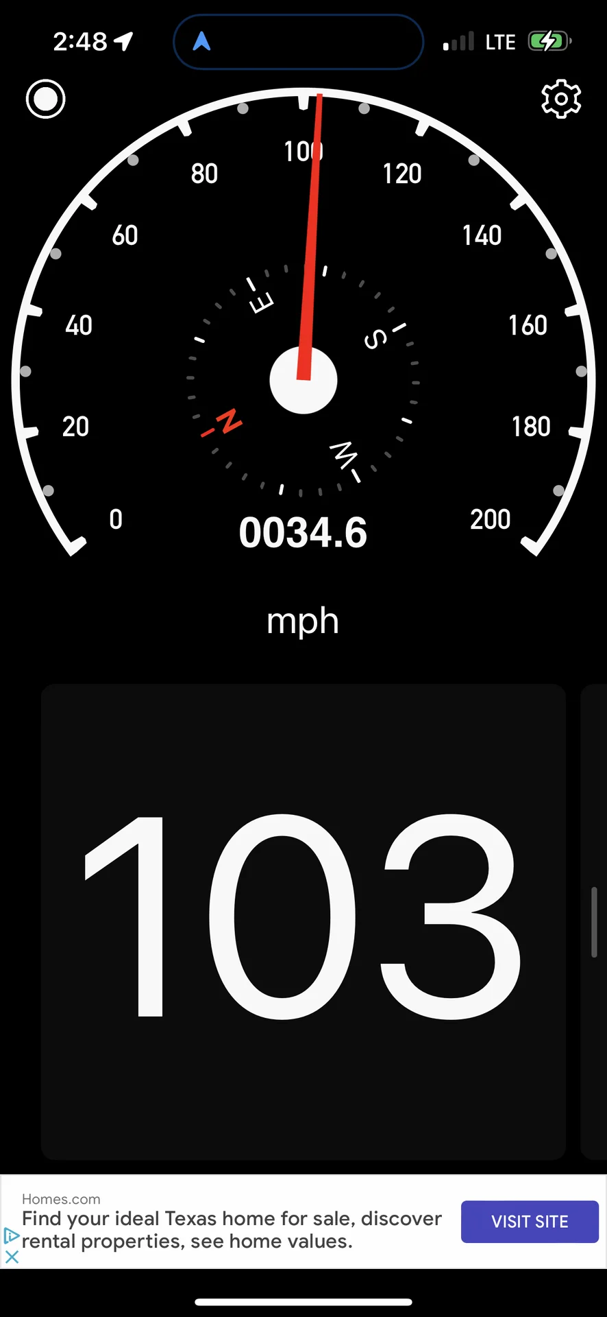

New top score: down hill might have had a tailwind. Lifted because I was scared at that point. Less by the handling and more the noise from the exhaust/engine compartment.
This was probably 3500 rpm in 5th gear.
I think the carb work that @mattressking did probably helped as well. Hit him up for any carb rebuild needs. The dude is the real deal and pretty nerdy about getting them right.
@mattressking : uh.. you know you have non correct hardware on your carb right? Does that bug you?
