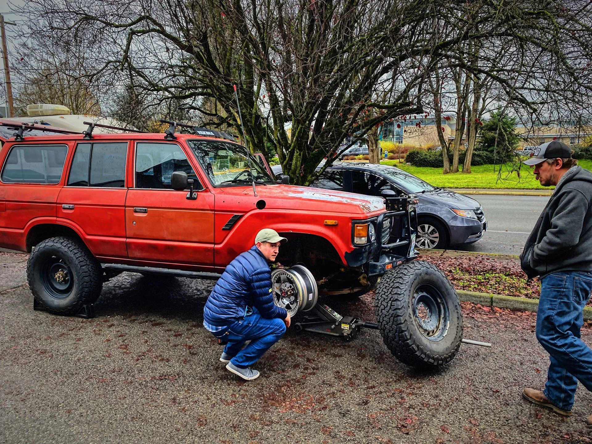

Hooked up with @RudigarP today for test fitting some bling over the tundra brakes on my rig. (There was a jack stand under the slider blocked in the photo, and yes Jason on the right is practicing his Moon Walk)
He has these 16x8 5.5BS and they cleared the tundra calipers.

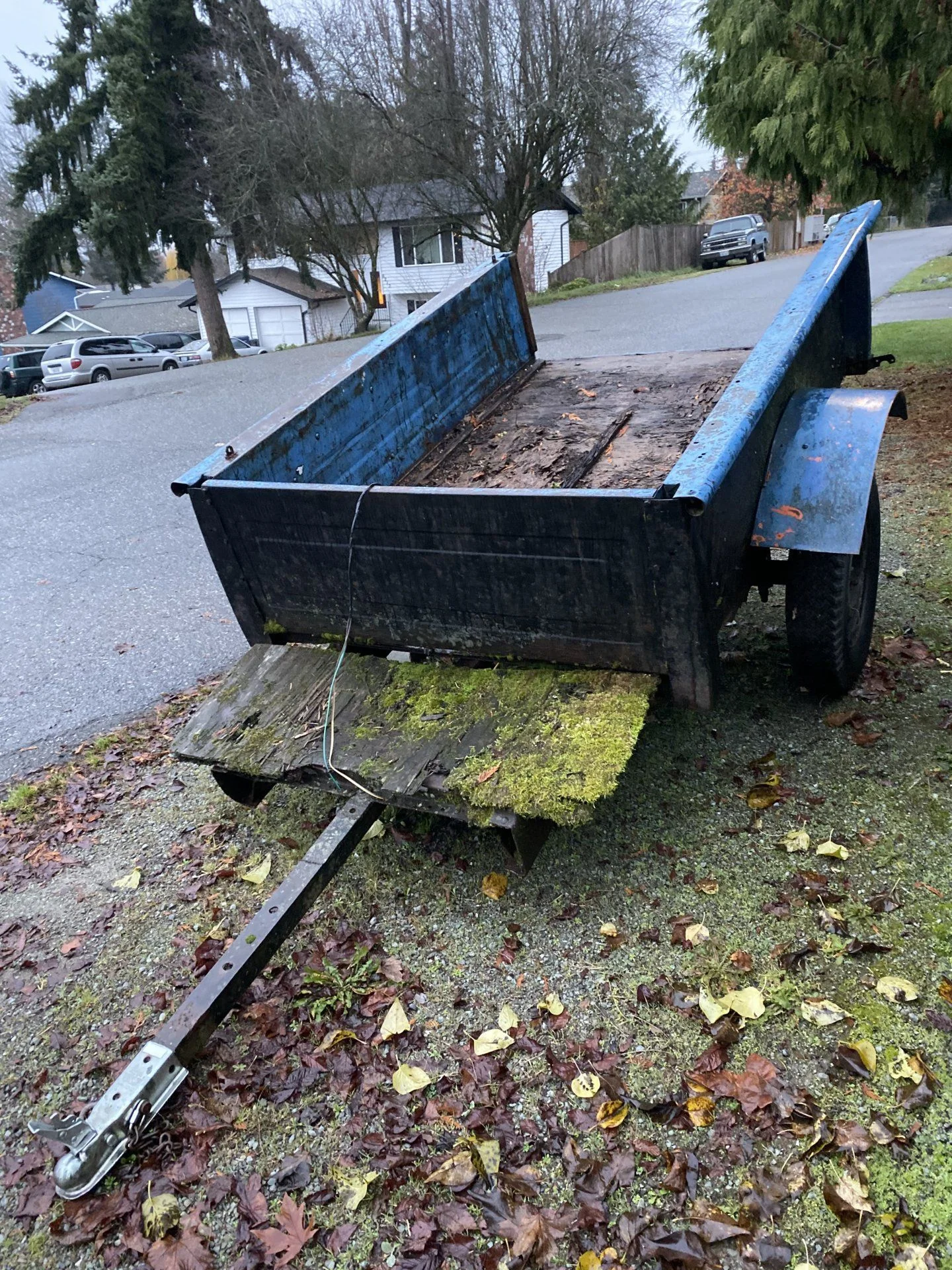

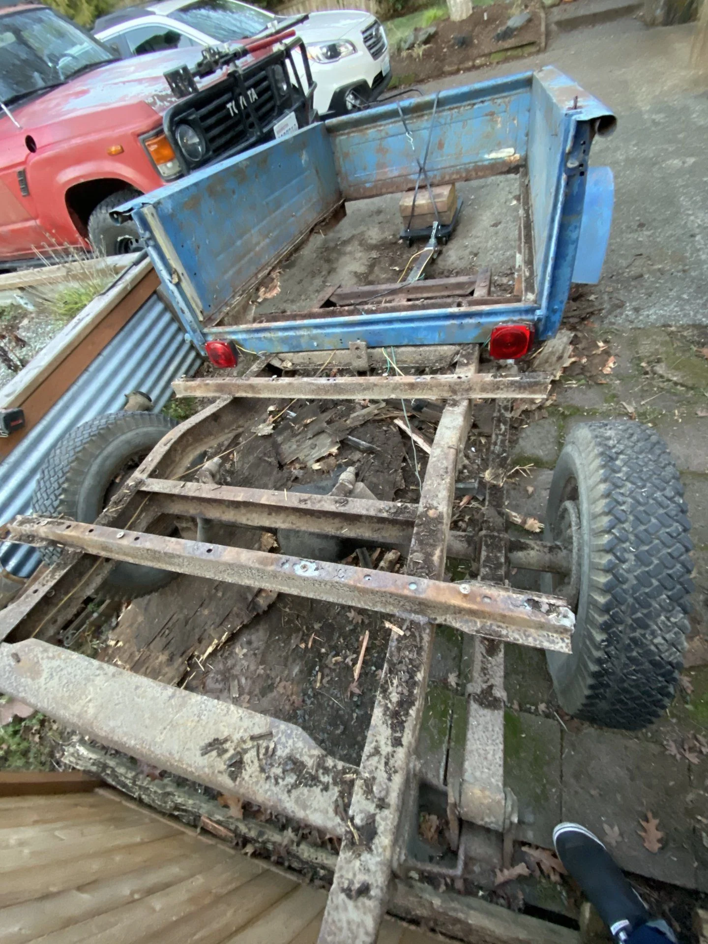

Spent a little time tearing out the rotting boards today.
Smashed up the floor and then pulled the bed. Hind sight being 20/20 it would have been better to pull the bed then tear off the plywood bottom.

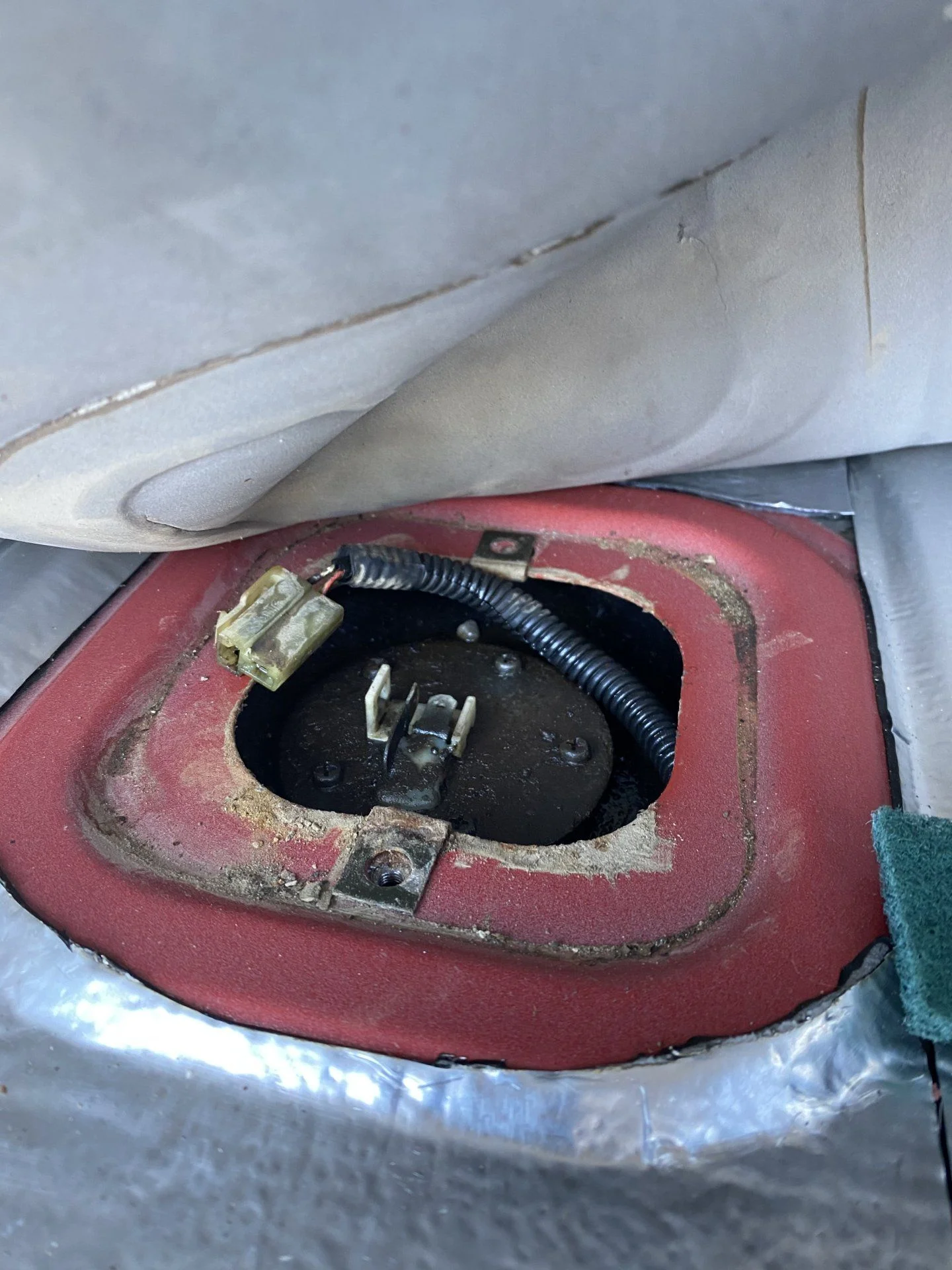

Back in 2018 on the way to SAS2 “I can’t be out of fuel we have only driven 180 miles.” Well at 80 mph you get lower mpg’s”

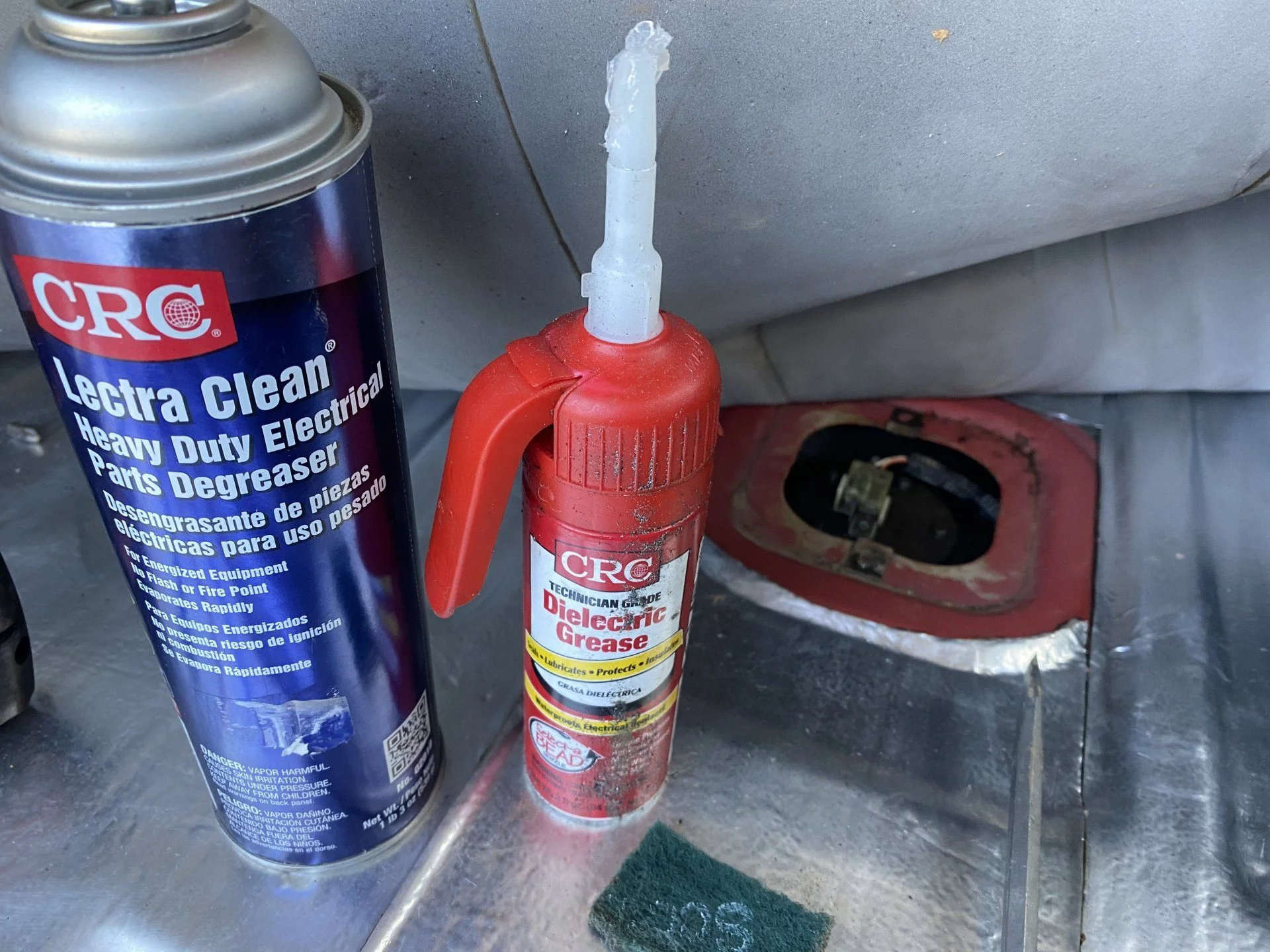

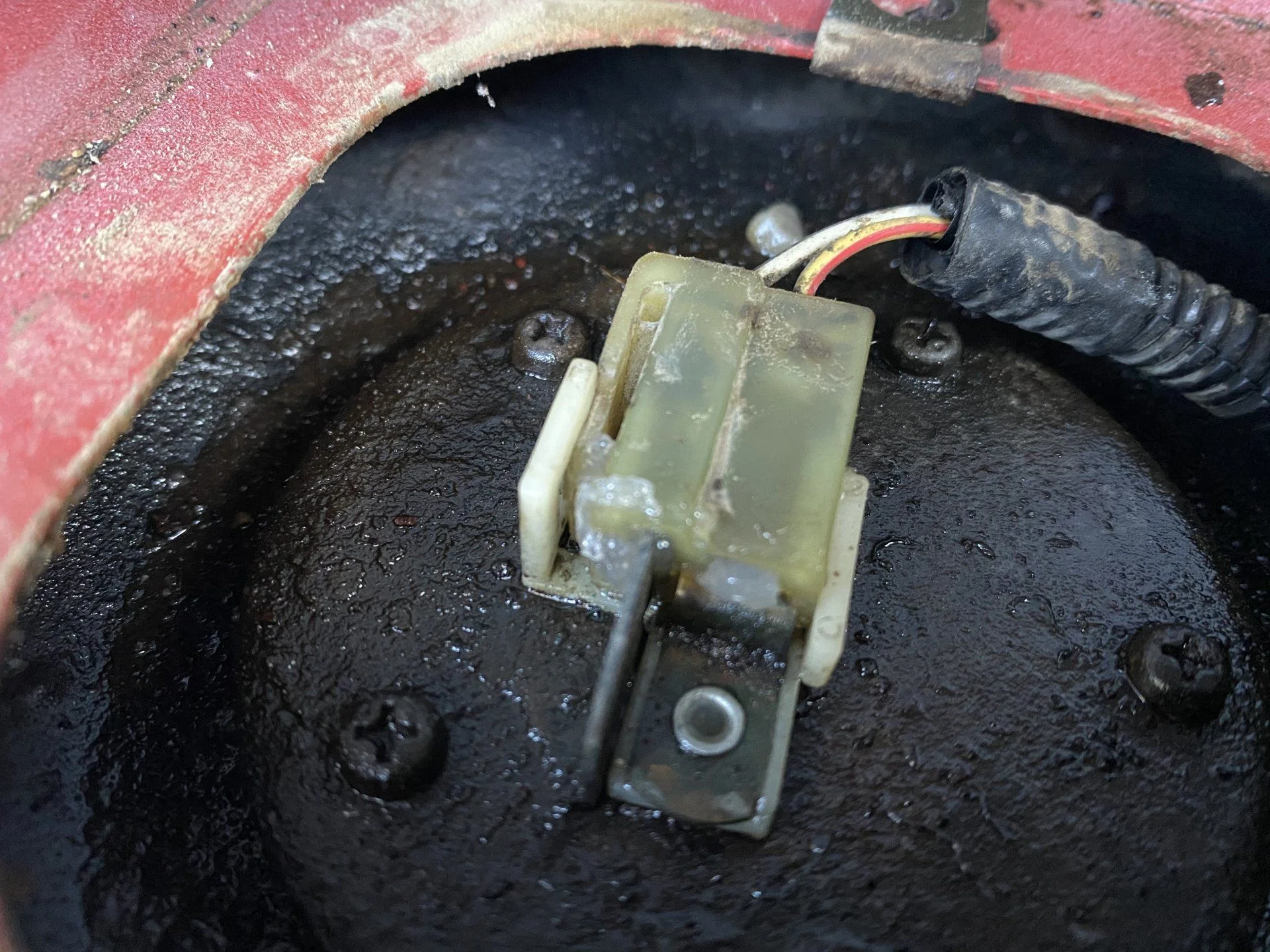

This wasn’t the only time that happened. So I dug into the fuel sender connection.
Simple fixes... should have done that 2 years ago.

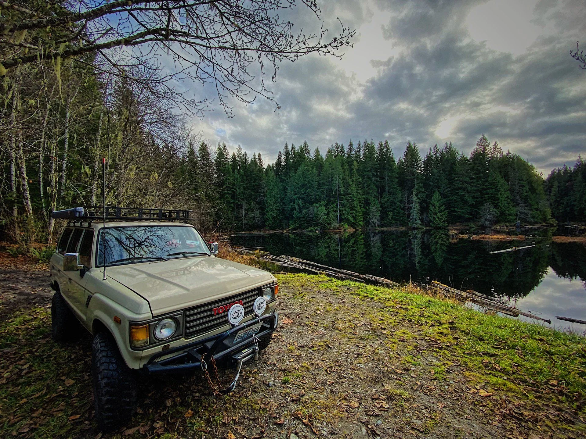

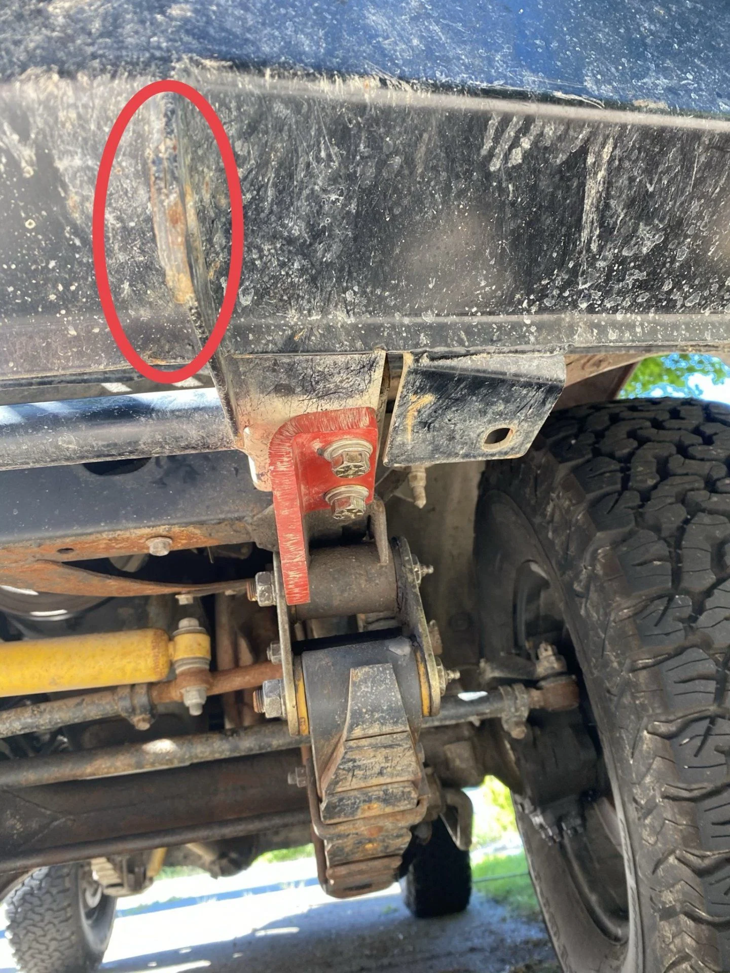

Old ARB style bumper has a little tie down point on the front (Red circle).I have used these once as a recovery point and have been carrying around a set of Trail Tailor recovery points for a while (since the rear bumper went on last summer) moved them up to the front under the ARB and now have soo.. many choices on where to clip stuff I’m over the moon.

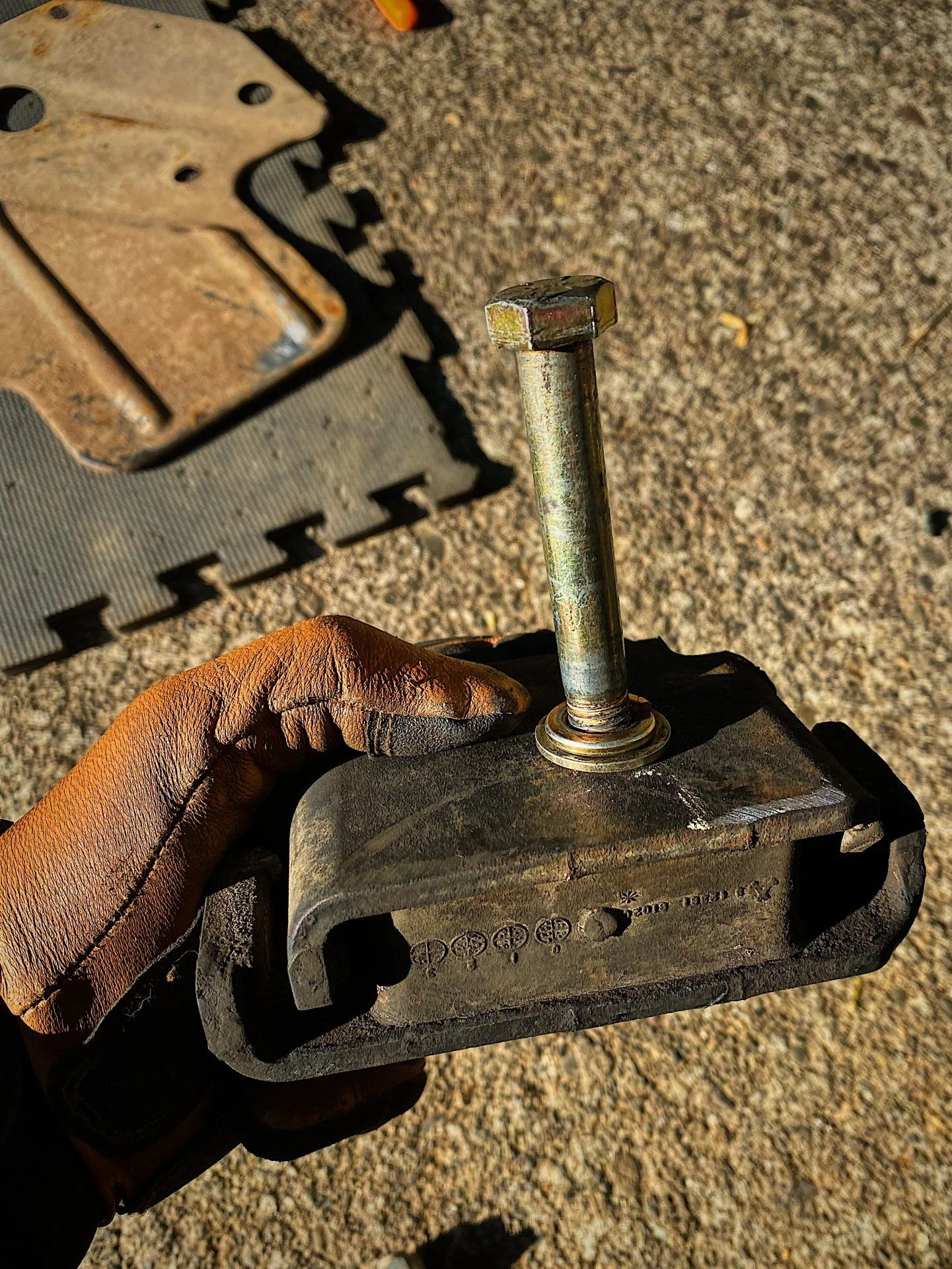

Broken motor mount? Not any more. Through bolting the DS (still chained up from last years SAS3) will prevent the mount from tearing due to the 3:1 Lo range and h55 1st.
Should be able to dump the clutch like a ninja now.
