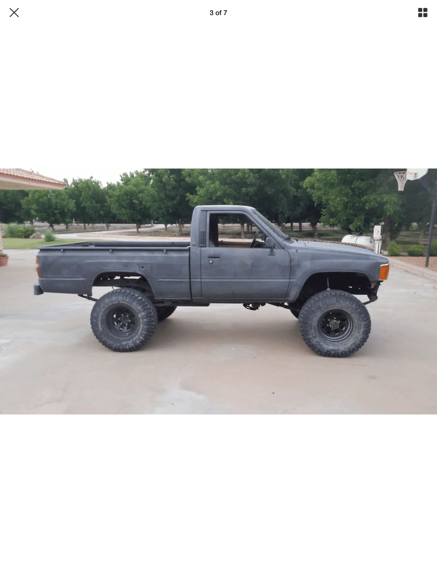

First off road Build 1985 Pickup. Advice/pointers appreciated.

I’ve had this truck for a few years now. I may have put 3k on it. Maybe. Anyway I’ve acquired some parts to get started but I’m putting things off until I figure out/ decide for springs etc. I’m not really sure what the previous owner had done. I know there is some sort of lift on it. There are 3” blocks in the rear which I’d like to eliminate. I have a marlin high steer setup I’d like to install but I know there’s a minimum lift required. On that note I would prefer the truck to sit as low as possible. Any advice is appreciated. I do have some parts already but am on a kinda tight budget. Thanks
