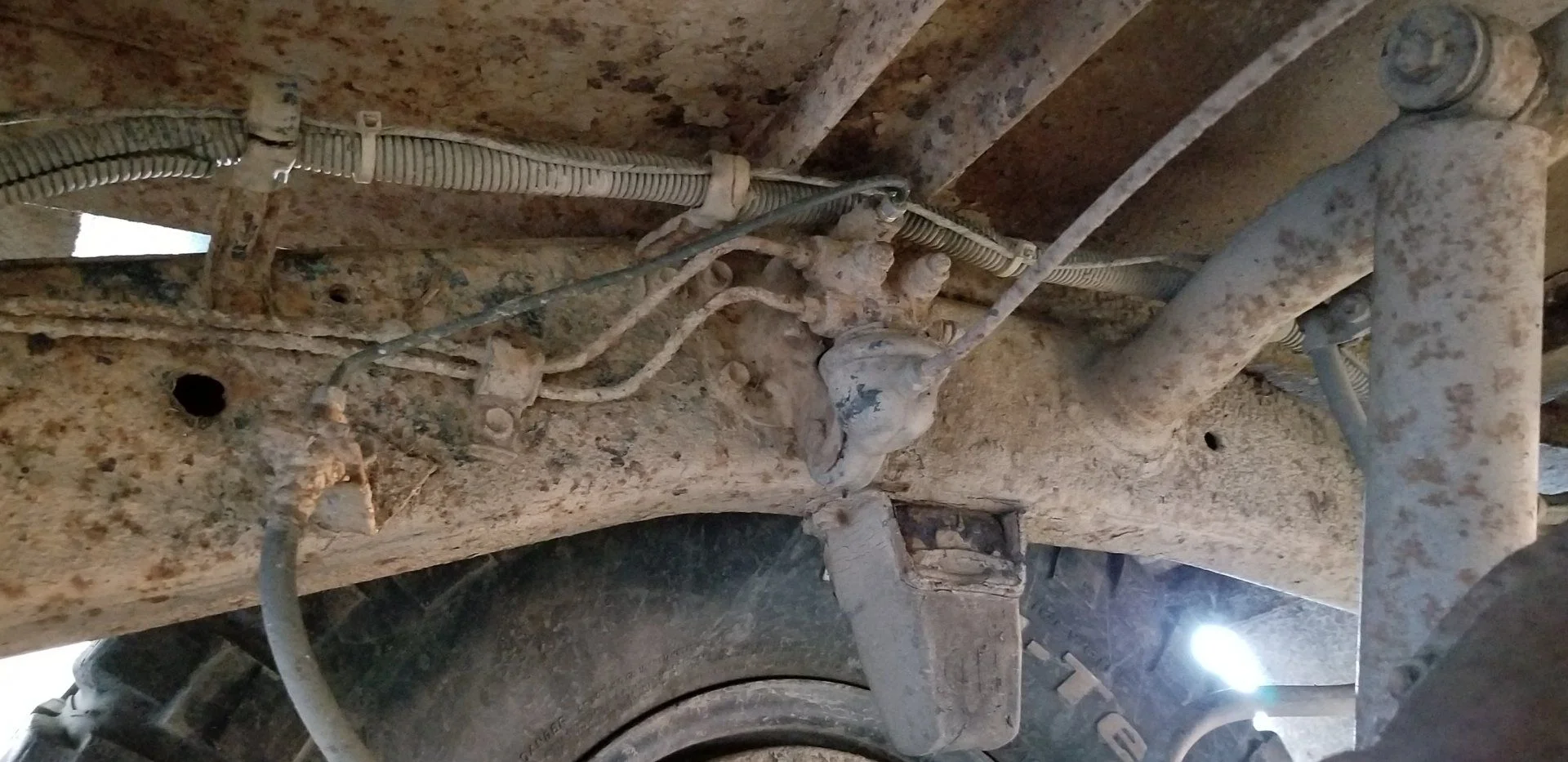

Last question is, the rear locker. I was told when I bought the truck that it came with a rear locker. I wasn't able to test it, nor see a switch or lever for it. I crawled under the truck and saw steel line (Hydraulic?) coming off either a splitter or booster attached to the frame (two lines in, one to the brake and one to the piece on the axle). the piece on the axle looks similar to the diff lock actuator in the diagrams I've seen. So! That seems pretty obvious that it's the locker. I chased the two lines back up the frame and lost track of them when it got to near the transfer case by the right front wheel. After that, it's a total junk show.
Is there supposed to be a switch or lever inside the cab for the locker?

For those interested, here are the pictures of what I had asked about for the diff
That's the load proportioning sensing valve for the rear brakes. The steel line is the spring for the load sensing valve. They have nothing to do with a locker.
Your locker, if it has one, is probably the non selectable type that senses spin and activates. The best way to test this is in soft dirt by getting it partially bogged and see if you can make both wheels spin.
