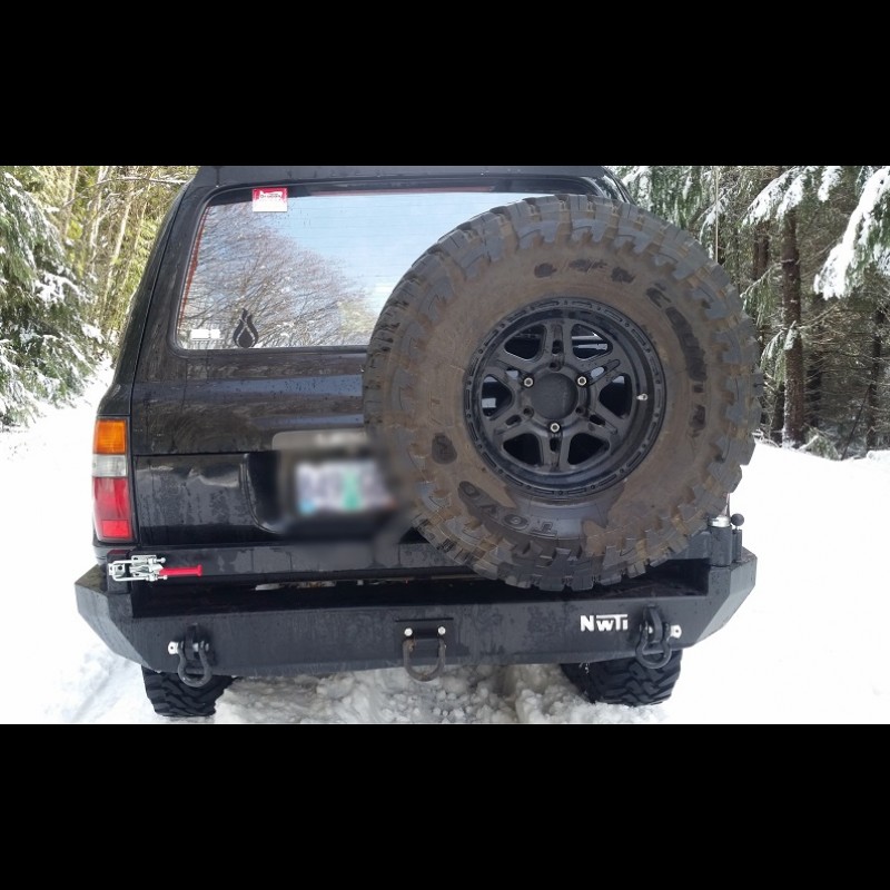

Finally got a rear end with a DIY NWTI Rear Bumper
I would like to see a pic o two with the swing-out attached.
Overall with/without the swingout, how much does this weigh?
I am SLOWLY designing my own and it is looking to be similar in construction because I have no desire to cut my frame.

I will get back to you on the swingout. It is heavy maybe 50 lbs?? Just a guess, I lift so much heavy crap. I want a pic of it as well with it on. The bumper is super beefy though, Mrs CY and I did it and used a jack to support it. guessing 150 sans swingout??
OK Thanks! That's definitely a heavy one! Looks like the recovery points are 3/4" and maybe are bolted directly to the frame members? Those would make it really heavy, even if the rest of it were only made of 7 Ga.
My first round design on a front bumper made it well over 400 LB, so I have had to back way out of that and do some serious redesign.

WOW. 400LBS!?!?!?! Are you building a tank? Seriously, that's crazy. I can lift this up solo but not so much when fine-tuning it, hence the jack and wife. But 400lbs, ya, that would be a doozy. And dont forget that you have to add a winch at 100 lbs. It seems that at that weight you'd go through front end parts pretty quickly.
I appreciate the pics and info on the bumper. I have been trying to decide if I wanted to do the NWTI for some time....but I don't know how to weld, so I would be at the mercy of finding a reputable welder that won't break the bank.

After searching a long time for a rear bumper that did not require cutting off the rear cross member, I finally have one. I wanted to keep my OEM tow hitch and this allows me to do so. This thing is super stout. I have the rear swing out in the shop, but I wanted it to be removable because I open the back a lot and it's a pain, so this allows me to put it on as needed. The shackles are nice too. I am not a fan of the NWTI cutout but oh well.
I did have to cut about an inch off my tailpipe, but I don't smell exhaust. The aluminum step gets removed too.
It's a DIY bumper kit, i think it is $440 and the swing out is $375.

The shackle hangers integrated into the bumper mounts are 5/8"

Is the swing-out easily taken off and put back on? I would love to see pics of the swing-out on there as well if available. Thanks!
