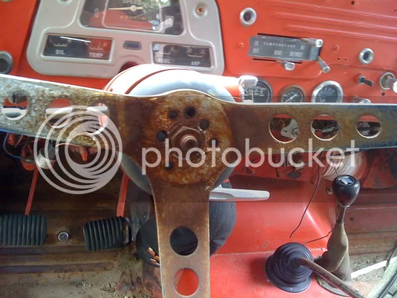

Okay guys. My 40 has a tilt wheel retrofitted to it. Well it has developed a problem. The steering wheel is no longer mechanically attached to the column.
The nut in the middle of the steering wheel is all that is keeping me steerable.
If I can figure out what the steering column came out of, I will simply replace the steering wheel properly. If not, I'm going to have to scour junk yards and hope to get lucky.

GM column (looks like it's from a pickup).. And see those bolt holes around the big nut. They should have bolts in them..
BTW, there is a steering wheel adapter under the black cup looking thingie.
Hmm....when I took the horn cover off to fix the horn there were no bolts in the holes. I'll check it out.
Okay I checked it out.....I see how it works now. I now have to figure out the correct threads for the adapter since there are not any bolts in there now.
I can't see the pics from work, but the two bolts to either side of the big nut are to install a puller. They do not have bolts in them. They might be utilized by your adapter. They are not used in the stock configuration.

EDIT: To answer your questions. The wheel doesn't move up and down in the column. The column seems fine, it is just the wheel and the connection.
IIRC fine thread 3/8" bolts
They thread into the adapter.

Gumby, it is a standard Grant style steering hub adapter.
