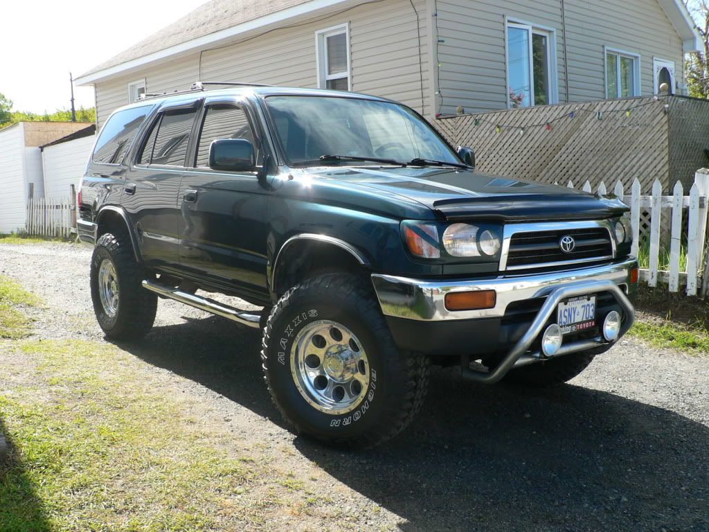

Shortly after, I ended up doing a budget lift from Toytec, which gave me about a 3" lift in the front, and 3" in the back. The lift consisted of Front Spacers, a Differential Drop, and some Old Man Emu 890 coils for the rear. I later added some Skyjacker shocks, as my stockers were toast.
A couple of weeks later, I got some 33" Maxxis Bighorn MT's and some Procomp Wheels with a 4.5" backspace.

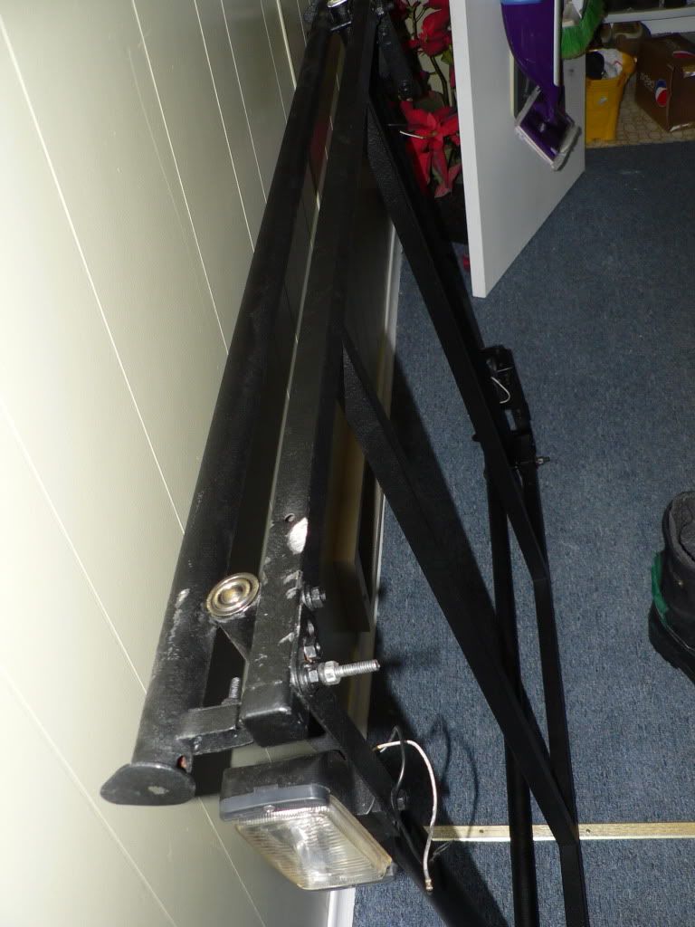

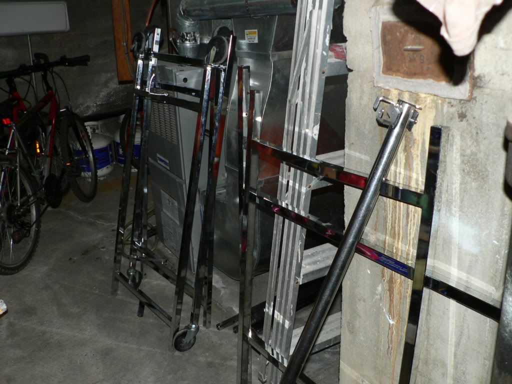

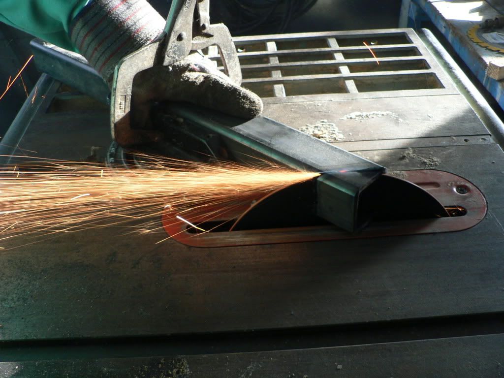

Then out of boredom, I decided to try and fab up a roof rack. I started out with Recycled Clothing racks from the Superstore.
I ended up bolting it all together:
After some trial and error, and a couple of cans of Rubber Guard, I bought some lights and wammo!

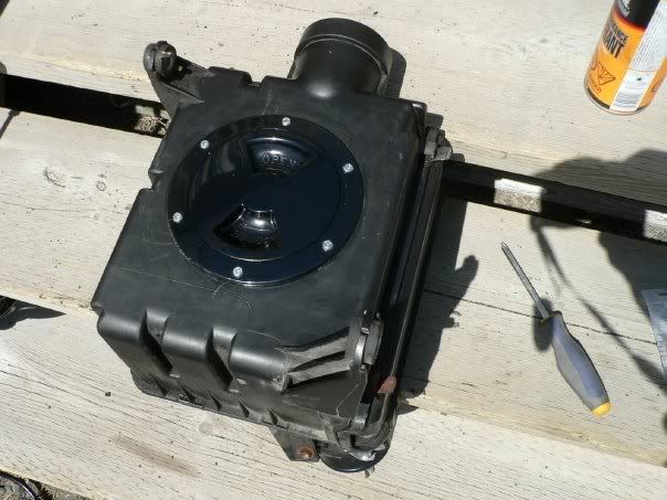

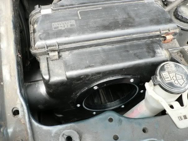

One of my other mods was the Deckplate Modification:
This allows more airflow into the airbox, and gives the intake a little more of a throaty sound.

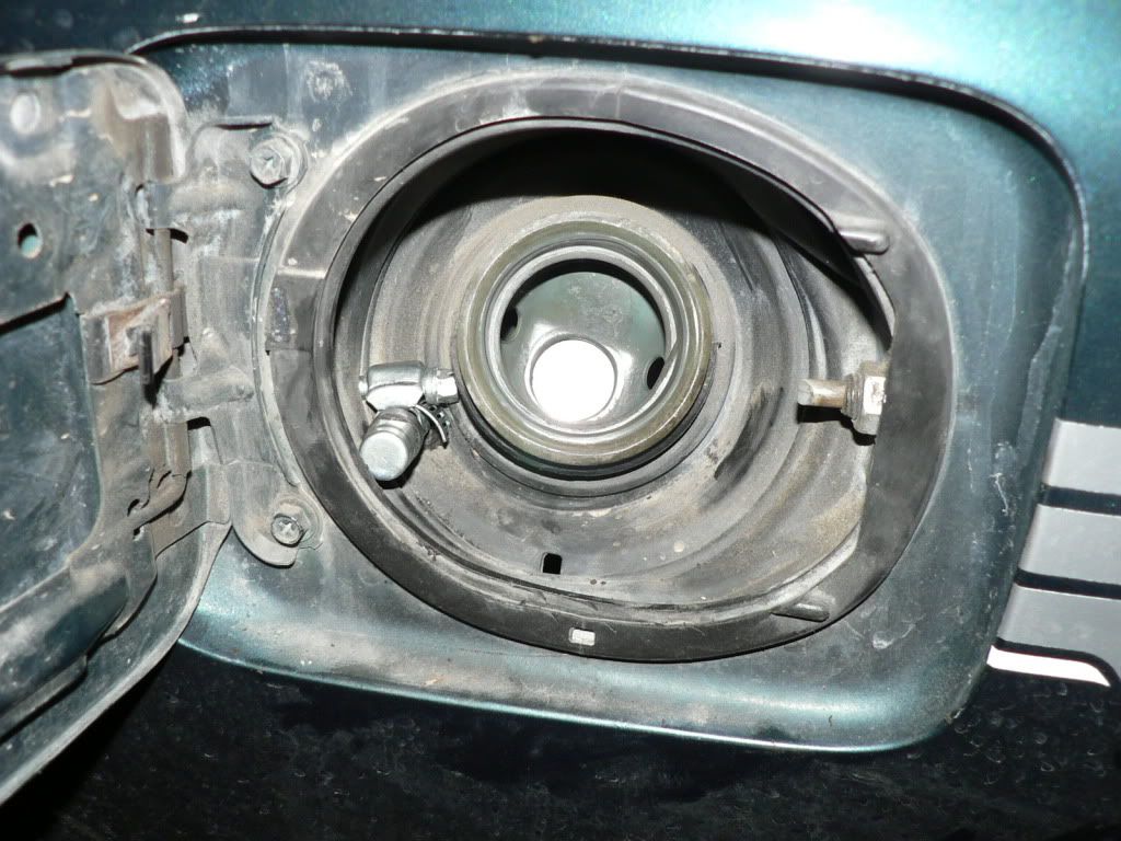

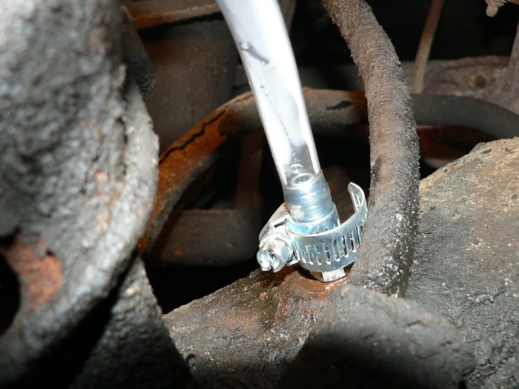

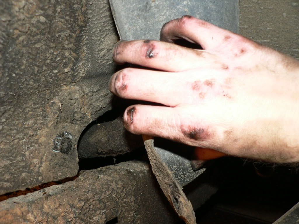

So this is a mod I've been procrastinating to do. But is a must do if you drive a Toyota and don't like to replace axle seals or rear brakes! (gear oil contaminates the shoes) Today, while waiting for paint to dry, I decided to go ahead an get -R- dun!
First, I had to locate the original diff breather:
Once I loosened it off with some WD40 and a ratchet Wrench, I removed the old breather and then installed the Union fitting:
Once I was done with that, I moved on top by the Gas filler neck. I drilled a hole through the rubber gasket using my biggest bit and a drill. Once that was done, I fished some Fuel Line hose through the hole. I noticed that I couldn't find the other end of the hose, so I removed the Gas filler neck shield inside the inner fender, located the end of the hose, and then fished it through along with the gas filler neck.
Then I ran the fuel line to the Union fitting and secured it with a hose clamp. I then zip tied the fuel line to the Gas Filler neck, but leaving some slack to permit articulation:
Once I was done below, I moved back on top, and added the new breather plug. I used another hose clamp to secure the fuel line it, and then tucked it in.
Overall, it didn't take me much time to complete this mod. The only trouble I really had, was washing all the grease from under my truck off my hands!

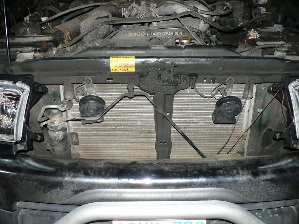

I just remembered I upgraded my horns last year! If you drive a 4Runner, you know why this is a must do mod! Mine sounded like the RoadRunner! HA HA HA! I got mine from Princess Auto, it's like a Tractor supply store....with all kinds of stuff for sale!
This pic, is for demonstration purposes only, It's got the low tone horn pictured, I used 2 high tone horns.
[/quote]
I snapped these pics when I did my headlight conversion
I ended up getting 2 high pitch horns though, but still better than the stock setup!

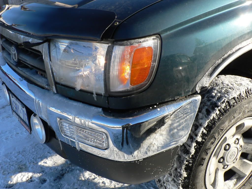

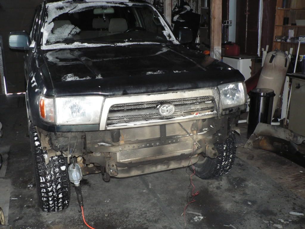

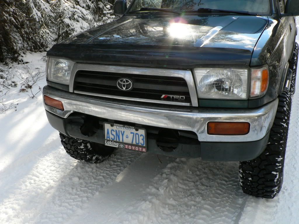

Well, today I decided to brave the cold (-25 Celsius with the windchill) and get working on my truck!
First, I had to survey the damage on my front end from my last little outing in November. This happened while I was crossing a frozen stream with the truck:
Enough with the bad memories :'( , I had to get started by removing my front bumper. (Thanks to the Tutorial and Documentation Reference Sticky on T4R.org, it was a breeze!)
Now sorry for the teaser pic, but I only removed the bumper that day. I had to see if I needed other parts, like the bumper brackets, or what have you....but I lucked out! Looks like all I really need to buy is the Chrome piece...should be under $200.00 for a brand new after market piece! Other than some new bolts, I should be good to go! I ordered the bumper piece on Tuesday, and it should have been in within a couple of days after that!

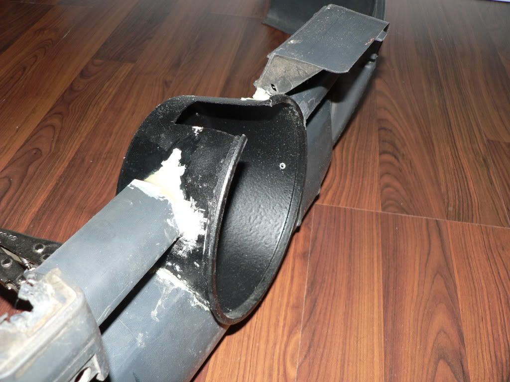

So, I got the bumper home, bought some Plasti-dip ($15.00 a can here!), and started patching the valance with the epoxy and some mesh.
Here's the valance mocked up with the margerine container light pods I made in November!
Last fall, I used silicone to glue the light pods into the valance. This time, I'm using 2 part Epoxy, and some mesh to make it stronger. Once it's all filled in, I sanded it down, and then painted it with the Plasti-dip.
Here's a pic mid-way into the Epoxy stage:
Ok, so I worked on restructuring the valance, making it solid again, and properly grafting the light pods in. After using the mesh and Epoxy, I took out the Dremel, and a sanding bit, and got to work on cleaning up the rough edges. I then used a sand paper to soften the sanding bit marks.

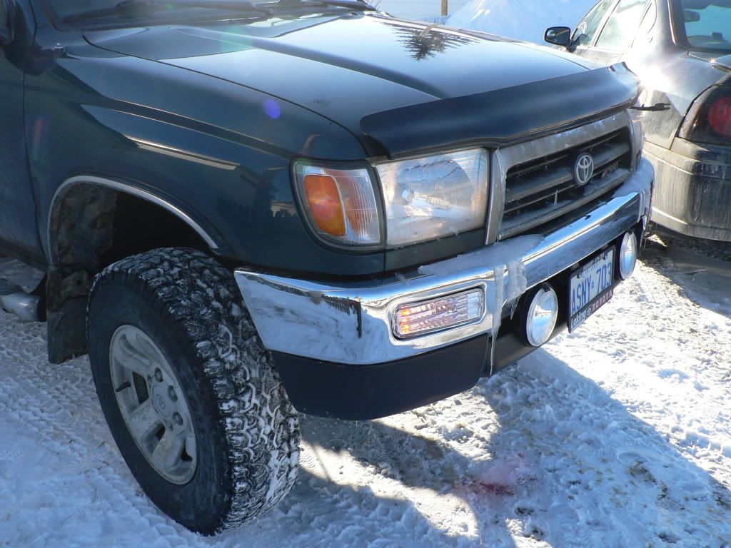

Here's a pic of the valance on the New Chrome Bumper:

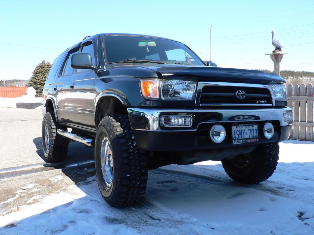

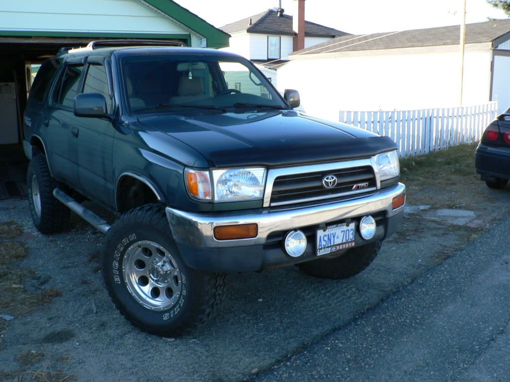

Here's a pic of the entire assembly with the new bumper lights and the driving lights:
Turned out alright.....next was to mount it on the truck, and aim the driving lights!
So, I got the bumper on the truck! However, it seems that my passenger side bumper bracket did get tweeked by the accident! The pictures don't really show it, but the passenger side gap, between the bumper and the lower fender edge, is about an inch and a half and the driver side is only half an inch!
(don't mind the 245's, these are my winter set!)
I was able to straighten things out! All I did was remove the nuts on the passenger side, add some washers to space out the top stud from the bracket, and re-torque the nuts! All is level now!
I'd also been working on revising my roof rack this winter. I'd decided to take some of the advice I've been getting, and cut off the ends of the lateral bars from the roof rack. This will make the rack look more square, instead of having the cross bars hanging half a foot on each side of the truck.
I started out by grinding off the ends of the cross bars:
I wanted to have something to cap off the ends of the tubing. So, I got creative, ha ha ha, and used some recycled cabinet nobs, to cap the tubing!
My next step will be to rubber guard the caps, and then maybe plasti-dip the whole rack!

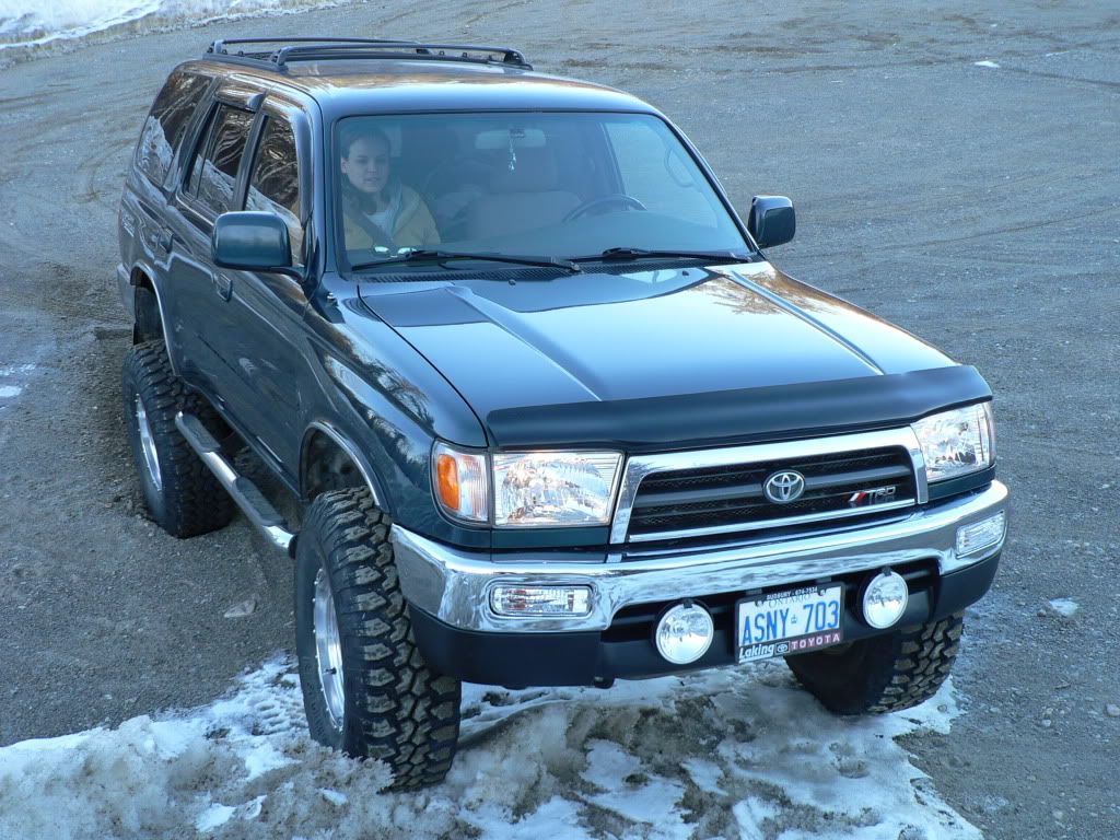

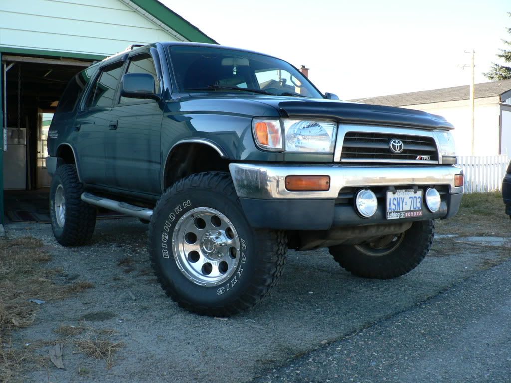

So, I couldn't wait for Spring weather to get here, and decided to put my mud tires back on! I'll just drive the truck on days where the roads are not invaded with salt!
Gonna polish up the wheels today, and post an updated pic of the truck....ALL CLEANED UP!
So, after a couple of hours of work, Mean Green had it's Mud Tires and Alloys back on!
Here's a before shot in my driveway:
Mickey Thompson Baja ATZ 245/75/16's
Here's the after shot in my driveway:
Maxxis Bighorn MT's 285/70/16's
It's hard to see, but the wheel on the left is polished the one on the right, is simply cleaned:
I used the Mother's Power Ball with some "Autosol" metal polish to get the wheels back to their original luster.
Pic of my daughter standing next to the Bighorns:
Here's some other shots for good measure:

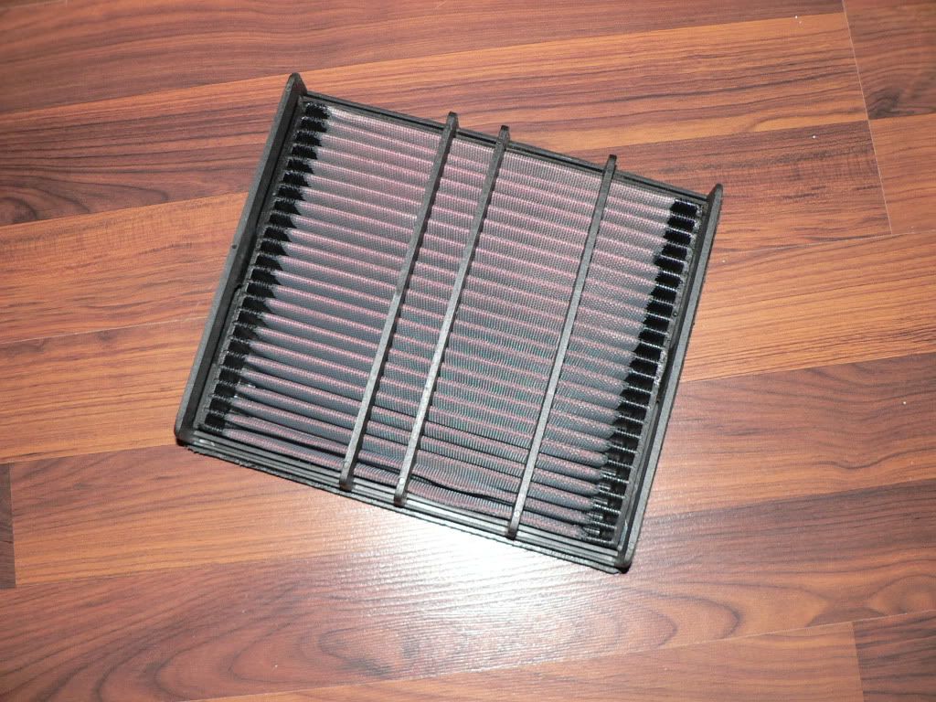

Got a K&N filter for FREE today!
The same guy I got my LC coils from, has a 2000 Taco that he removed the filter from, and just wanted to get rid of it!
It's gonna need some cleaning, but that's a sweet deal!
