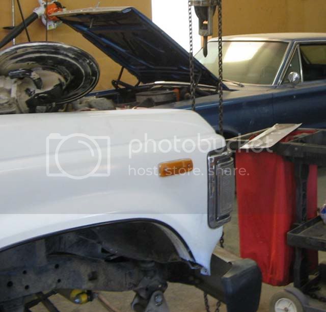

I finished mine last weekend, im gonna put up some pictures when i go home to do some more work this weekend. I figured out how much of the outer fender i wanted to trim and made a tape line down to the leading edge of the fender where it meets up to the front valance and trimmed along that curve leaving about a half inch the whole way. I then bent that extra half inch back so i didnt have an ugly straight cut, and then used my hammer and dolly to work it so it was a nice smooth radius. I cut out part of the inner fender too, i could see spots where the undercoating was getting rubbed off by the tire. Its a little ugly looking but i think im gonna put a peice of rubber in the place of the excised metal to finish it up a little bit. Ill put some pics up this weekend, im gonna do a writeup of my 4runner brake swap while im at it.
here is a few shots...woops there backwards
That looks good, mine doesnt follow the body lines as well, i didnt want to have to mess with having to make the fenderwell meet up with the fender again. I just cut off the bottom corner, it looks fine and took care of my rubbing problem.
I can try and take a couple with my cell camera, but i dont have a digi right now. Ill take a couple and see how they look. Ive flexed it out since then, i need to do a little clearancing of the inner well with a BFH but otherwise its good.
Heres one that kinda shows it. It looks cleaner with the inside of the cut area sprayed black like it is now.
