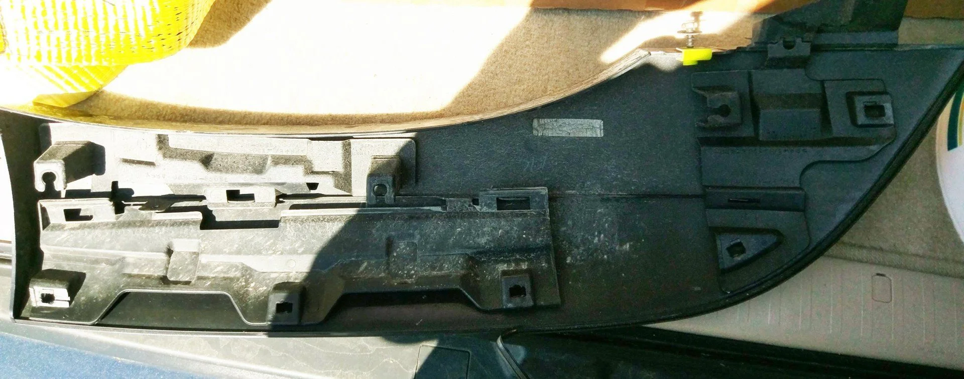

upload_2018-5-7_10-3-19-png.1695031
Ok dumb question, is there a different kind of pin for the square receptacle?
I don't know, that looks like a front or door mounted fender. Mine is all about the fender mounted right above the rear driver's tire.
This is the flare off the driver side rear, above the tire, it's just upside down. The yellow clip in the top right is where it connects to the rear bumper.
