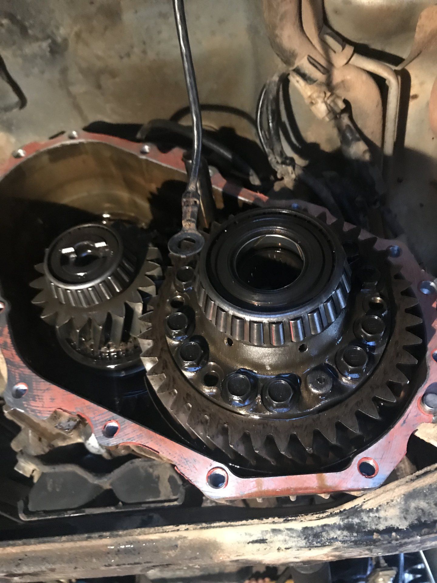

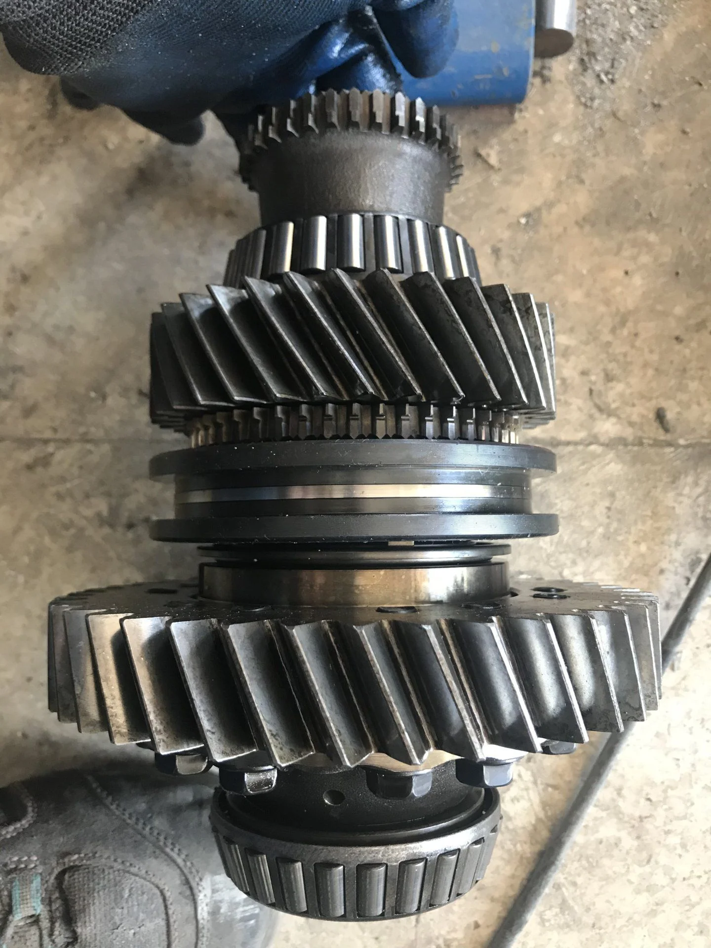

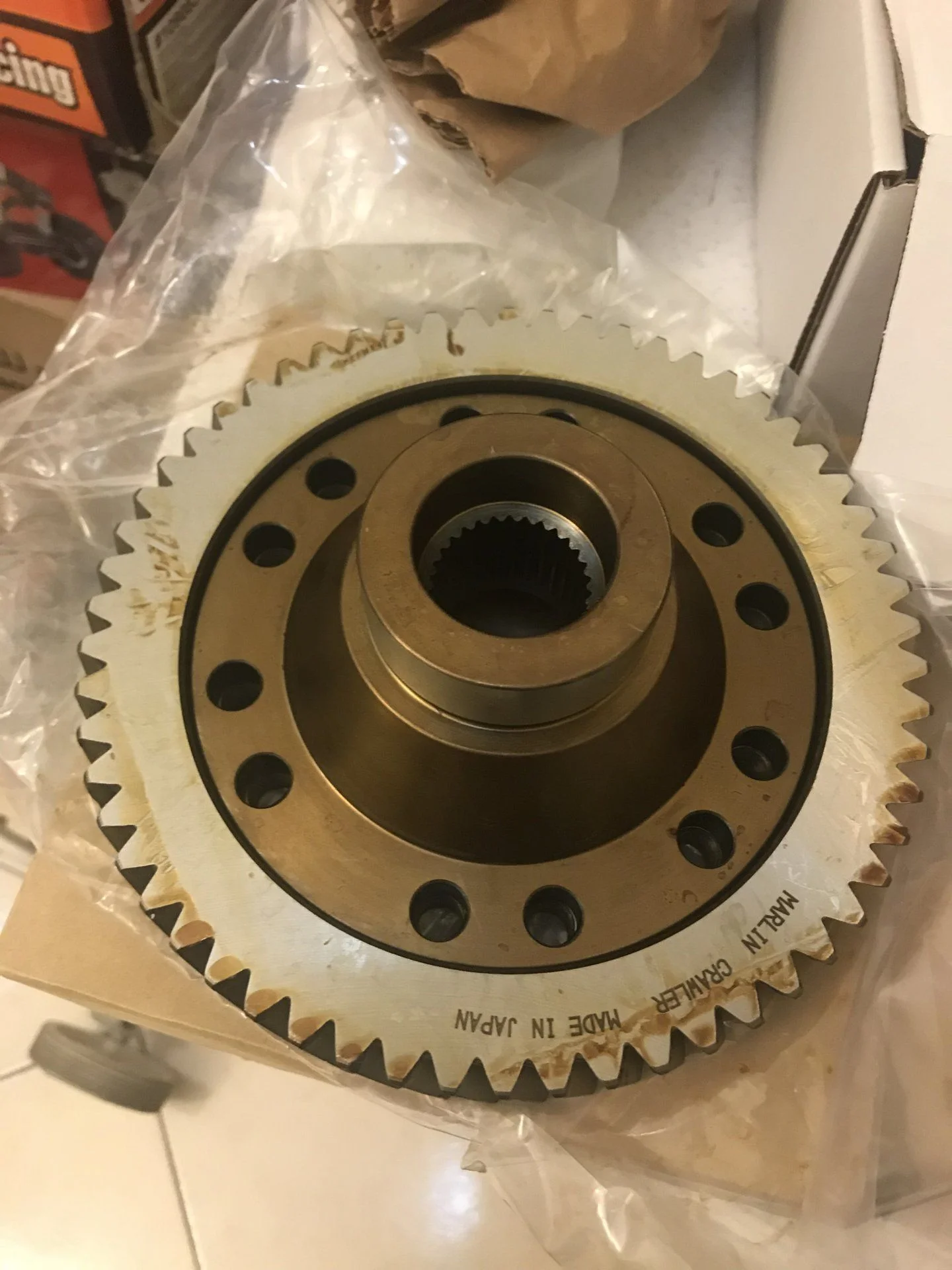

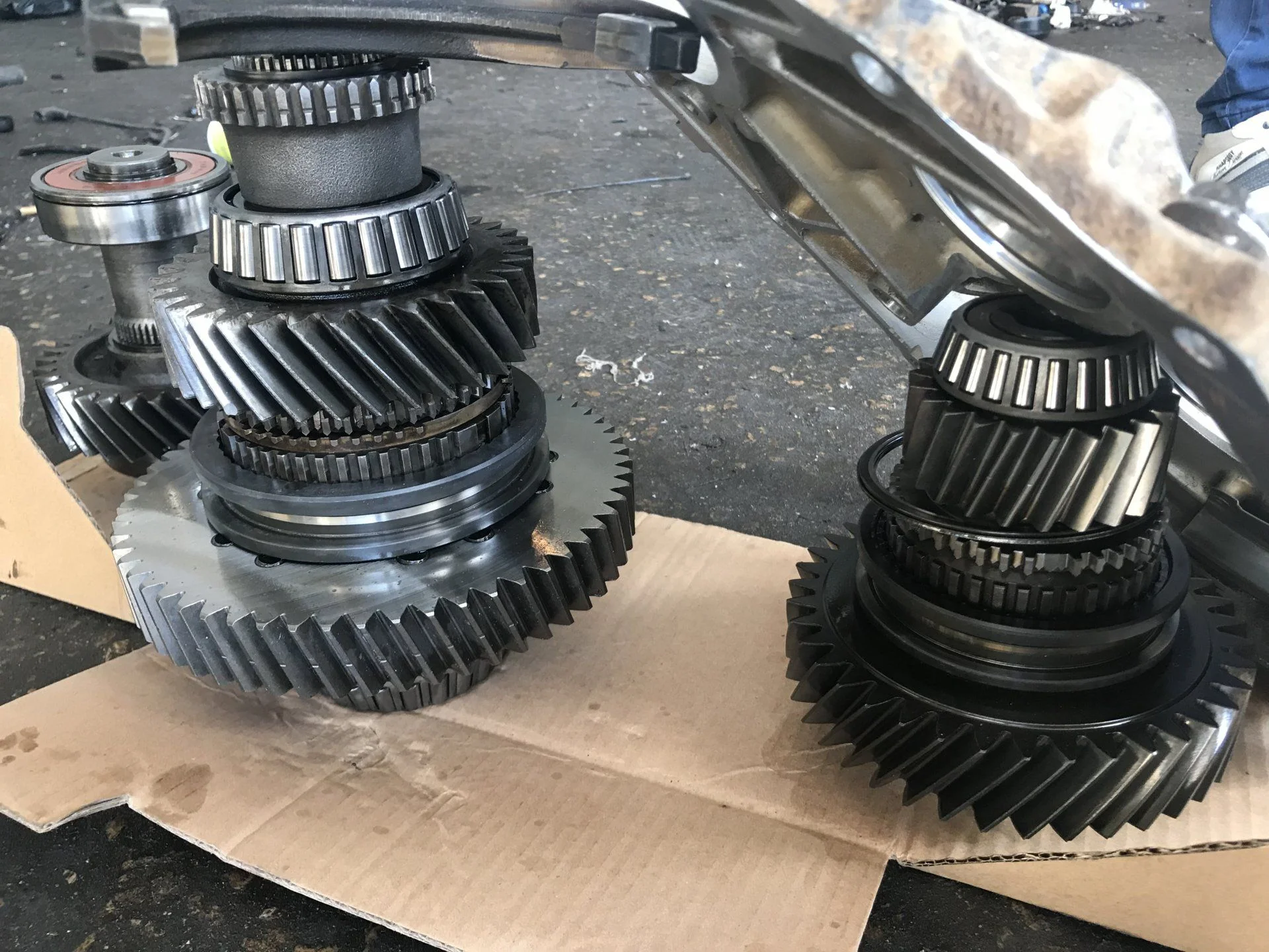

Already i have the switch and i changed the low range ration to 3.18 from marlin crawler, also it is rear wheel drive.
Ut what im asking is the front differential lock and rear differential lock without engaged the cdl switch
Last week transfer box had been upgraded.
