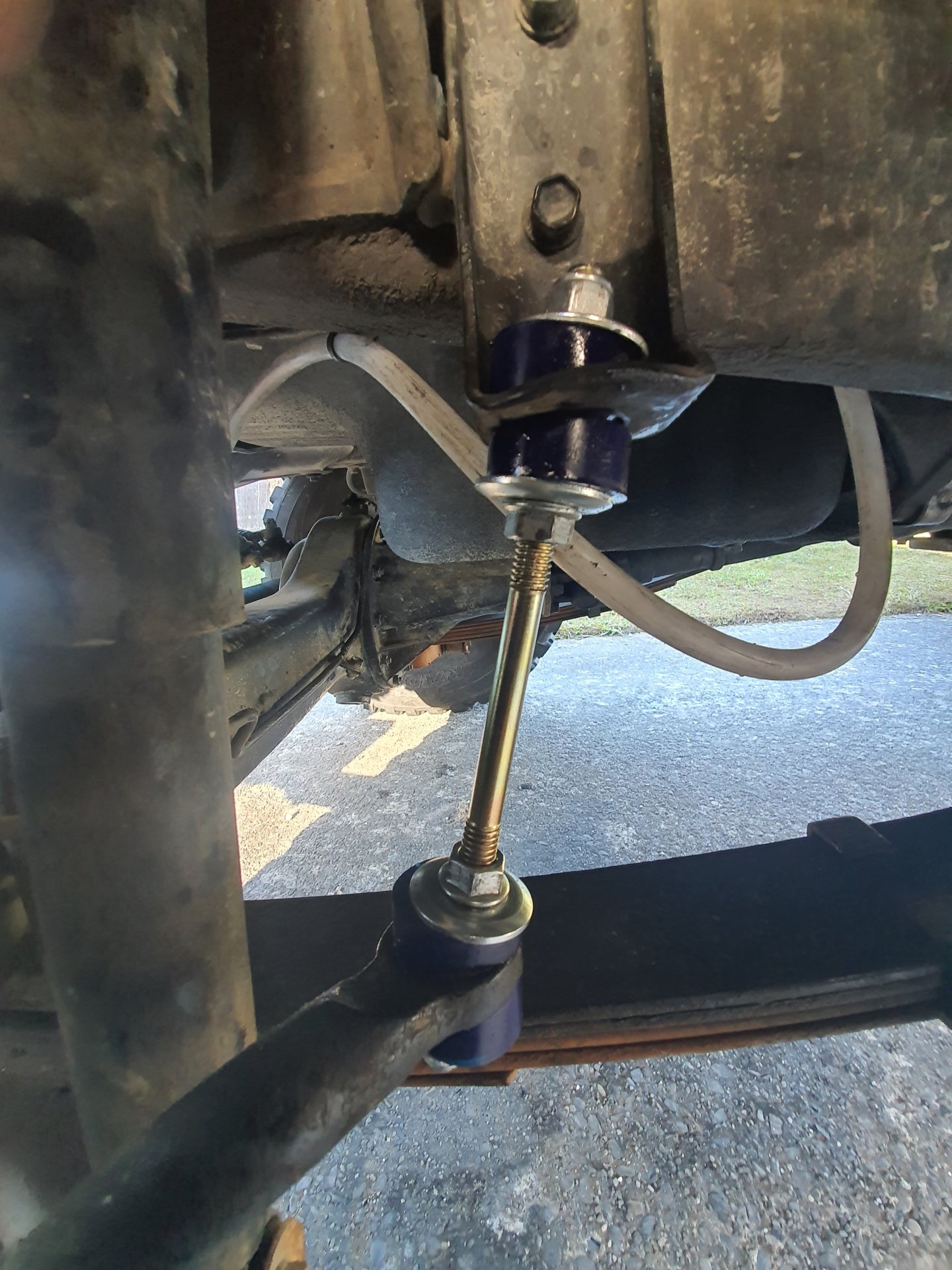

Hey there,
Just resurrecting this thread a little. On this photo of the flat bar extension, your sway bar rods appear vertical. Where as my PZJ70 has rods that slope from the chassis bracket down and forwards toward the diff. Does anyone know the reason for this?
Almost in comparison seems like my diff sits too far forward.
Regards,
Kempy.

Hey,
Do you have a pic? My chassis is also a pzj70 and mine sits vertically
Hey,
Hey mate,
Sorry for the delay. I've just tried a new set of sway bar links to see if it makes a difference. Definitely a slope forwards still. Hopefully you can see what I mean by the photo.
Almlst like the whole diff is an inch forward of where it needs to be. Which in turn pushes the sway bar forward by default. If the sway bar was an inch longer at each link end it would be perfectly in vertical alignment.

Maybe that's the case as you said. Some people push the diff housing forward 1 inch to fit bigger tires.
Have you taken the spring off the axle housing to see if so?
No, I haven't tinkered with the springs since I bought it 4 years ago. Looking to get an upgrade on the leafs soon, so maybe time to get to the bottom of things.
The guy I bought it off kept everything pretty stock for 17 years after importing from Japan, so I'd be surprised if he did move the diff. Not implausible though.
She still handles really well. And the new sway links seem to have tightened cornering up quite nicely.
What size tires are on it now?
Hmm very strange as to why it's not straight tbh.
