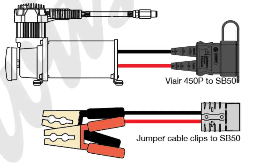

Here is what I typically do for customers. Some of these I have ready to go and some I need to build to order. This was for a customer's order.
As I said, I'm not too savvy at this stuff. To power something like a Viair 300 or 450 that draws 25-30 amps wouldn't the 25' extension cable need to be 6 awg or maybe even 4 awg rather than 10? Same goes for the wire on these pigtails if you were going to run the 25' extension between the two? All I've ever heard on compressor usage is run more hose, not more cable to avoid power loss. I suppose running heavier gauge cable could reduce/solve that problem but then it becomes a monster to stow or fight with itself. Right?
The 25ft cable is intended for solar panels that run about 100w. The Viair is 40A so yeah for a 25ft extension it would be 6, maybe even 4 gauge. If that was the intent than all wiring for that circuit would be based on 25ft run.
