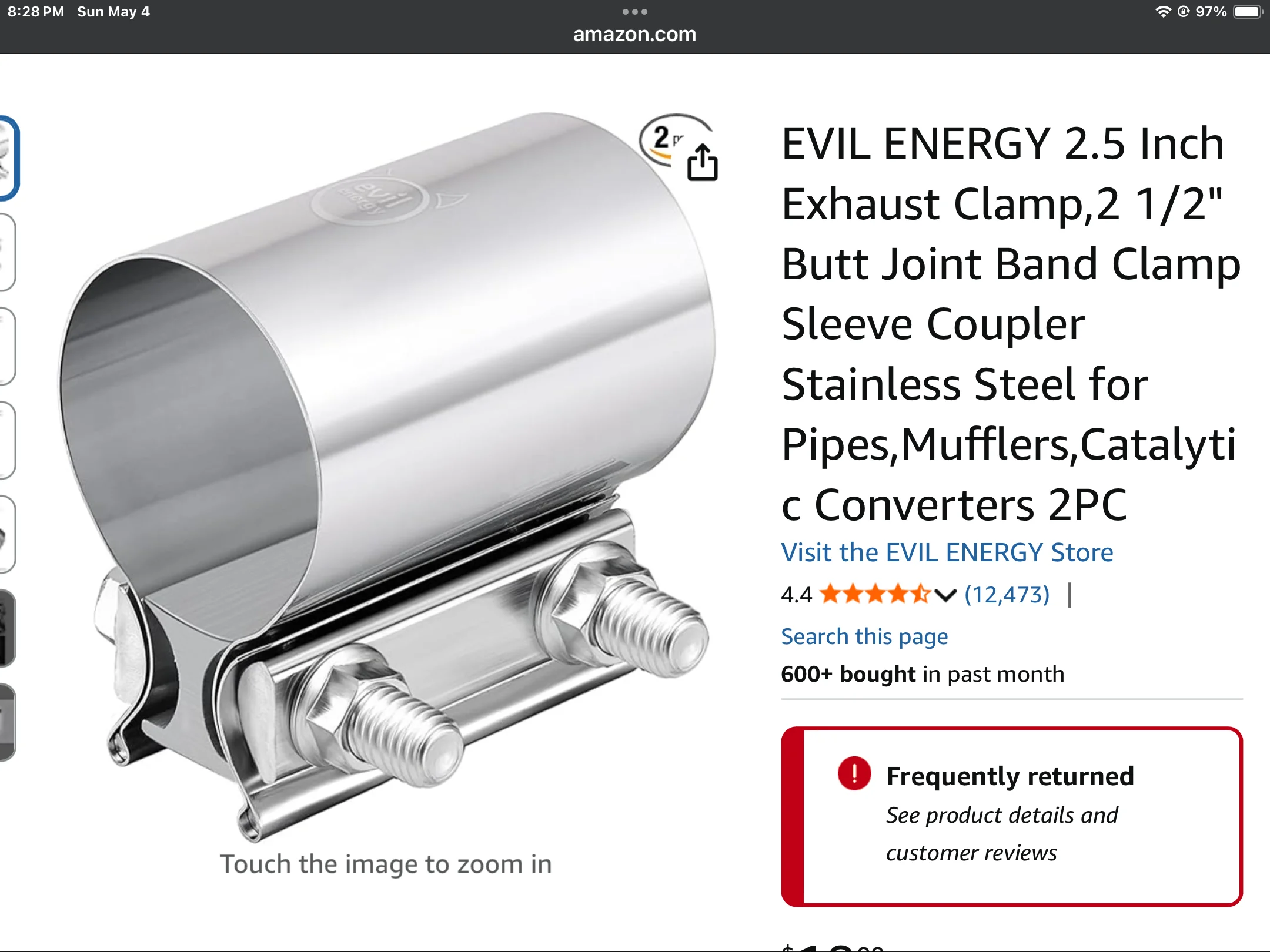

My neighbor gave me his Catback from a newer 4Runner, 2023 or 2024 I think. It doesn’t quite fit because the pipe that goes from muffler to the Y pipe(towards front of gx, not exhaust pipe) is a couple inches too long. This causes a bunch of the exhaust hangers to not line up properly. Could I shorten that section of pipe to get this to fit? If so, could I use an exhaust coupler and do this myself, or should I take it to a shop and get it cut/welded? I’ve installed an exhaust on the gx before but I don’t know much about exhausts other than bolting them in. Thanks.

Thanks Red. I wound up just using my sawzall and that coupler. I just cut about 2-3” and everything fit. I also used some copper rtv. It worked great, only one hanger doesn’t line up, all others are perfect. The front hanger, right near the y pipe, didn’t fit.
If I could cut the hanger off and turn it around it’d fit perfectly. How did you reattach? JB Weld or something? I don’t weld, wish I did.
I’d also buy a proper fitting exhaust in the future, but this one was free and it’s shiny and new. So for about $25 and an extra 15 minutes of work I can’t complain.
