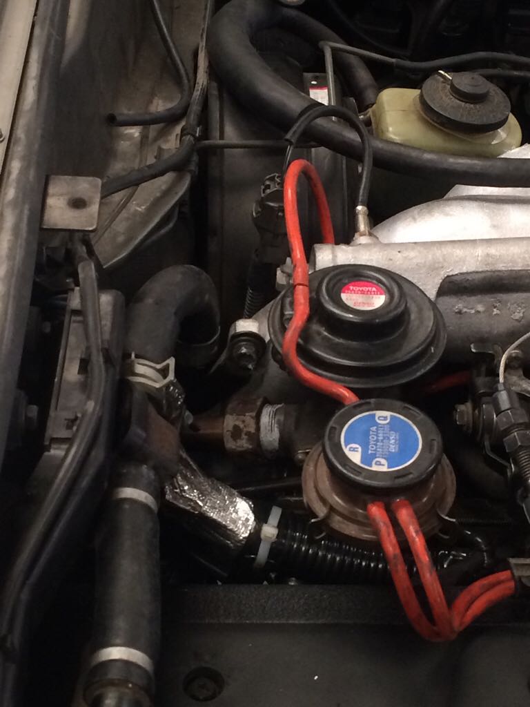

Traced it to #5 cylinder and this morning the tech confirmed that the #5 injector is not firing. There is an intermittent short in the engine harness. It failed the wiggle test.
Yes, this is the exact spot that I had to repair and has been a concern ever since I saw the condition of the wire. My guess is that my attempt to repair was not good enough.
I showed the tech the picture I took before my repair.

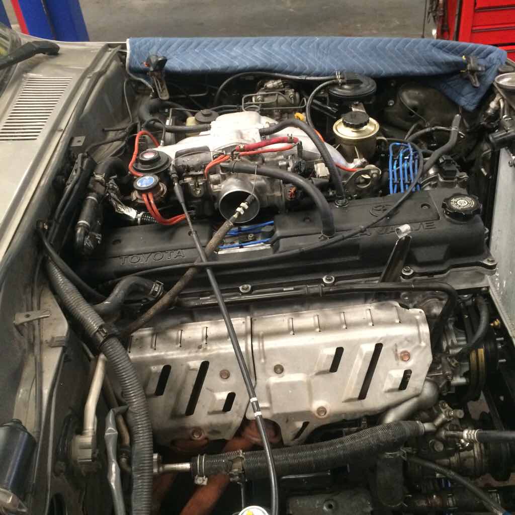

Update... The short resulted in damaging a portion of the ECM that controlled #5 injector. I got a rebuilt ECM from cruiserparts (Big Thanks) and installed it last night.
The moons are aligned now and she is purring like a kitten.

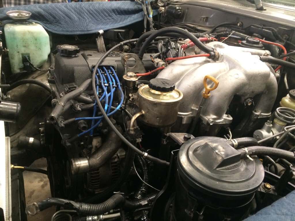

Transplant almost done. Going into post op soon.

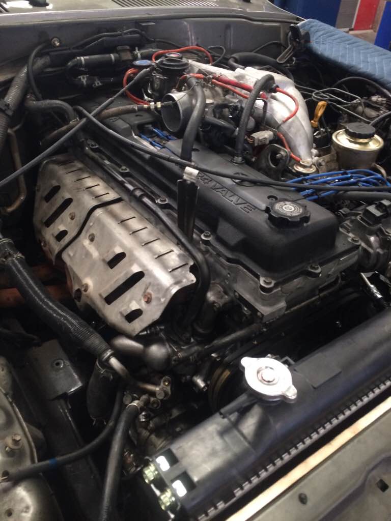

The tech mentioned how much of a challenge it was to get the block and the transmission to align. Unlike domestics, this tranny and engine had to line up perfectly with the splines to install.
And, of course, a few select words about how the radiator mounts to the frame...:bang:
I absolutely hate how the radiator mounts to the core support at least the horizontal points..
