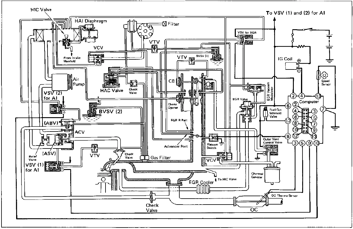

Question, Any reason the emissions computer can't be removed after doing the smog delete? This is on a 1985 FJ60, carbureted but will be modified with the Affordable Fuel Injection kit sooner than later.
The computer does control the Fuel Cut Solenoid (prevents afterfire during de-acceration) and the Evaporation control system. If you don't have the stock carburetor nor care about venting the fuel delivery system...then maybe you can get rid of it. The diagram below shows what the computer is connected to. Compare that to your desmog...

As stated, ECM controls the ICS, for Decel cutout, but if you've ground the white wire to the ICS (stock Aisan carb), that circuit is defeated anyway.

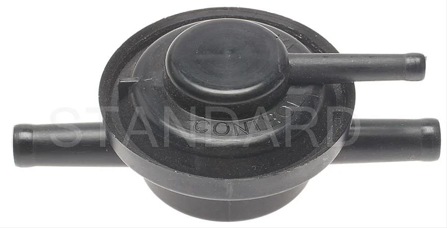

You can deal with the Fuel Tank Venting by substituting a vacuum controlled Canister purge valve for the electrical one, something like this:
(@wngrog frequently uses something like this on his Sniper setups. See his many well-documented build threads and sniper installs).

Standard Motor Vapor Canister Components CP107​

Thanks for the info. The fuel cut off was what I was seeing. Like the idea of the manual fuel vent control. Commifornia smog laws really suck. If the intent was clean air then the only thing that should matter is what is coming out of the tail pipe. Luckily I am not from CA and have a residence in a free state.
