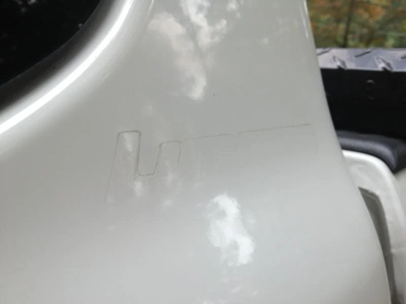

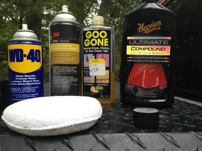

I have been removing a few obnoxious emblems around my vehicle lately and once i get them off I am left with this ring of residue that will not come off (pic attached). Ive tried getting it off with lots of different products (pic attached). Does anyone have a suggestion of what product to use or any tips? Thanks!

I would still suggest letting the residue soak in some Goo Gone for 5-10 minutes before taking the wheel to it.

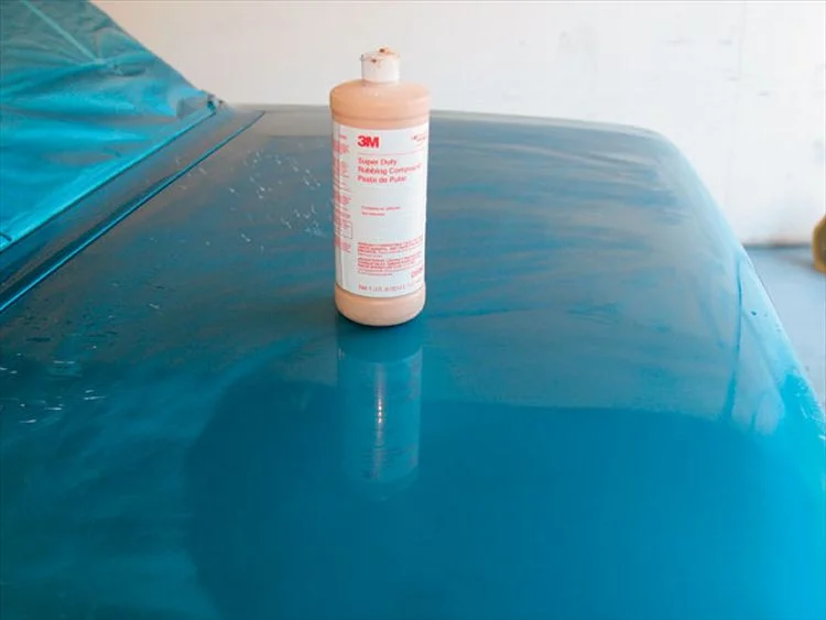

I'd say wet sand with some 1500 grit, a bottle of decent rubbing compound and obviously a buffer. Looks like you got just about all you can get off with adhesive removers. Sometimes you have to pull out the big guns.

I can't believe that none of that stuff worked on mere adhesive. Are you sure that's something ON the paint and not something UNDER or into the paint? Can you catch your finger nail on it? Is it a raised line or a depression? Does your nail go down into the paint? I'm wondering if it isn't a depression where something ate into the paint. Especially because it's only on top. Bird poop among other things, could have collected along the top of an emblem and etched into the paint. Megs ultimate compound may not be enough to remove that. In fact it's way to mild if you can catch your fingernail on it.
