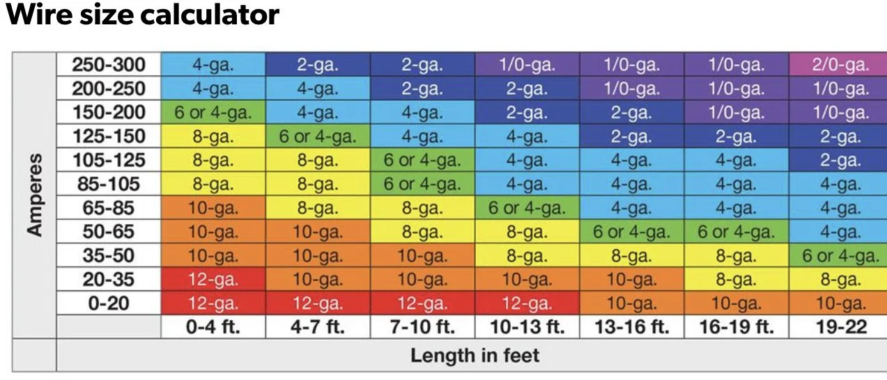

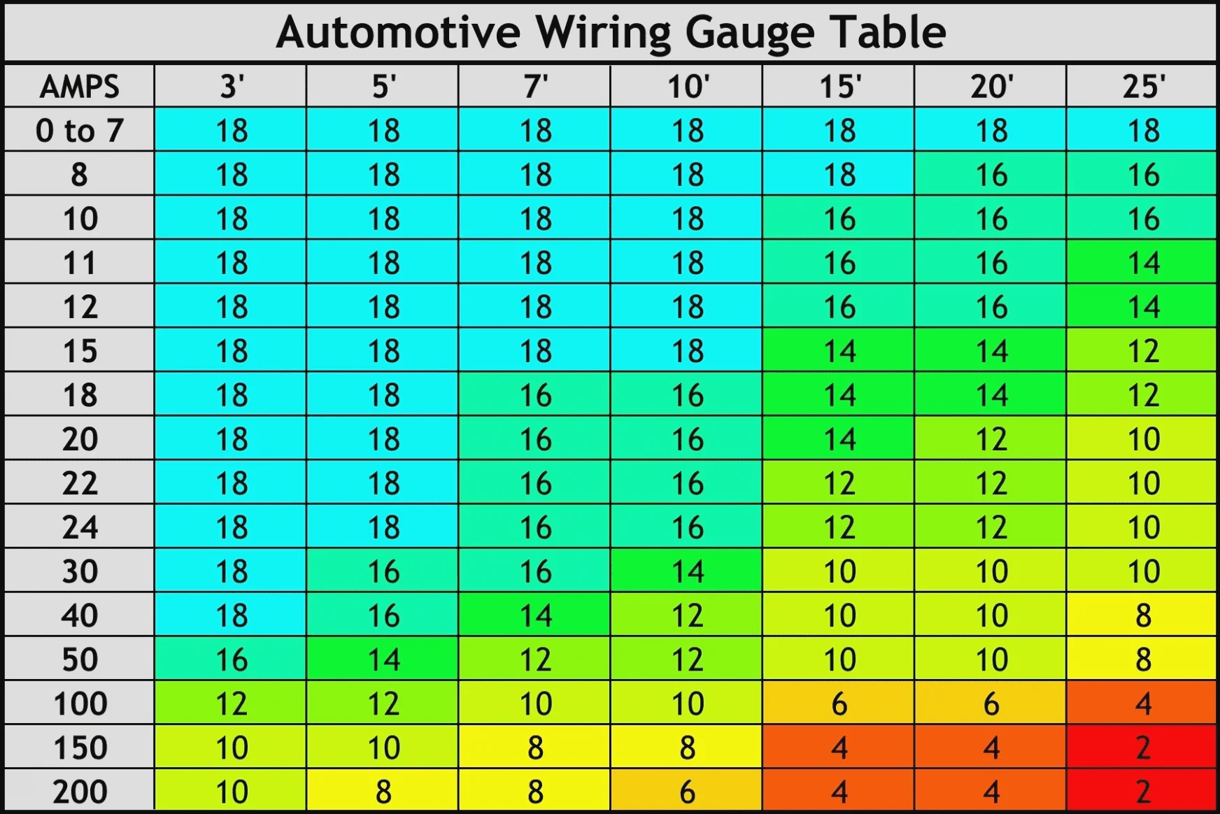

Is your wiring sized correctly? The manufacturer will spec the minimum. For reference, a larger 50 quart ARB requires a min of 10ga and uses a 15 amp fuse.
