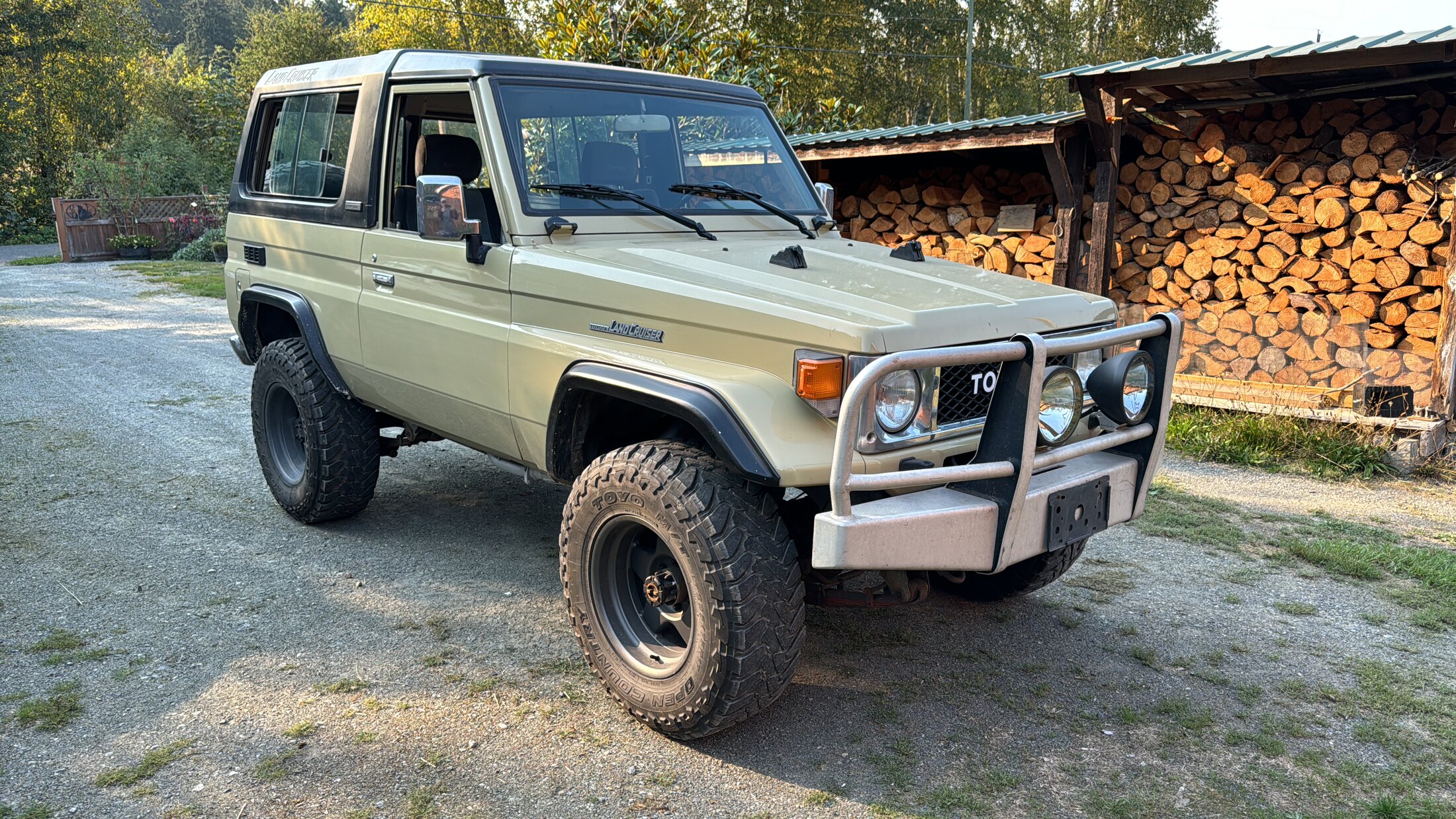

My rig and daily is a 1988 BJ74 - quite heavily modified except for the 13bt itself (AFAIK). I've had it since 2019, and in that time apart from the kms put on it, I've added to the PO's list of mods and got the body to a non-rusty condition.
