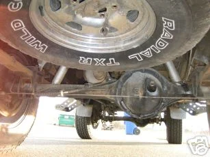

I saw this FJ60 (linky) on ebay and have a question.
It seems the diff filler holes have been moved up really high. Is this necessary for spring over? I copied some pics from there:
It's a good idea, but in this case poorly done.
when you turn your housing to change you pinion angle, your fill hole will be lower then stock.
