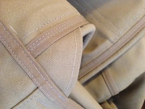

And a few detail shots of OCD Jim's top, not sure I ever posted them. But all the multilayer flappage made it pretty labor intensive.
