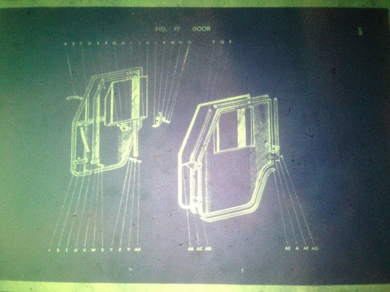

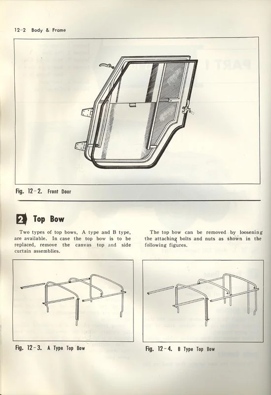

Went through a 1962 book I had and found something I didn't realize. The FJ43 was available with a rounded door. B-type = FJ43? A and C are 25/40?
To the microfiche! C has the rear bars for a 43 style ambulance door setup. In the fiche they call it STD, B, C (FJ43?), and STD again.
Check out the replaceable rear window in the 25 canvas...
Besides the rounded door opening the FJ43 was also available with a standard opening but high rocker like the rounded door. One was in Australia. The owner posted on Mud and then sold on eBay. I have pictures of it.
Not sure what 1962 book your talking about my 62 micro-fiche shows the B style same as the std (A) bows. Difference is std has a tailgate and B has barn doors. C has the two piece ambulance soft doors. which make the rear bow area different.
What year was this FSM? I'll check mine but you notice that yours the B style bows has the two piece ambulance doors. 62 micro-fiche those were C. Toyota kept switching what they called different styles bows.

Need years on these. The FJ25 has the removable rear window. My 63 book shows no removable rear window and that style is called A. Is there a year on this micro-fiche and are the part numbers ten digit or the earlier part numbering system? Guess I need to dig out my 63 FJ25 micro-fiche and see if it's different than the 63 book.
Ok. The B stuff, STD stuff, etc. is a little over my head. Can someone just answer a question - when it comes time for me to find doors and a suitable top with bows, is it do-able, or impossible? I'll tackle the logistics after I know my chances ... ahah. The alternative is a 62' FST with no top at all.
Drove my FJ today and had a great time. Still can't believe a motor from the 60's runs like that. So simple, it's stupid.
...Not sure what 1962 book your talking about my 62 micro-fiche shows the B style same as the std (A) bows. Difference is std has a tailgate and B has barn doors. C has the two piece ambulance soft doors. which make the rear bow area different.
1962 brown Land Cruiser Repair Manual.
The microfiche is 00116-00393 July 1963 - Model FJ25 and FJ25L. My '62 microfiche doesn't show the 25 (00116-00391).
I have the same 62 FSM I need to look.
I have a couple of 63 micro-fiche and 62 micro-fiche. The 62 is for the FJ40 and FJ43 both RHD LHD but old part numbers. The 63s are FJ40 and FJ25. Looking at the picture of the FJ25 I realized that it doesn't have a tailgate or barns door but just fixed closed. That was std. Looked in my book and it's there in front of the A style. As far as I know none of the std FJ25 were imported but the parts for the rear removable rear window were converted to ten digit. Used in some other English speaking market.:hhmm:
