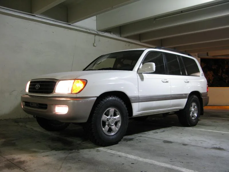

I was going back and forth between D and E load rated AT's for my 100-series... ended up going with the 8 ply D rated AT's. E's are good for 1 tons towing 10k plus trailers all of the time. My 100 will be lucky to see a little 4x8 utility trailer or tent trailer at best, so even the D's are overkill for my application. The other thing to consider is the fact that the D rated ones had the snowflake logo, so they're supposedly better in the snow.
