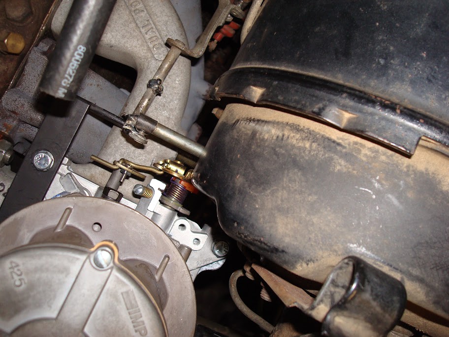

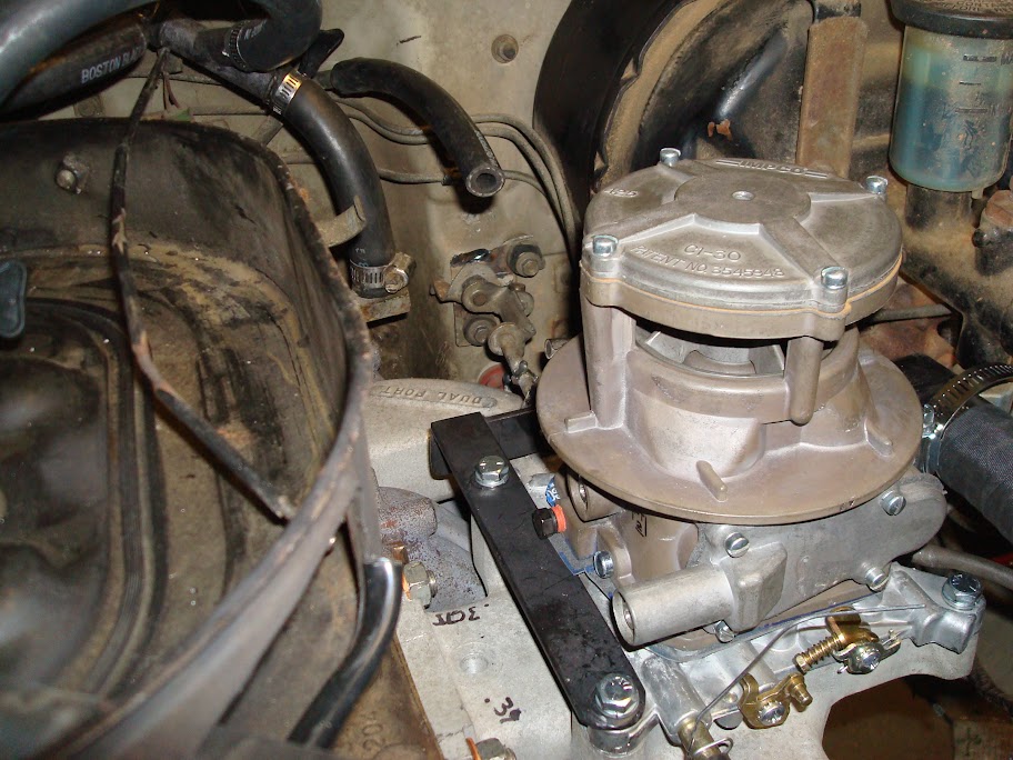

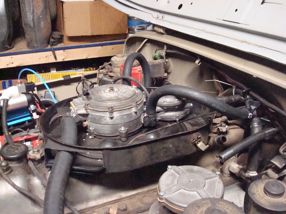

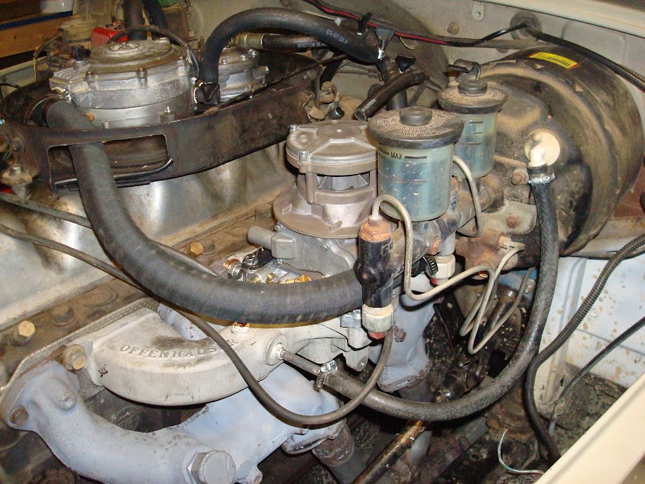

I bought some parts from a guy on Mud, and a big thanks to Al for helping me in the tank department! Got her running this weekend and was having issues, but our friends at Pirate got me straightened out and now she is running well. I have to swap in some colder plugs and get her timed up, but other than that it's pretty sweet. Here's a few pics. I was able to retain the factory throttle linkage with some major modification and fabrication, but well worth it! I'm stoked - bring on the rocks!!
:beer: R
This is the throttle linkage bracket I had to fab up:
