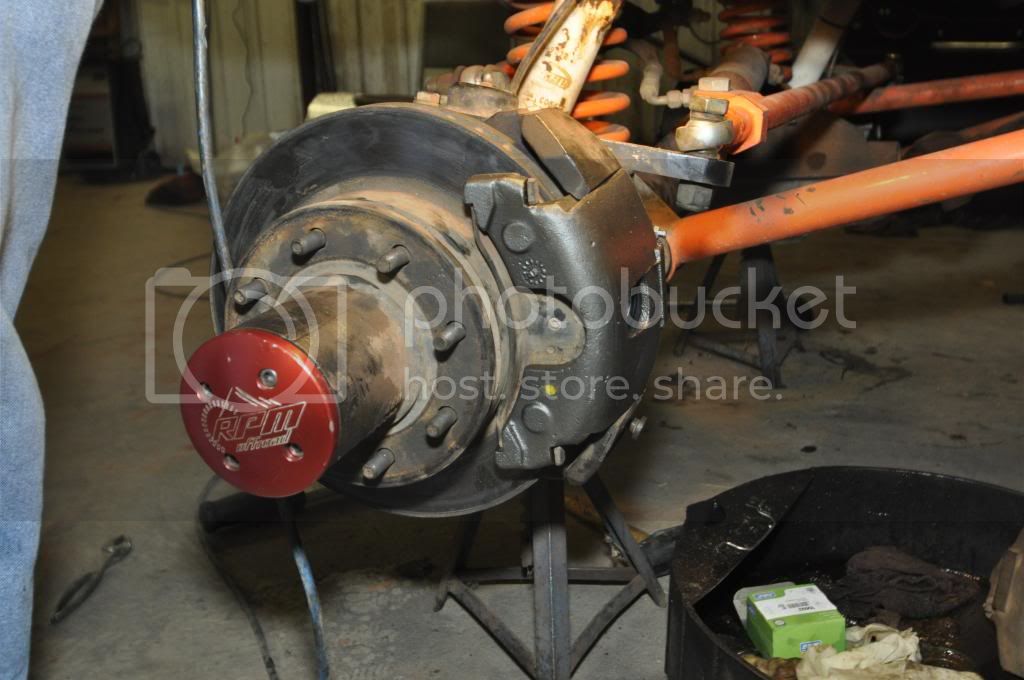

After I finished the axle instal, I replaced the front and rear brake calipers.
