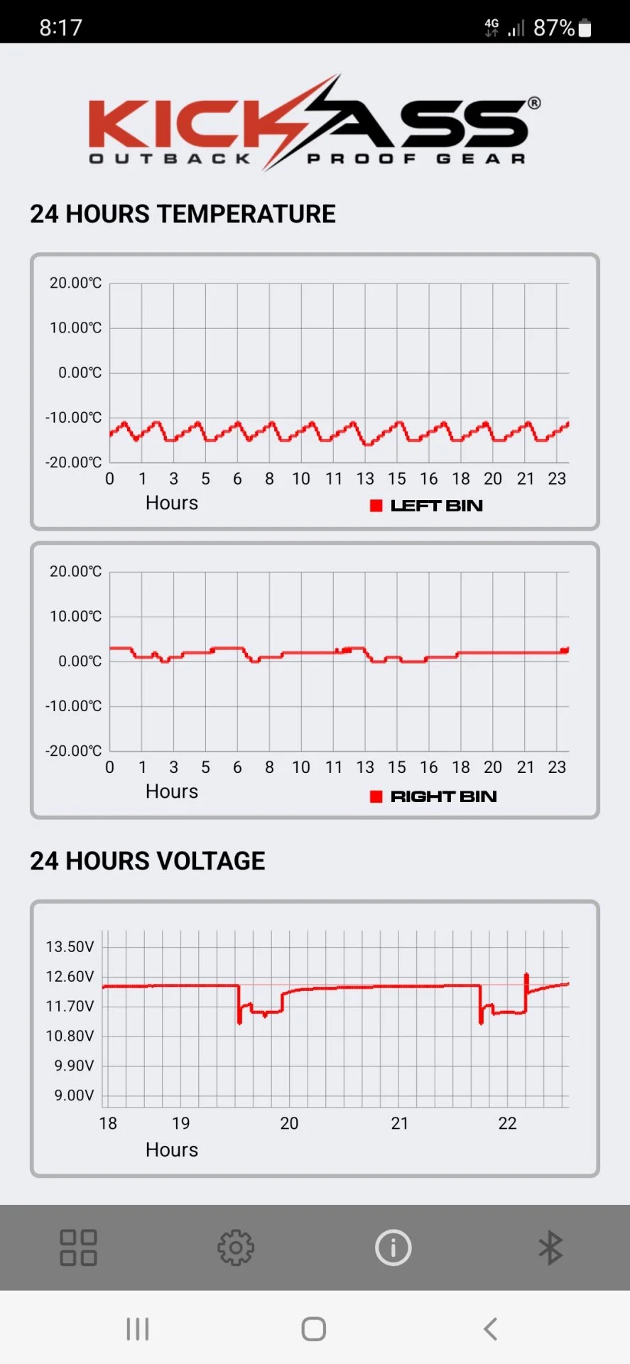

Since I love data and trends, I cant help but look at the trends when commissioning.
Its looking like the battery is settling into a voltage of about 12.6V overnight, which still feels low, but bearing in mind this is the voltage the fridge sees via the controller.
And then when the fridge cycles it gets hammered on the volts and drops down below 12V. That sort of lag makes me feel like its a resistance/wiring issue. I actually have a recollection that the load terminals of the controller are quite small, so I think bypassing that will give it more omph.

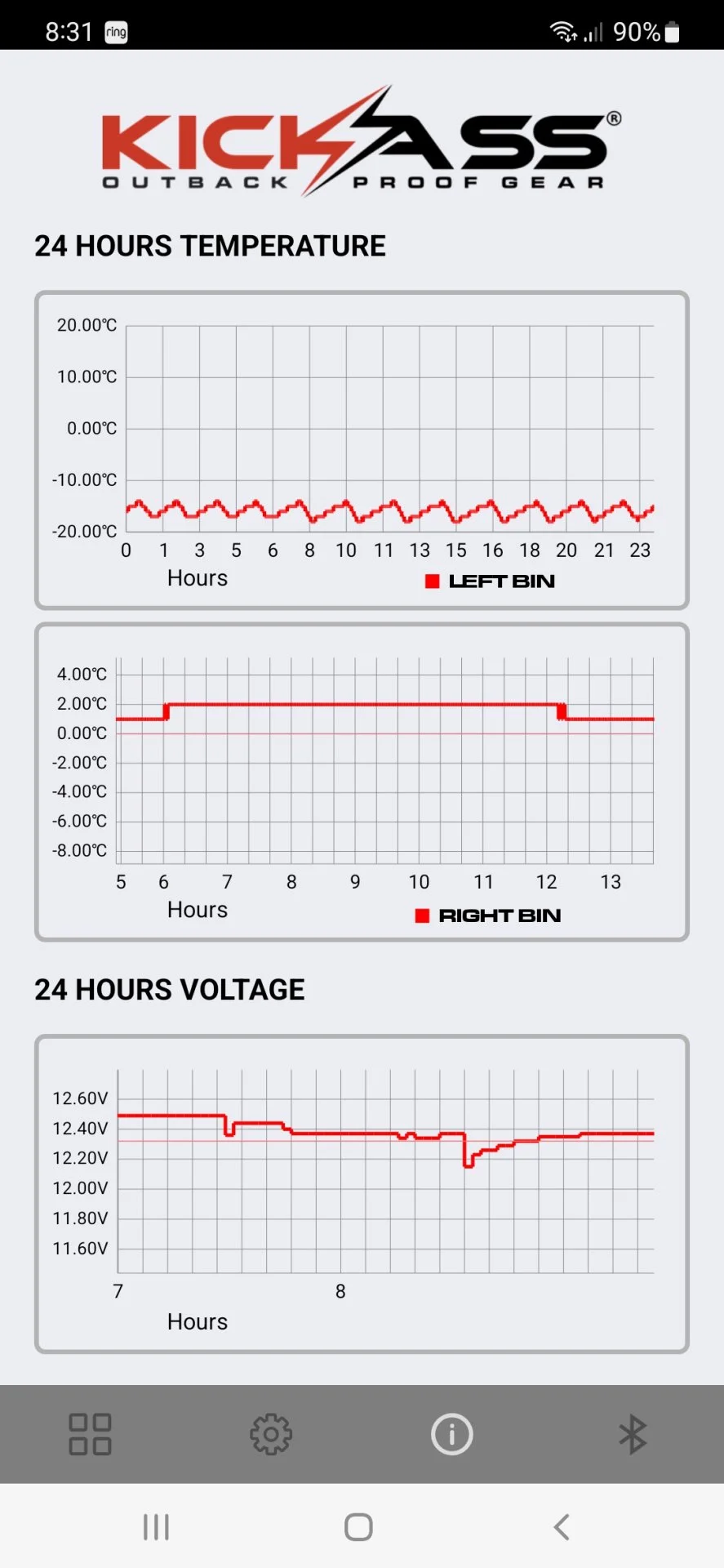

Problem solved! Well, at least its looking solved.
Re-routed the cables so that everything is now on the battery side of the controller. So at night time its directly drawing from the battery, and during the day it should be charging and power the fridge in parrallel. I'll see how the voltage at the battery goes today, and I'm still interested to see the amps.
But the voltage trends are barely budging now, so it must have been the voltage drop back through the controller.
