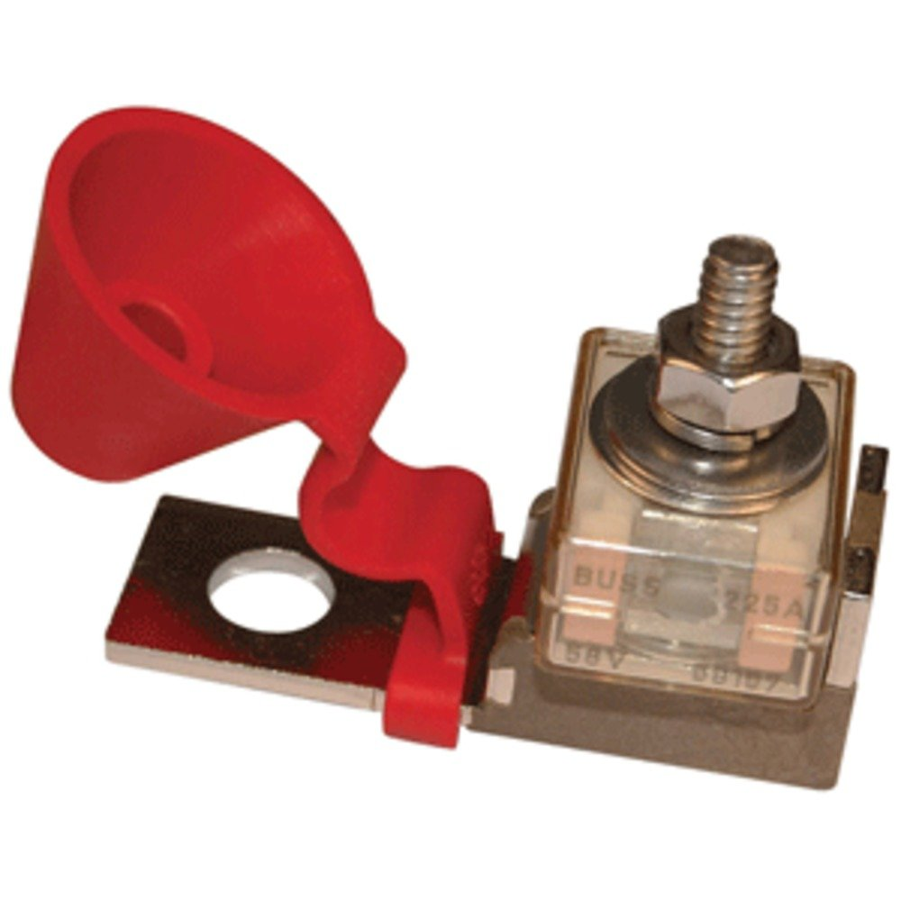

Below is a rough drawing that someone came up with. One thing I will be adding is the Blue Sea fuse block pictured below. There will be 2, one on the starting battery and the second on the house battery:

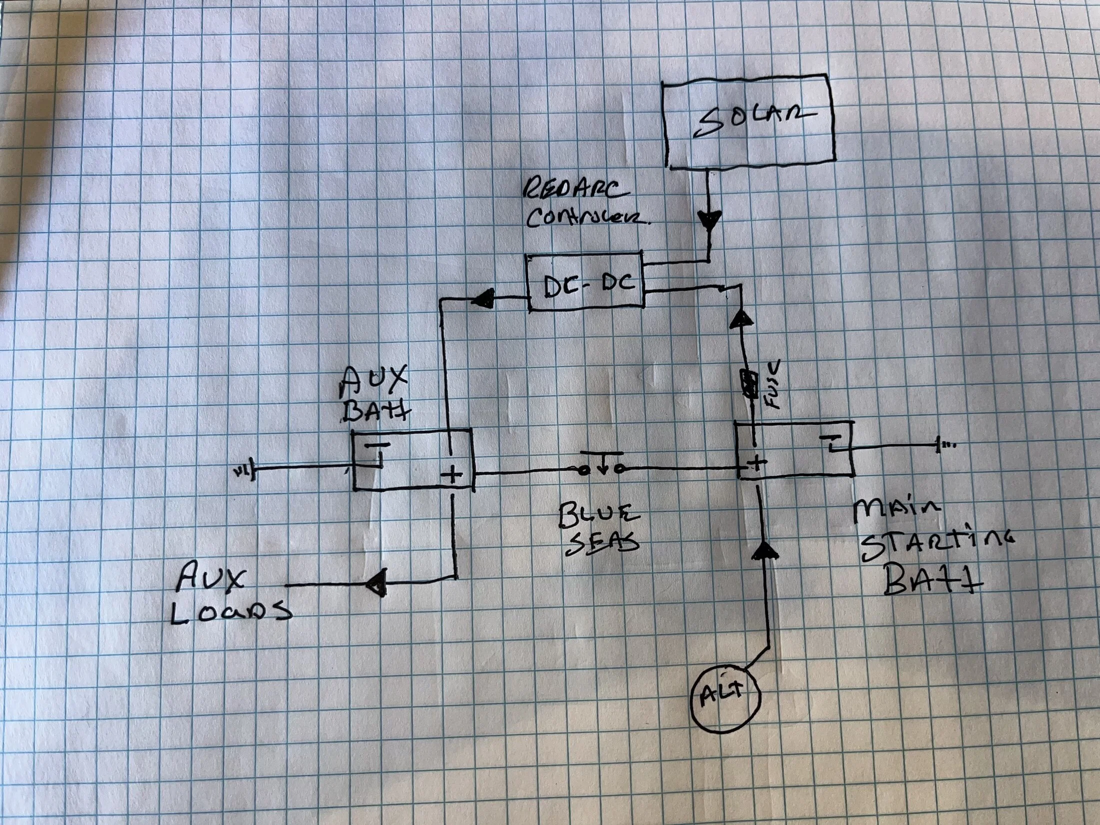

Below is the schematic I am going to use for reference when wiring things in. Yes there are other wires from the Blue Sea ML-ACR and the Red Arc DCDC charger that need to be wired in but this give me a general idea.

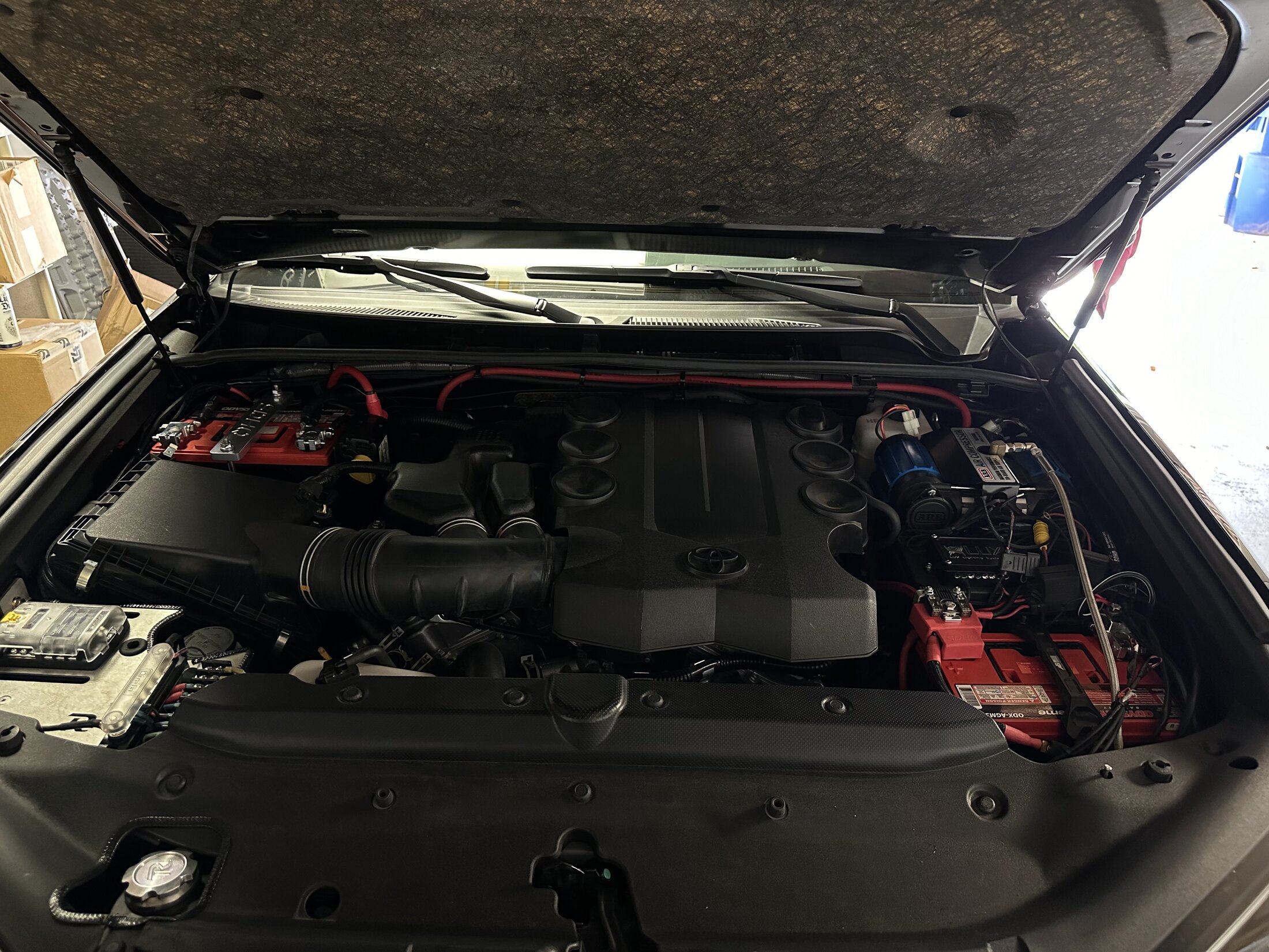

SDHQ dual battery setup. Using Odyssey Extreme 34s.
Great setup. Comes with everything thing you need for install. EVERYTHING, minus tools, Easy to install. Can't recommend enough.
With the 2nd battery why are you running so much off the main battery? I see you have the fuse panel in the lower left of the picture are you re-doing things?
Lots has been reworked since this photo haha. Very messy in this photo
Okay, I assumed but wanted to make sure.
If I had the extra 1200 for that kit I would get it. I love idea how they label all the cables so you cant screw up. Sucks there is no room for a Red Arc DC-DC charger to mount. I probably could figure out a place to mount one.
In your schematic you show both a Blue Sea VCR and a Red Arc DC/DC controller... I think you want just one or the other, correct? As in, they do the same thing other than one of them can manipulate charging voltage, while the other can combine both batteries.
the only video I have of this is my Tundra setup, which as been working well even with the obvious flaw of a simple Blue Sea switch & AGM 2nd battery... but I offset that with solar, and not worrying about it.
You are correct, a disconnect would be better suited for that schematic.
