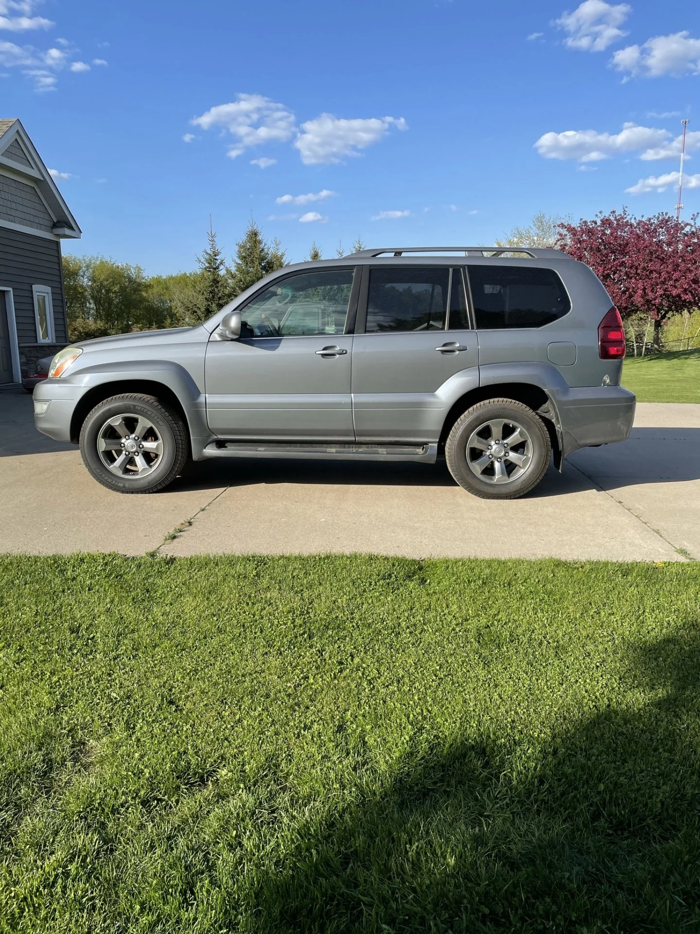

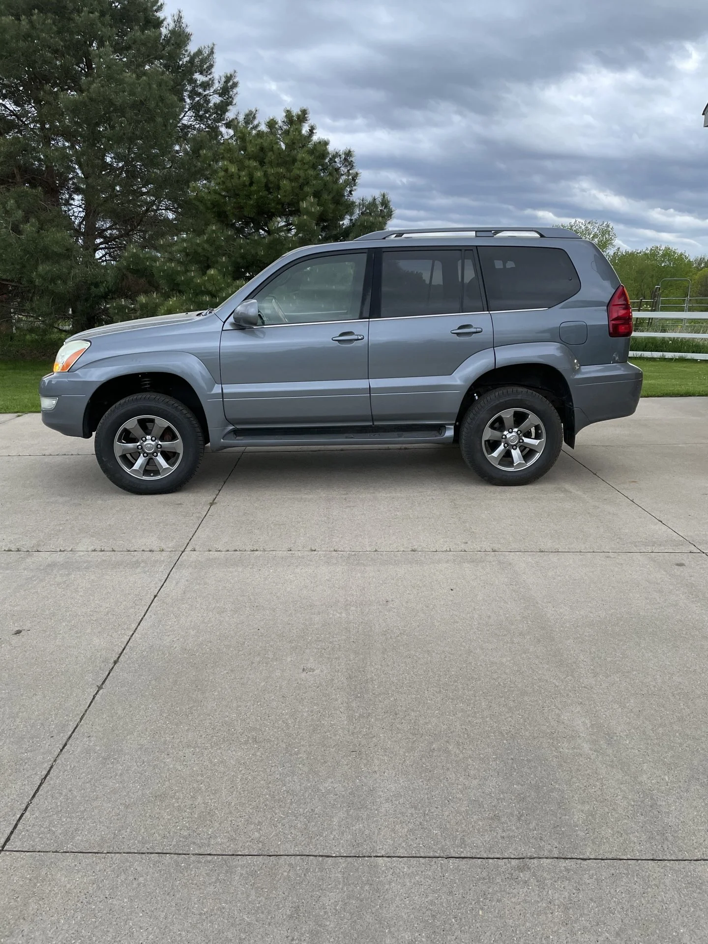

I ended up putting in an Eibach stage one lift . Set the front shocks one slot from the bottom which should be 2.8 inch front and in the back should’ve been 3. The goal was just to get level. I actually gained 2 1/2 inches in the back and I didn’t have a pre-measure on the front but it looks pretty good. The rake looks a little different because it’s facing opposite directions on my driveway which has a slope to it. First picture is going up the driveway second picture is going down the driveway

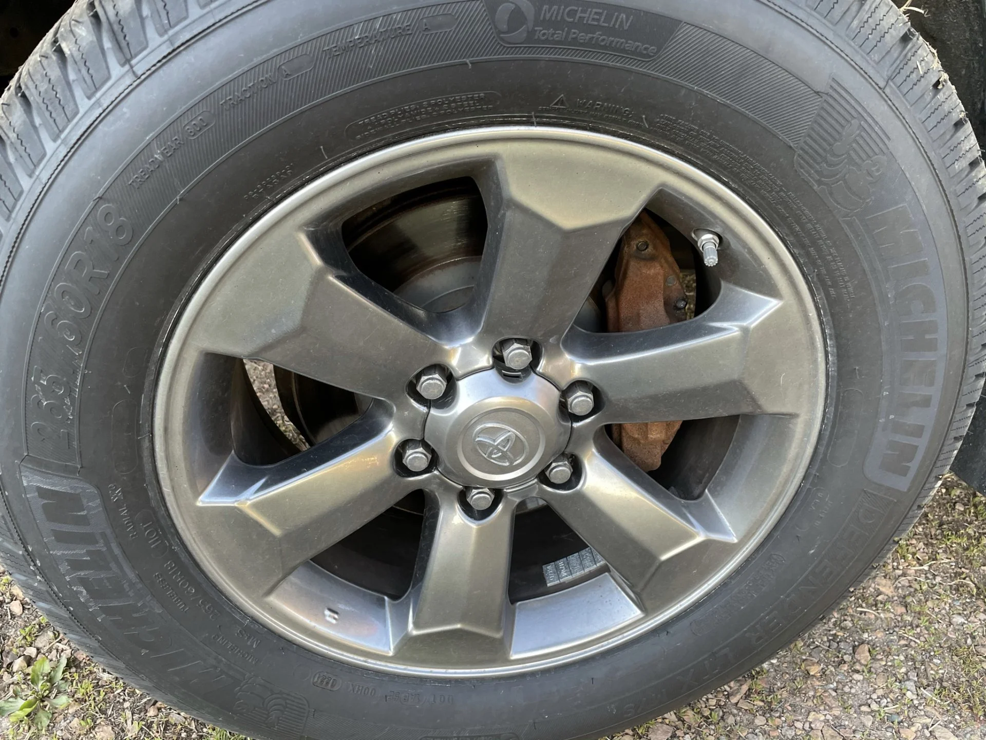

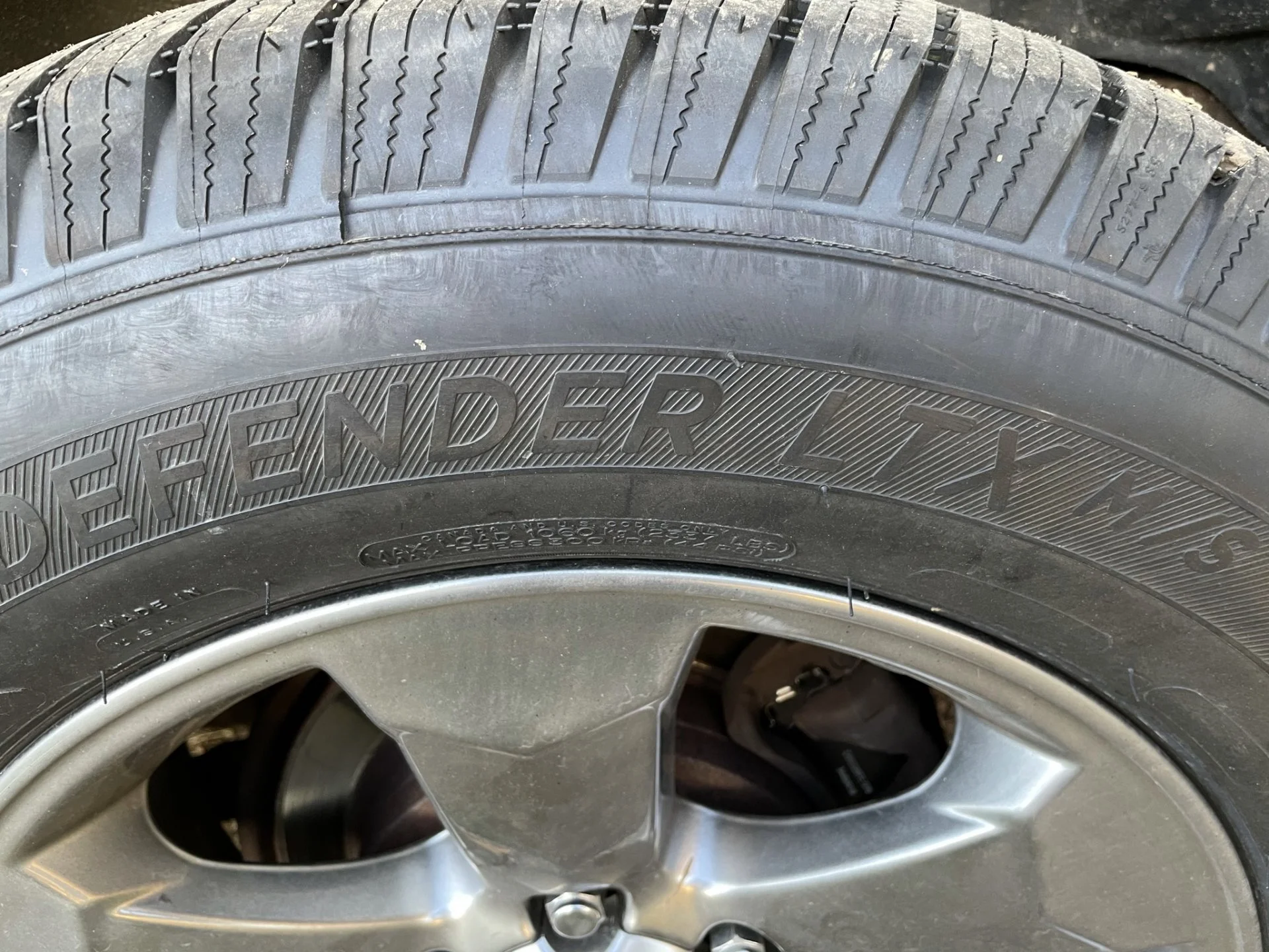

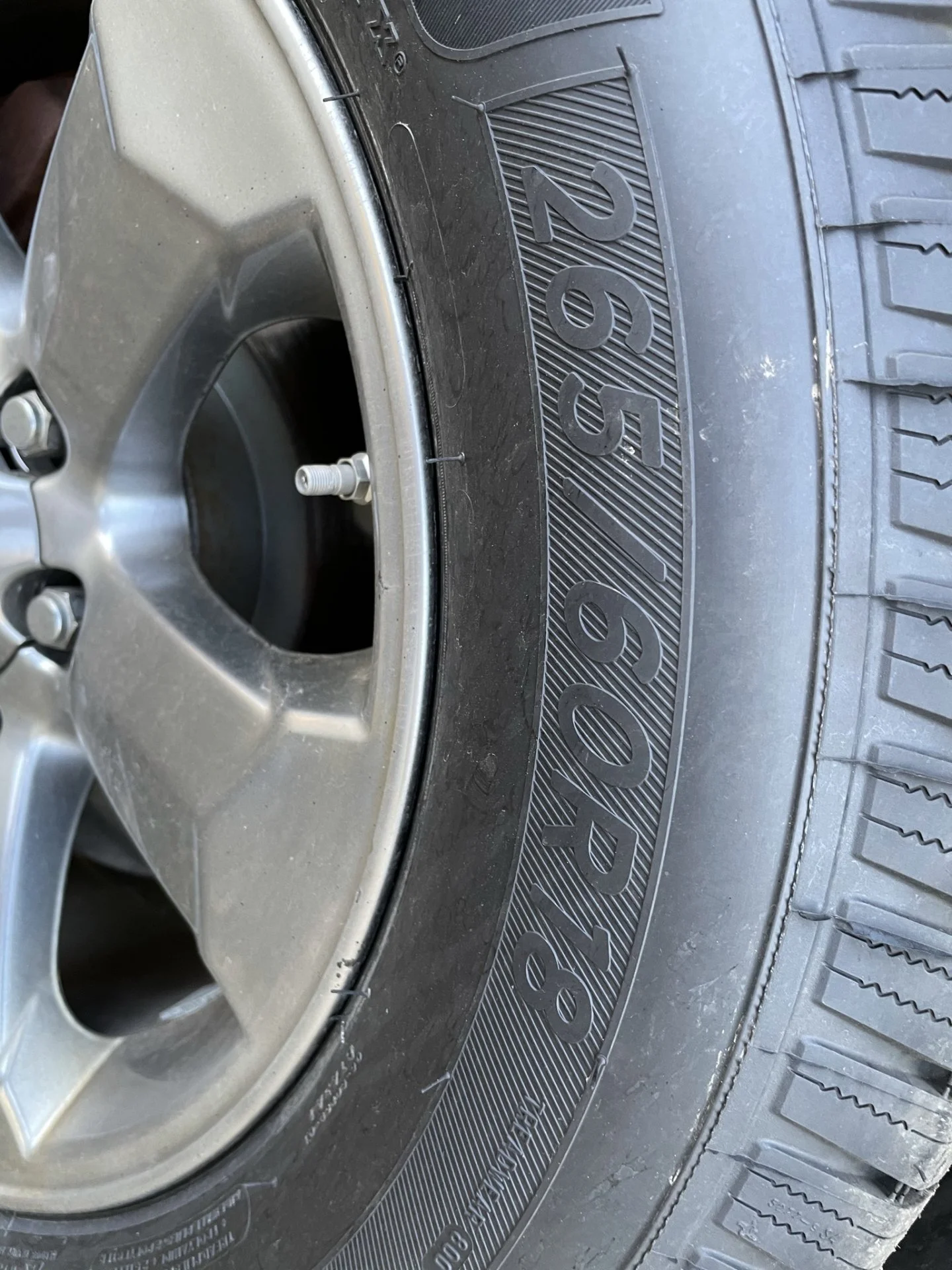

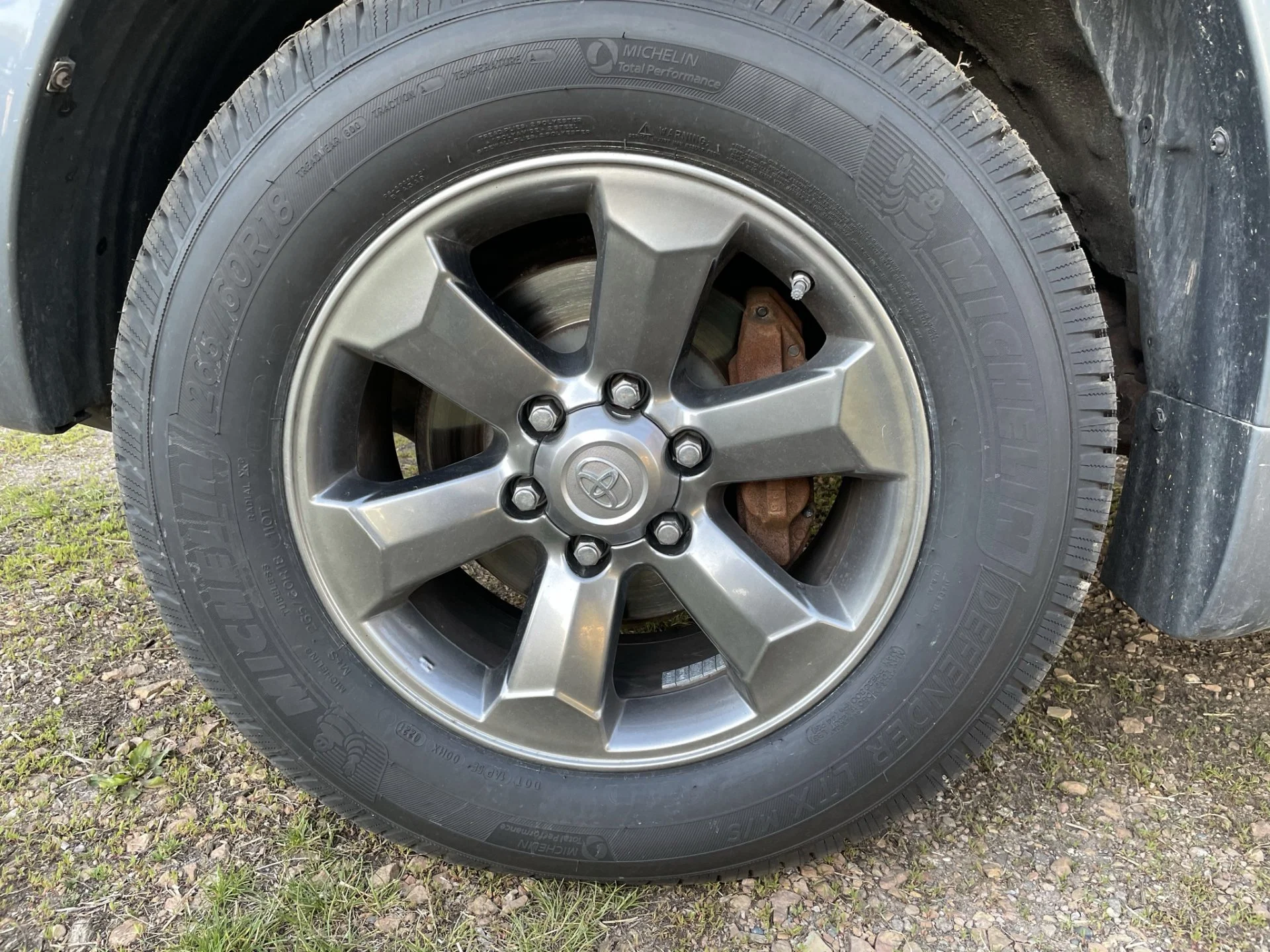

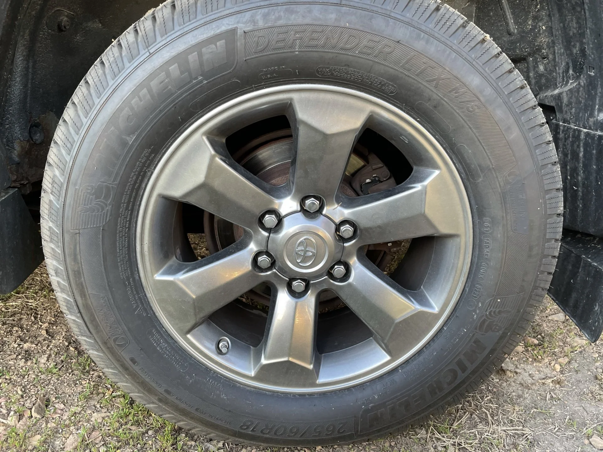

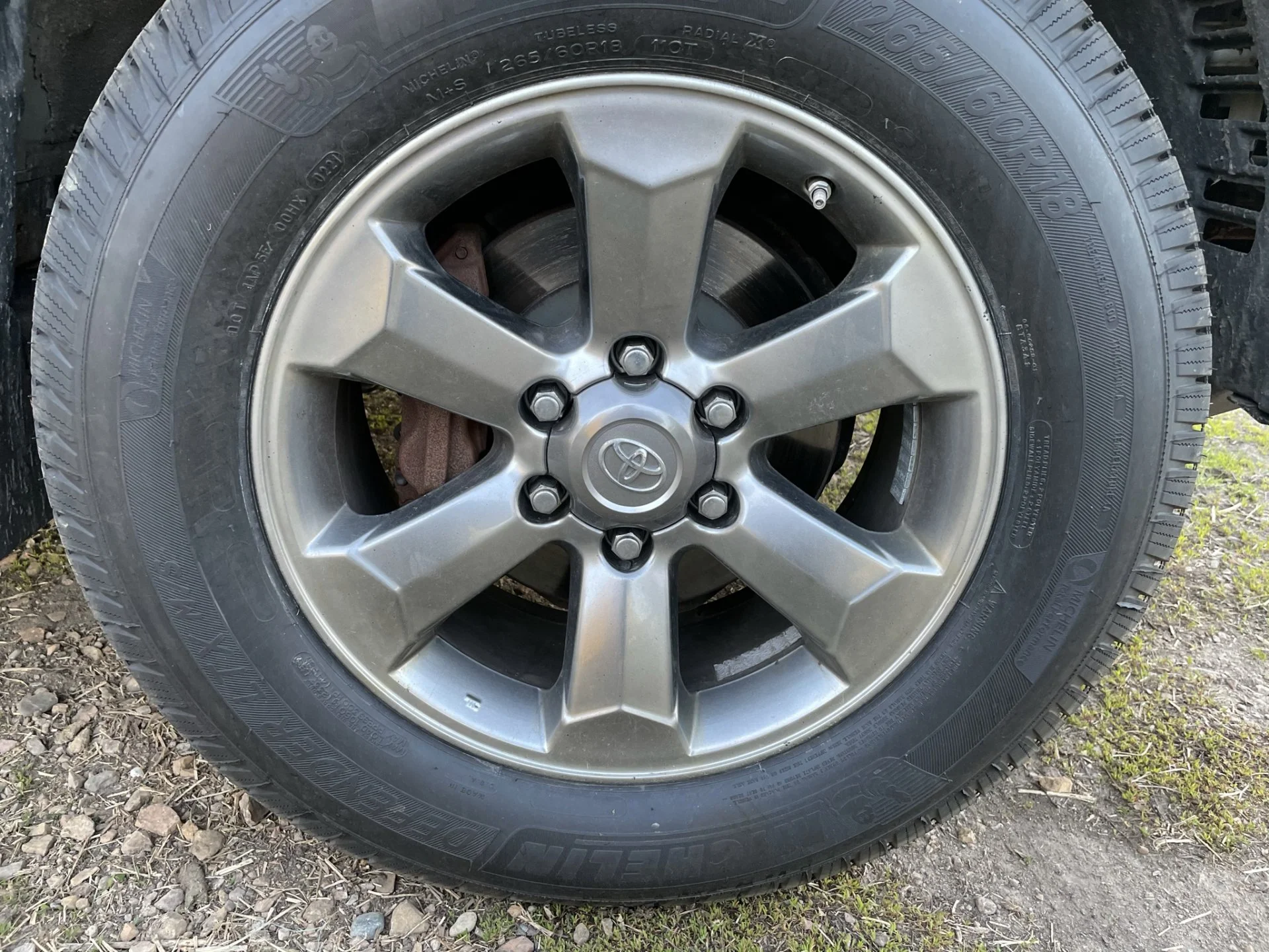

So now it really needs rims and tires. My daughter just bought these New Toyota four Runner Limited rims a couple years ago and new Michelin tires about a month ago.. They look really good on the GX but not so much with the lift. Somebody’s looking for a nice set of rims for the GX and brand new Michelin tires, here they are. This needs bigger tires now!
Michelin Defender LTX 265 60 18
