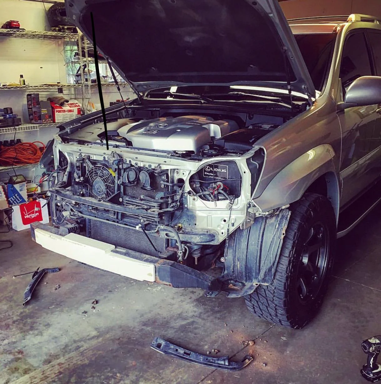

Yes, the front fascia needs to be removed.
JjaTq
Imgur: The magic of the Internet

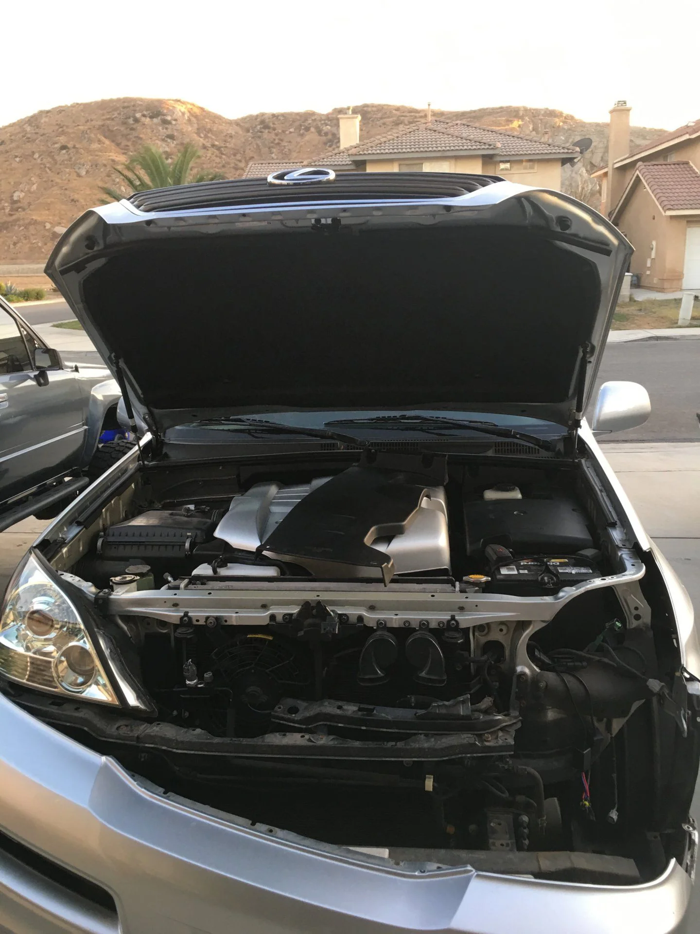

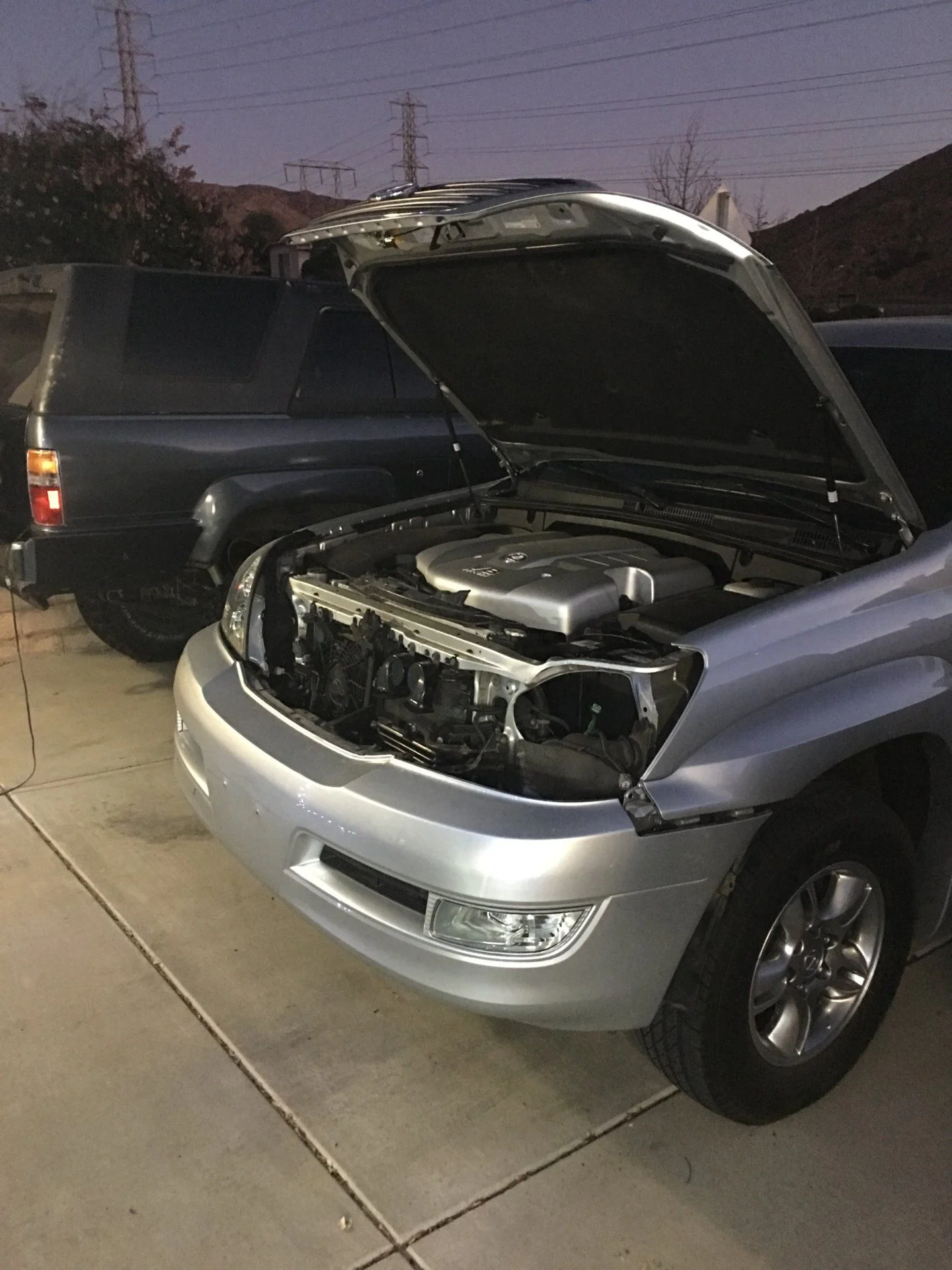

Follow these steps. Then remove the pieces on the ground in Blackcats photo (2 nuts and 1 bolt). I kept trying to wiggle the light out but it’s impossible until you pull those supports.
It’s not too bad, I replaced both in about 90 minutes taking my time and I’m no mechanic haha.
