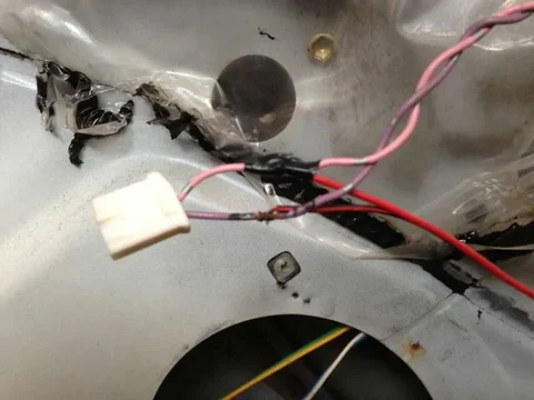

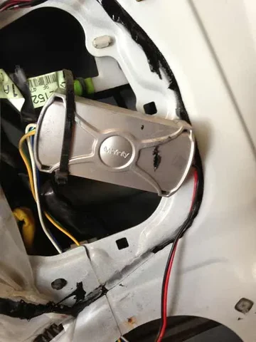

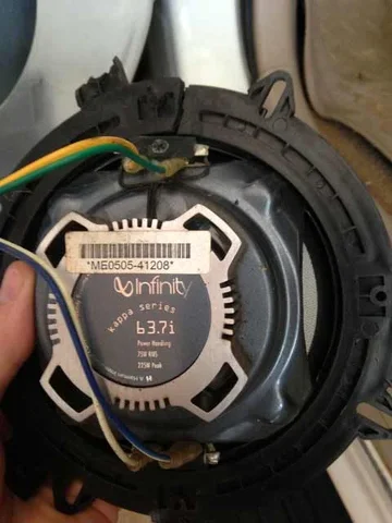

I removed the panel to find I have Infinity speakers. Whoever installed them just taped the wires together. I cleaned up the connections and nothing.

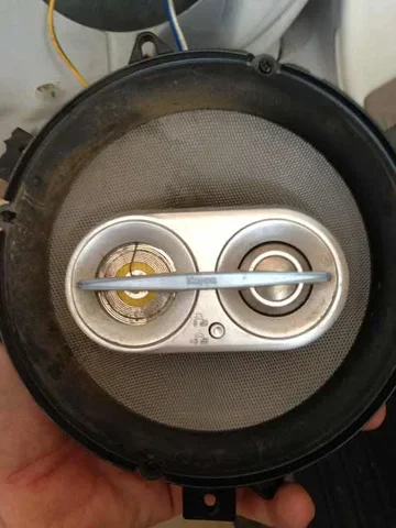

Then I removed the passenger side panel so I could swap the speakers. The driver side speaker worked on the passenger side. The passenger speaker didn't work on the driver side.

So if you have continuity in the wire from the amp to the door and a working speaker (original DS side speaker), you can use it to test the amp. Hook it up back up on the DS with a good connection and see if you get sound. If so, the amp is probably ok, since you got sound out of both sides with known good speaker. If not, it's more likely the amp. Given the awful wire connections (including those going to the crossover?), I'm voting for bad wiring or a bad speaker instead of a bad amp. By the way, you can also check a speaker with the ohm meter. Once the speaker is disconnected, the resistance across the woofer terminals should be close to what's marked on the speaker.
I hooked the old speaker up with crimp connections and still nothing.
Since the both speakers worked when hooked them up on the passenger door, I'm guessing their OK.
