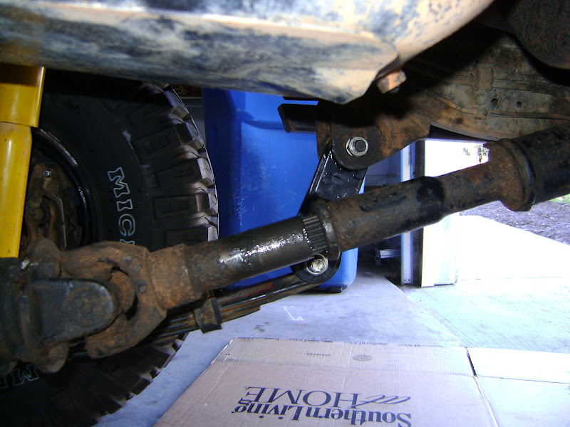

In this pic you can see that the shaft is extended about 2" more than before, the greasy area.
Does the compression bottom out when the yolk hits the smaller part at the arrow on the right?

You never need a shaft balanced if it is straight. The factory does not put the effort into making each shaft perfectly straight. Does not make economic sense. Any shop doing them one at a time should. Few do. :)
In an SR situation, the dif moves away (forward) from the T/C under droop as it also moves away vertically. In the normal fore shackled arrangement, the diff moved closer (rearward) as it moves down. The two motions go a long way toward offsetting each other. Which is why Cruisers have such short slip joints. In the OEM setup, the pinion also points upward more as the diff droops. in the SR, it points down more. All of this equates to a greater movement at the slip joint as to steeper Ujoint angles.
These are some of the things everyone should understand before undertaking an SR.
If you just lengthen your DS after your lift and SR, You may find that it is a good length when drooped, but that it bottoms out when compressed. Or if it does not bottom out when compressed, it may pull loose under droop.
The spacers you are considering.... result in a steeper Ujoint angle because they effectively shorten the distance between the ends of the DS.
Might work for you.
Might not.
Mark...

Just remain concerned about the travel in the drive shaft spline. With a shackle reversal you cannot afford to over compress your driveshaft,(which you can easily do because of the geometry and relationships of the leaf springs and shackle). It will do extremely bad things to your transfercase. If there is any doubt, at all, get a longer spline put in there. Remember a spacer re-establishes the right length, but actually takes up some of the compression stroke of the shaft.
Over time I have come to like the SR I did on my 40. I'm not going to bust your chops for that. The approach angle is much better. You just have to accept that spending money on additional required mods is just part of the game.
