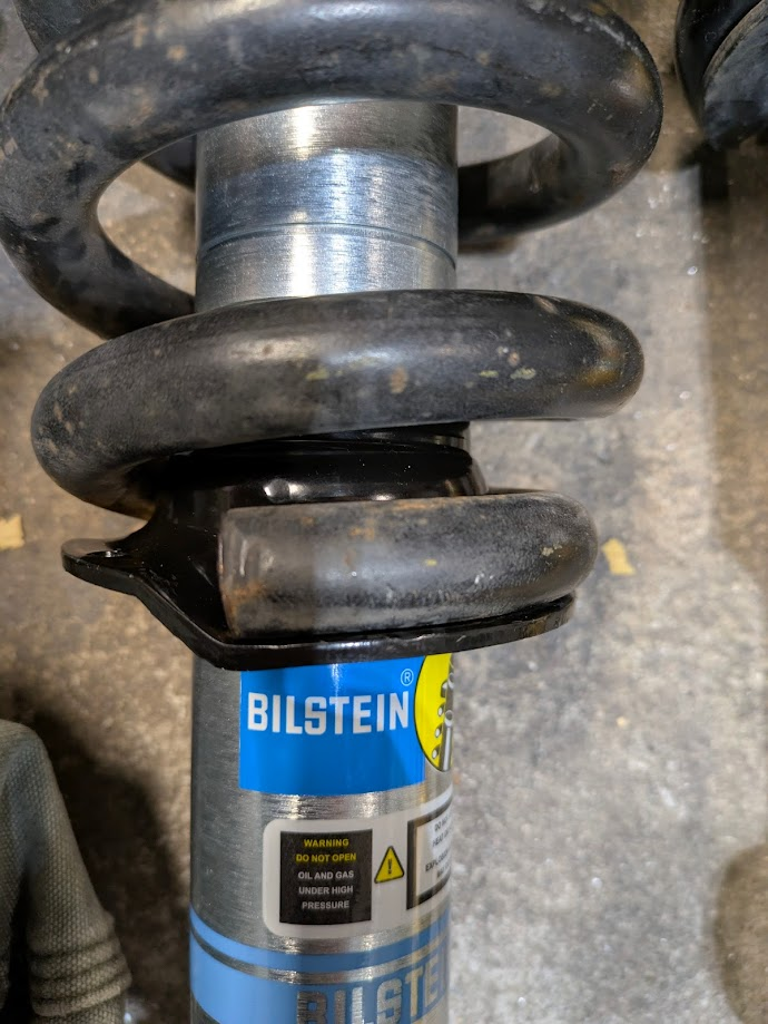

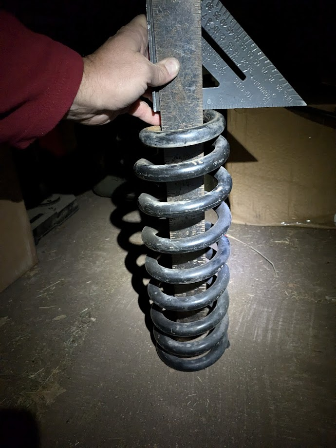

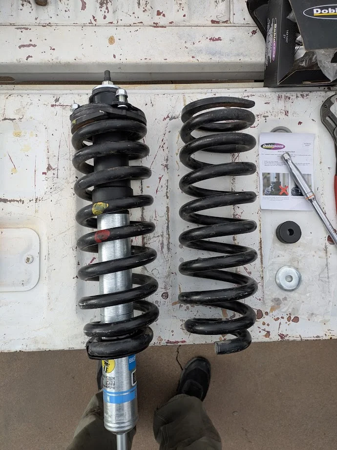

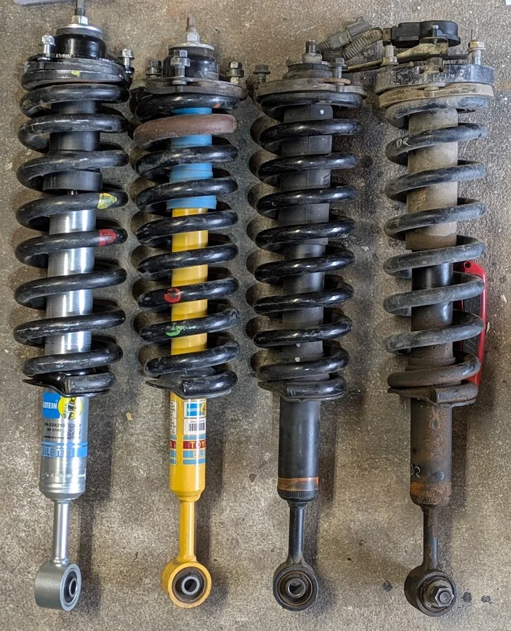

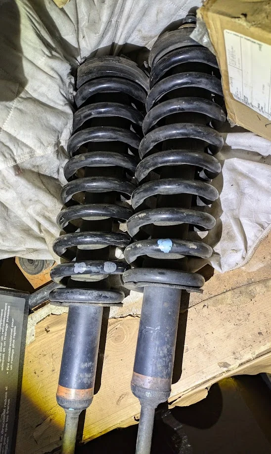

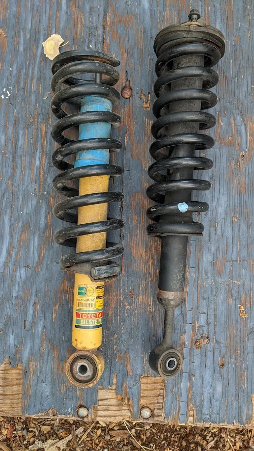

Notes to self [and y'all] about some scavenged Toyota springs and unknown spring rates....
These are as follows left to right:
gen 1 Tundra Lt (06 crew cab, TRD OR 4x4), 2019 Taco TRD OR center, GX 470 rt
Lexus GX 470 take-offs: 17mm coil diameter
grey/grey and blue

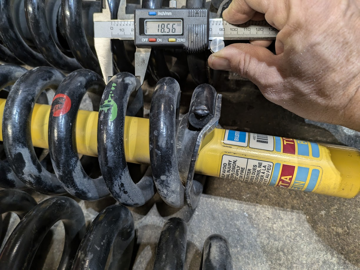

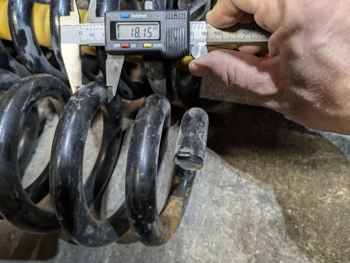

2019 Taco TRD OR: 18.5mm coil diameter
red/blue(maybe grey) and red/green
1st gen Tundra (2006? TRD OR crew cab 4x4): 18.15 coil diameter
Driver 14.75" tall
Pass 14.5" tall
Tundy coils a scosh overall wider but they'll seat on lower spring perch and upper tophat okay...

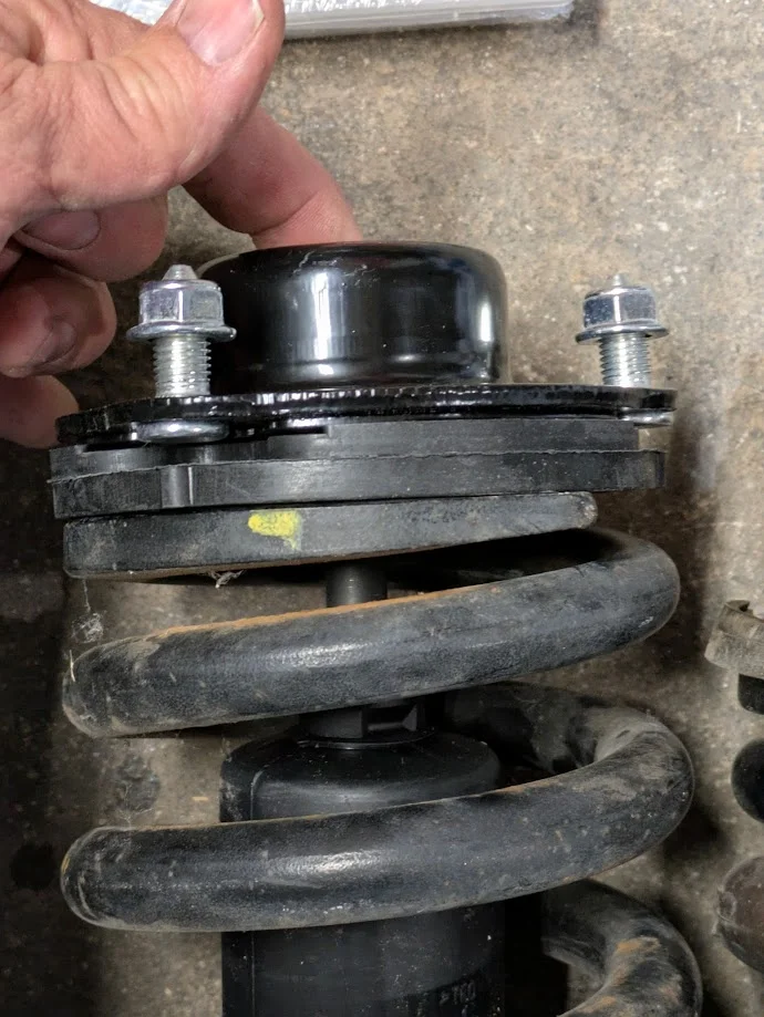

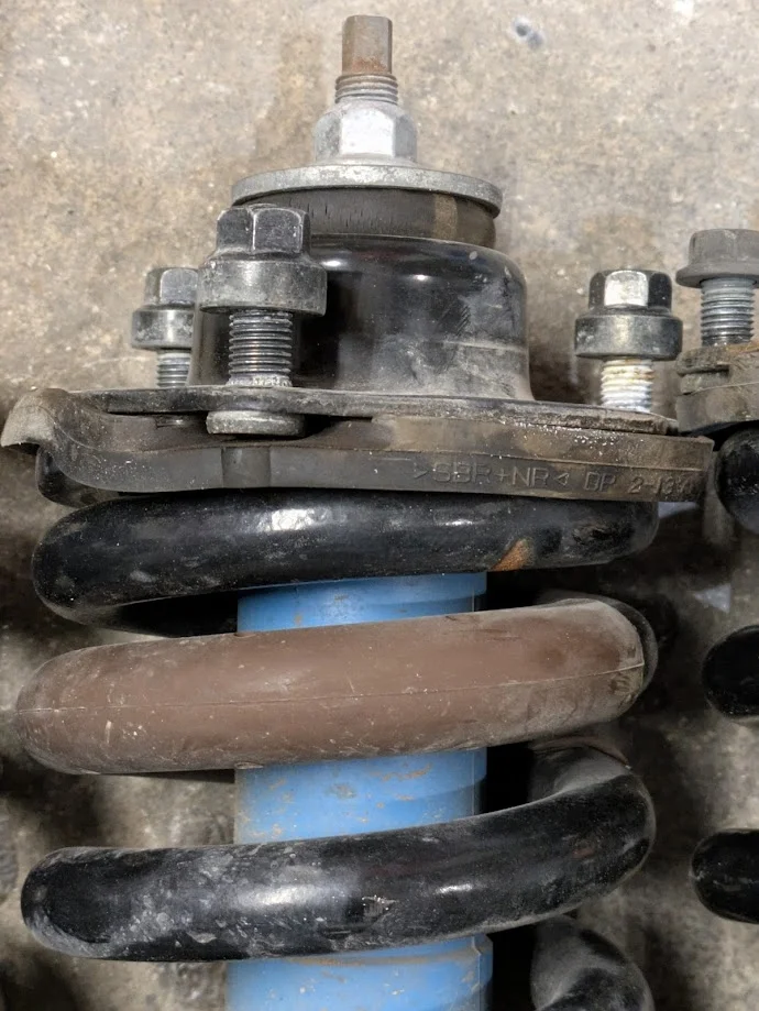

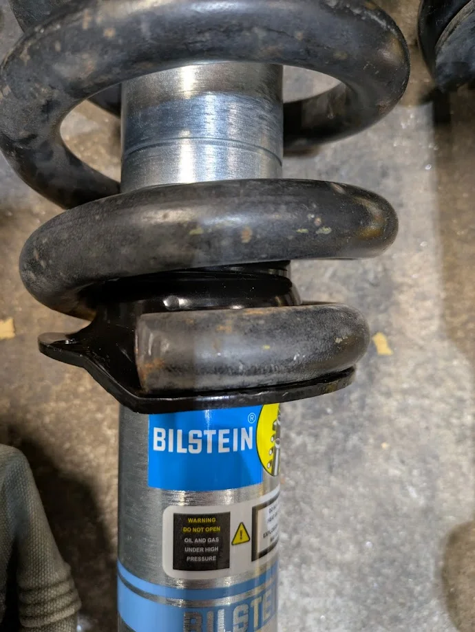

lower spring perch:
GX-Taco-Tundy
Tuphat (Hmm, those Dobinson's tophats look tall like Taco....)
GX-Taco-Tundy

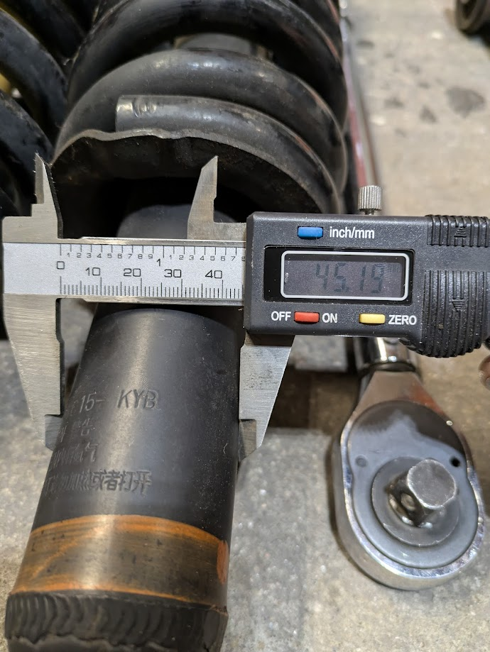

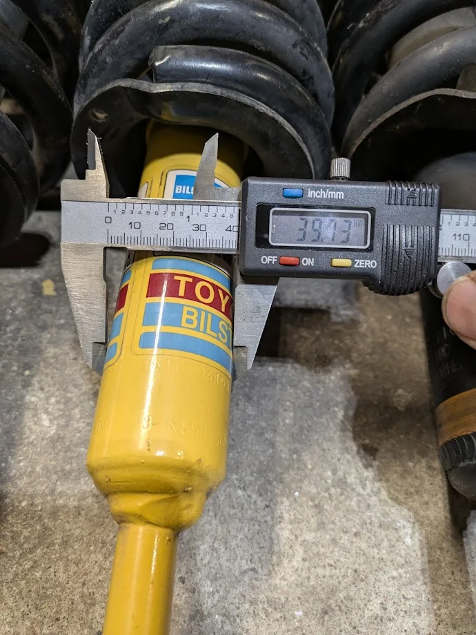

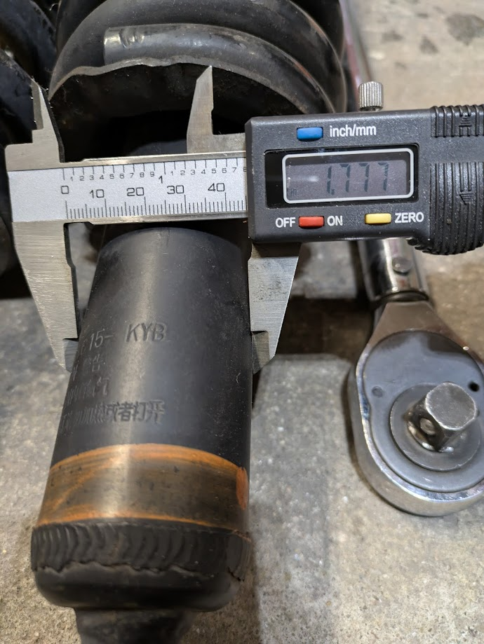

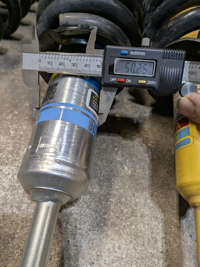

Shock body diameters
GX-'19 Taco TRD OR-Bilstein 5100 (B*-324359)

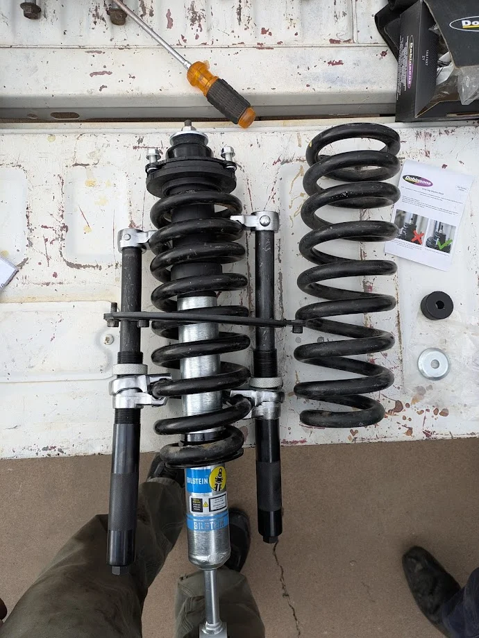

Way nicer to use this style compressor than the Janky parts store loaners!!!!
I still hate those compressors. Unless it is a wall mount unit I don't even bother and head to the local shop. Scary!
TBH I've never had a problem with the threaded spring compressors. I put the shock/strut in a bench vice and use a $40 set of OEMTOOLS compressors from to compress the spring and let off the tension with my M18 impact. I've probably used it on at least a dozen struts/shocks.

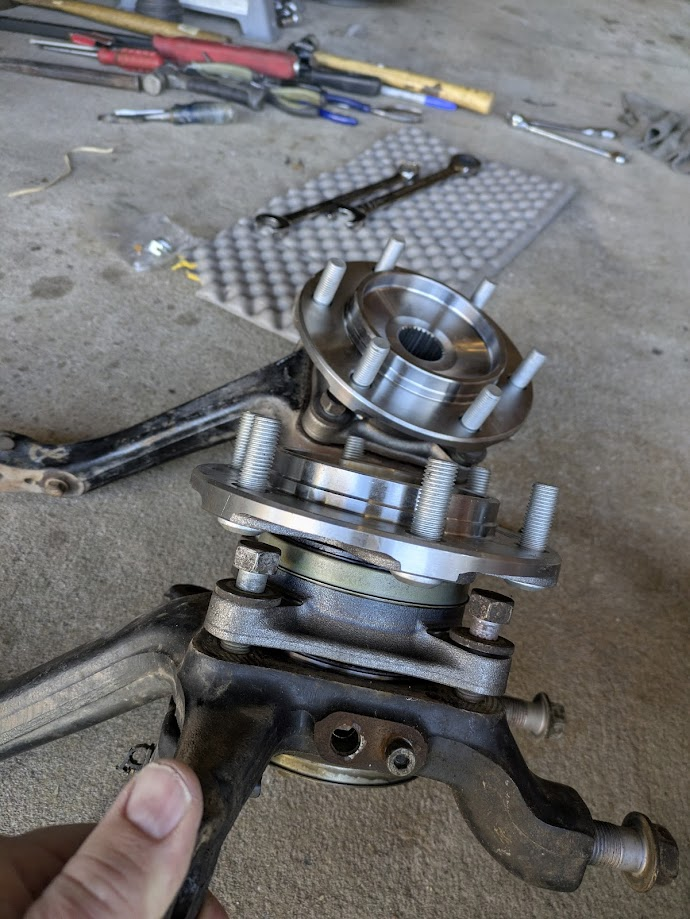

Alright, I got the hubs pressed into the Toyota bearings
BIG shout out to Rich a new mobile mechanic in Moab!!! When in Moab, hit him up for repairs and i guess even some trail recovery work.

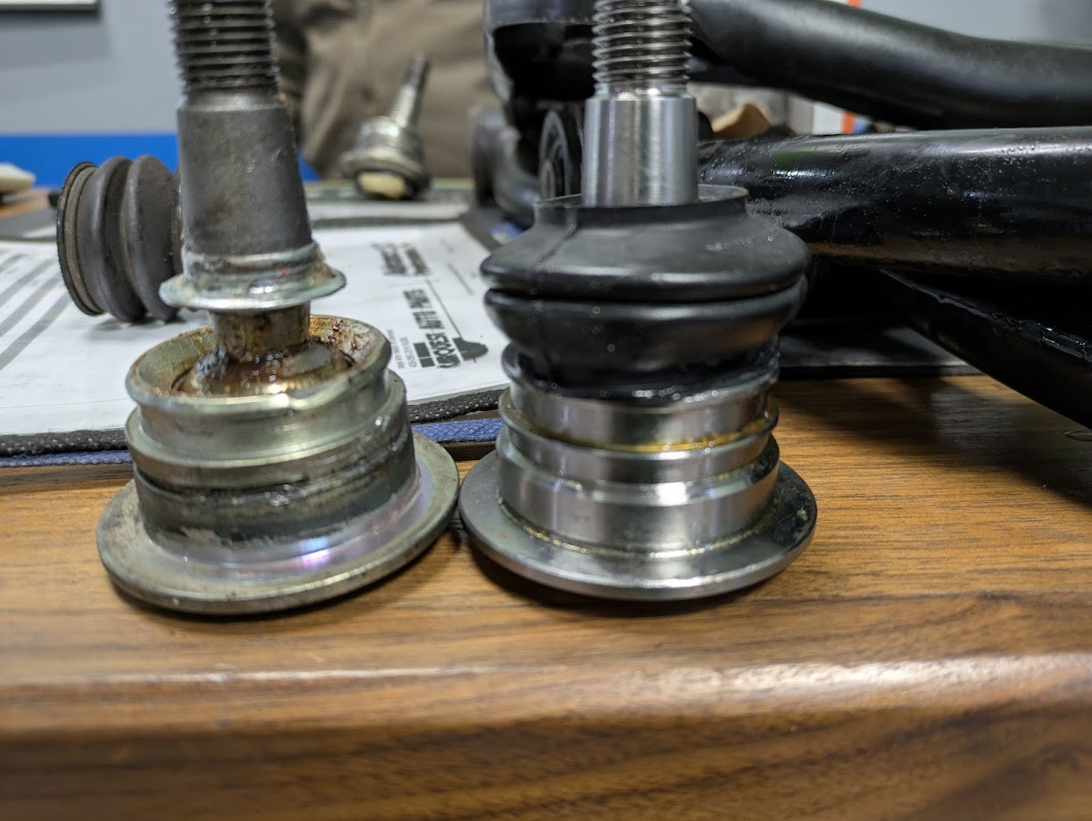

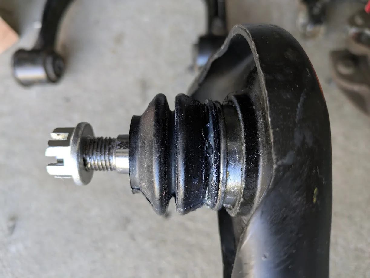

The 555 upper ball joints did NOT fit into the 2019 Taco UCAs....
So there's something more than just the shaft taper and length difference across those ball joints.
(Don't ask why we didn't caliper the 555 vs the taco UCA opening first 🤦)
*EDIT*
Mic'd, the diameter of the taco ball joint is 1mm less than the 555 spec'd ball joint for the GX 470...
So there's yer answer! 😫🤦
As such, Back to rock auto for some loaded GX UCAs. 🤷

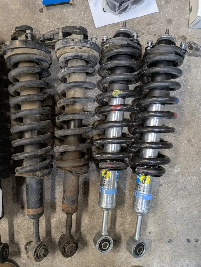

And another week down.
outer tie rods swapped, Pass innser CV seal swapped and CV installed, LCAs ready to go on with new Toyota alignment kits (to be anti-sieze gooped)
5100 loaded with Tundra coils.
Hmm, I just noticed the on the GX strut take-offs, Driver side coil has fewer winds than the passenger side that I pulled out of the GX!
Interesting!!! I need to recaliper everything now for driver vs passenger!! LOL
