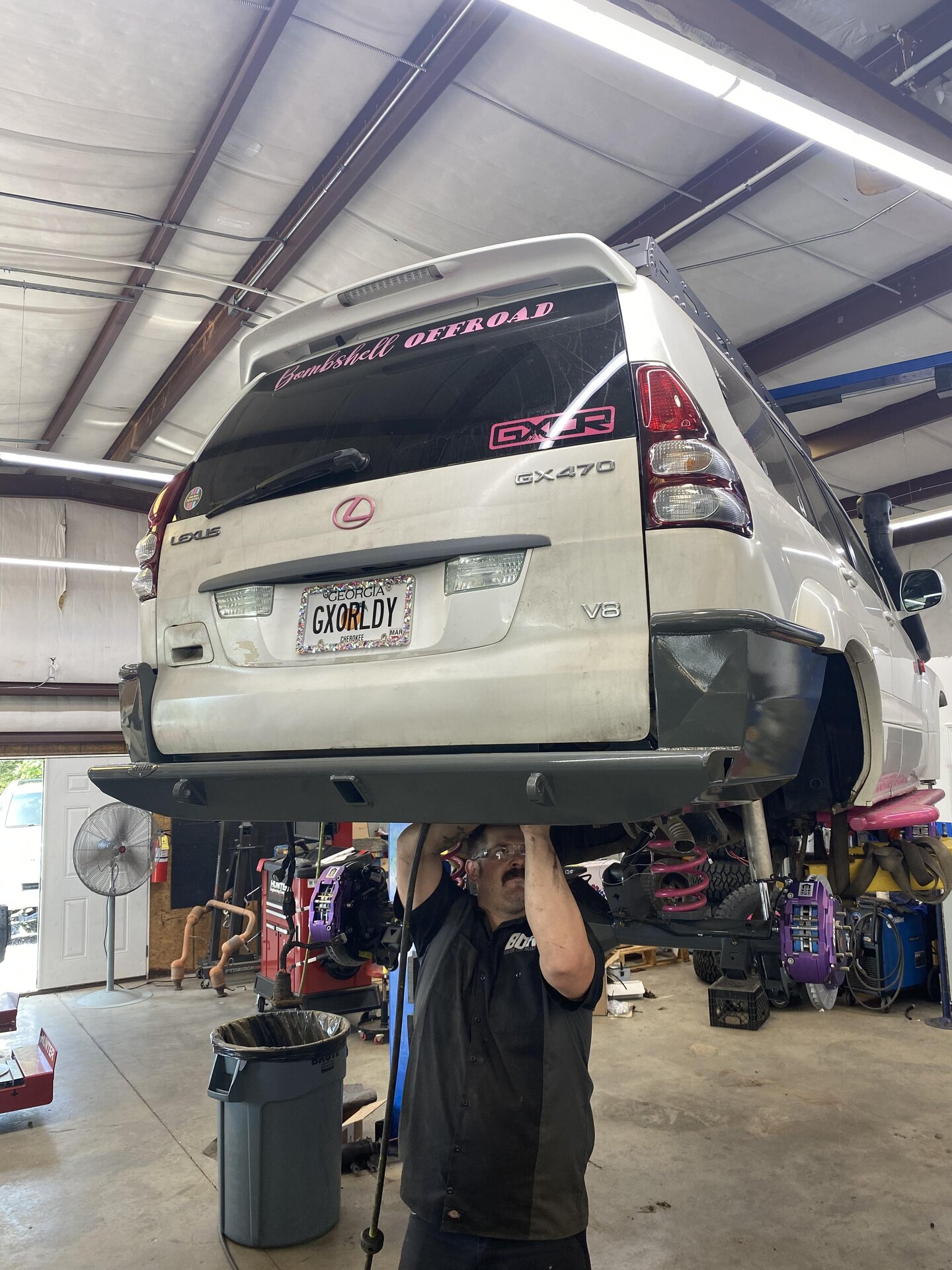

#5 does not bolt to the frame. I got the long arm so I have one swing out. Not sure if he is showing the beefed up hinge bracket he made for me to support the long arm. I didn’t like the ide of those latche hooks in middle of the bumper. I also reinforced the vertical parts with some extra steel I had laying around. I have a few pics in my build thread. I have towed a full 6x12’ uHaul trailer 1,000 plus miles no problem with coastal hitch.

I got it in summer of 2019, after that Moab trip. Been happy with it, swing out has been great since the new hinge bracket. Coastal is great to deal with. Your idea of cutting a larger hole would require you to go inboard from the light cutout and I think you would hit the frame. I‘ll look at it once I get back home in a few days It’s been a while and I just don’t recall how it fits around the frame back there. Seems like it was tight,
You can’t realty see anything once installed due to plate 1. Just judging by what I can see and kinda feel, I’d say #5 is pretty much against the frame.

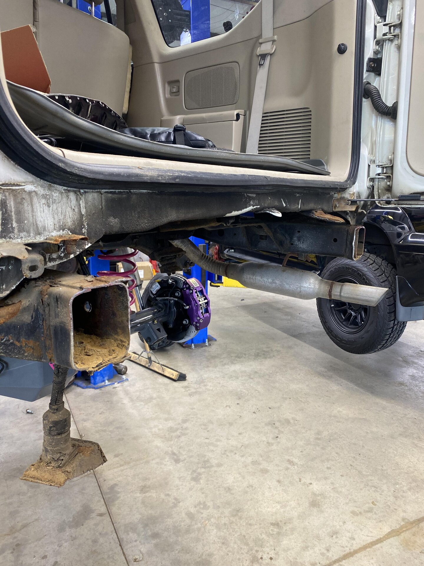

I don’t think there would be a way to acces that plate to bolt it to the frame as that plate sits on the outside of the rail. Might be worth a call to ask them how the recovery points have held up under hard pulls as I would be surprised if they have not received some feedback either good or bad. I know the strength will depend on weld quality. I have only had really hard pulls on the front of my GX.

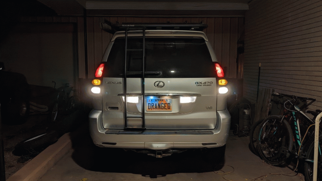

I think I'd ask for no holes cut for reverse lights (have Prado tails AND stock door reverse light now), but I might want something to break the plane of that rear panel... Hmm...

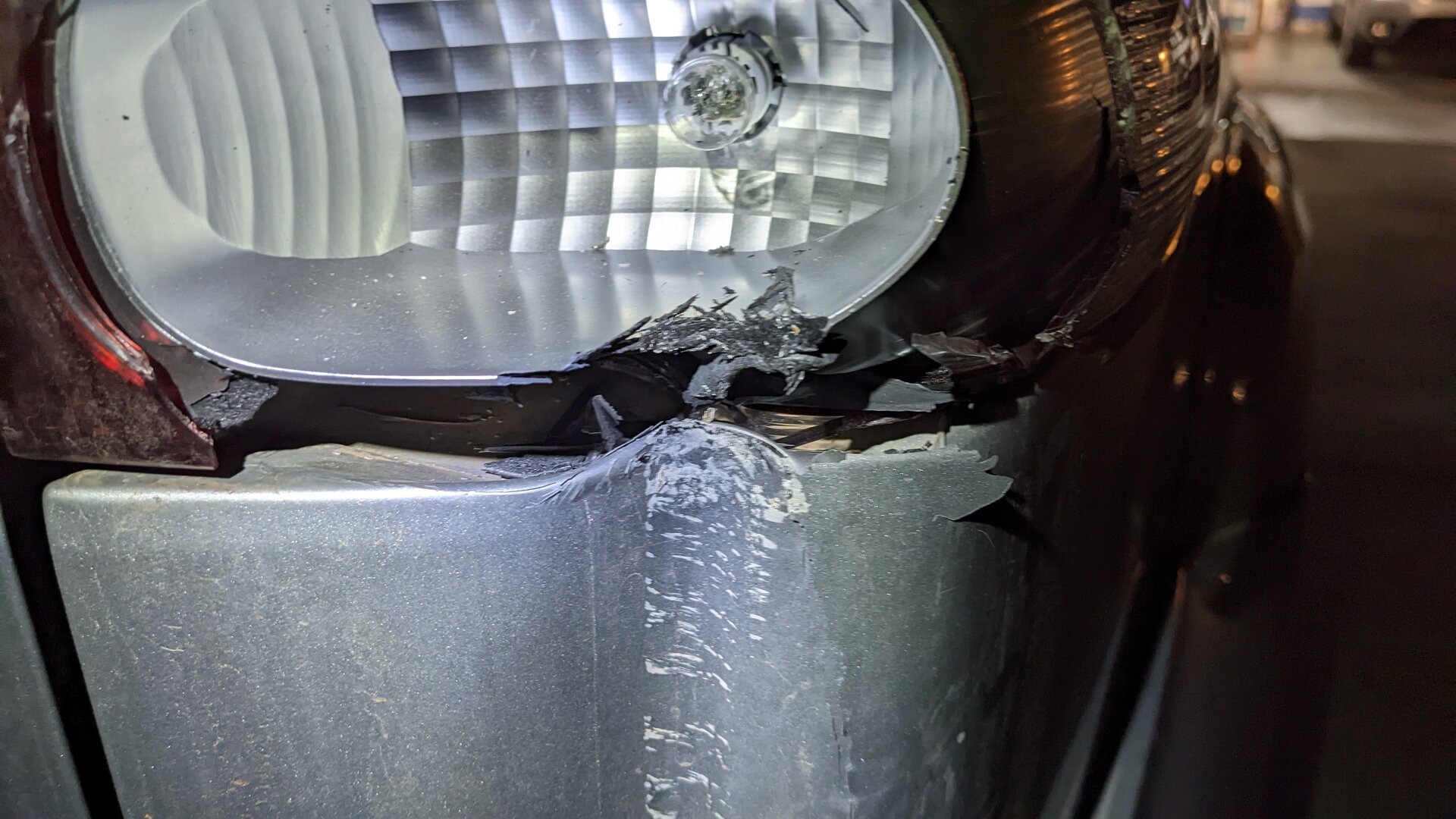

I'm nearly 100% in for this bumper, so that's not much of an issue on my side. I'll need to coordinate with the body shop to see if I can take stuff off and look, and if when it's all stripped if I can mount and finish the bumper after they do the body work. Another issue is my bumper skin now compromised on the pass side, so new skin to cut up, or heat gun and massage the old into reasonable shape and fix with epoxy and sanding... or metal fab to fill that piece, @carolinagx has a good version. . . 🤔

If you ever add Jerry can or spare tire carrier it may block those reverse lights or might make them less effective. Something to think about before you delete the holes.

Just get Prado tail lights. You can move the reverse lights out to the housings when you install them. Takes one split and two wires with a repin at the tails. Prados have tires on the door so they come with OEM reverse out on the tails.

I have Prados Dan, 🤙🏼and Less that 2 week after install, I backed into a damn pole...😤
Thus the hope for a bumper via the insurance claim.$🤞 😈
