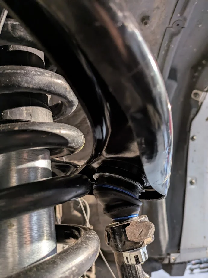

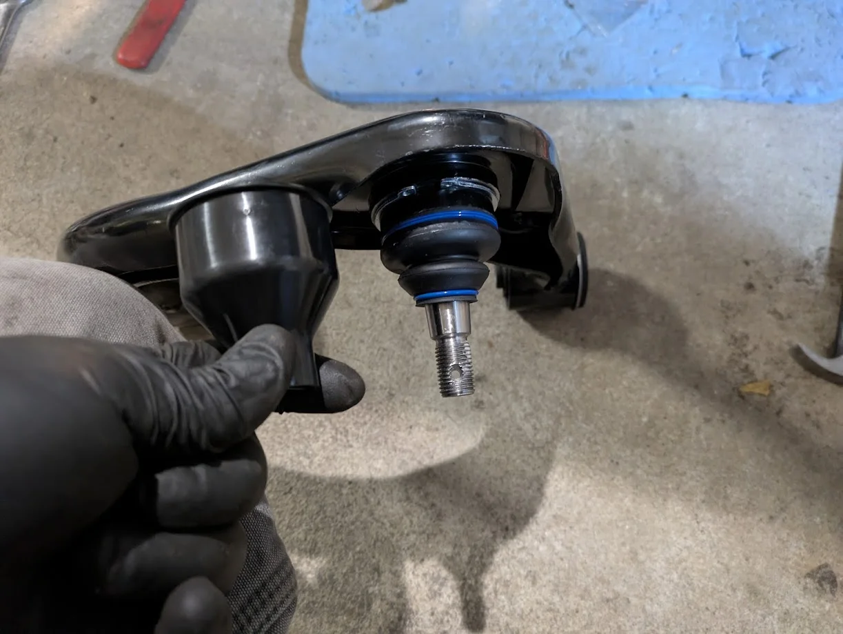

I ended up ordering Delphi UCAs from rockauto (Moog was similarly priced), I did not go with the $30 uber cheapies.
There's a whole thread devoted to the $180ish SPC-like Mevotech adjustable UCAs (using SPC bearing) elsewhere in mud.... Currently they only have the Right in stock... so I didn't pull that trigger.

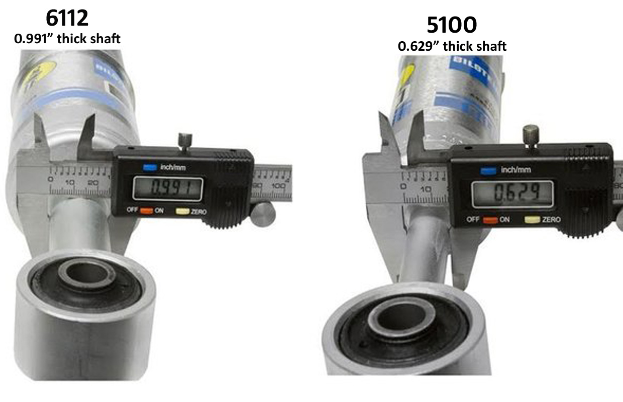

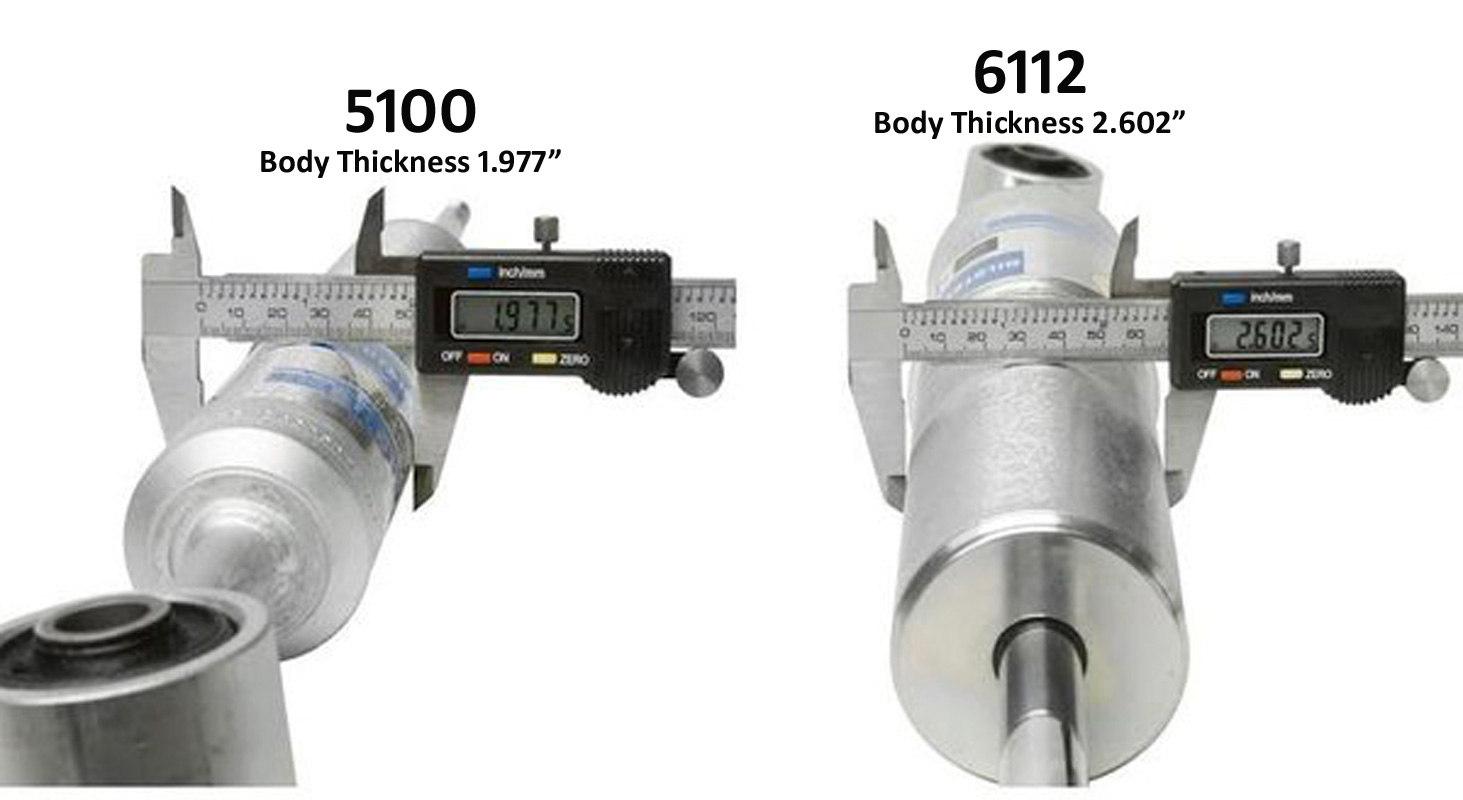

I know you didn’t include the 6112s, but they are 2.6” thick and the bottom rod is way beefier than on the 5100.
I had a picture of someone measuring it with a caliper like you did on the 5100.

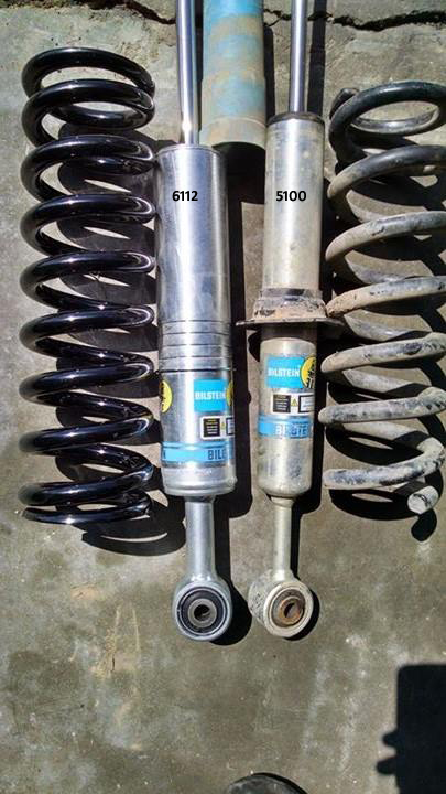

Edit: Found the pictures for comparison purposes…
this is good and I appreciate this addition.

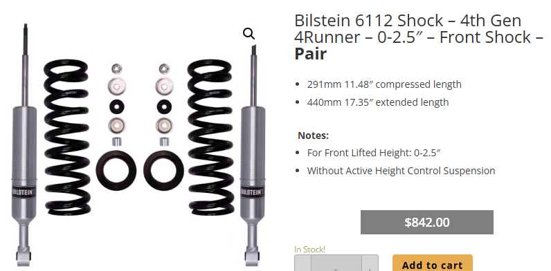

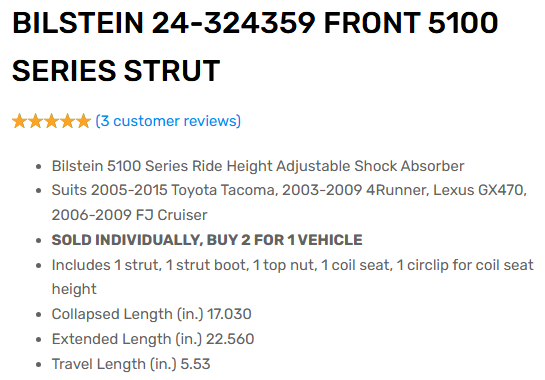

I did some digging, there are other sources suggesting the 5100 adds like an inch of travel over stock, and trying to find comparison extended and compressed lengths this is the best I could do comparing the 6112 to 5100.
your pic above shows the 6112's lower perch is closer to the lower mounting point, maybe this accounts for different spring heights (flat top and bottom for 6112, Oae for 5100), as well as an overall shorter shock body of the 6112 vs 5100.
*EDIT*
-Caveat- my pix; 6112 appears to be an older design w/o ride height adjustability, AND spec'd for a 4th gen 4R. BUT this was the only source I could fins showing extended and compressed lengths for an applicable 6112.
6112: Bilstein 6112 Shock - 4th Gen 4Runner - 0-2.5" - Front Shock - Pair - Slee Off Road - https://sleeoffroad.com/products/47-309975/
5100: Bilstein 24-324359 Front 5100 Series Strut - Exit Offroad - https://exitoffroad.com/product/bilstein-24-324359-front-5100-series-strut/

Those compressed and extended lengths on the 6112 don’t make sense to me.
I was under the impression that the 6112s and the 5100 both get you 1.2” of extra droop because they are like 0.6” longer than stock.

the 6112 also has the floating piston stuff inside which takes up travel space in the body...so if same length they'd have to have less travel b/c of the floating piston design WHICH is what gives it the superior ride quality on DD as well as fast hits/G-outs, slow wheeling and mile-moderate use.
I watched the TA videos, I love his content!! That was one source describing the added travel of the 5100, and the Bilstein marketing info is unsurprisingly vague. THIS is the problem I have with all this stuff (TA aside), it's nearly impossible to find objective rote information not led by marketing...!

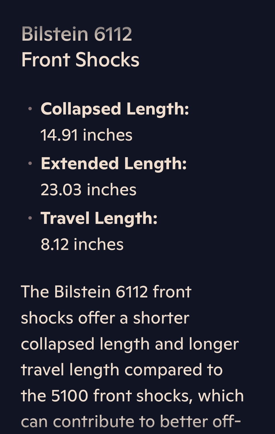

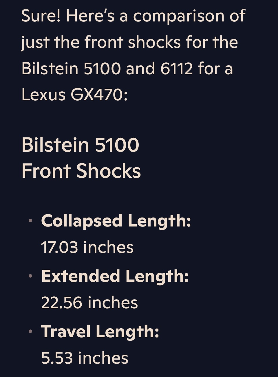

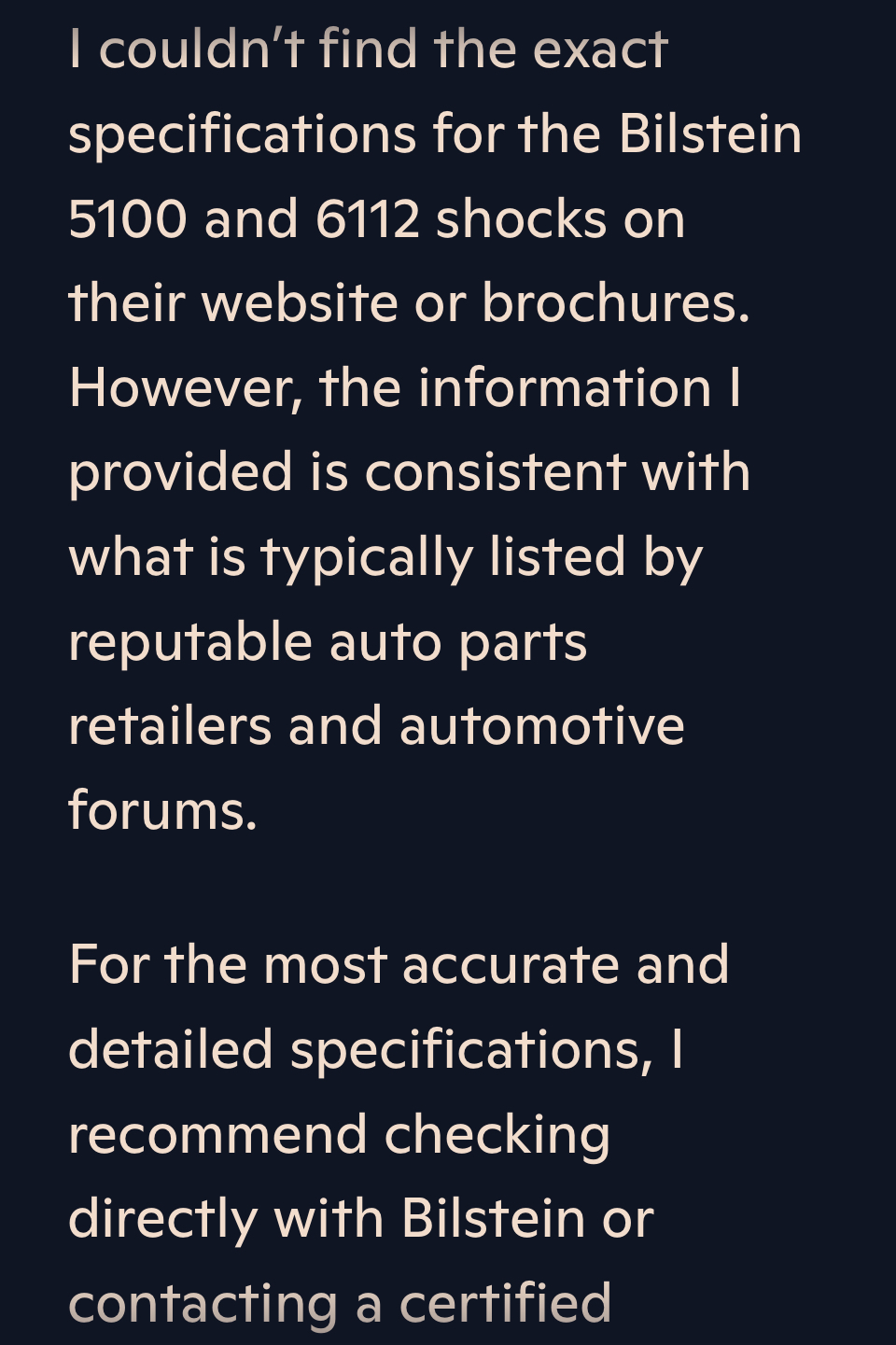

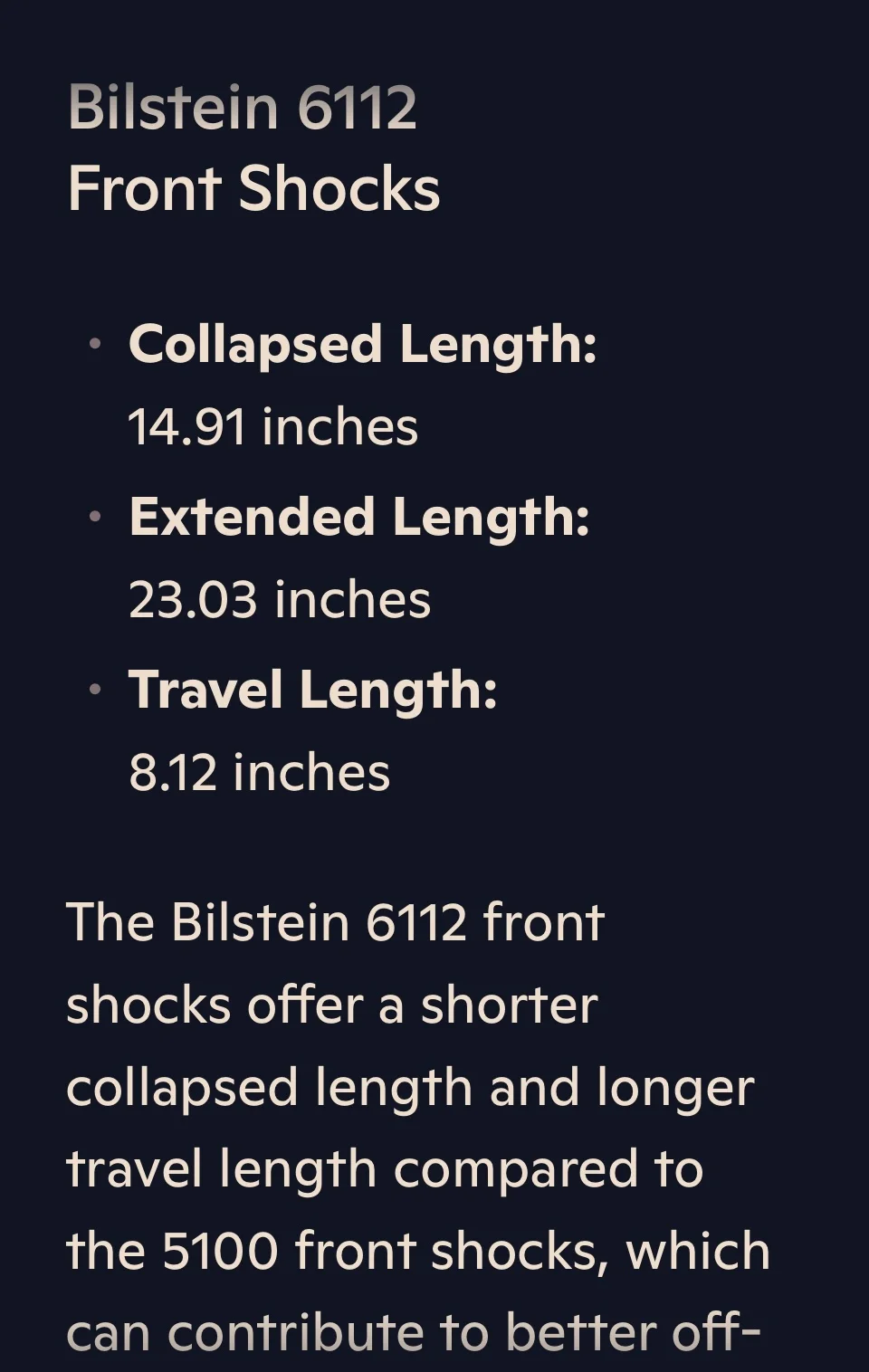

I also asked copilot to find the info and quote the source documents from bilstein…but it says it can’t find it at bilstein and is using information from seller web sites
Even with the floating piston inside, the 6112 has more travel by just looking at the compressed length and the extended length.
Copilot provides numbers way different than what you found.

I don't consider myself a luddite but AI isn't quite there for me yet with regard to accuracy. Its right Bilstein doesn't list 6112 lengths as it does the 5100, and various 'reputable' YT reviews agree the 6112 is BadAz...

Until then I need to return a UCA I received today as I got two lefts. DOH!! :bang: 🤬
there goes ANOTHER week!!!
purported full droop clearance of loosely fitted 5100s, tundy springs, Delphi OE UCAs
not gunna lie. AI searches are intriguing. . . .but just not quite reliable.
I tried a few Gemini searches which returned conflicting or inaccurate info. 🤷‍♂️

Right…I couldn’t find specific info on the 6112 either.

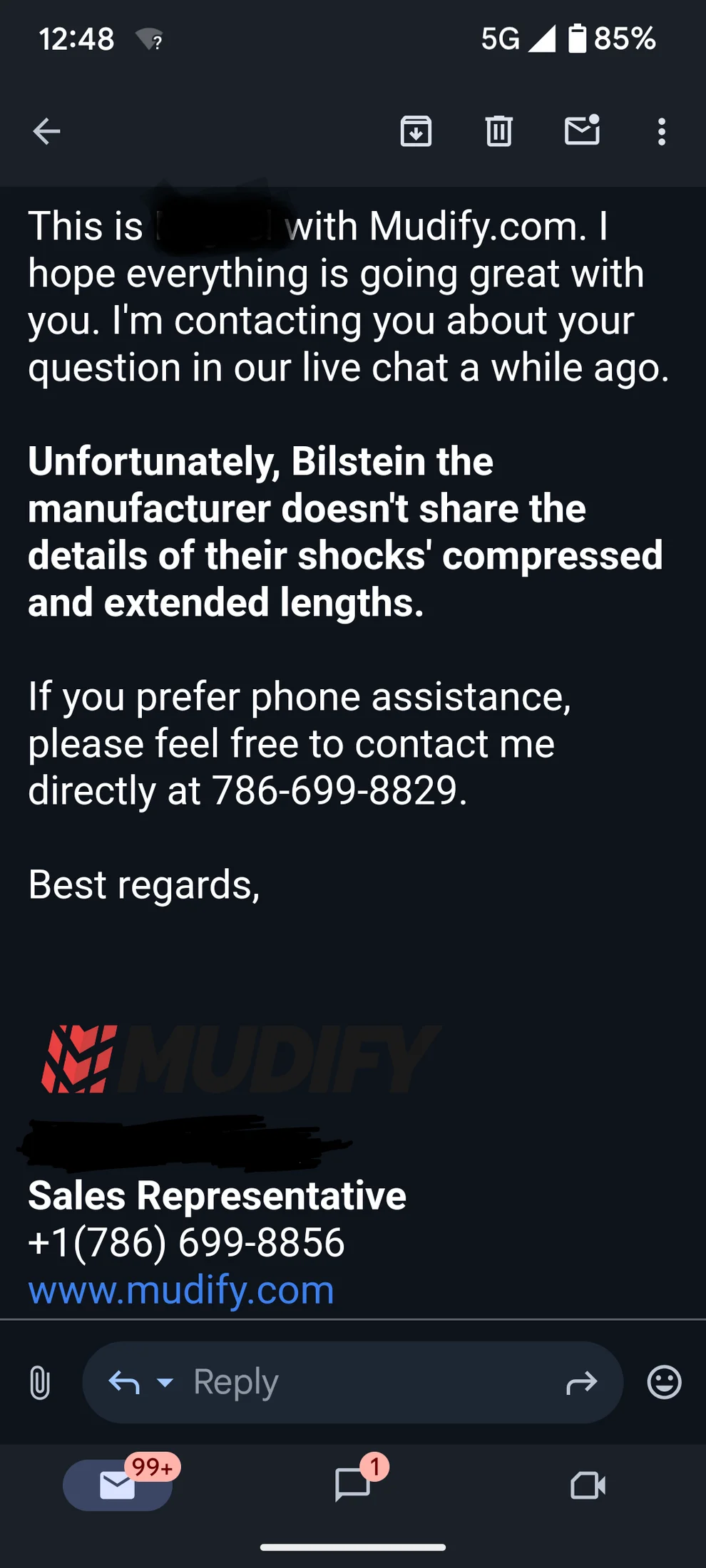

Email reply from Mudify (Bilstein lifts seller)... Seems the 6112 specs just aren't out there they way the 5100s are published. 🤷‍♀️
(Name removed)
Email reply from Modify (Bilstein lifts seller)... Seems the 6112 specs just aren't out there they way the 5100s are published. 🤷‍♀️
(Name removed)
It’s frustrating not to be able to get the specs.
A shop that assembles them should be able to measure them by compressing them and extending them. At minimum get the travel distance.
I could have done that when I disassembled them to move the circlip up for a higher lift.
Well... isn't that special!

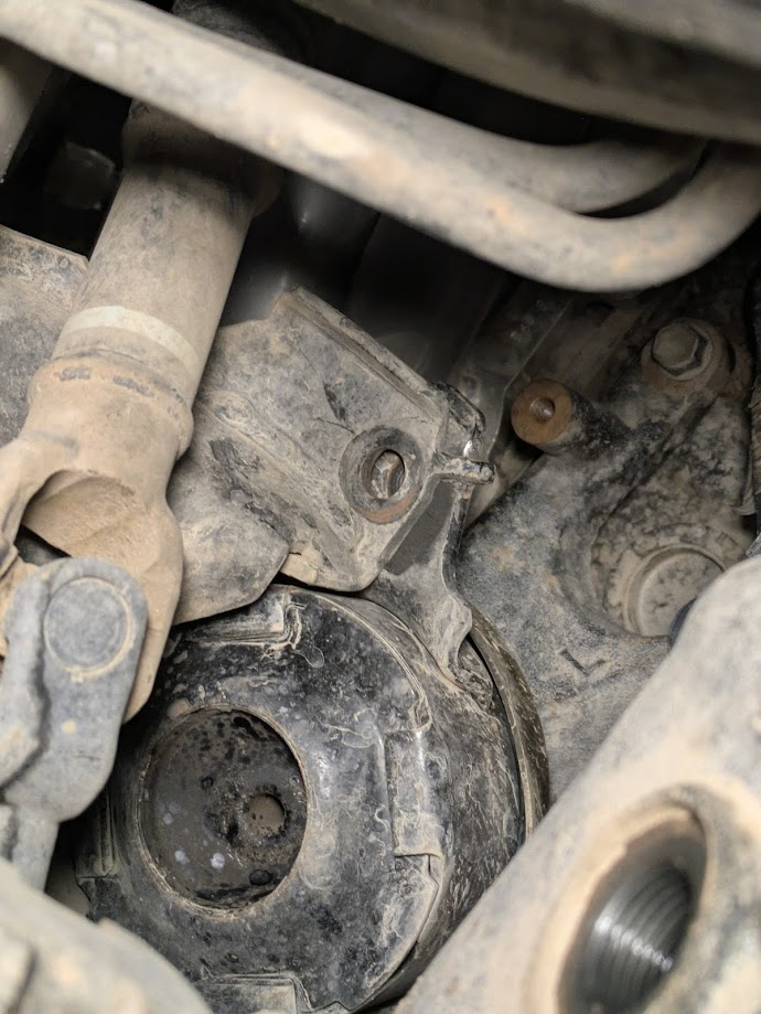

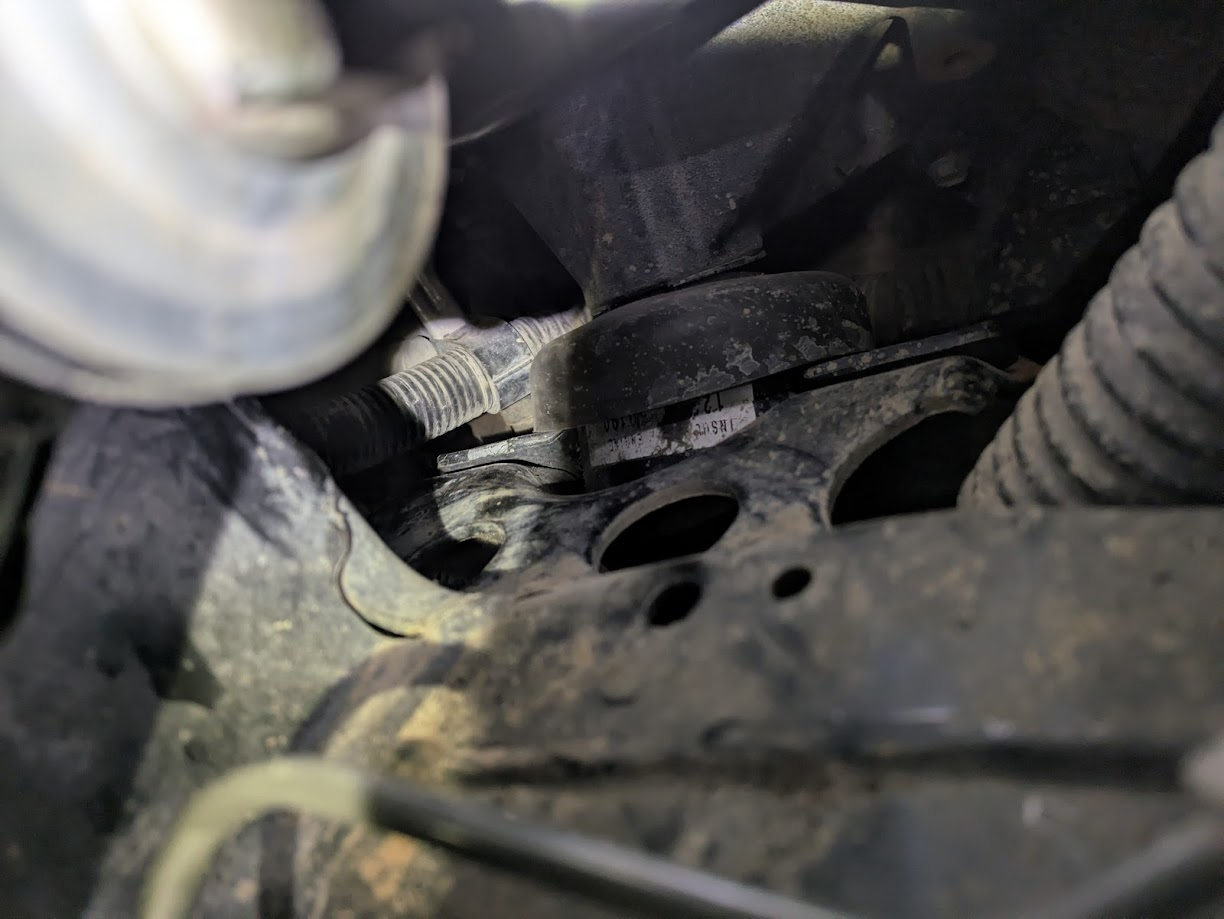

while bit by bit buttoning up the front end and fixing to top off the front diff fluid I noticed my driver side engine mount was missing both bolts! Hmm...
I'll throw some JIS10.9 M10x1.25 30mms in there! blue loctite I s'pose!
Is this a recent issue after you replaced your exhaust manifolds/headers?
UGH, yeah I can only assume not torqued down and the nuts backed off. Hope that mount's not ruined...
The header job was 2 years ago.
If the bolts drop in from the top at least they'd stay in even if the nut backed off...
