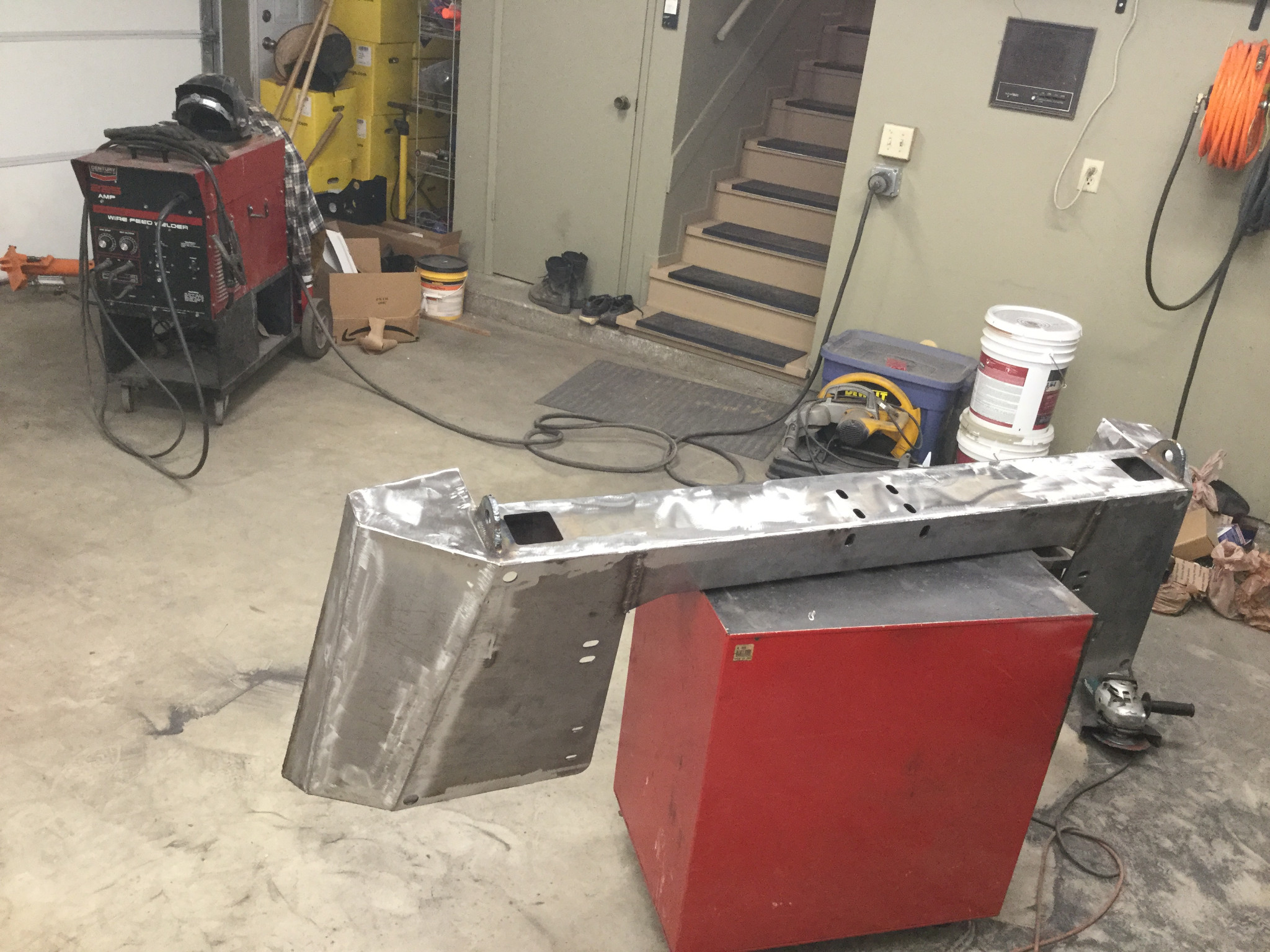

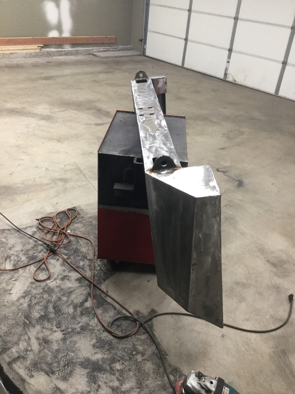

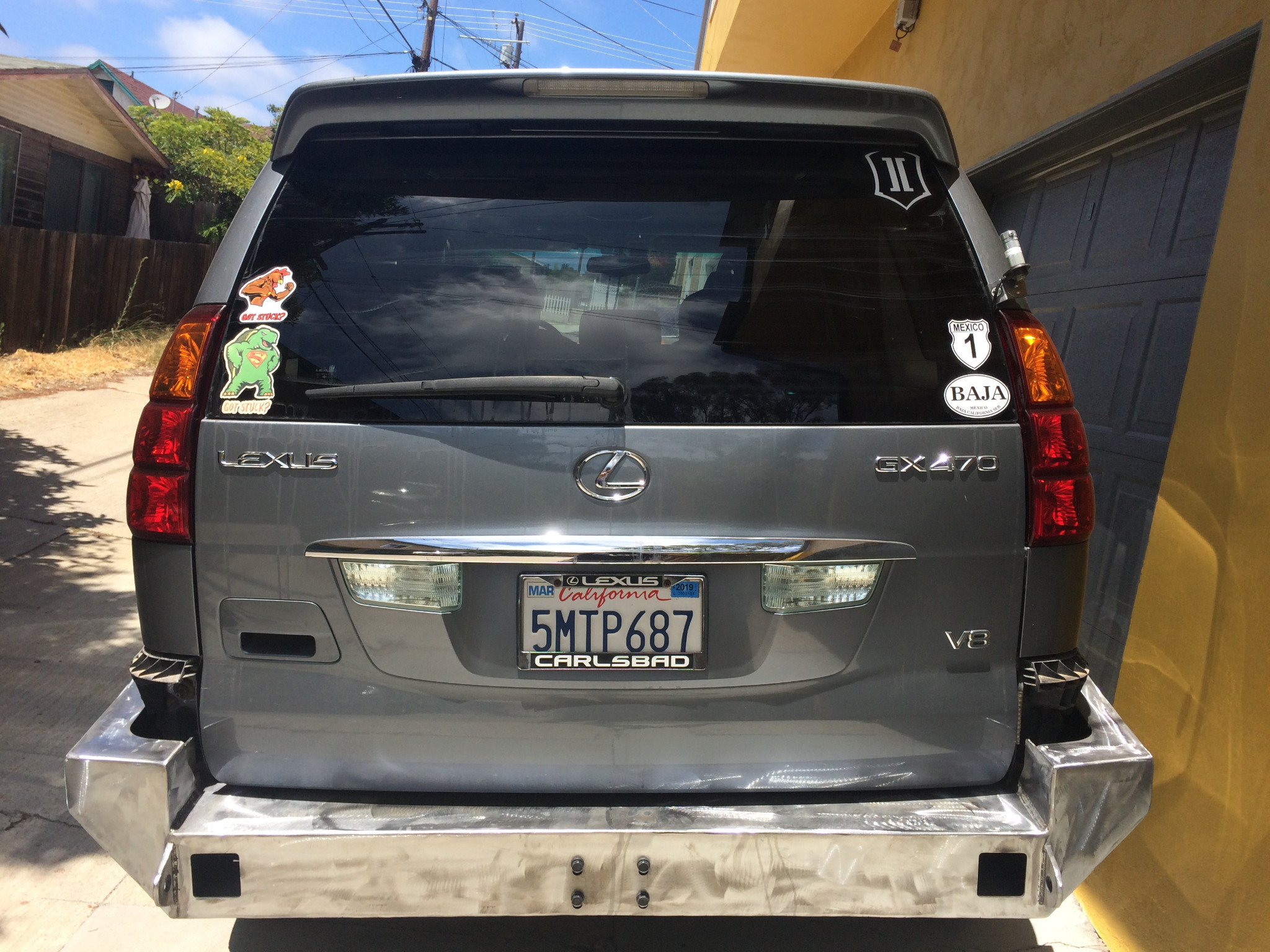

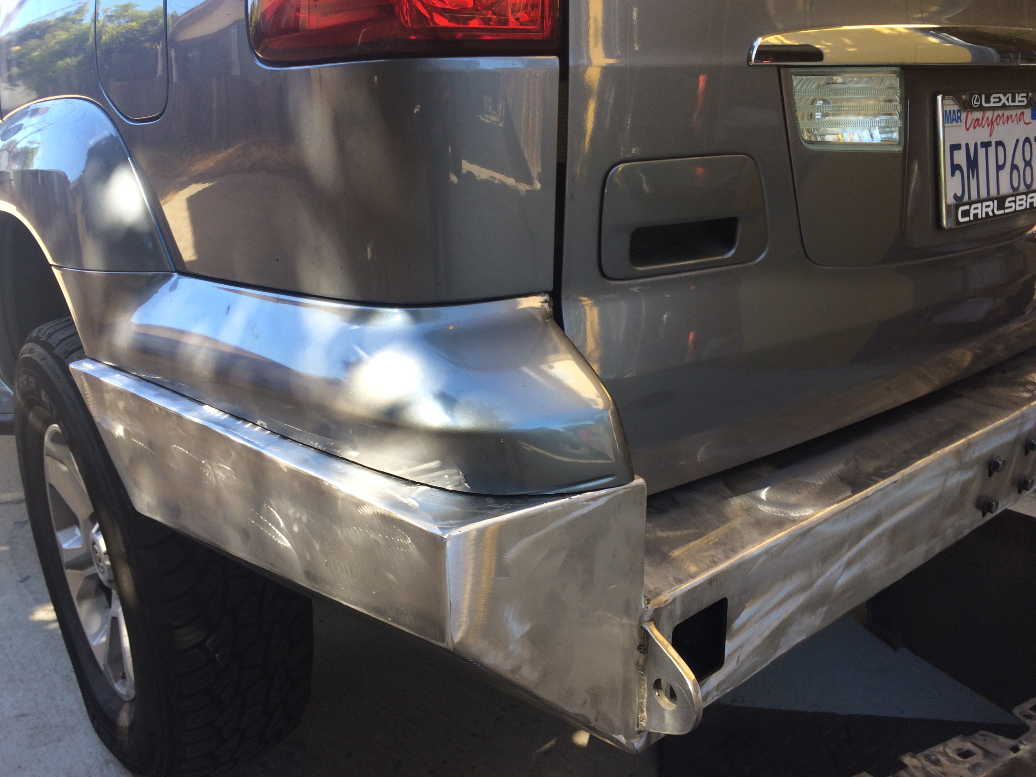

OK, so I finally have an update! My buddy was not able to tack things together and then fit on the truck. You have to bolt up a few pieces and tack it on the vehicle. So while I flew out to Colorado with the family for a little vacation to see family I left by truck with my buddy for a week. Yesterday I went and picked her up with the bumper fully welded and most of the welds grounded down. I really owe my buddy more then I can repay him as he had to deal with an old finicky welder, ran our of wire and ultimately ordered a new welder that will be waiting for me to get all of the pieces for him to build the tire swing.
Some picks of the bumper removed and spare out before dropping it off at his house.
Here are some build photos he sent me after he had it all welded up and started griding.

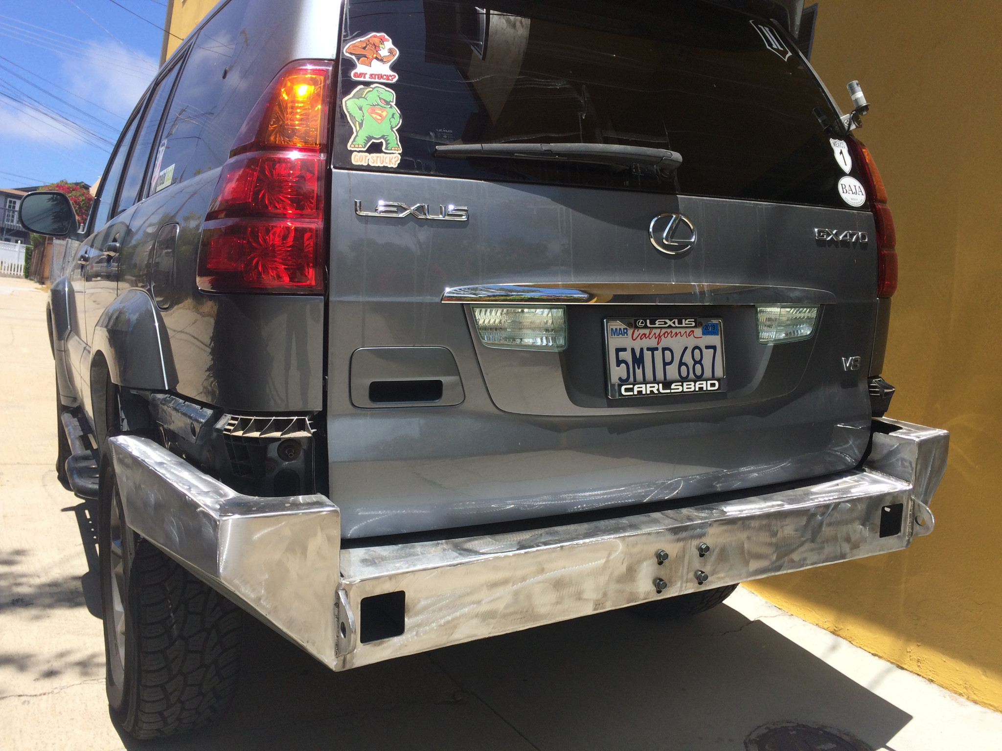

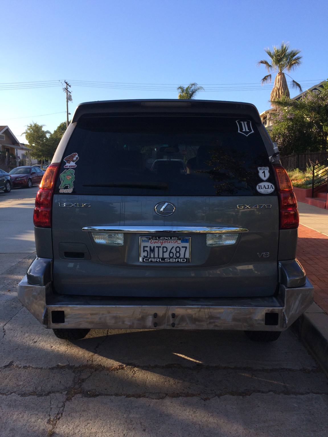

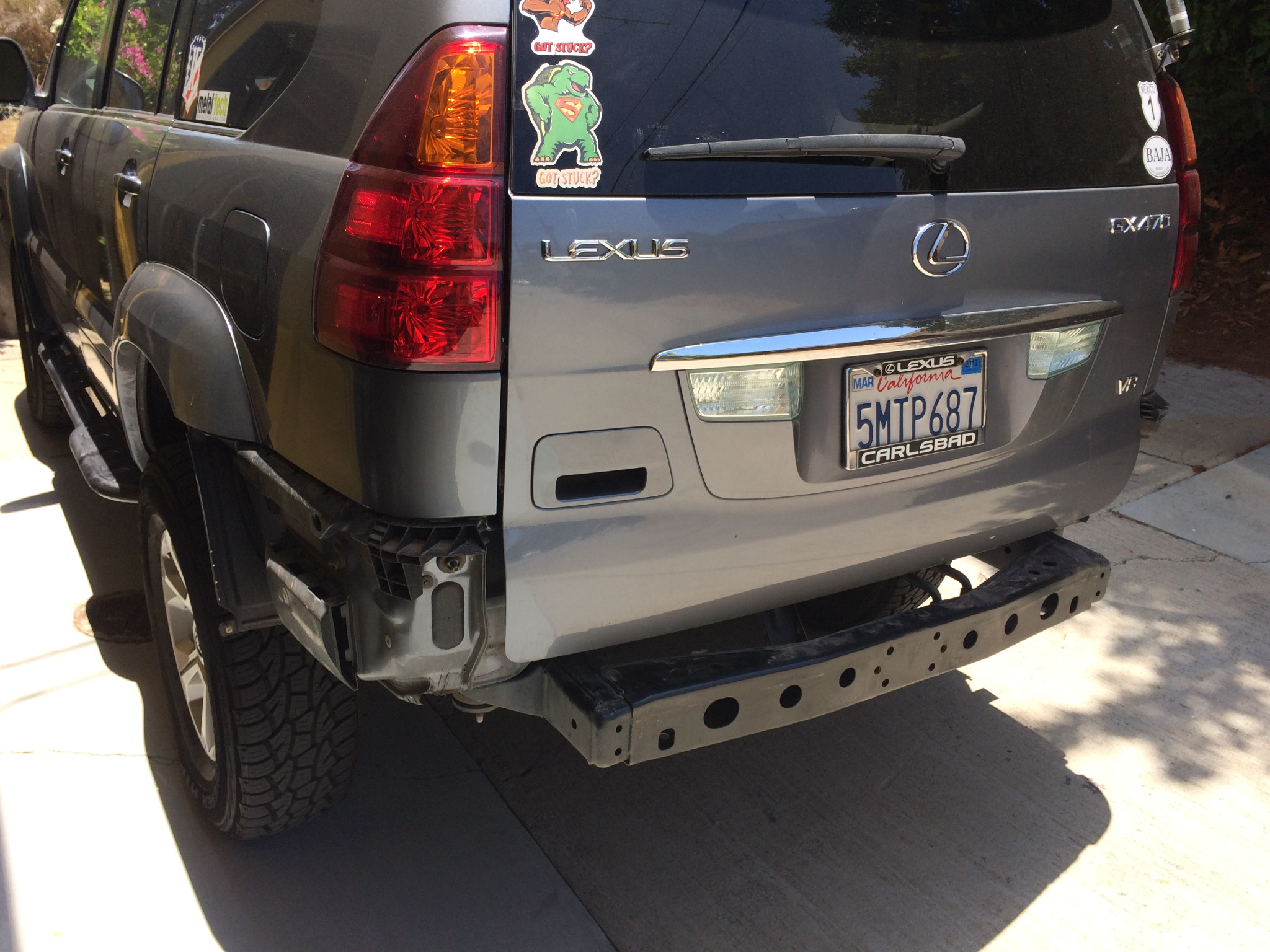

Now that she was home it was time to hack up my stock bumper to fill in the gaps.
And with the bumper pieces re-installed, Man I really wish they would have made the bumper lines straight along the crease in the bumper, it would have been soo much easier to cut and fit.

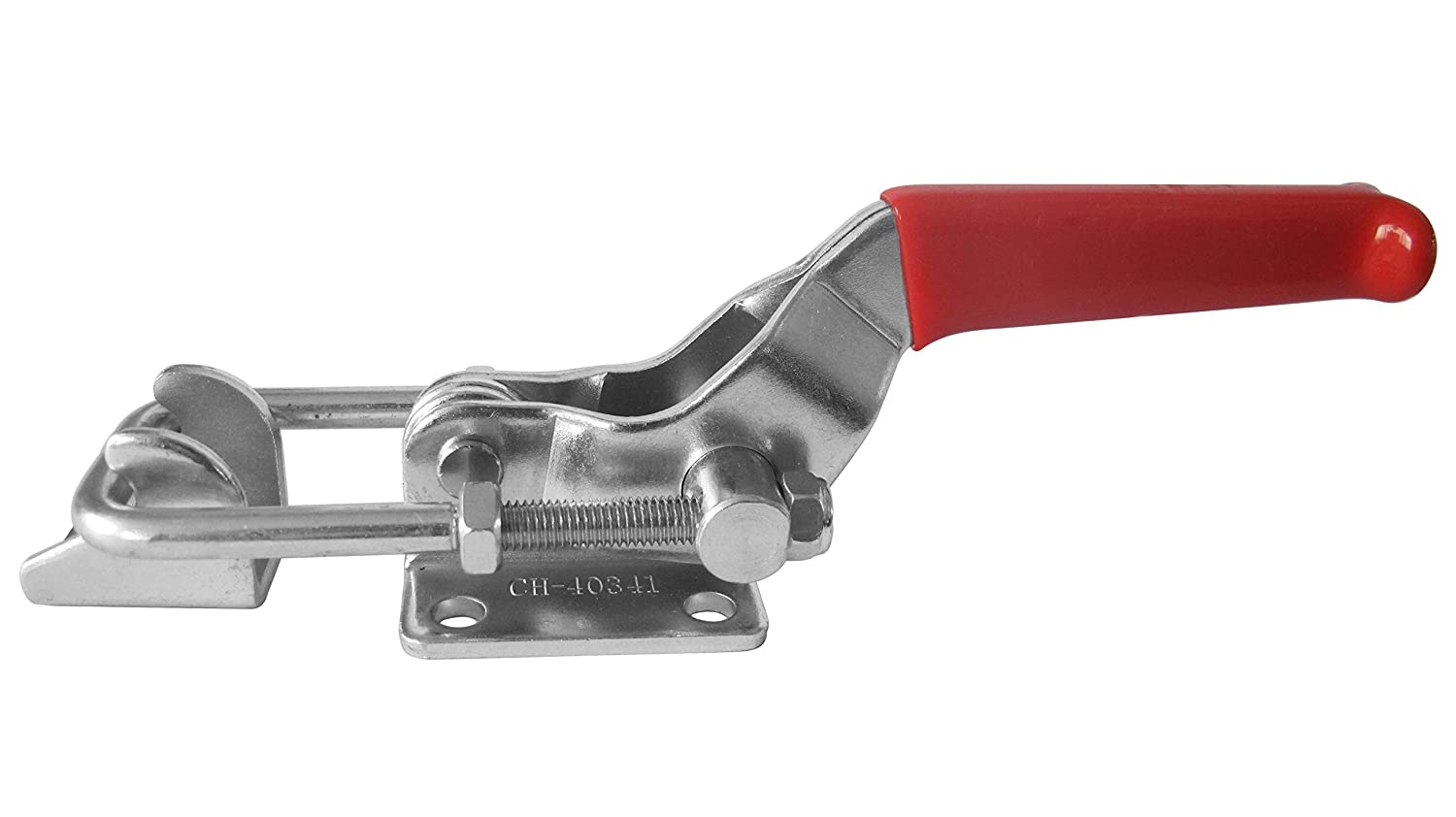

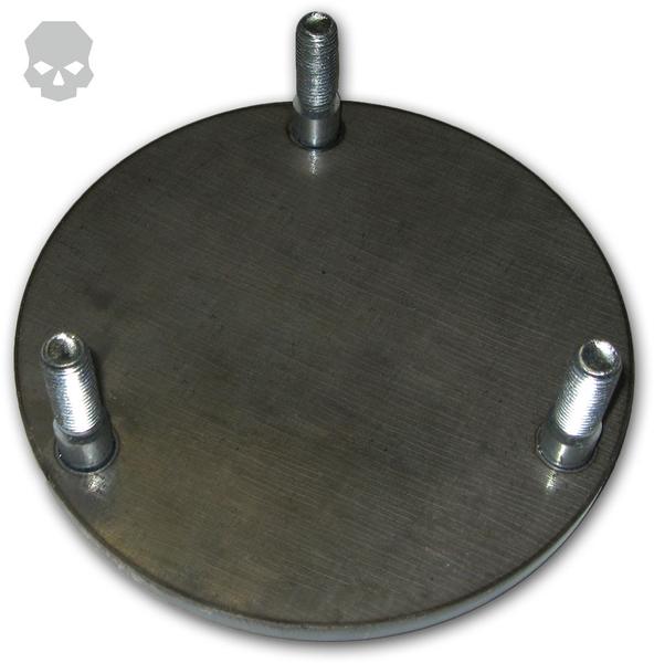

The plan for the tire swing is to build a single arm all the way across that will hold the spare tire, a single NATO can, and a Hi-Lift jack. Here are the parts I am buying for the tire swing.
CLAMPTEK Latch
Ruffstuff Locking T-Handle Pull Pin Latch, Spring Loaded
BRK-1120-4 Ballistic Fabrication | Spare Tire Mounting Plate 6 x 5.5 Inch Bolt Patterm Ballistic Fabrication
