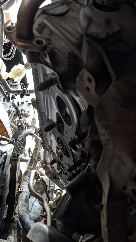

While proud I retained ALL engine studs in situ, fitment is impossible with them all in place.
All block-side surfaces scotch-brited
I was able to shimmy the passenger side in place and hang it off the studs, but no go on the driver side. Pulling the driver's side back out once all mocked and cat tacked (prolly have to MIG tack it) THEN refitting it back in once filled in with TIG WILL BE A CHORE!!!

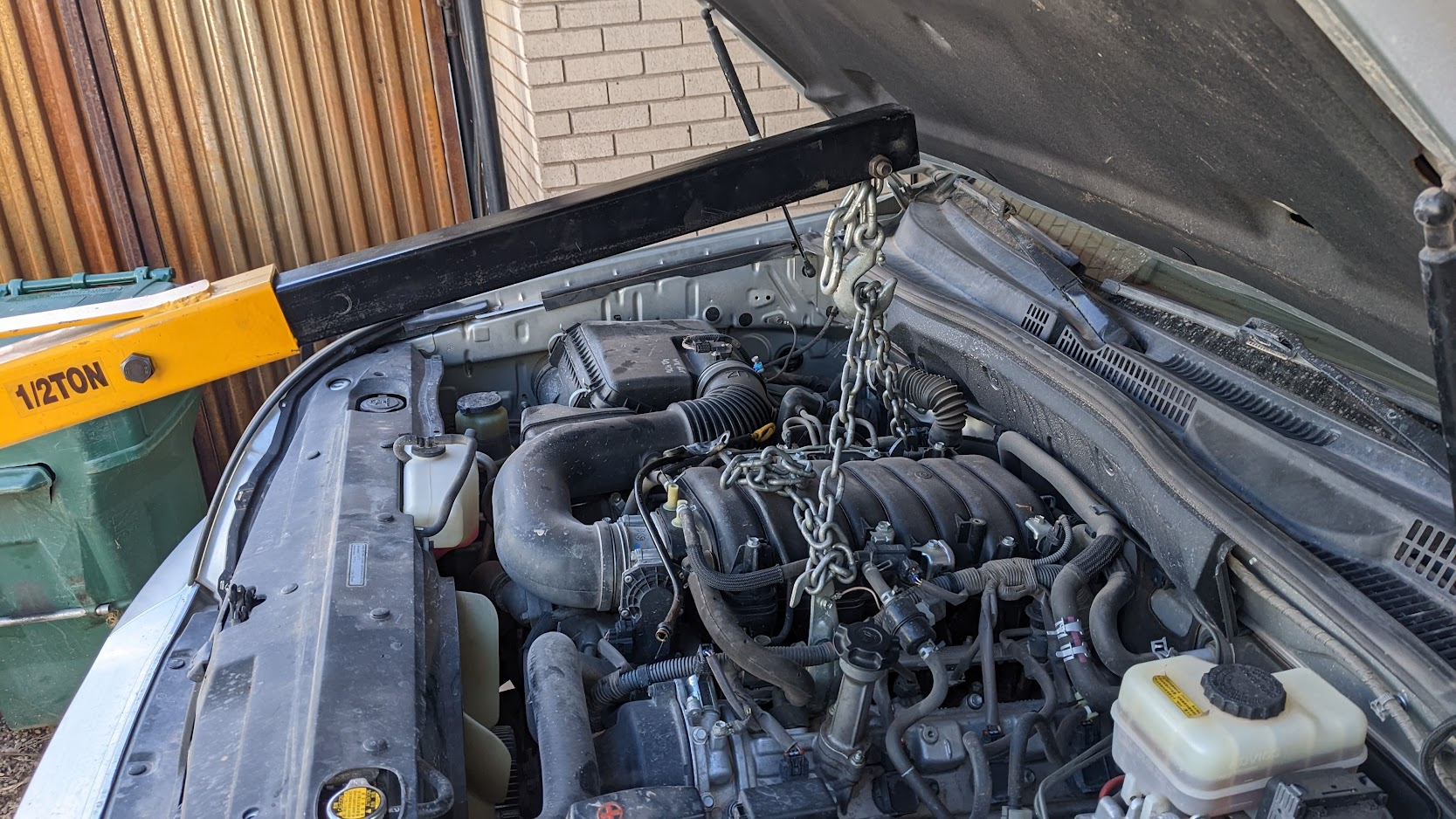

I'm using and engine hoist vs. floor jack to lift the engine; I've replaced both motor mounts and the transmission mount. I've refitted the engine mounts to the block; the insulator mounts to the block side mount with a nut, but you have to take that bit off the block to mount the new insulators onto the block-side mount. The frame side mount is held with two bolts.
this is looking down into the block-side mounts... the insulators mount into these from below
Frame side bolts removed in this shot.
I don't really see the space to wedge a 2x4 in there once those bolts are removed. The fan it interfering with the shroud and the bell housing is ramming the firewall at this point with the engine jacked with a hoist.

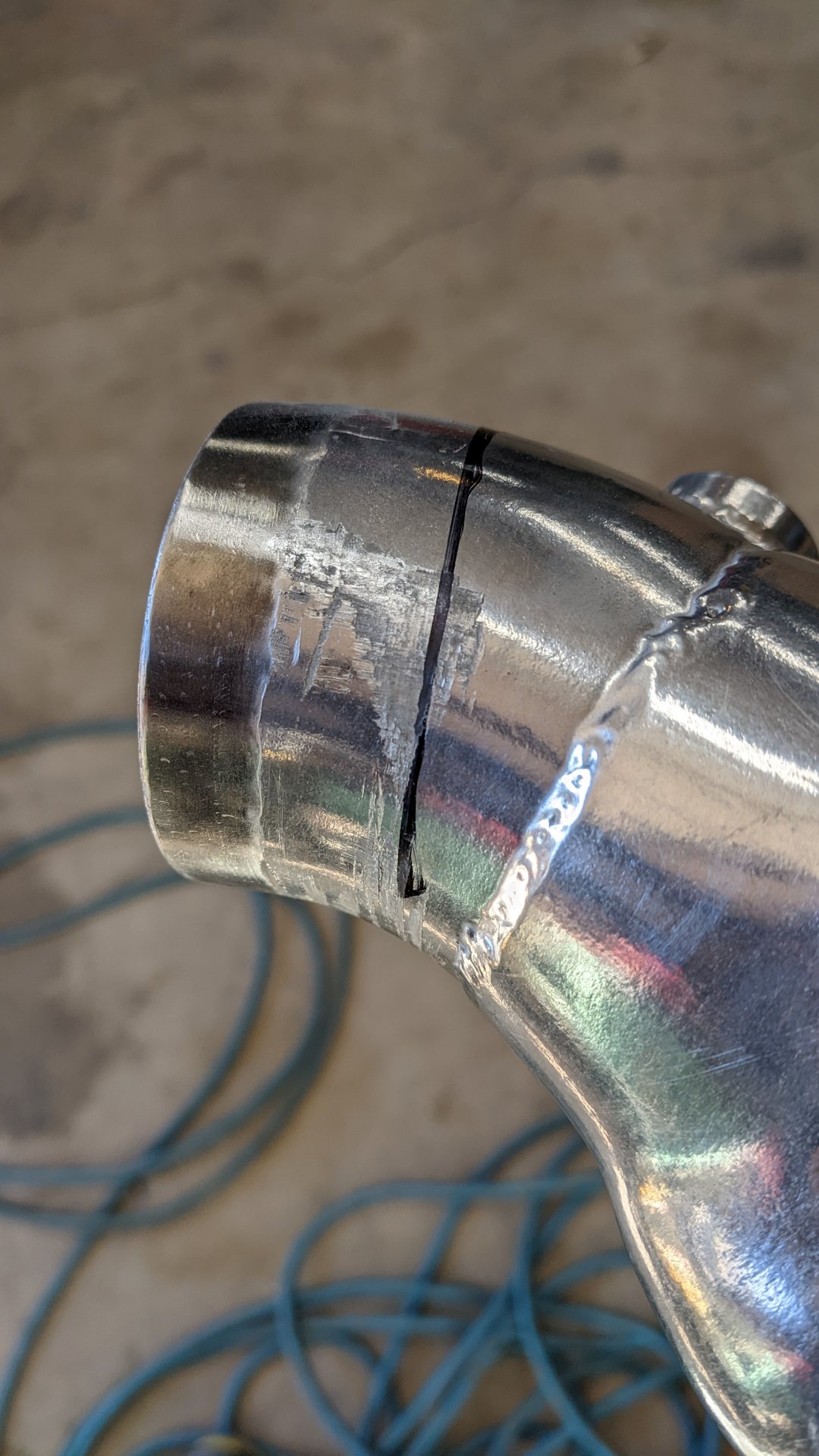

Driver side has cracks we'll fill in with SS filler rod
rod
Next move(s) will be remove some driver side studs, but not all can come out. At least the rear top must stay in place b/c there's NO room to refit a stud or bolt, one of the header pipes is FLUSH in the way, access to the nut will be ... challenging.
Get driver head in, lower block, fit Y-pipe and exhaust, then mock up cat and tack in place, un-bolt exhaust bits and remove header then bench weld the cat fully, then put stuff back in. THEN fit gasket on pass side, dry fit header with a few nuts and re-mount exhaust. Dry fit trimmed cat and tack on, then un bolt bits, finish weld that cat on the bench and replace bits, THEN using ATD, fit all the bits and start tightening stuff... Once all fitted go through the mtions of checking for leaks and addressing....
THENNNNN, do all the detailed checking, and fire it up. . . !

I think I'll try removing them again and see if that gets me the space to maneuver the headers, then I'll pull some driver side studs with the enging mount out and see if I can negotiate that way.
also I'll try lifting by one engine hook side at a time instead of both at the same time. maybe lifting with rotation will afford moar room. . . .

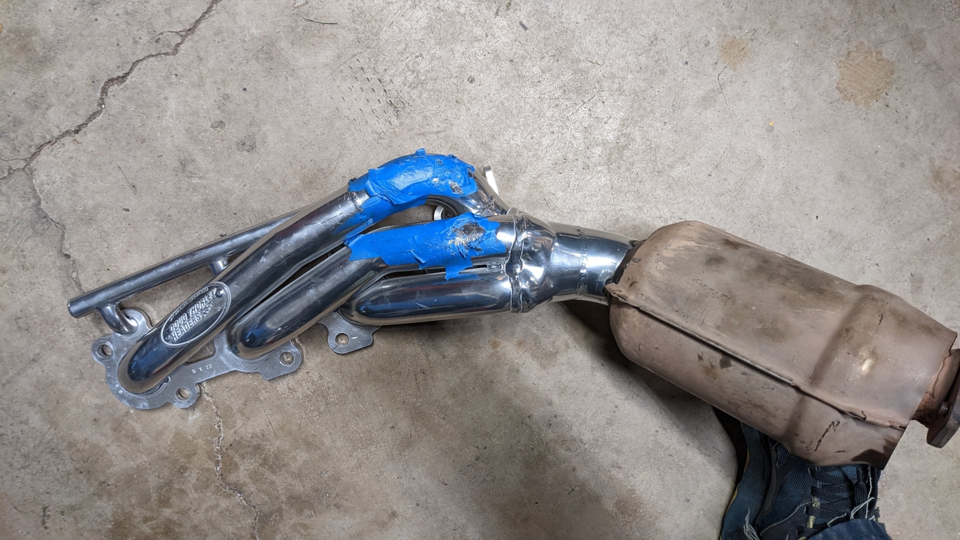

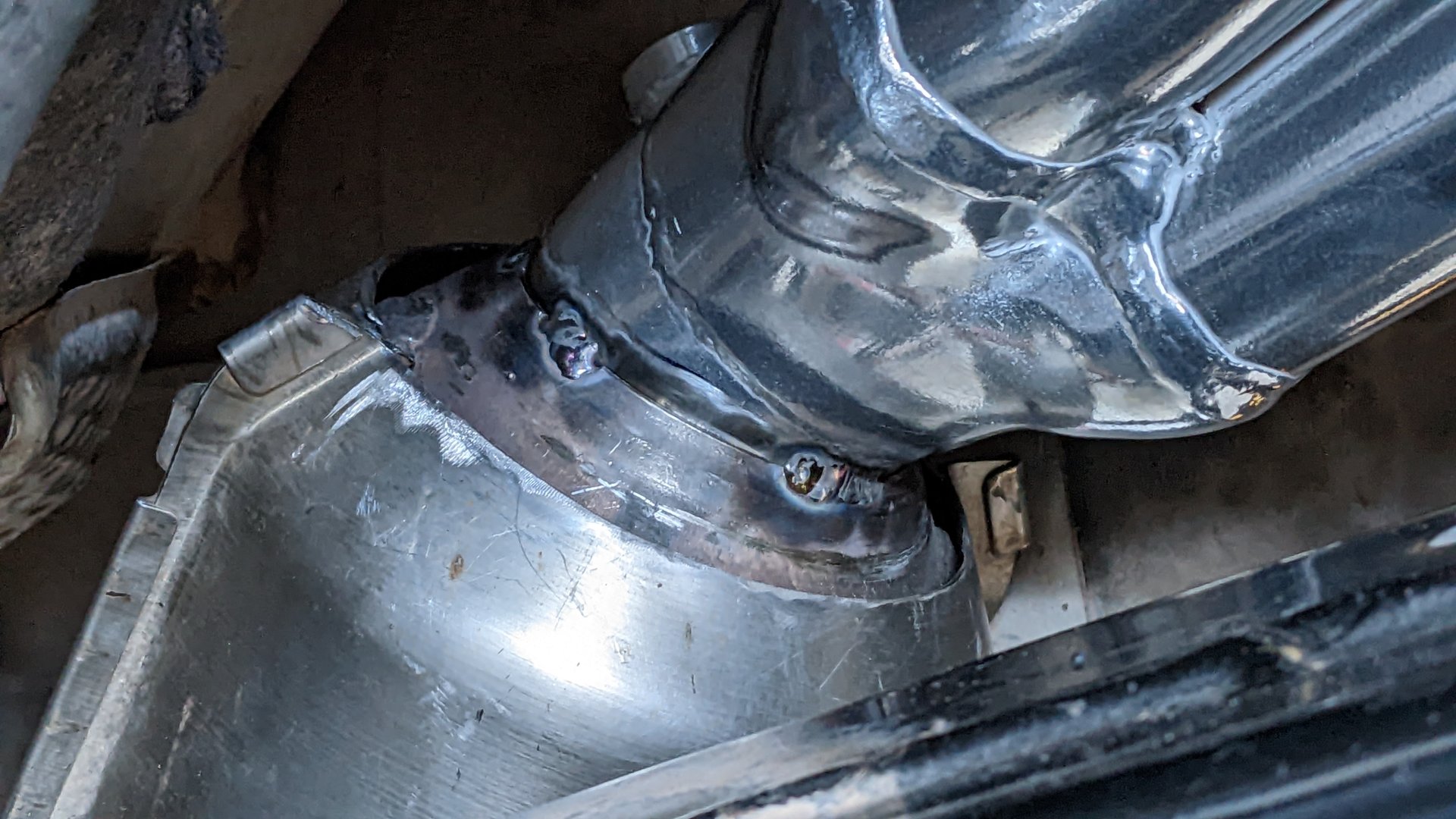

Dry fit headers, cut and sleeved passenger cat (driver was already cut), loosely fitted flanges, aligned motor mounts using bolts, lowered engine, snugged everything and sharpy-marked headers.
Then Pulled it all back out to sand back more of the ceramic coating and shortened driver side pipe by an inch or so.
... Then dry fit everything back in, Snugged flange bolts and buddy TIG tacked cats.
AAAAAND THEEEEENN I pulled it all back out for the bench weld. . . .
Inching closer (to the next false summit 😂)!!!!!

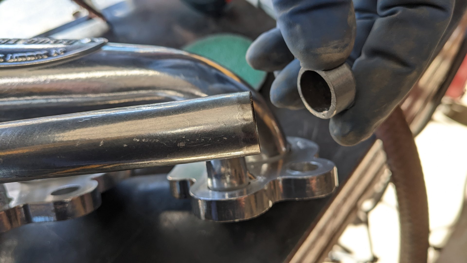

We may cut down the driver side rail by a half inch of so (as pictured in 680). It interferes with a power steering line on install so a scosh moar wiggle room could be immense.
Then I gotta figure out how to hang them on a few studs (i dry fit them with 4 studs and nuts on driver and just 4 nuts among all 8nstuds passenger) and insert the remaining studs in the driver side?. I may use a bolt or two as access for some is INSANELY challenging!
