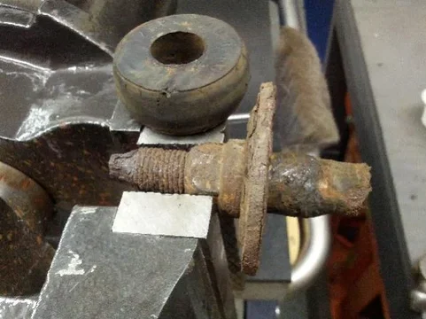

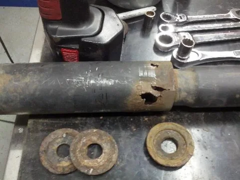

Not pretty. The upper nut and threaded shaft were badly rusted. Time to get serious. Turns out that the bushing between the shock body and the frame [and the shock shaft that runs through it] is very easy to access with a sawsall. Use some soapy water in a spray bottle to keep the blade lubricated and it will go through the rubber easily. Try it dry and you'll have a slow, smelly, melty mess on your hands. Less than a minute of cutting and the old shock was out.
Here's the upper nut and shaft. Would have been a struggle to get this off any other way. Note that the original bushing had held up well.
The shocks were shot, of course. They were the originals after nearly 240K miles. The one thing I regret is not having new bushing washers. If you are getting ready to do yours, suggest you get new washers for both front and rear. Rust never sleeps!

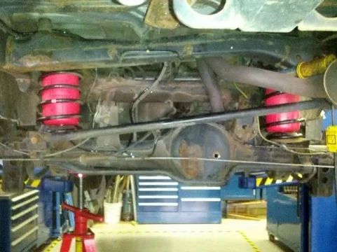

AIRLIFT:
The FSM procedure to remove the springs involves removing the sway bar brackets and disconnecting the lateral control rod. There was enough corrosion on the exposed ends of these bolts that they weren't coming out without a fight and a high risk of snapping bolts. Not worth the risk. Turns out that the rear axle will hang down far enough to remove both springs fairly easily, so it was done with everything hanging as far as the ASB links would allow. The airbag install was a snap.
NOTE: If you are removing the springs for any reason: They are not equal length!! Make match marks with a sharpie so you know which spring belongs on which side.
Its a different truck with the new shocks installed. Should have done it a long time ago. If your Hundy feels more like a trampoline than a truck, its time for new shocks!

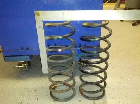

You guys really think the rear coils are fine at 180k plus miles? I must have the defective ones... I think they were shot in 2005. When the truck is empty they will suffice but I have to imagine that with some gear and a passenger or two they are pretty rough.
Hey Rob, promised I'd measure my 240K springs and here they are!
LH was 478 vs 486 spec length new
RH was 488 vs 492 spec length new
Both less that 10mm shorter than new spring length, and these have done a lot of towing with a very heavy hitch weight. I was a bit surprised that they were not seriously collapsed, but looks like they have stood up to the load pretty well. Would not expect any noticeable improvement from new springs based on this measurement. YMMV of course.
