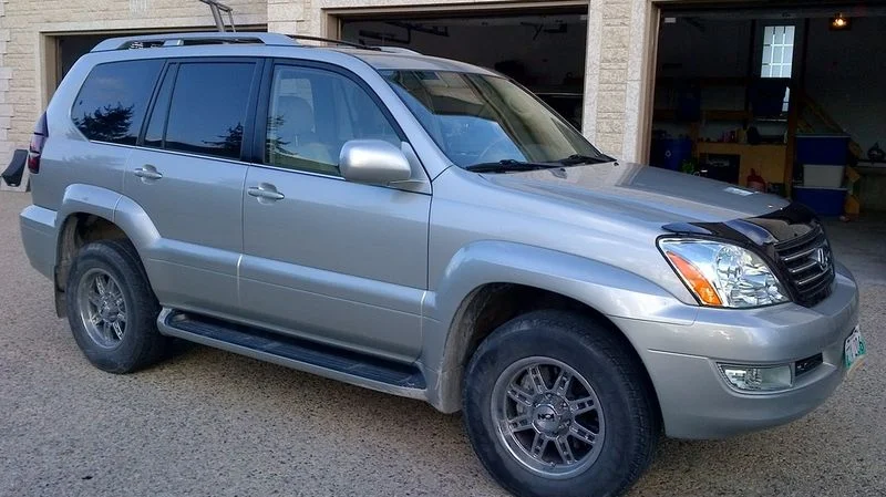

I am running those front springs on Dobinsons twin tube shocks (in black), I have nothing but good things to say about them. I did a 1.5F/1R lift and still have some rake with the ass end higher than the front (no 3rd row seats, no added weight), I'm running the twin tube comfort valved shocks in the back (also in black).
I ordered from Kyle Fogle @ Treaty Offroad, he was very patient in going over the MANY options to end up with the lift I was after. Mine is a daily driver as well, so I didn't want/need a big lift, this truck won't see any offroading in the near future, I have my 80 for that.
Truck drives like a dream, firmer than stock but never harsh is the best way to describe it. Soaks up potholes and speed bumps with ease, way less dive/squat/bodyroll on the firmer springs.
