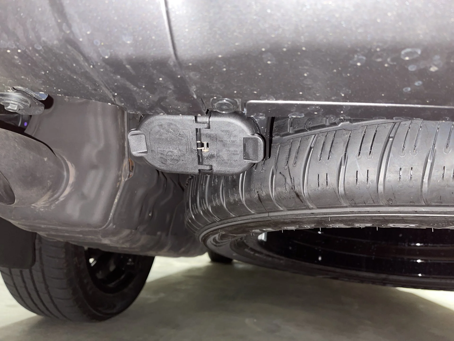

Picture shows it’s located just the the left (USA drivers side) of the plastic piece you remove in order to install the 2” receiver.

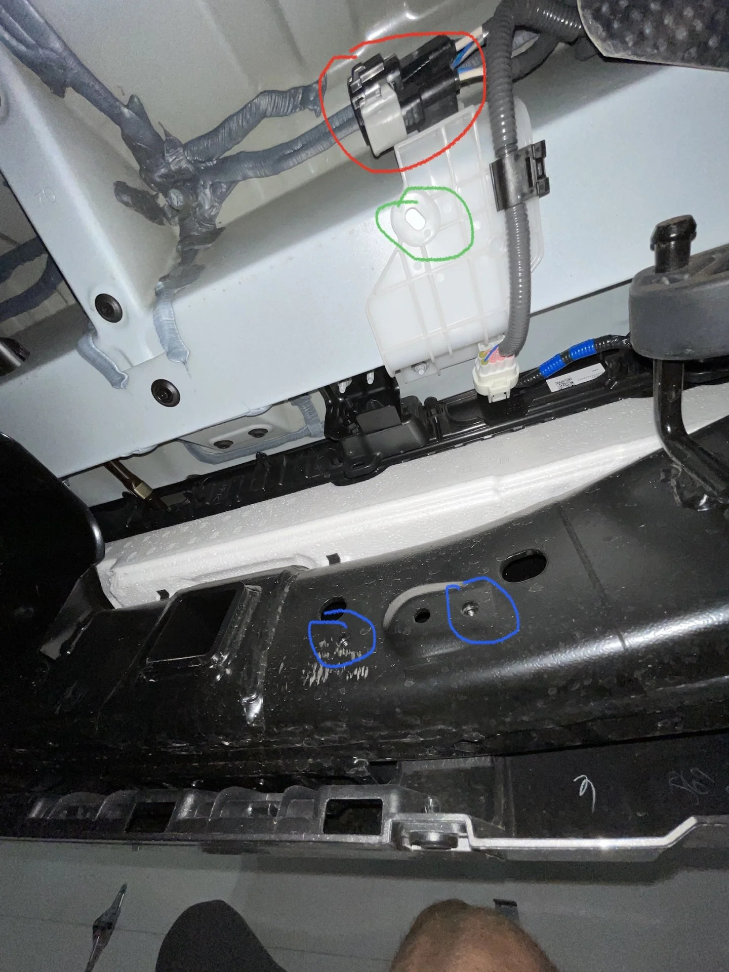

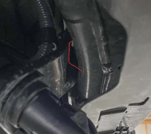

As my mad art skills highlight in the below picture, you can see there is a curve to the bracket for some reason…which also lead me to believe it must mount somewhere else.
Oh well, looks like I will be removing the spare to get this installed this weekend. Definitely not a great or intuitive design & one would think that with the window sticker indicating the “tow package,” it would already be installed.

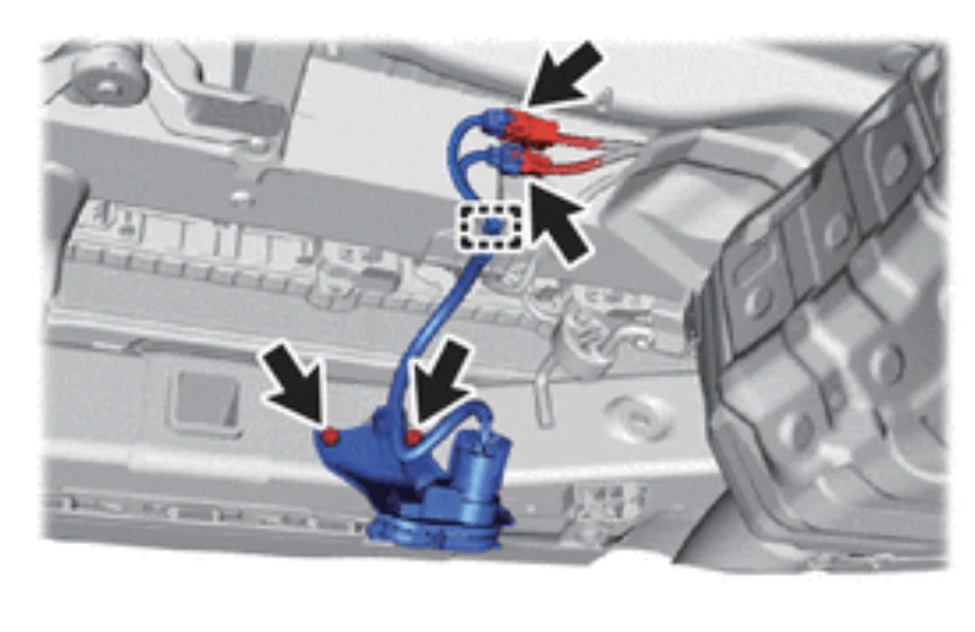

Dealer offered to install it, but I am about 7 hours from the closest dealership. They did send me this..
1). Spare tire needs to be removed
2). Install as shown below

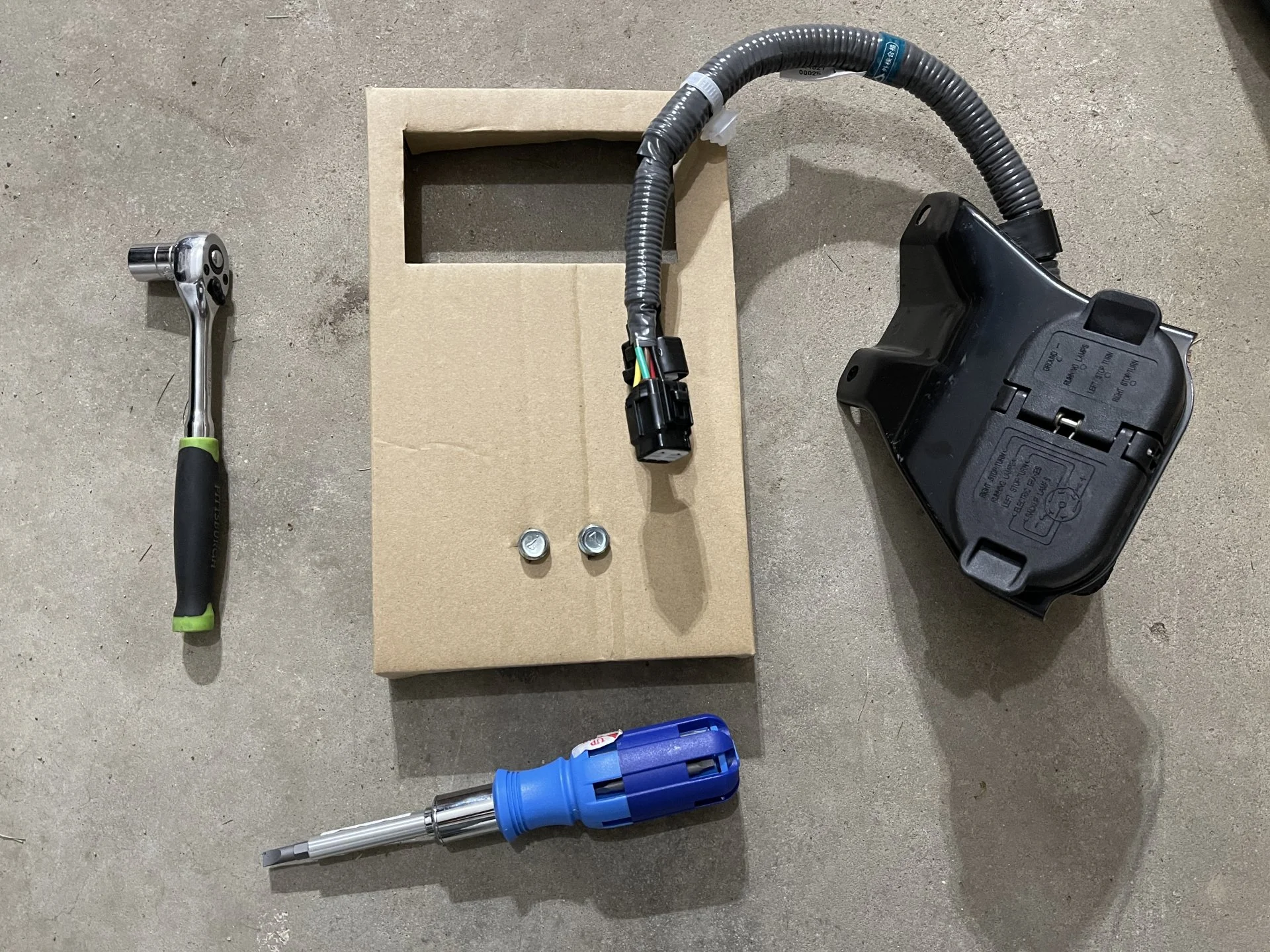

Tools Needed:
12mm socket/ratchet
Flat Head Screw Driver

Gather your tools:

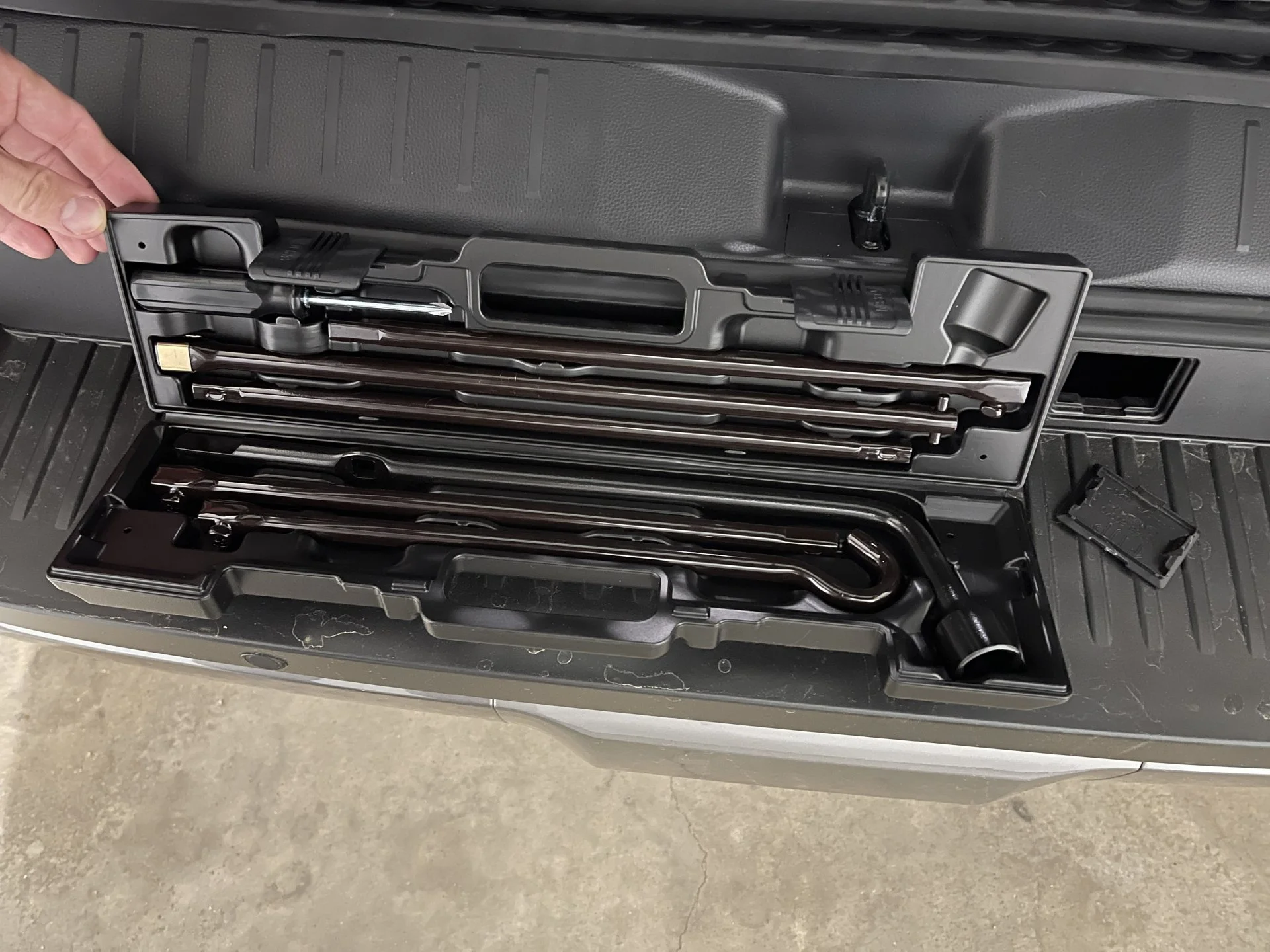

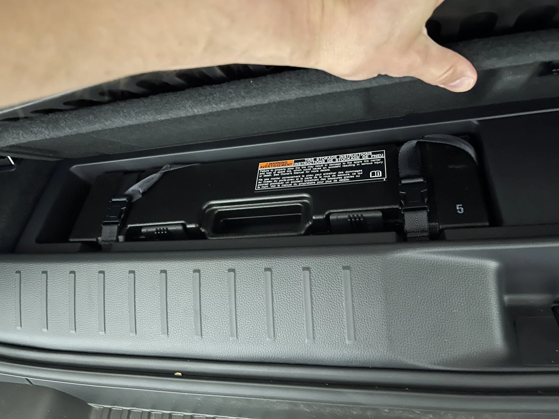

Open rear hatch and get out the lugnut wrench:

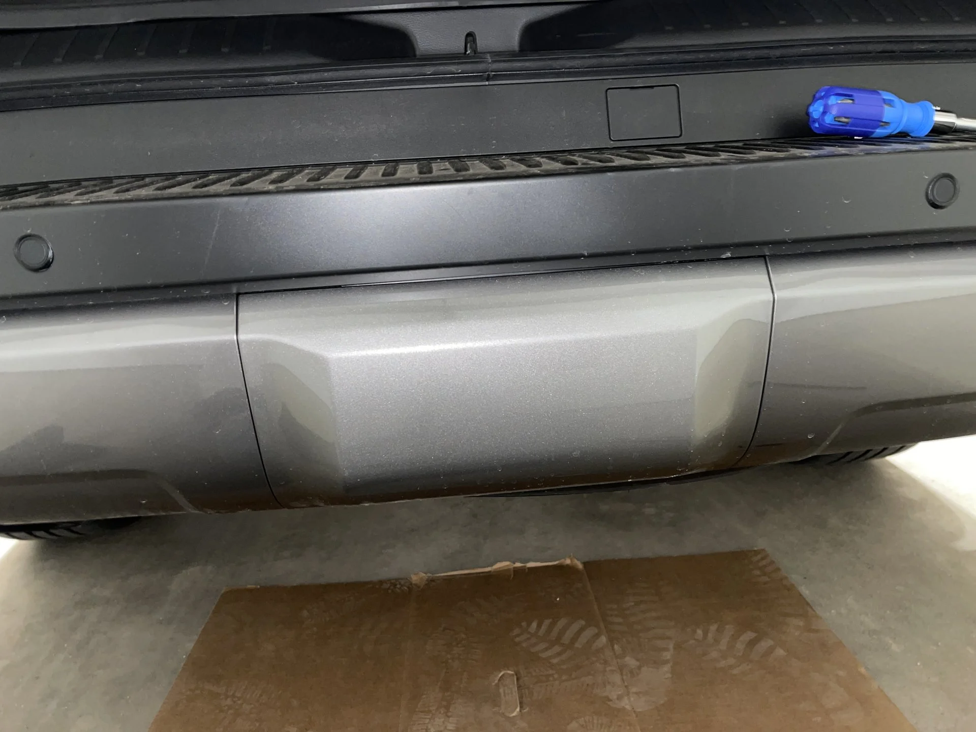

Use screwdriver to pry off this cap just above the bumper:
Grab the metal extension with a “t” on the end of it, add another extension to it (top to extensions just below the screwdriver) as well as the “L” shaped extension with the square in it (4th down from top)

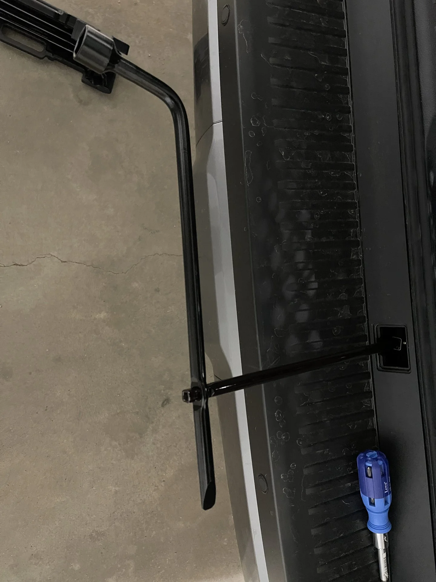

Connect the 2 straight extensions together and insert the T side into the hole that was revealed when you removed the plastic cap, connect the “L” shaped lug nut wrench to the end of it:

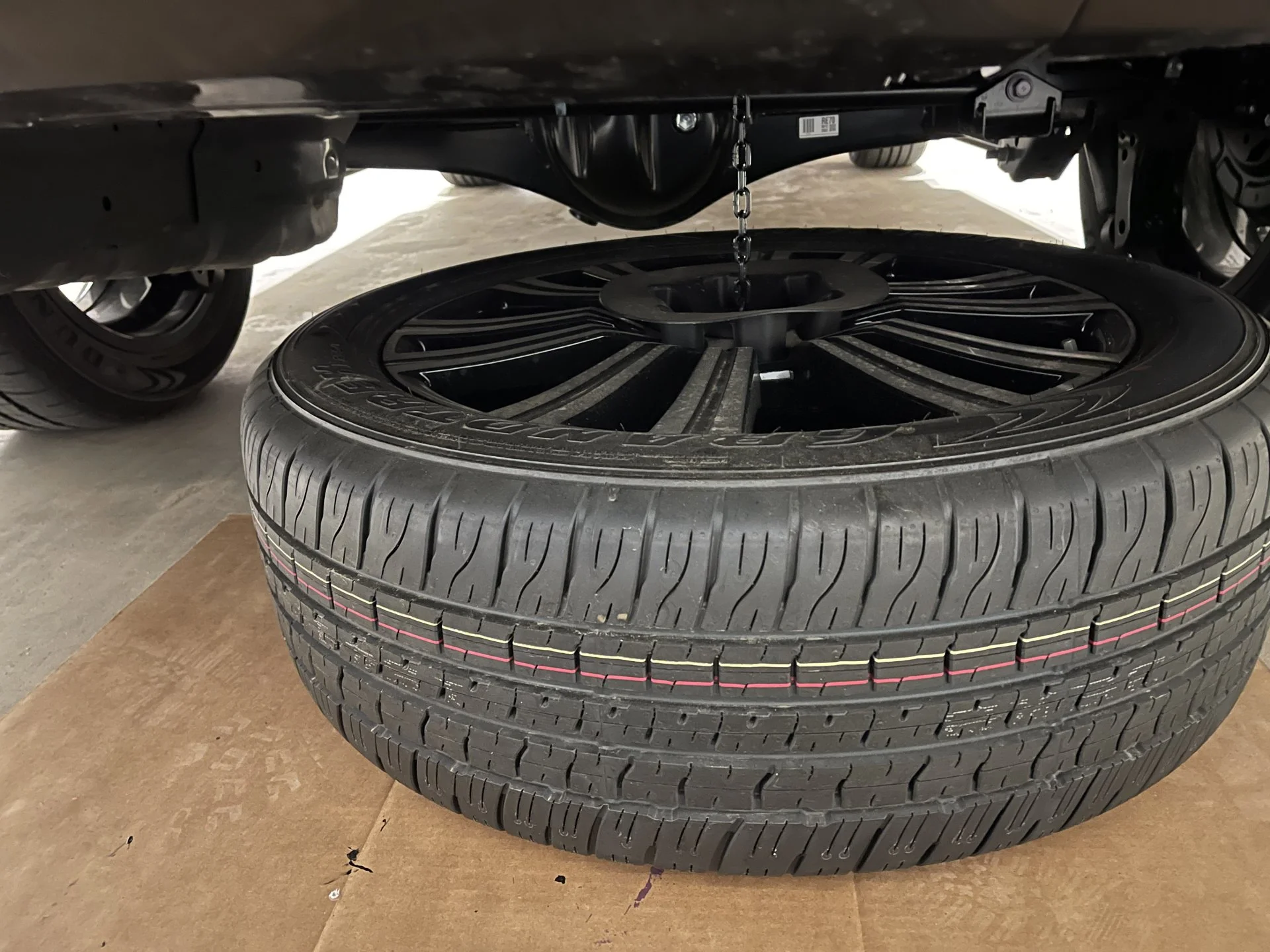

Turn counterclockwise to lower the tire to the ground. It took a little more force than I expected, but worked fine once loosened up:

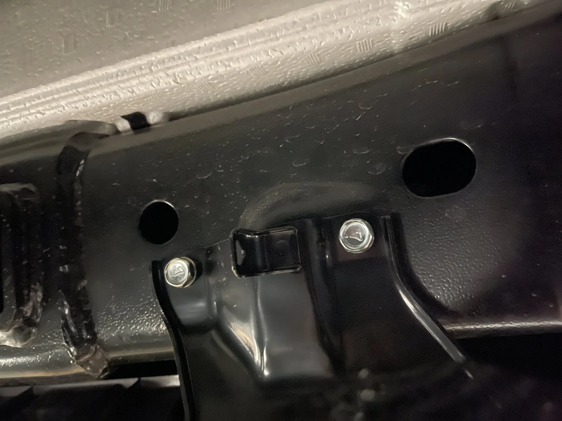

Note the following areas in the picture below:
Red-wiring connection
Green-place to insert wiring loom to keep out of the way
Blue-mounting holes for bracket
Attach the bracket using the 2 12mm bolts (note the black piece of metal protruding from the bracket between the two mounting points)

Gather your tools:

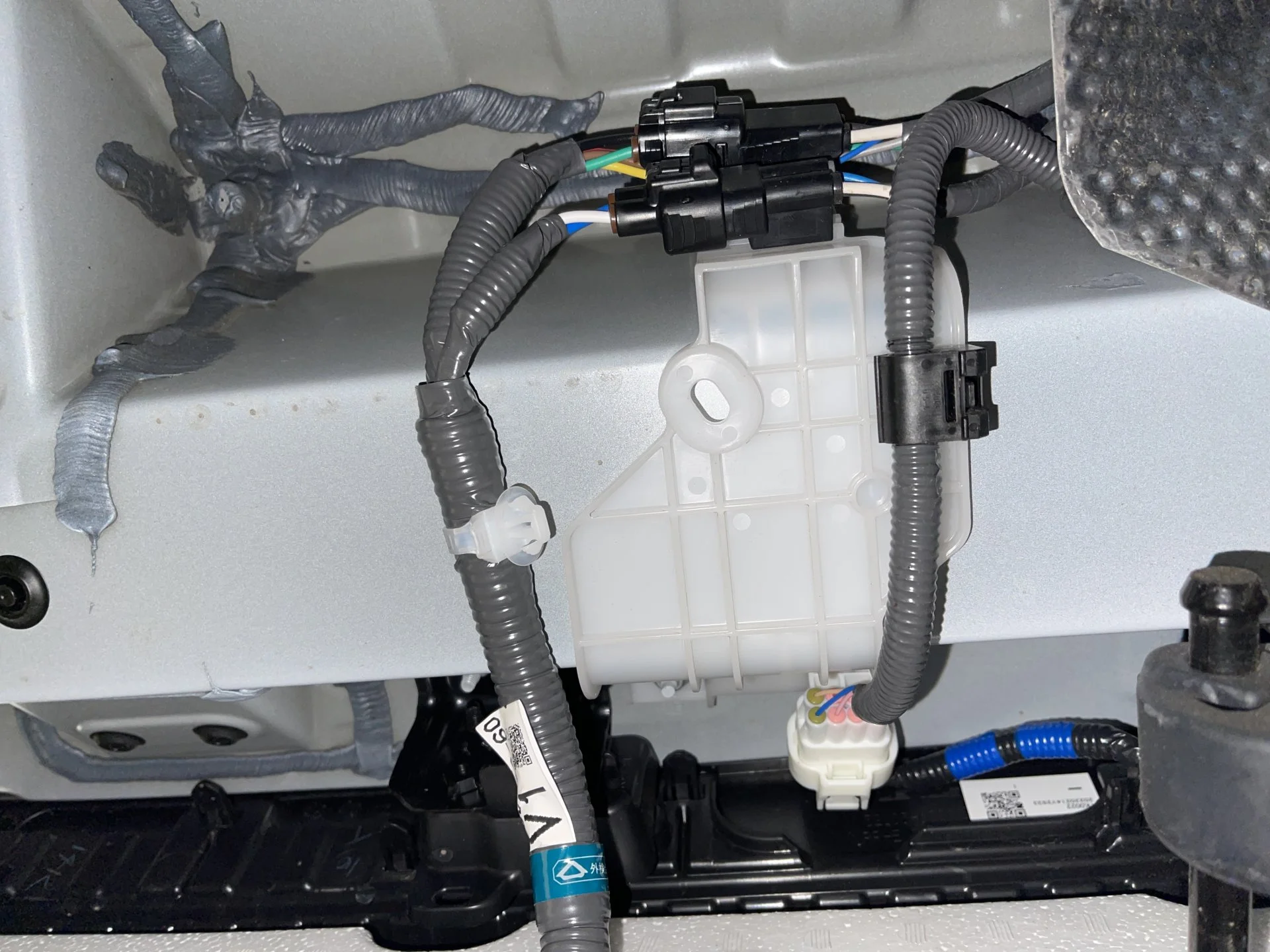

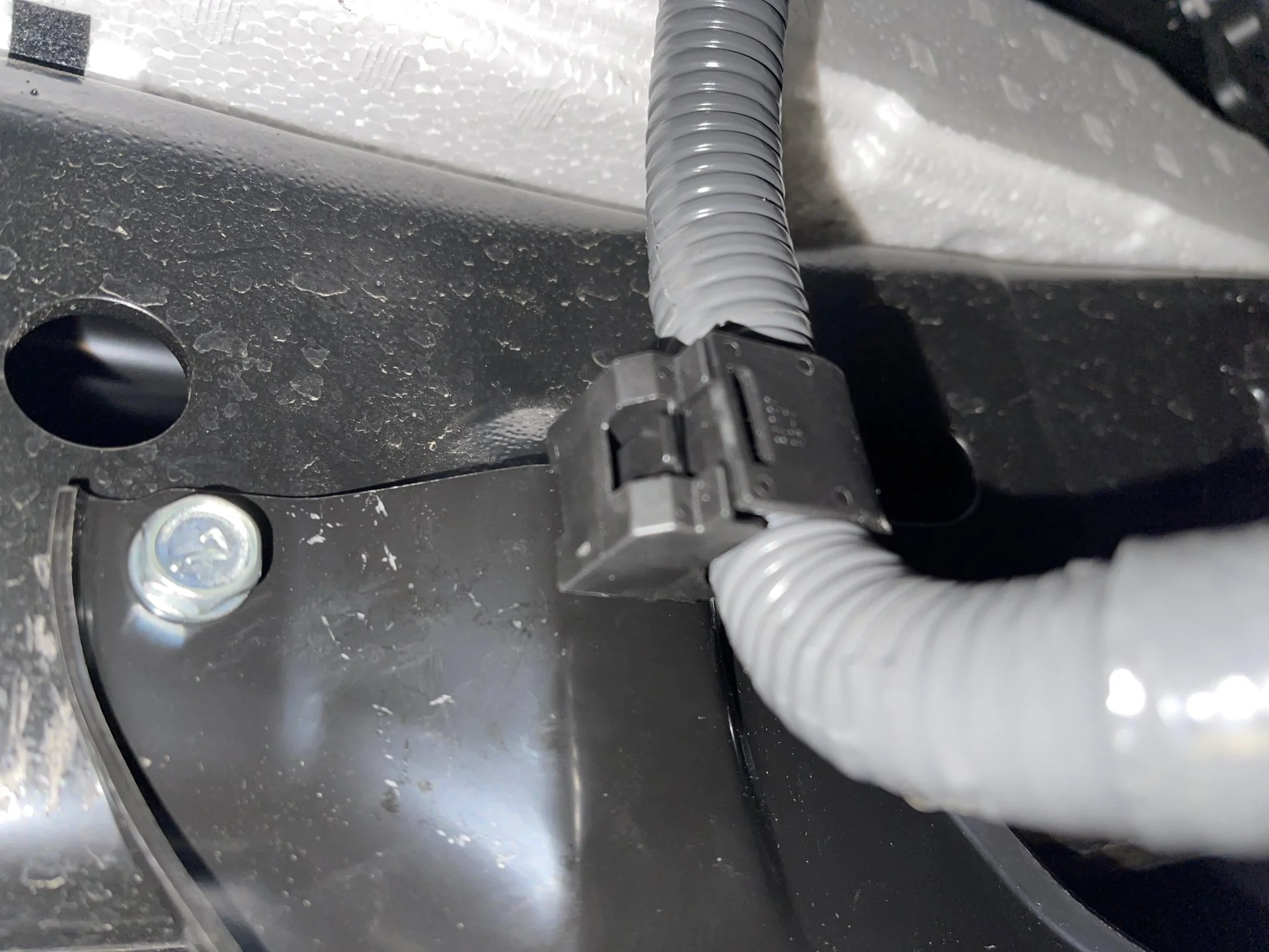

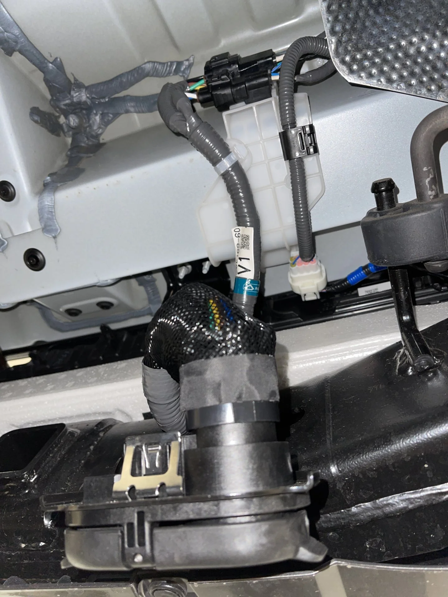

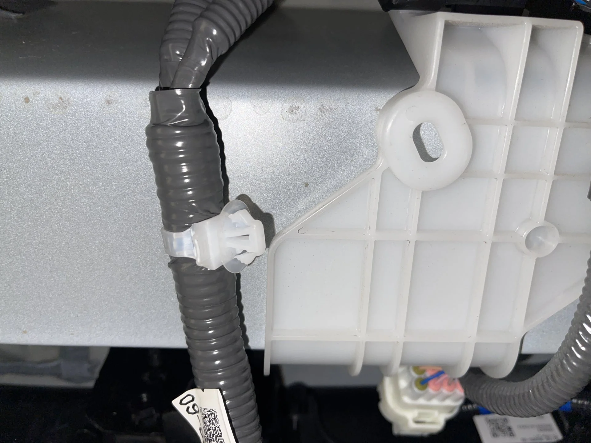

Attach the black clip on the wiring loom to the black metal clip on the bracket:
Remove the 2 caps that are on the existing plugs mounted to the vehicle:
Plug in the wiring harness to the vehicle:
Connect the white clip to the vehicle:
Complete:
