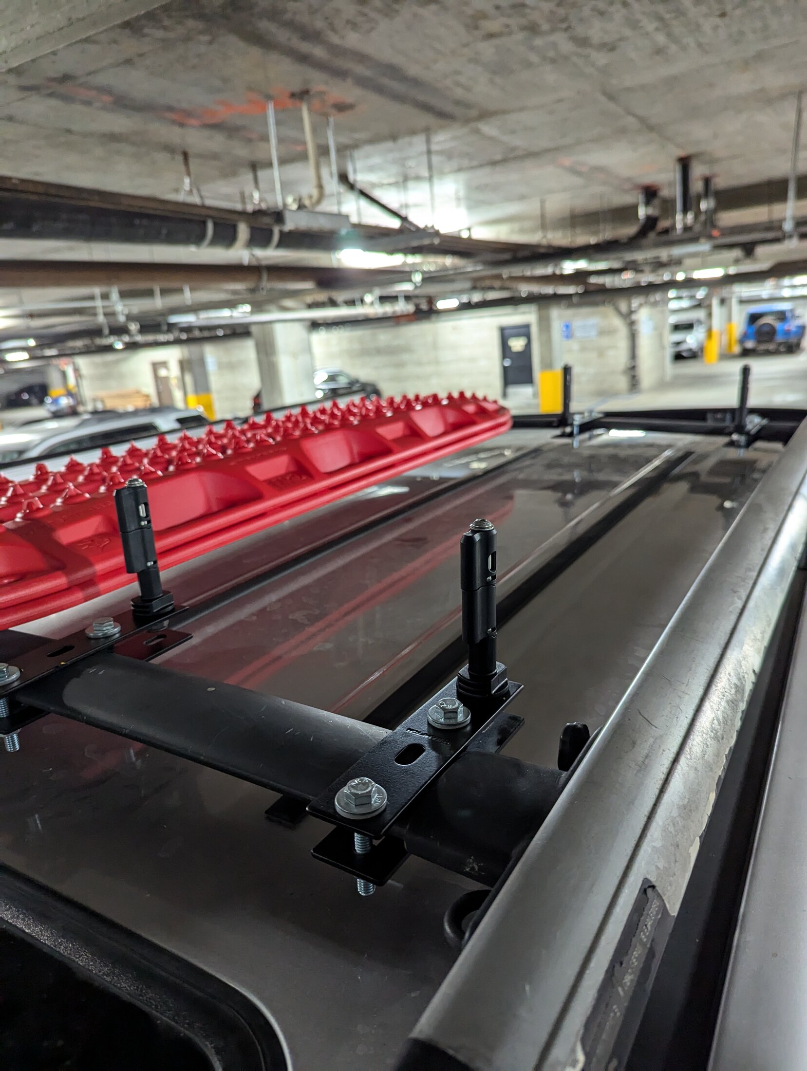

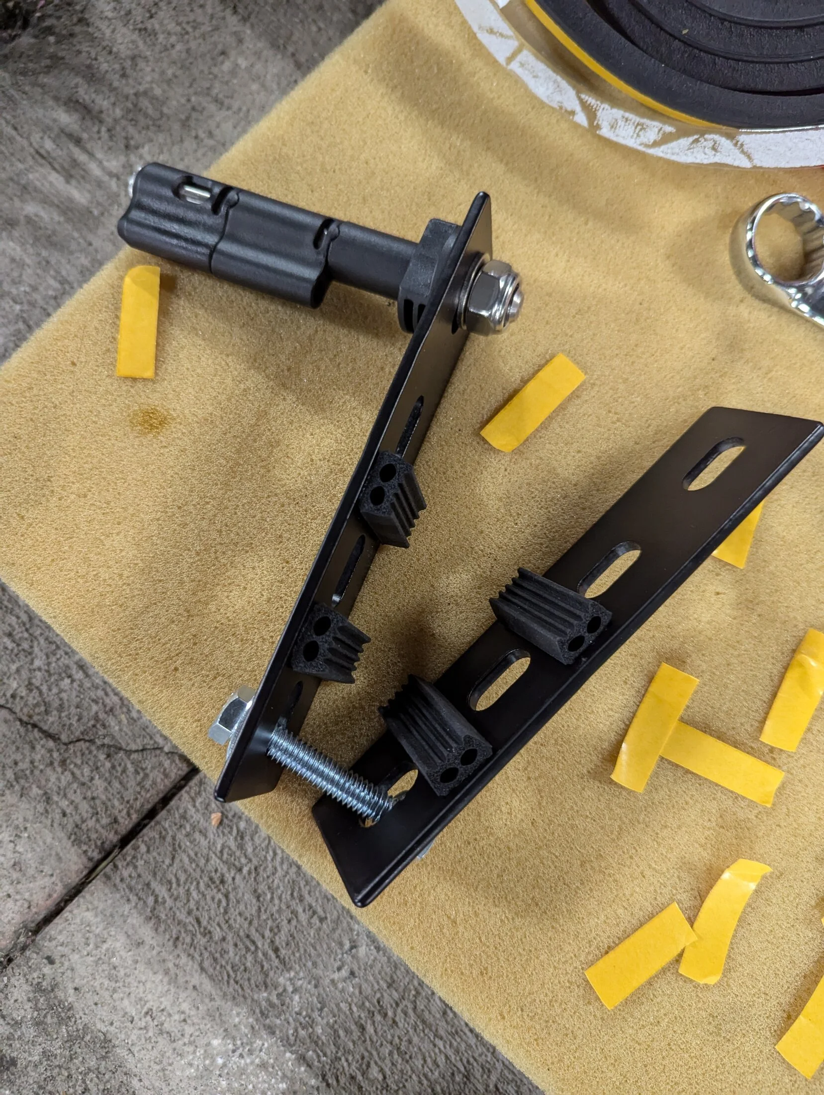

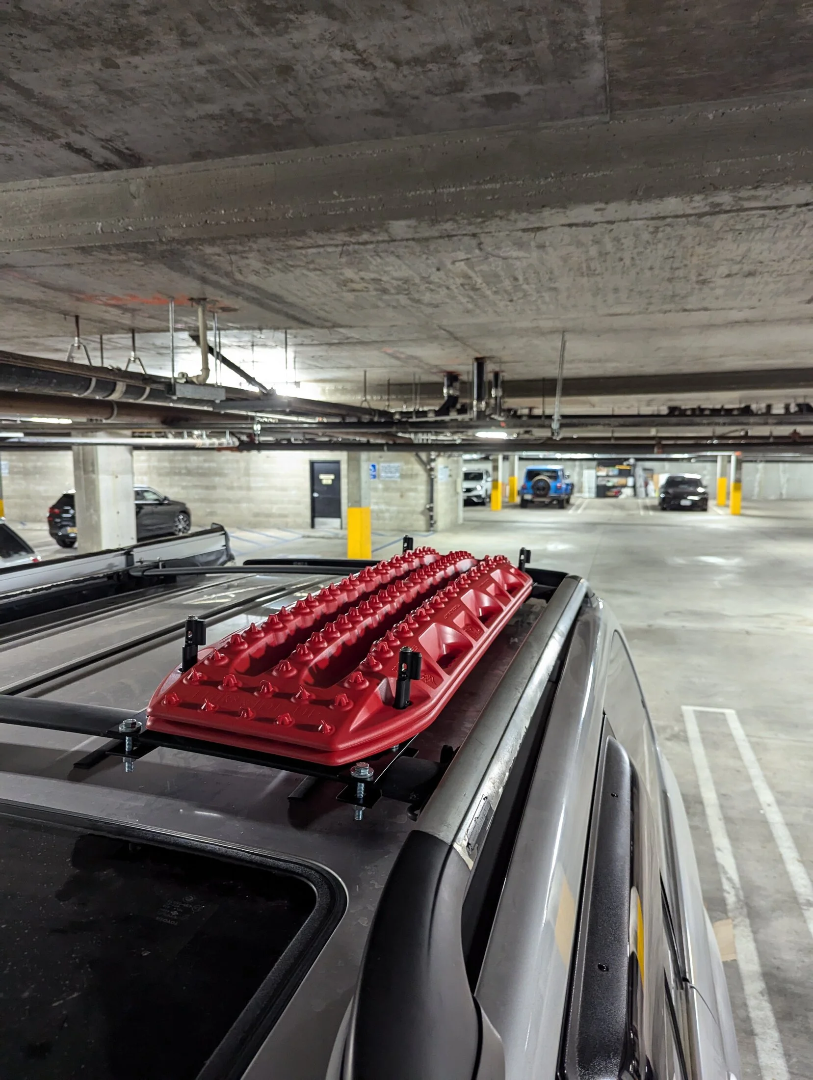

Wanted to share what I did since I hadn't seen this method on YouTube or the forums.

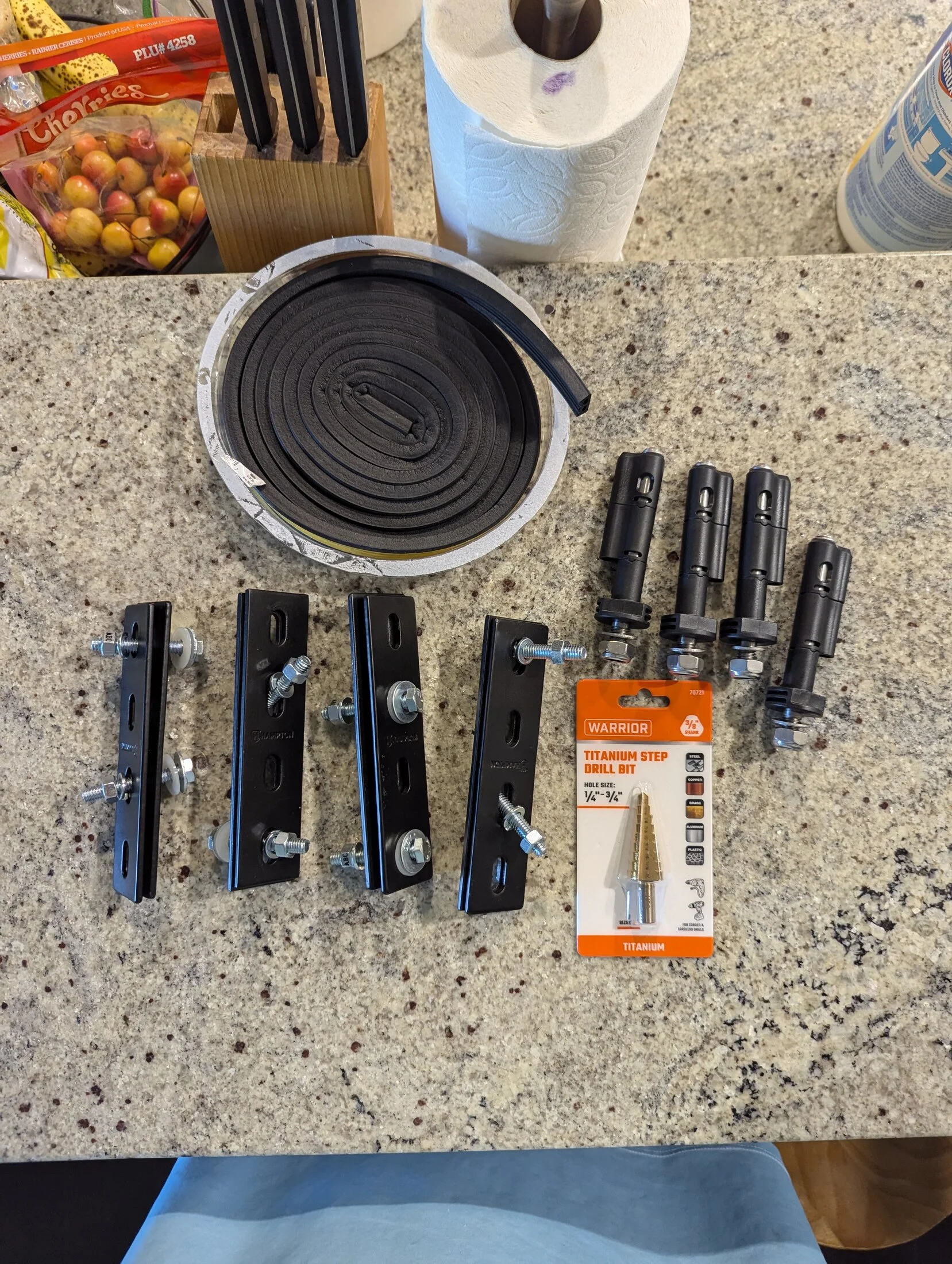

Materials:
Maxtrax pins (17mm option)
Mending plates x8
Bolts, nuts, flat washers, lock washers x8
Weather seal strip (auto/marine grade)
(Drill bit to widen hole on mending plates it the pins don't fit the mending plate holes)
Pics self explanatory:
