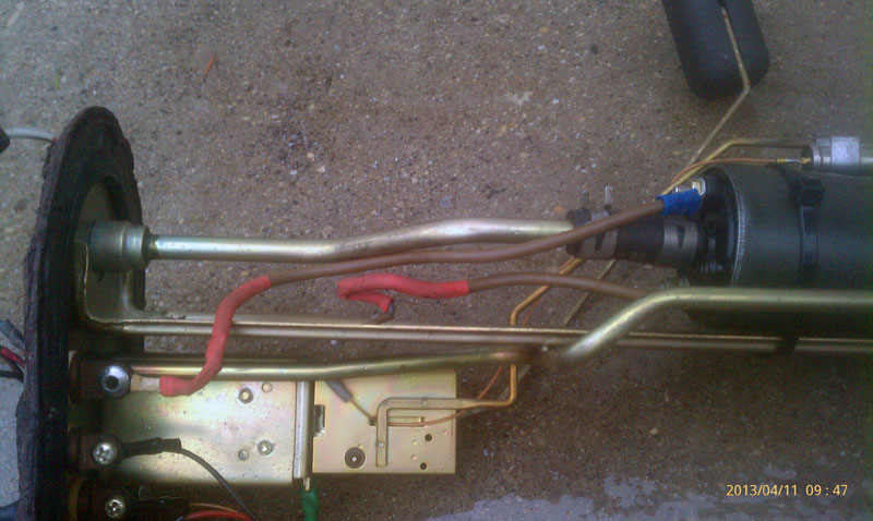

Ok, I installed a Supra TT pump.
I also rewired the pump with 10 gauge wire from the battery to a relay. Cut the thick blue wire on the fuel pump harness. The car side turns on the relay. The pump side goes into the relay. The ground on the sending unit is visible and riveted to the sending unit body.
This bypasses the resistor and ensures the pump has full battery voltage at all RPMs.
The bigger pump didn't change the top end lean out.
