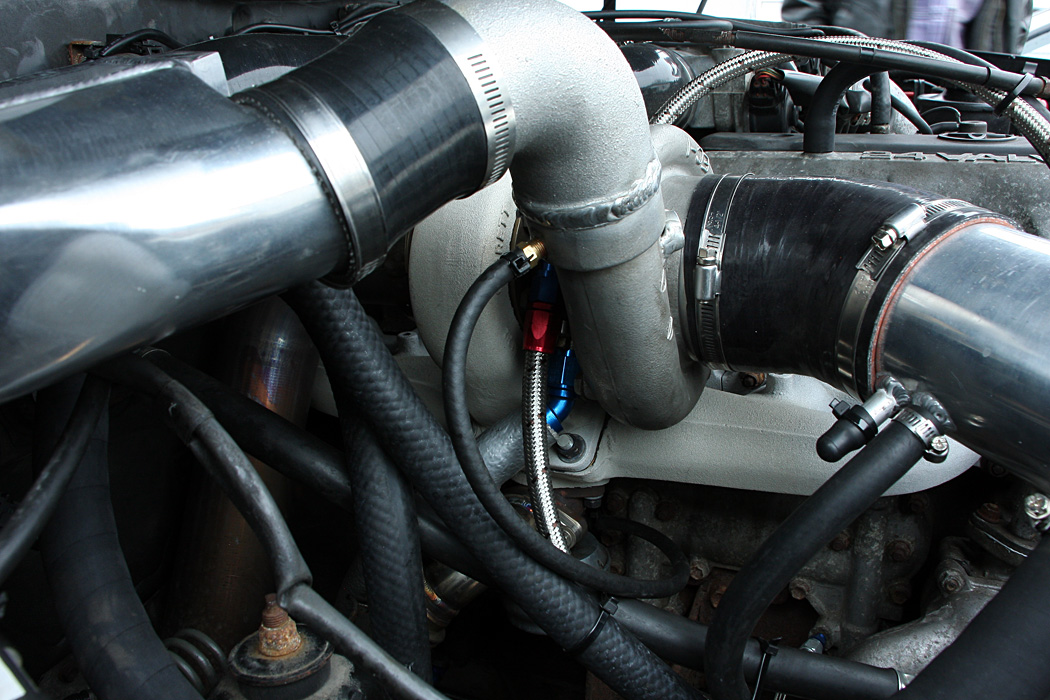

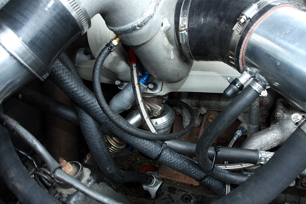

Cool :cheers: ..guessing the waste gate you got from treadestone? I see it's coming down from the manifold...might be a dumb question but where does the other end attaches to?
Thanks
No, I had the wastegate laying around. You can get a Tial 38 from nearly anywhere. They are pretty common and cheap these days.
You can either just run a tube out of the wastegate to atmosphere, but you will get a raspy exhaust noise and it sounds like crap or you route it back into the exhaust.
