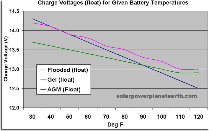

Alternator should be fine. You don't want anywhere near 14.1V on a hot engine. As that'll also mean the batt is warm and will want a lower voltage less it boils the batt.
As the alternator is setup for a lead acid, the diode should be used to compensate for the delta to AGM.
I couldn't find.a bulk charge graphic but this should give you an idea.

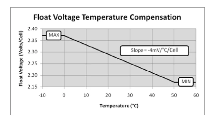

Thanks @gaijin and @TeCKis300, I'm beginning to understand this better. I found the Northstar manual on line which I believe to be the same battery as my X2 SLI27FAGMDP. It has this curve:

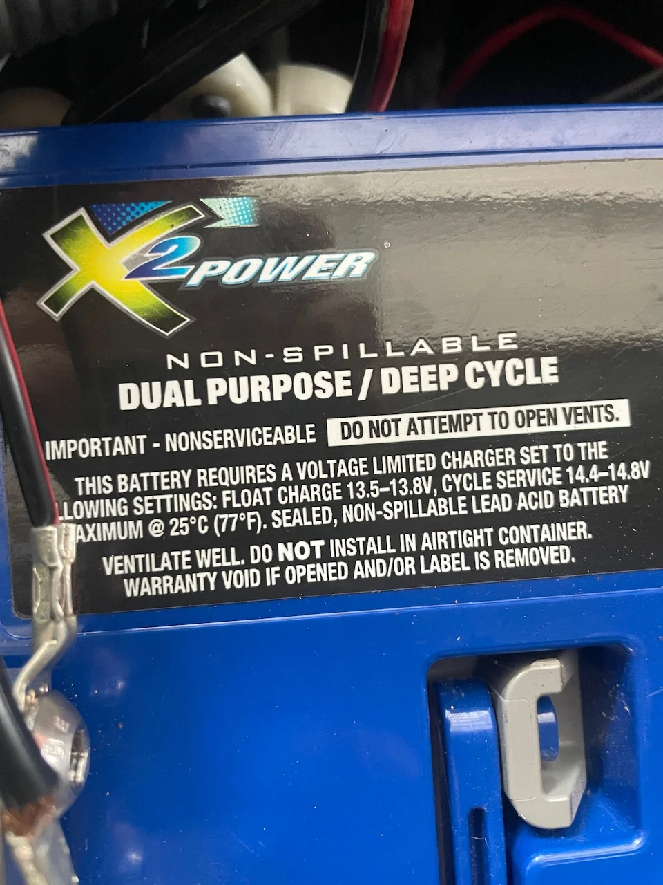

the battery also says this on the top:
I think the battery has 6 cells but I'm not 100% sure of that (can't find a spec for this). From the graph at 25C 13.5V/2.275 = 5.9 which is close to 6. I think this graph is also telling me that for a hot engine (>50C) I want the min float charge which would be ~2.175 x 6 = 13v. I think "float" charge is applicable to alternator charging while driving once the battery gets fully charge after starting.
I am now understanding the the +14v numbers are for "cold" in the garage with a charger. I'll back my diode off and monitor.
