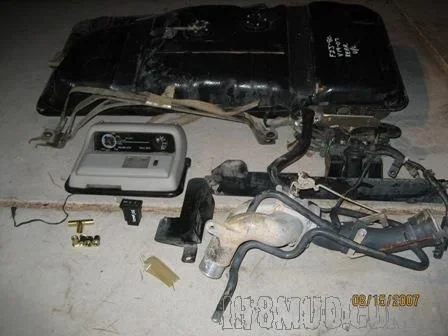

Okay guys I finally got to see all the parts. Here is a picture of one set with everything you will be getting. Please note that not every set will have all the tiny bits and pieces. for instance, one of the dash switches needs bulbs, a couple of the metal straps will need the rubber pieces that fit between the strap and tank. I think that is all that is missing. Also two of the tanks were from diesels and have diesel senders. You can run them this way but if you want to use the overhead gauge you will need to call CDAN and get the 3-wire sender. Lastly, the overhead consoles appear fully functional but one has a small slit on the front-side where someone appears to have tried to install something. Its fairly small and isn't all that bad. Another one of the consoles has cracked plastic tabs. They do not affect the function of the gauge and I think superglue would be a quick and easy fix. Overall the condition of everything is good and hardly any rust if at all but I just want to make sure everyone understands these are used parts and are not going to be perfect.

from the picture it looks like you have the complete bolt in transfer pump assembely.
I agree. Matt, if I were you I wouldn't buy anything else until I got all these parts in, inventoried them and posted pics of each one. Then we can help you figure out what you need. But that kits looks fairly complete.
