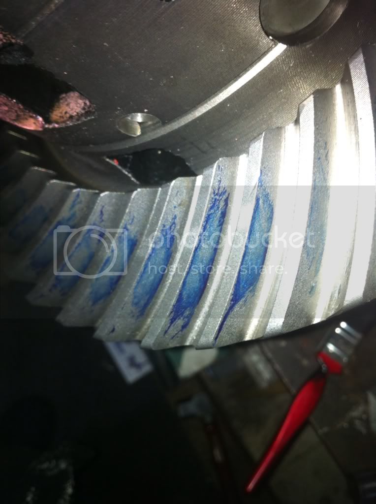

Once the correct preload is obtained, stake the nut.
What preload did u go to?

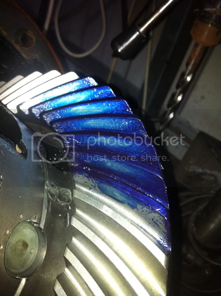

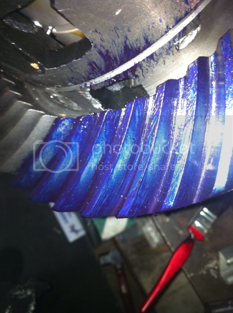

I had set a preload of 14 inch pound on pinion bearing and after following the manual to set the drive bearings, I checked the total preload and it was 15 or 16! Now I have locked the nut after adjusting the total preload to 16 inch pound as per the manual for néw bearings. It's all good but I noticed that the locker is working and the diff is cool except while coming to stop, I hear winding sound underneath! I checked the nut, if it's in same place and was all good! Will drive few kms, n will inspect the oil or else have to pull it out n have a look. Thanks
One thing I would like to add is that, when I checked the contacts of gear and pinion teeth, I noticed that, the whole tooth was having even contact, I mean instead of just in the center of tooth as per ur picture or manual, the whole area of the tooth was evenly contacted ! Do you thing its a wrong setting as I didn't disturb the washer under the bearing on pinion shaft and my back lash was set to 8 thou! While checking with blue, I gave some load on the drive gear with a pry bar!
