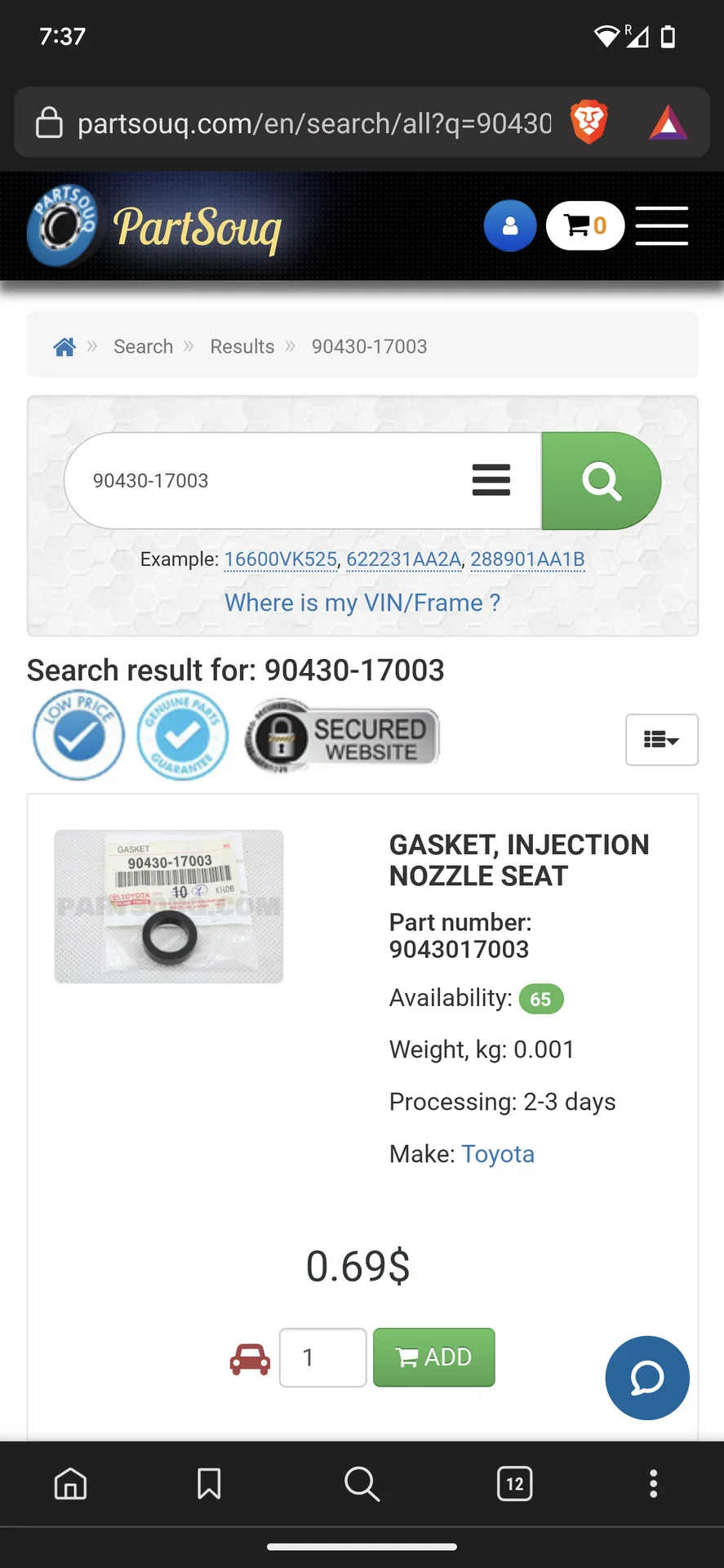

90430-17003. Available from overseas Toyota sources.
Since you have to remove the injector and pull the spill rail off, make sure to get the two copper washers: 90201-08106 (x2 per injector). They are available from any Toyota dealership in the US.

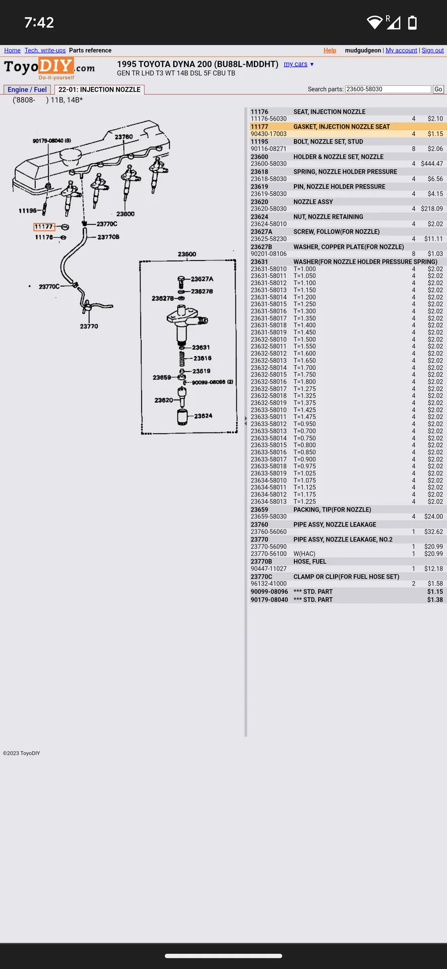

Did you manage to get TOYODIY working for you?
Once I find a diagram and part number, I copy the 10 digit part number, and search by list number on partsouq.com as a first stop for pricing and availability.
I've used Dave Stedman to source parts too. He's very helpful and will track down what you need.
1995 Dyna 200 with 14B
Or,

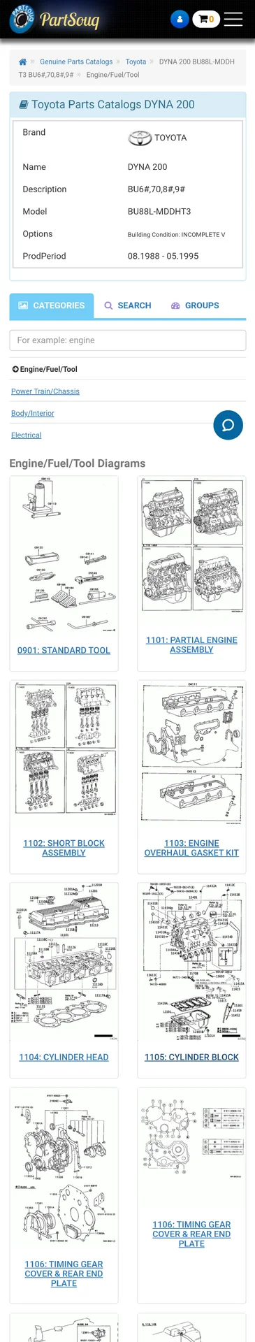

Go straight to partsouq.com
All the parts diagrams are available, no log in required.
Scroll down on the Partsouq home page and click on the Toyota emblem, then search, Dyna, enter as much info as you can to find a relevant model.
Hello @mudgudgeon So, I tried for 3 days to get registered on Toyodiy however the “captcha” code was never visible. In the end, it just said ….not registered. The image in the box was a tiny blue “?” and not a link to anything. So, I gave up realizing that this is a real source but I would not get access to so, I will try your second option Next
I started to find a few injector seals and rail gaskets and ordered those….thank you @OGBeno. Some of these are local and very inexpensive crush washers….one injector seat was $4.24 US but the shipping was $18.00

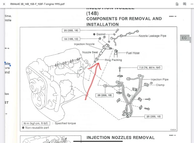

Thank you kindly for your advice and checking in….by the way, I did print that 14B manual you sent…over 160 2-sided pages. It lives on the front seat right now
