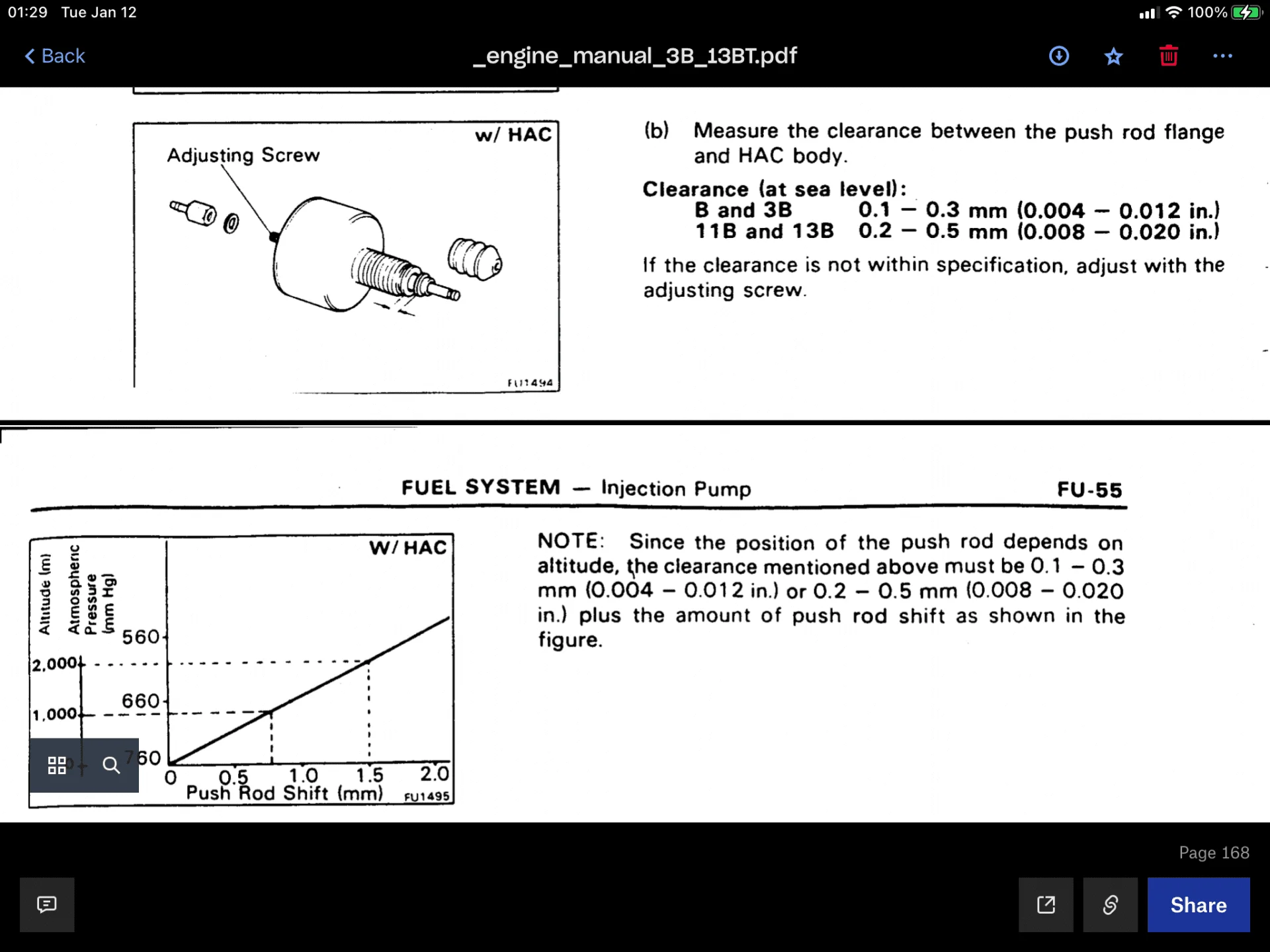

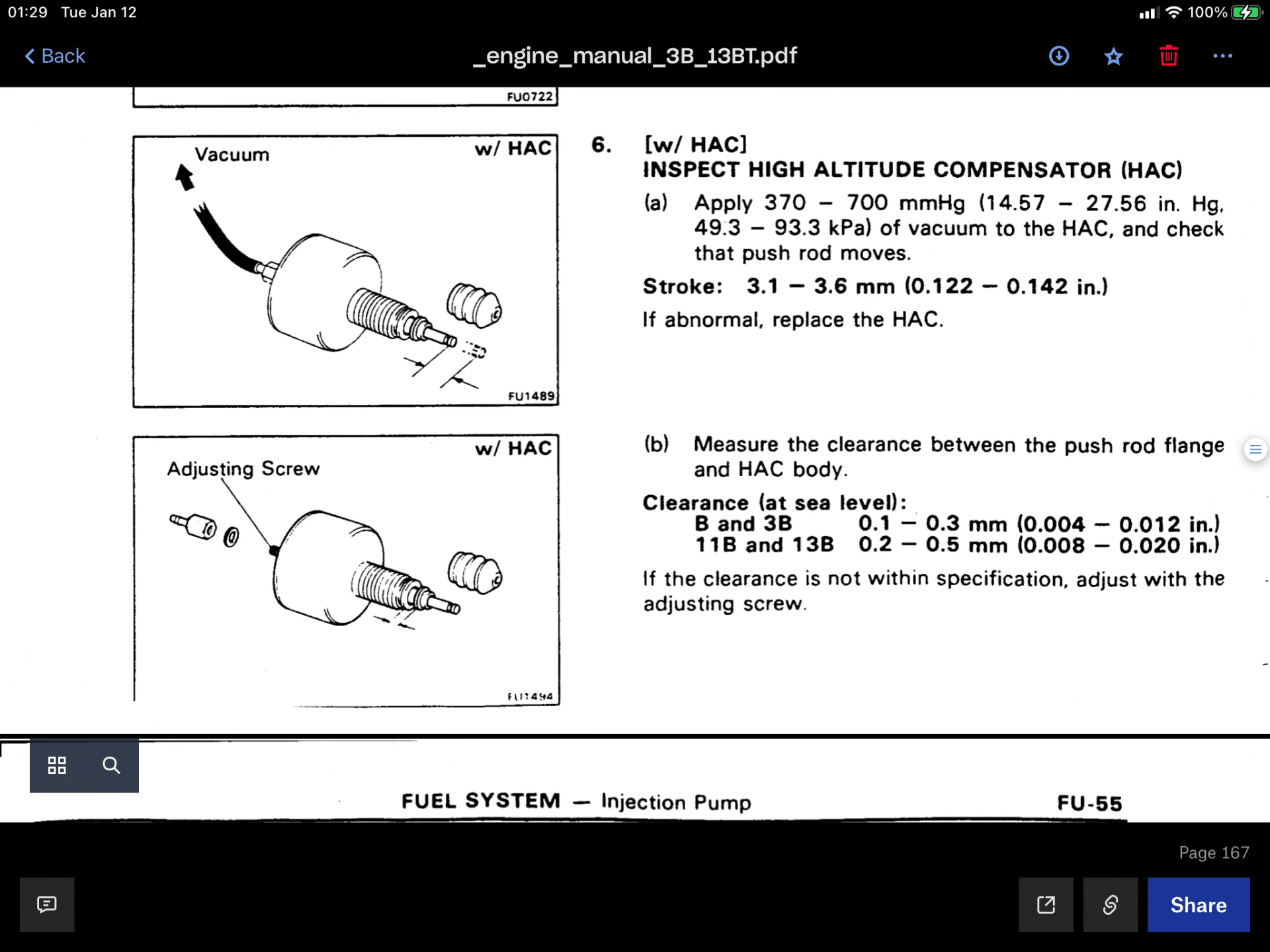

I read the engine manual and found the table for the Diesel HAC outlining the amount of movement. From what I read, it retracts on higher altitude (need to confirm that). The capsule moves 0.75mm per 1000M of elevation to a max of 3.1 to 3.6mm. If it retracts on higher elevation, the aneroid capsule internals are exposed to Baro, while encased in an outer shell calibrated at Zero MSL; conversely if it extends, then the aneroid capsule is sealed at Zero MSL and the housing is exposed to Baro.
I think I will still need to have a closer look at a running set up to see what it moves, and copy the bracket as well.

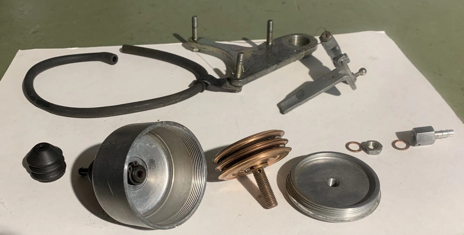

Here’s a couple of pictures, of a DHAC both assembled, and disassembled. As you can see, the aneroid capsules threaded attachment/adjustment post has an axial bore to allow ambient air from the collection tube to be routed to the inside of the housing by a radial bore at its base. It does not enter the aneroid capsules, which are sealed. The actuator shaft, under the rubber boot, has not been removed, but has an free sliding fit to reduce friction (which allows air leakage to and from the housing). The actuator shaft is retained by a circlip, which allows a maximum of 5mm travel.
there is no seal between the housing body and lid, just two edge stampings to lock it in place. The copper washers, and both the locknut and nipple (with lock wire drilling’s) are used to prevent any change in adjustment once sea level pressure clearance has been set, by turning the end of the aneroid capsules post with a straight bladed screwdriver (under the nipple).

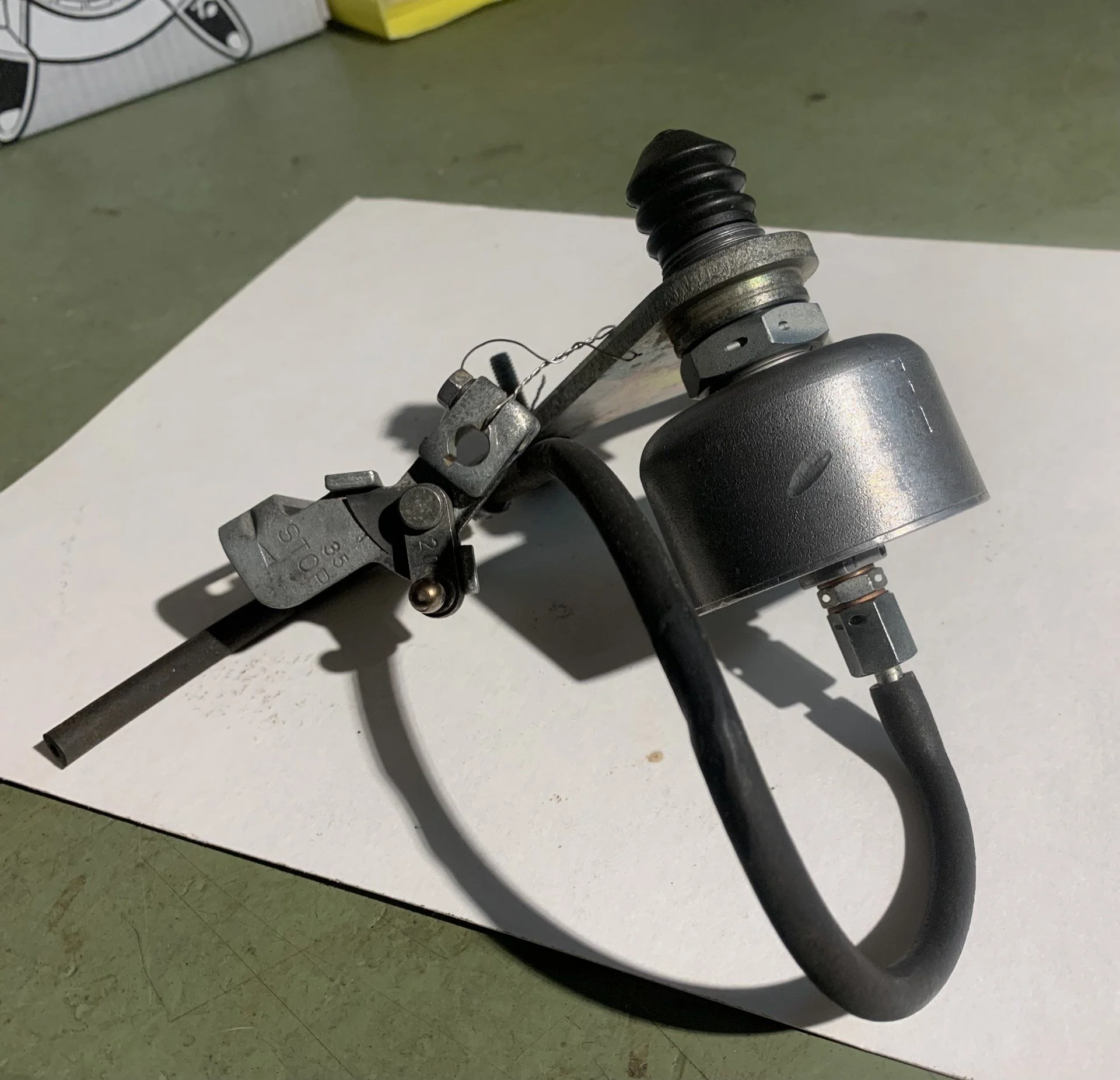

Oh, and here’s a terrible shot of a picture of a DHAC installed on a B class engine, showing the different actuator arm and EDIC linkage. Apparently the EDIC linkage arms are the same, so there is no change needed.
Thank for the lovely information and pictures. Can you give me the diameter of the aneroid capsule, and the stacked height? From what you have given me, we can reverse engineer the D-HAC and I can begin matching up a suitable aneroid capsule.
I have sent of an RFQ to the aneroid capsule supplier, to meet the same performance specification. I would design it slightly differently. I would put the sense port on the housing directly and not use a threaded nipple and hollow threaded pipe and opt for a solid post instead.
