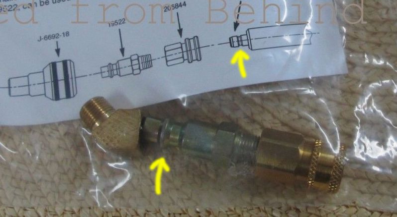

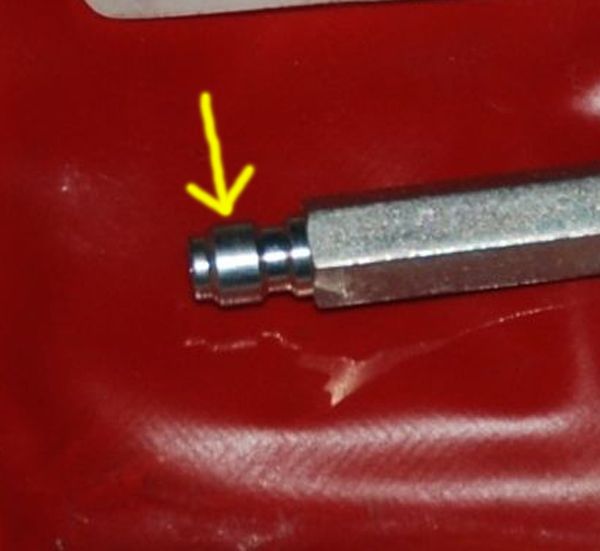

It's hard to know if that adapter will work with the tester. The quick-change fittings aren't universal and using the zoom feature on those images looks like the connections are different. You would be better off with a Kent Moore kit that includes the adapters.
A couple of photos to demonstrate the connection points that look to be incompatible. But the Kent Moore unit comes with an adapter that might make it work. Hard to know.
